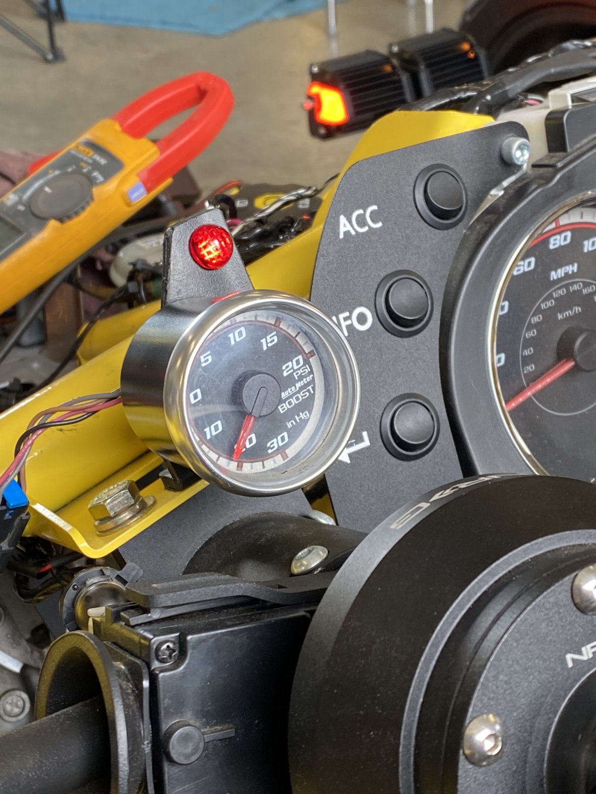

Anyone on here know how to wire the Parking brake from my donor car properly? Need to get that done to get my reg in cali. They make it such a pain in the ass to try and get registration.
I think the instructional videos indicate it can't be wired in since that connection goes back through one of the modules that was removed (I think the restraint module).
What do they require? It might be easier to just add in a bulb labeled P Brake with a micro switch or a ground connection through the original switch.
Parking brake light? The switch on the lever triggers ground. So grab an Ignition positive and run it to an led. Then the ground is triggered off the park brake lever. I put mine next to the boost gage.
