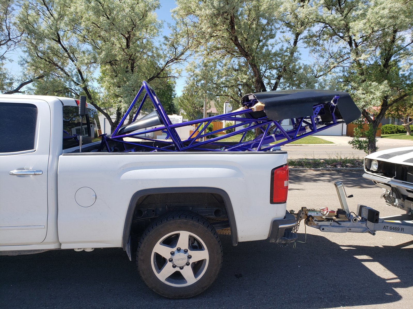

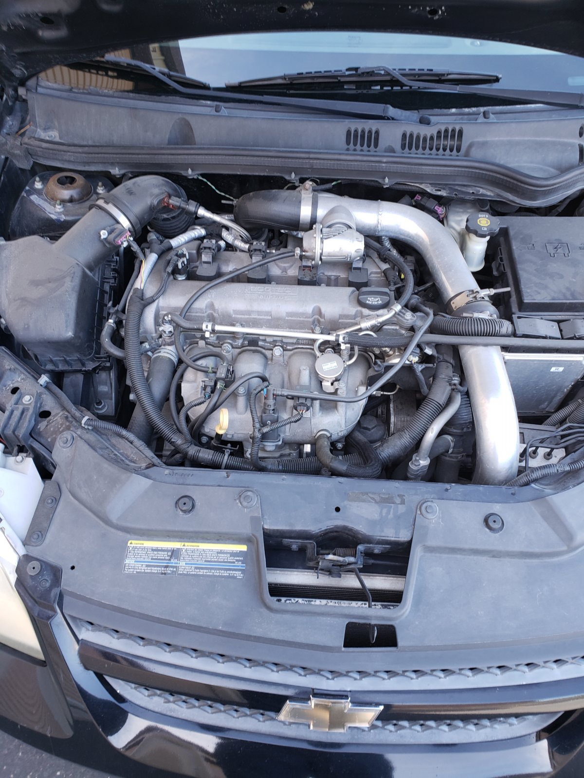

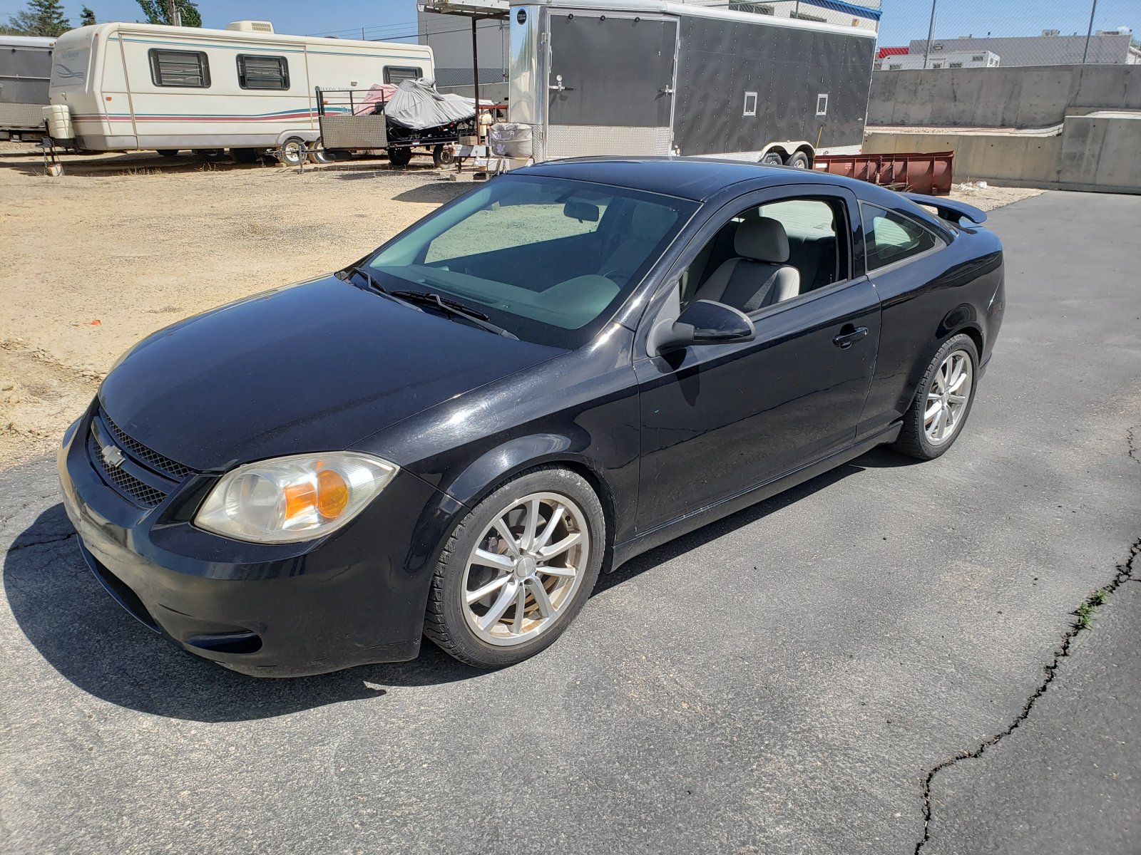

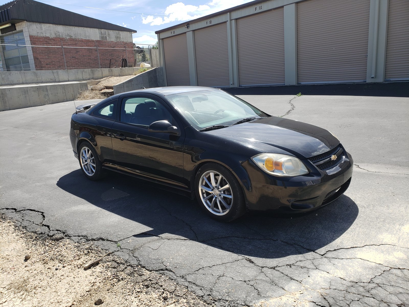

Well the trip to DF went pretty good. Lonnie and Adam were great :D. Got to ride in a goblin for the first time and wow I am impressed. Now the drive back was an interesting one. Had 2 blow outs on the uhaul trailer I was pulling. Waiting for uhaul put me over 8 hours behind on my trip back. I do have a question about my donor though. Talking to Lonnie he said that the turbo ss has a boost gauge but mine does not. Has anyone else seen them without the gauge. Maybe mine is a very bottom of the line ss lol. Haven't started to tear down the donor yet but figured I would include some pics of it.

I spy an RS Camaro on the trailer (RS lower valence), is it a 67 or 68?

Someone on the Cobalt forum may have an answer about the boost gauge.

Thank you and Good eye. It is a 68. Brought it up from Midland, TX. Has a low compression 383 in it. Going to put a pro charger on and see what it does :D. I will probably just put a aftermarket boost gauge on unless it has the wiring for it and I can find one for cheap.

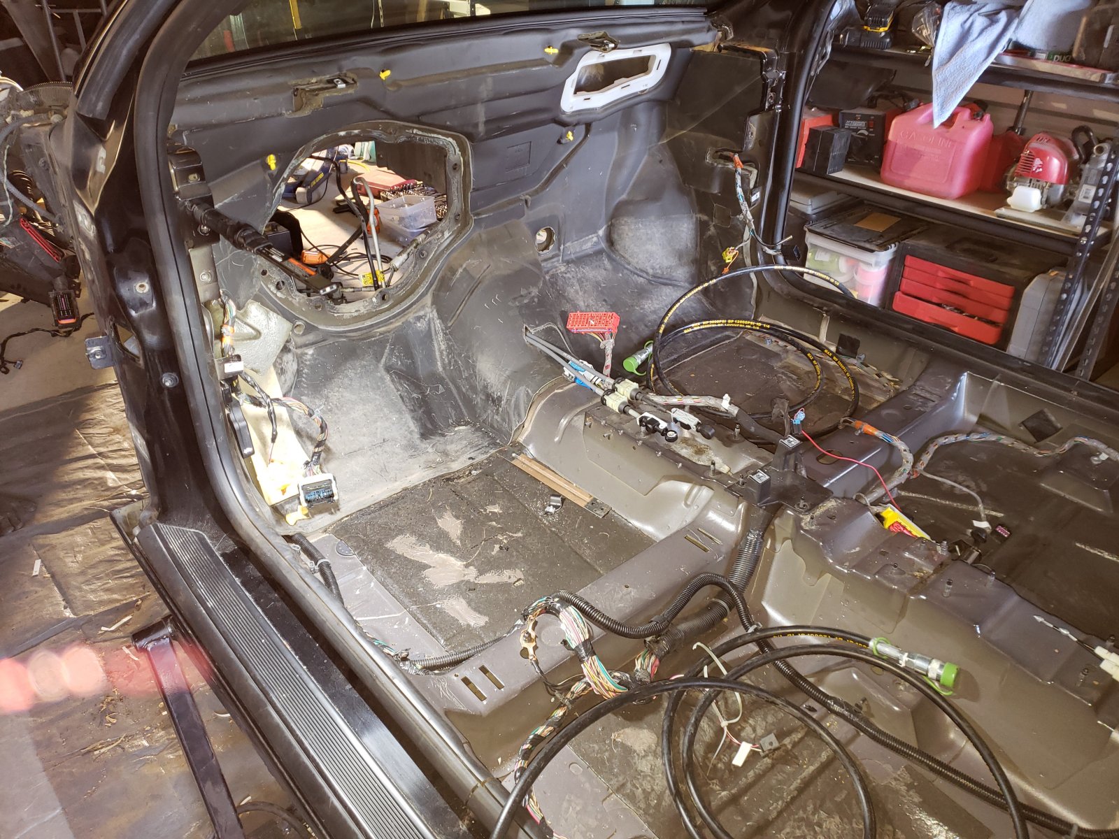

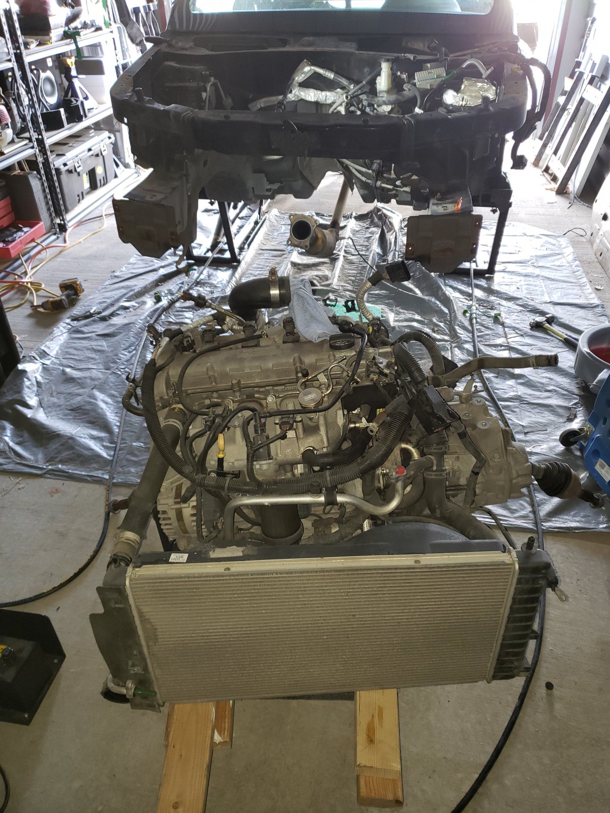

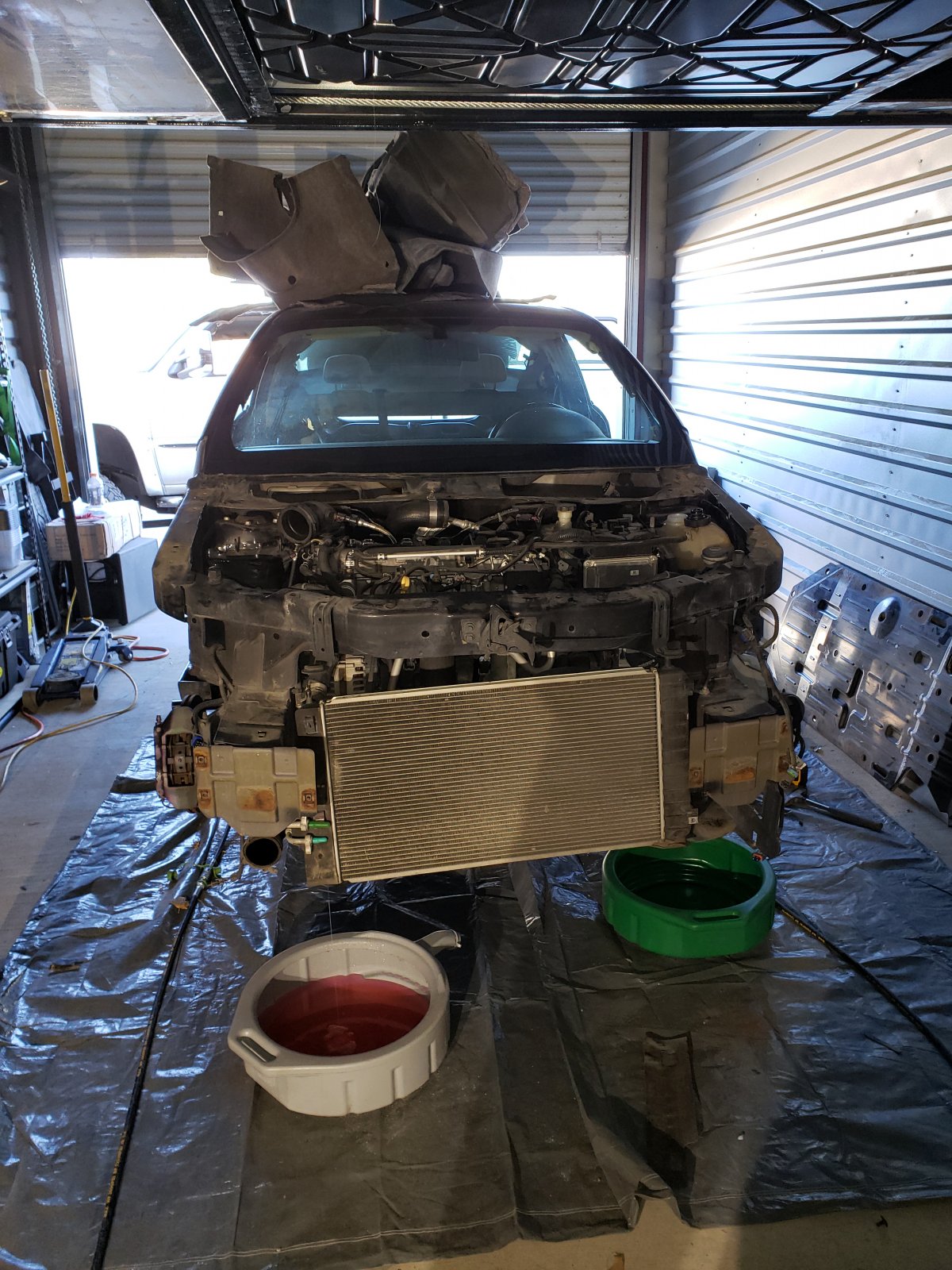

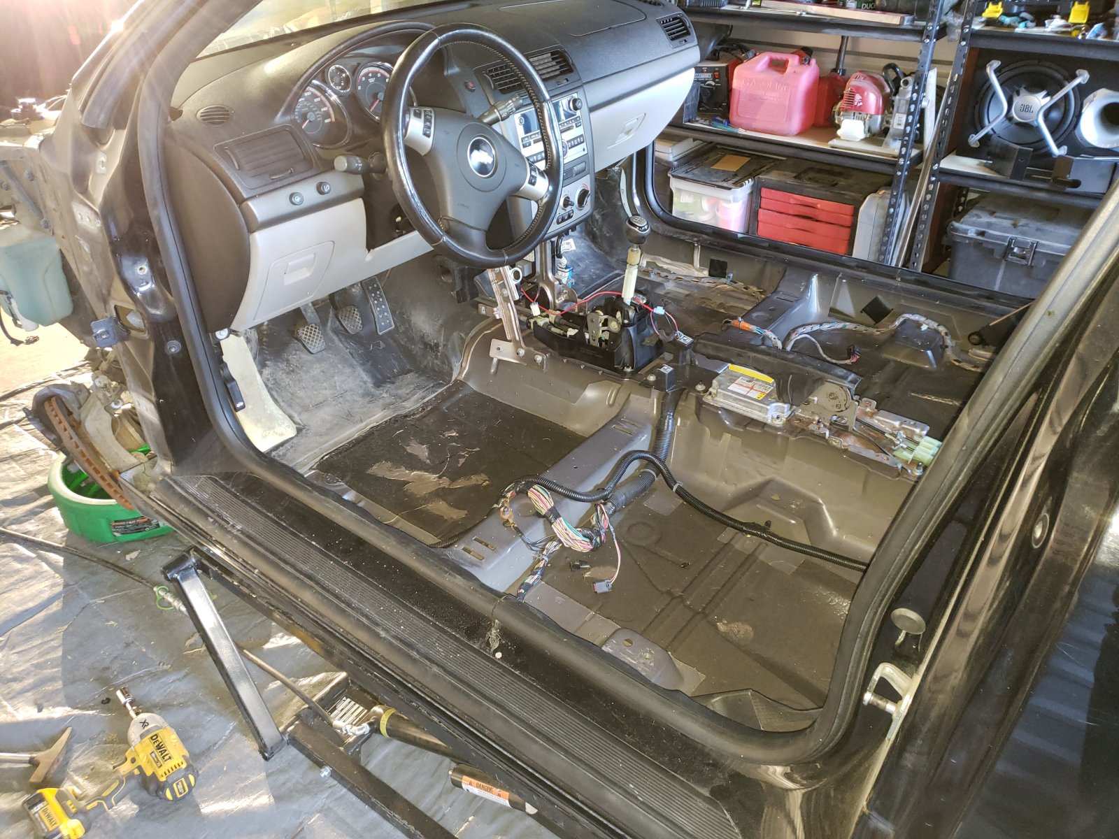

Well been a while since I posted. Finally got to start disassembly. Once I started going it seemed to just move along. Wish I had some buddies to give me a hand but at least they didn't have to put up with me singing along with the radio. Got the powertrain out, which was my biggest fear without some extra hands just to be safe but the quickjacks worked pretty good. Just set the car on the dolly and unbolted the engine and transmission mounts then lifted the car off of it. :D After I got the powertrain out I decided to tackle the dash. While I was trying to figure out how to get the dash out like the video showed and not having a second set of hands I decided to strip the dash in the car. Wasn't too bad actually. by the time I noticed I had the dash in pieces on the ground and the heaviest thing I had to lift was the steering column with the power steering unit still attached to it. All I have left really is to get the body harness out so I can get it shipped off to Lonnie to rework, but got too late and got it about halfway out. Today I was going to go finish it but weather stopped that. Was down to the teens today and no heat in the unit I am working in. :( Hopefully finish it in the next couple of days, weather permitting. All in all it hasn't been too bad. Have about 8.5 hours in it so far. Pile of parts is growing lol
Was going to replace the clutch and timing set while the engine was out. Any suggestions on what type of clutch, brand type etc, and if anyone is running an aluminum flywheel. Don't know if the aluminum flywheel is worth it or not, being such a light car. I probably will be doing upgrades in the near future after getting it on the road. I just cant seem to keep things "stock" lol. Not looking to get 585 hp but a nice 350-400 would be nice :D. Any other suggestions to do to the engine or transmission while I have it out. It will be cleaned and painted also. Have to have it look good where everyone can see it

Christopher Sanchez
Your donor is very interesting, I owned a couple of these little cars over the last 10 years and they all come standard with either a digital or analog boost gauge. Also come with “SS” seats up front.. the emblems on the doors were removed along with the front lip. It has me thinking either the previous owner was trying to get it to look like an base cobalt or maybe swapped parts to another car. haha. Either way you got all of the important drivetrain components and from your fuel fill tube discovery sounds like you got very lucky and now have a nice donor! Good stuff. With opal injectors and a ZZP turbo swap/tune you should be able to hit your HP goal. However stock is plenty to get yourself in trouble in these things haha
WYGoblin
Yeah I was thinking the same thing when I asked Lonnie about the boost gauge. I did find the plug for it in the a pillar though. I think I am going to try to find a stock boost gauge to put in. I have seen a couple as here that look like mine. Not sure if they were turbocharged or n/a though. I was thinking the same with the turbo upgrade and opal injectors. Maybe the upgraded coils too. I still want to drive it first and have some fun with it. Maybe next winter would be a good time to do it if I get to drive it next summer. If I make good progress this winter it might get drove in freezing temps cause it would be hard for me to wait for spring lol.

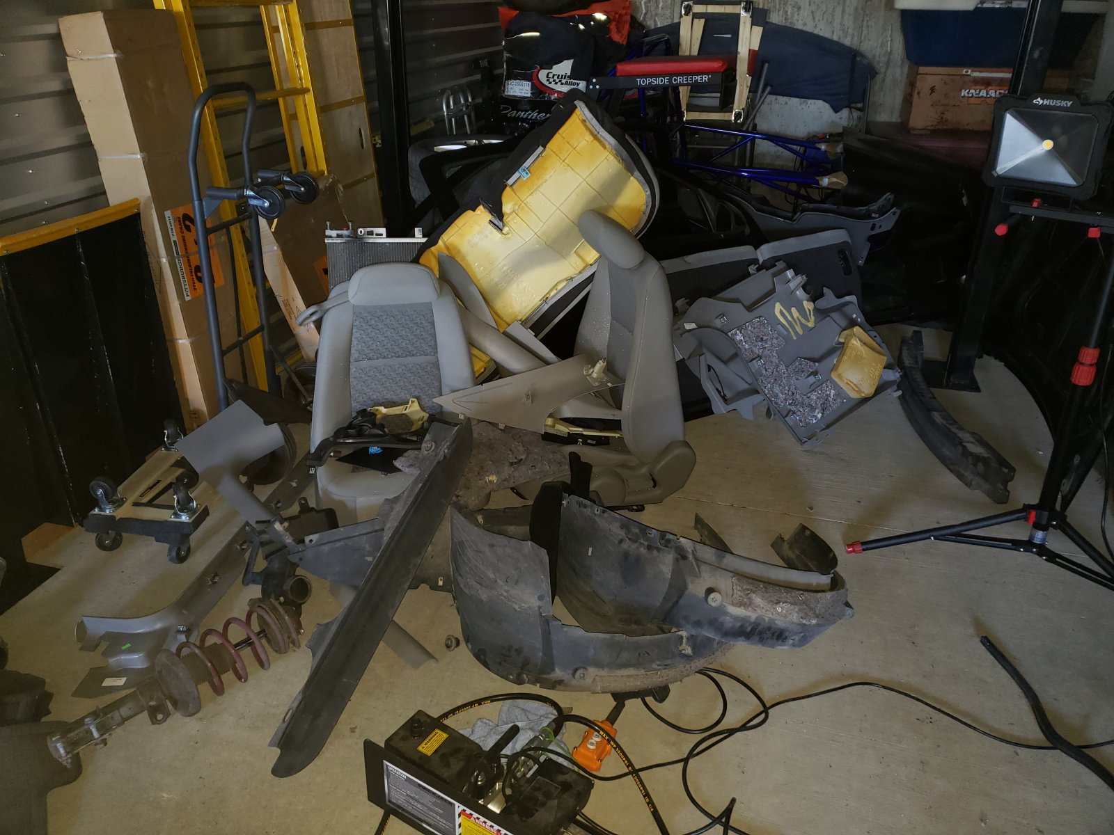

Well I got the rest of the car stripped today. Started to load the car back up with the pieces I do not need to keep or sell. I was debating on putting the doors back on but not sure if I need all the bolts out of the door hinges. I looked at selling the extra parts but there is not a market for them where I am at, so to the scrap yard it goes :(. Glad I did get it done today as tomorrow the high is supposed to be 9 deg with a low of -5. Now comes the clean and organize all the parts so I can find them when I go back together. (I know I will be losing something, always seems to happen to me lol).
Christopher Sanchez
Just be sure to save your shift cables and parking brake assembly. DF supplies new shift cables but you will re use the cobalts shift cable connectors. If you purchase DF’s parking brake kit you will reuse the lever and cables.. The tear down is definitely fun but now comes the exciting part!
