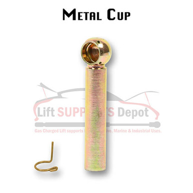

Does anyone know what the thread size and pitch is for the Bowden shift cables? I am wanting to eliminate the stock plastic clamps. The aftermarket options do not work because the included shift cables are a smaller diameter than the stock Cobalt ones.
Lechlis
What are you planning to do here? I wouldn't mind eliminating the plastic clamps either, and have no means of welding.
For the forward/backward movement, I ordered one of the ball sockets linked below. It is a 10mm ball on the shifter and 6x1.0 on the shift cable. It measured about 2” from the ball to the end of the shift cable with everything neutral, so I got the 2.24” long ball socket.
I am still looking for a side-to-side adapter. Instead of the ball, mine just has a small rod that measured 0.24” in diameter and ~0.40” long.
OptimizePrime
You may have seen this already -- works perfectly.
