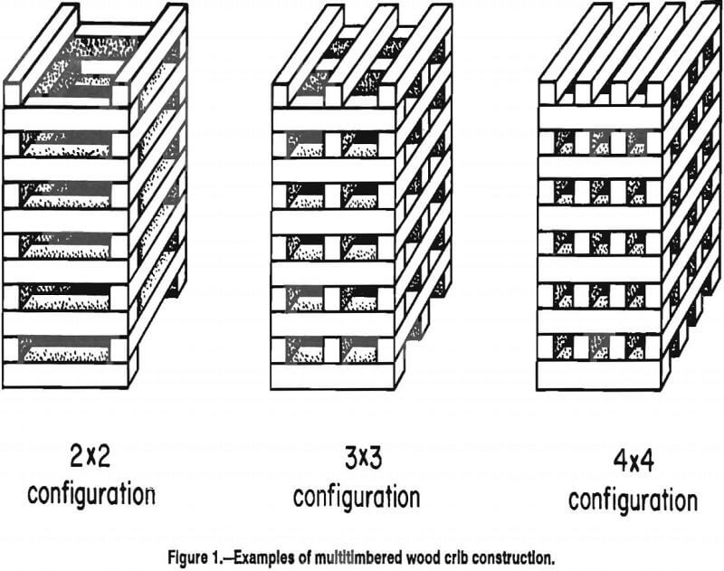

Meanwhile, another few things have been done here and there to address the coming premium of space related to dropping the engine and finally pulling the old shell out of the garage. I tore apart the rear bumper & reinforcement to get a couple more inches
I had positioned the car to be 2 inches away from the garage door while the bumper was on... although it may have shifted while settling the thing on jack stands, there was still very little room to be had with the door closed. taking off the bumper will give me an incredible 16 " of space with the garage door closed. this will help when i go to pull the engine or need to drag the donor body out of the way later.
i am considering the idea of placing wood stacks on the wheel dollies in what people consider a crib configuration (?!?)
image from "911metallurgist" dot com
