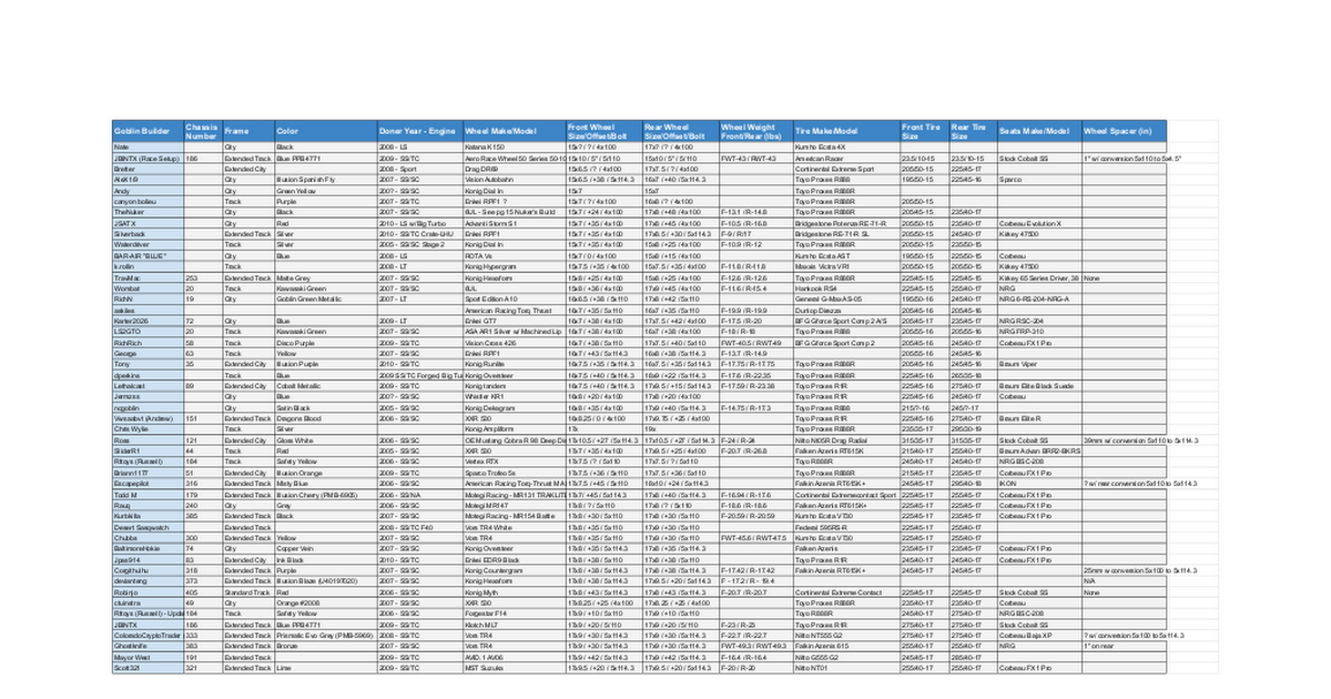

Any chance someone is willing to share the excel or google doc file of the wheels/tires spreadsheet? wanting to do some analysis and see was is most common. Would be easier if I had something i could manipulate. Thanks!

TravMac
I might take this on one of these afternoons. There was a file at one point, but not sure where it scampered off to. I'm curious myself as I'm looking to get a second set of wheels for the street to see what folks are running
TravMac
Also, looking for more info too that may be useful to folks, can we include spacer information too? Could really help folks make decisions using this info on their build or wheel purchase.
I can make it open to edit by folks with the link and add their info. Can also fix any mistakes I may have made in translation of all the data here. Any other suggestions for information to include for filtering would be great!
