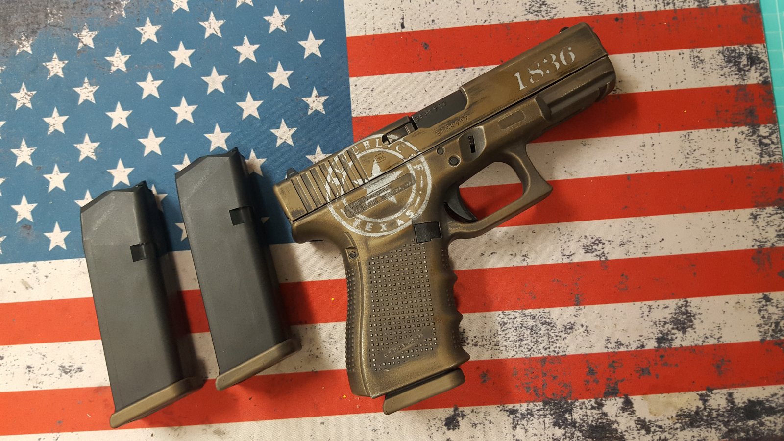

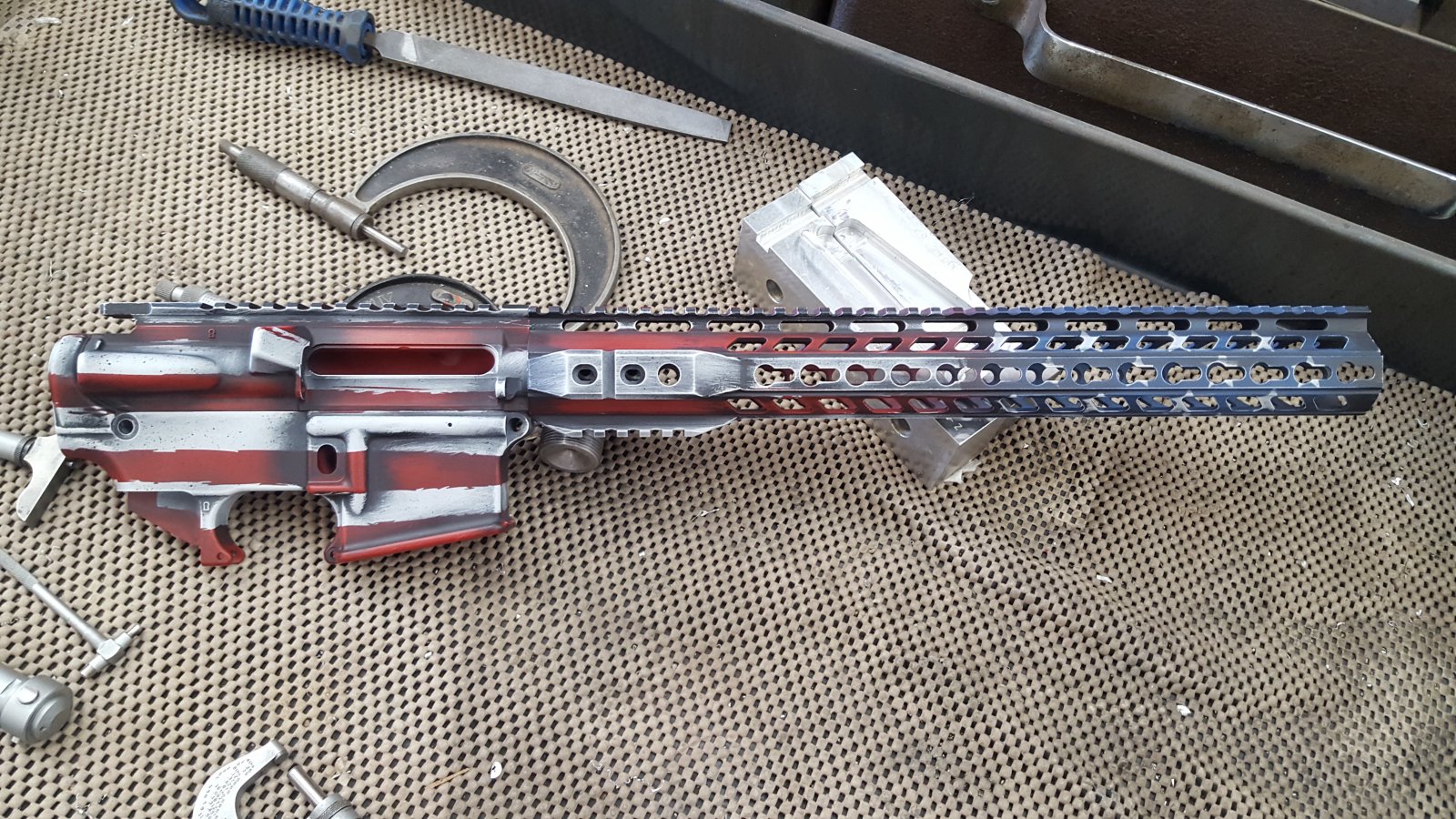

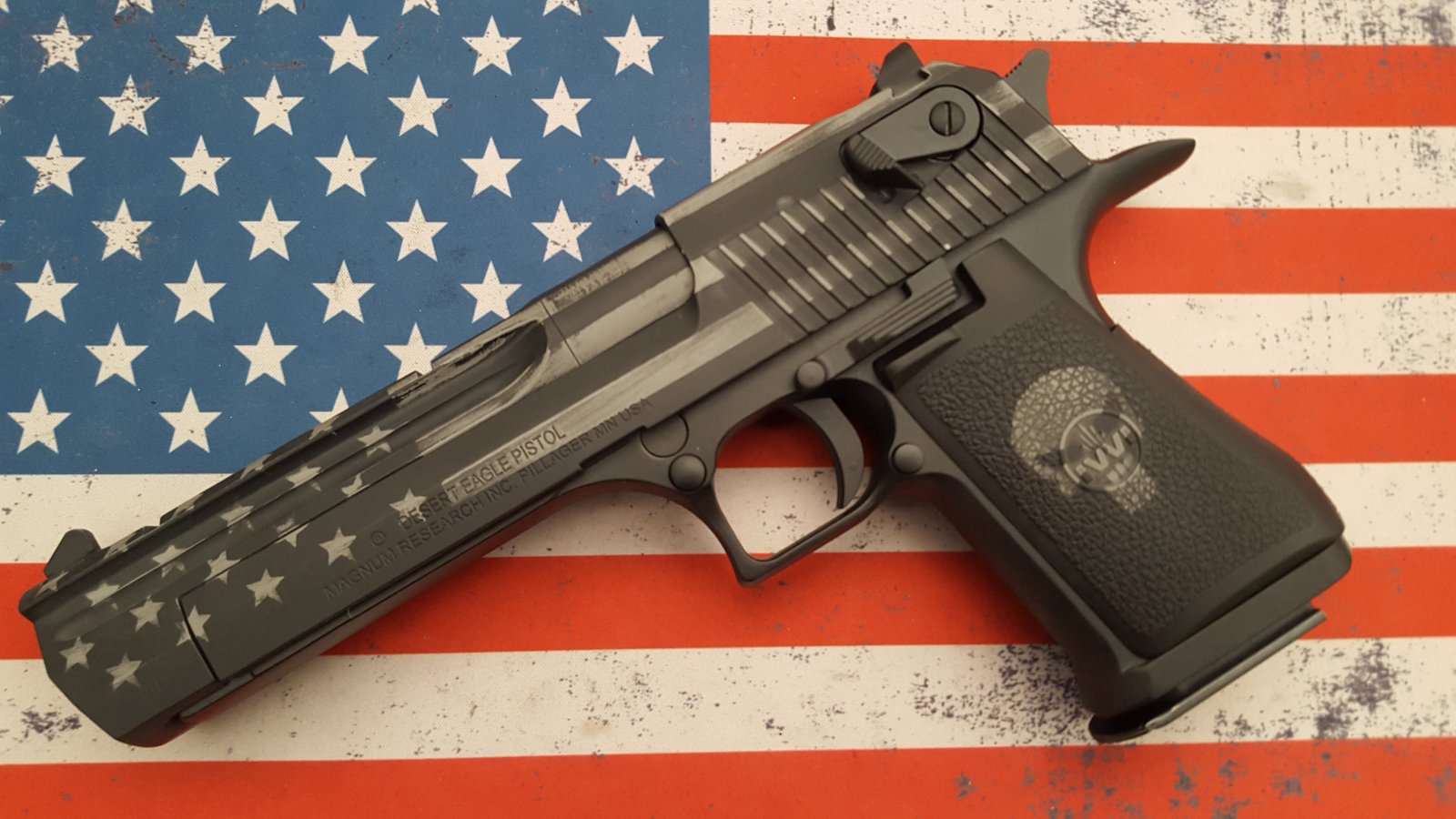

LLBenj, A couple of things. Talk to any painter that ever painted tubes and they will tell you they hate it. It very hard to get a consistant finish and not get runs. Spraying Cerakote is no diffrent than painting in the sense its a learned skill. And getting a consistant flat finish on a large area is not easy to do. Unlike paint with cerkote there is "Sanding or buffing" mistakes. As far as touch up once the cerakote has cured it would be like painting on a non stick pan. It wont adhere and and you will see where it was "spotted in" When I have a problem with a job there is no "touching it up" Its a complete Do over. Strip it and start over. You mentioned the cost of the Cerakote. You also need a good gun with the right tip. And no they dont sell it at harbor freight. The gun I use is an Iwata and its over $300.00 So add that to your cost And you still need a paint booth or like paint there will be all kinds of crap in it. Also Cerkote is not UV stable so in time it fades as well. Just to close if a customer brought me a chassis to do in Cerakote I would turn them away for all the reasons I stated. You can get a flat bronze in powder coat. I would simply do that. I hope this sheads some light on using Cerakote. I am including a couple of pictures of my work to show that I do know what I am talking about.
