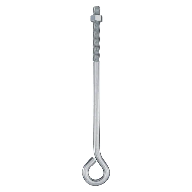

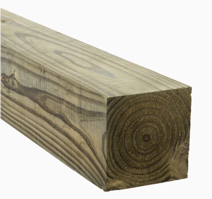

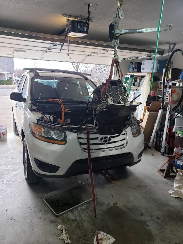

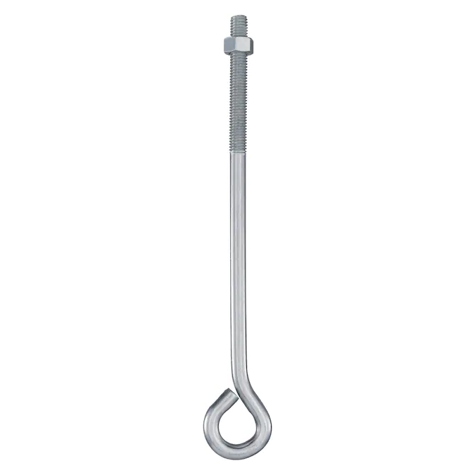

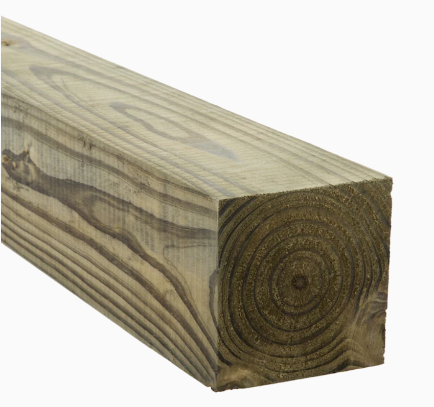

Most garage's I have owned, I put a 4"x4"x10' up in the attic, spanning over 5 ceiling joists, then put a 10" long eye bolt thru the 4x4 and ceiling.

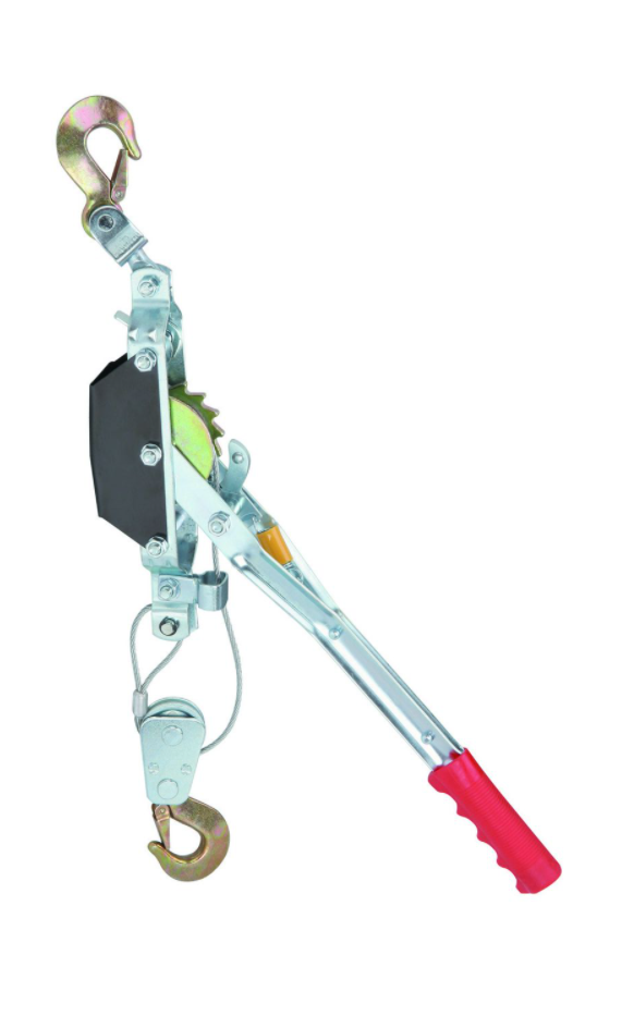

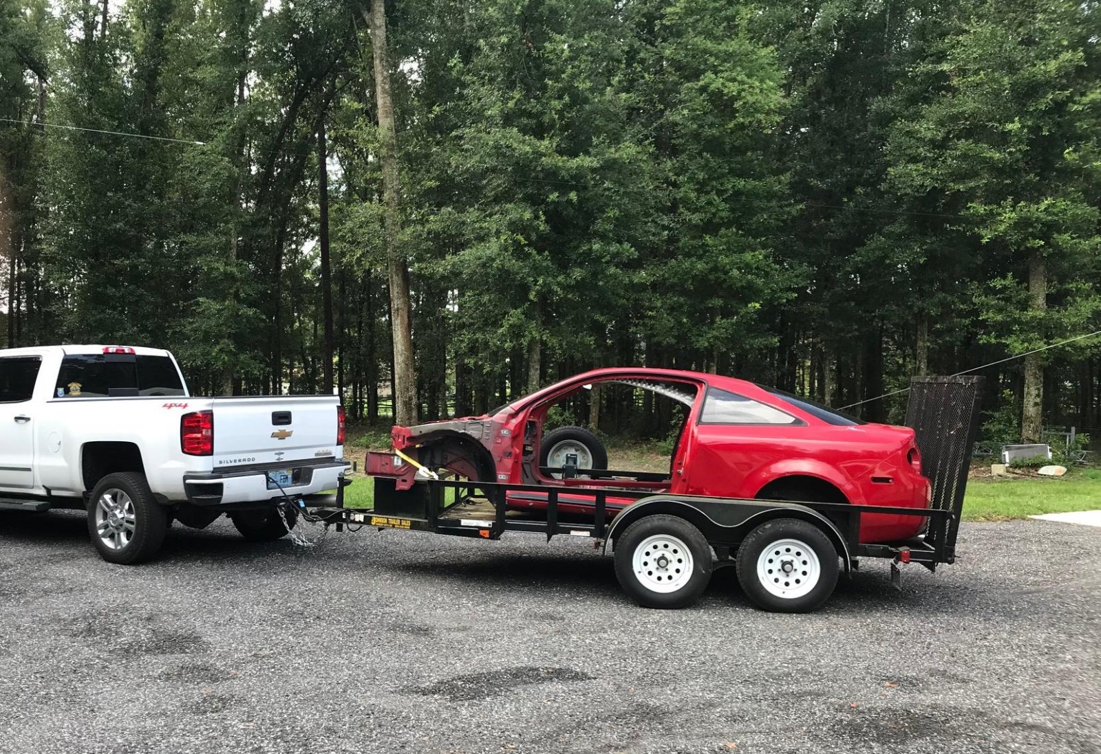

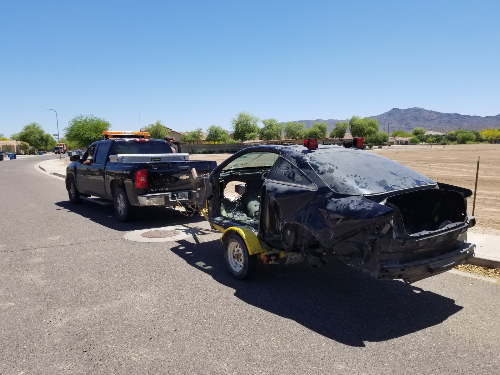

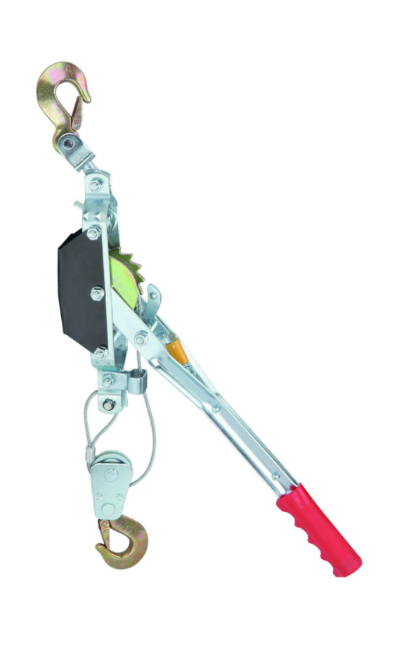

Use a come-a-long to lift the Cobalt shell, then drive the trailer under the Cobalt. Also useful for pulling engines out of cars.

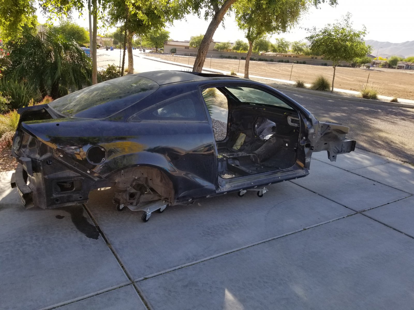

I used a similar process. I used 4x4's across car dollies throughout my tear down in a storage unit. It allowed me to move the shell around as needed during tear down. When I was done, I pushed it out of the unit and up onto my tilting snowmobile trailer.

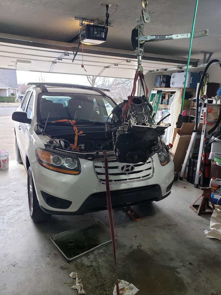

I had my donor on a set of cheap HF car dollies. When it was time to scrap it, I used my engine hoist to lift the front up onto the back of my trailer. I moved the dollies up on the trailer for the front. I then lifted the rear of the donor up and rolled it all the way onto the trailer. Went back to the front and lifted it enough to get my dollies back out. It looks kinda sketchy when you first start, but I've done multiple shells that way without issues. The scrapyard has a gripper excavator so they just pick it up off the trailer.
