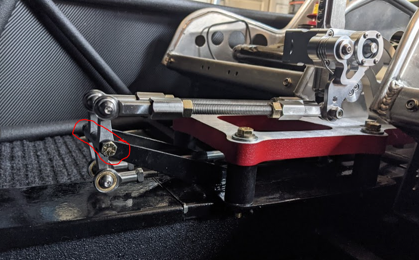

I took out all bolts one by one from the shifter and added loctite. I then snugged everything up really well. I noticed that once I hooked everything up that there was a lot of resistance. Are there some of the bolts that shouldn’t be super snug? I guess I could detach the cables and see if it is still that way.

Loosen this one and see if that does the trick

That was actually what I was thinking but I only had it finger tight. I wonder if there is a bolt on the billet shifter that adjusts the resistance based on how tight it is. I snugged them up pretty tight. I am going to disconnect the shifter from the pivot entirely and see if it feels the same as before I hooked it all up. I cant imagine its because the cables need to be lubed that badly. Maybe I just need to go to the gym haha.
You don't even want that nut finger-tight. You only want it tight enough that the bolt doesn't slop around back and forth. That's a pivot point for the shifter hardware and will resist if the nut is tightened at all.

Oh I see. I will double check it. Thank you!
