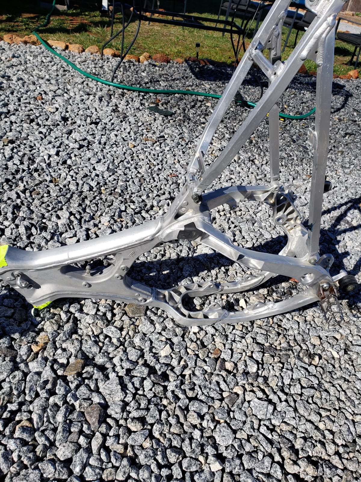

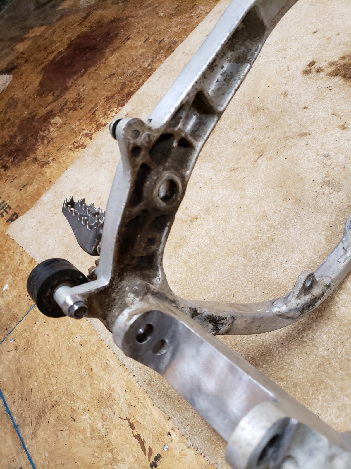

I used it on this project YZ125 I built over the winter. Its legit

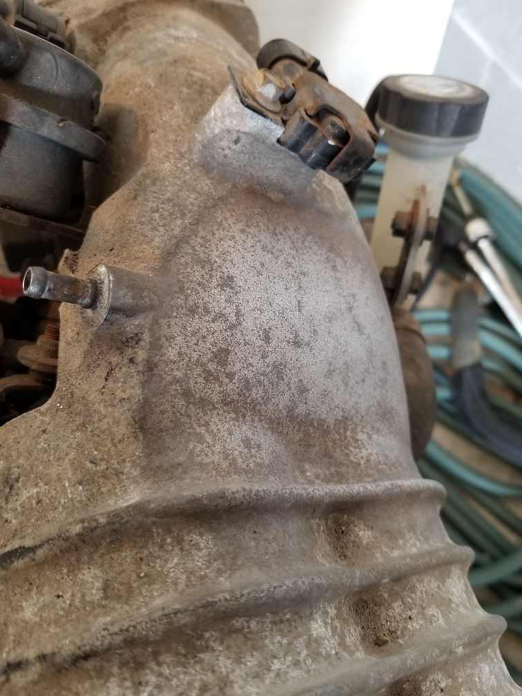

I tried out the Eagle One product mentioned in this thread and it packs a punch. I was able to clean up my AC pump housing pretty nicely with it, though I still have to get into the nooks and crannies of the piece before it's done. Also cleaned up a patch on my supercharger. I won't have time to dig into cleaning the entire engine for a bit, but I can post a pic of the cleaned part of the supercharger later for comparison's sake.
Attached is a quick sample of two squirts of Eagle One and 30 seconds of elbow grease applied to a crimson-red Scotch-Brite pad. It's not perfect, but considering the corrosion level and the fact that this only took me about one minute, I'd say it's pretty impressive stuff.

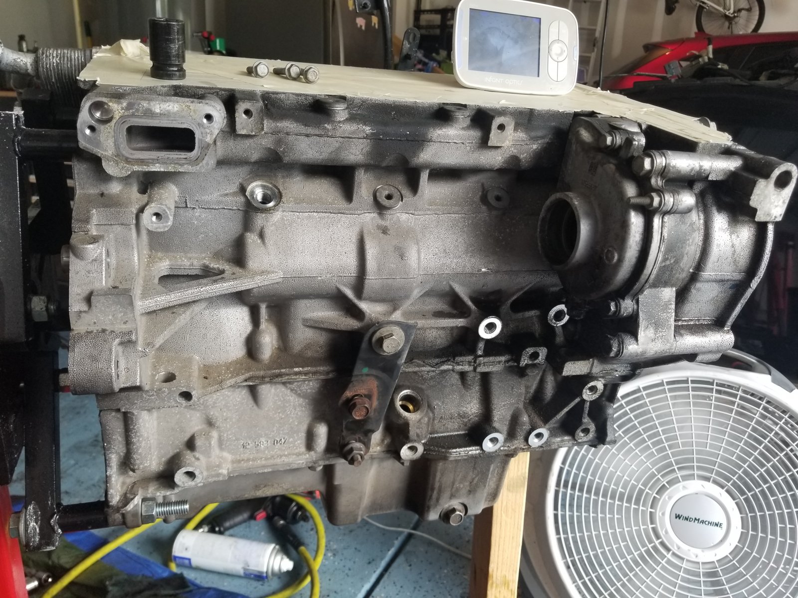

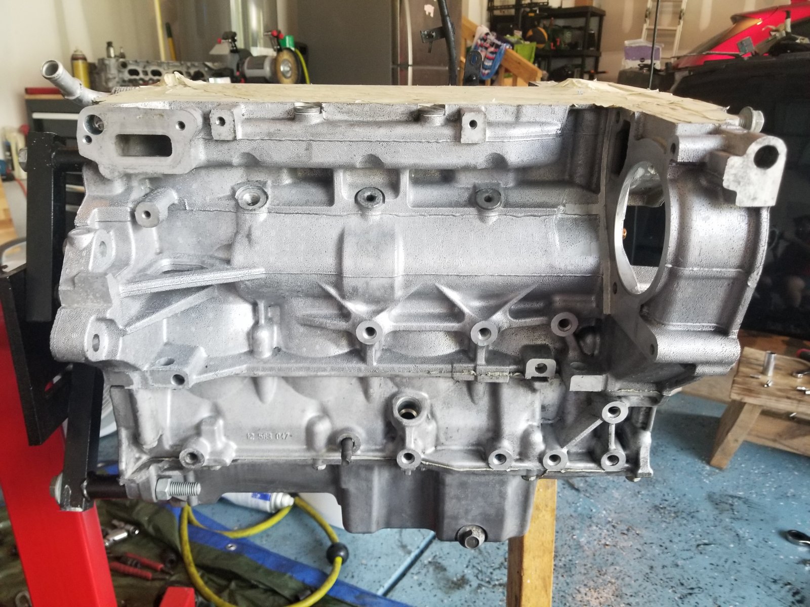

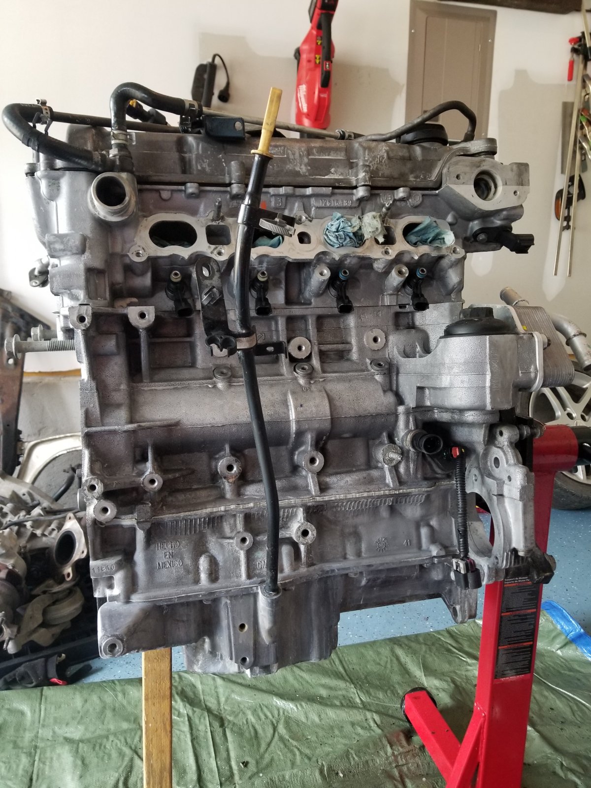

Here are some results of my acid cleaning.
Only one real before picture... I think it turned out well.

Mayor West
I about to do this tonight did it require a lot of aggressive scrubbing? I saw your post after ordering the eagle MAG cleaner.
No, it sort of melts away after spraying the acid on and doing some light agitation with a brush. Just be careful to wear eye protection and gloves, some mist got into my eyes even with goggles on and it burns quite a bit.
In no way was it on the level needing of "polishing" scrubbing.... just light agitation like the level of brushing your teeth. It really does just melt the dirt and grime away nicely.
I did rinse with soapy water, though, as to not waste the acid or get more of it in my eyes.
I don't have pictures yet, but the head really took well to the acid. The crud from the intake ports from being direct injected was difficult because getting it out proved hard, I had to remove all the valves and clean them individually to get it all out, but its spotless now.
