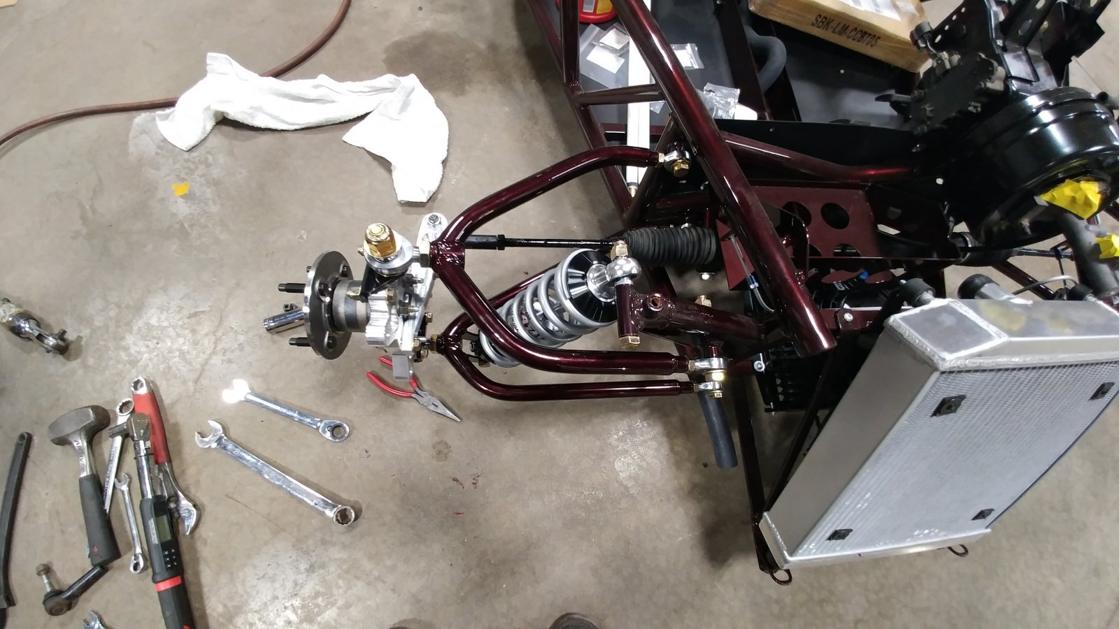

I think I have everything on right, it seems like a lot of people post their pictures and get told their arms are upsidedown or on the wrong sides. So hows it look?

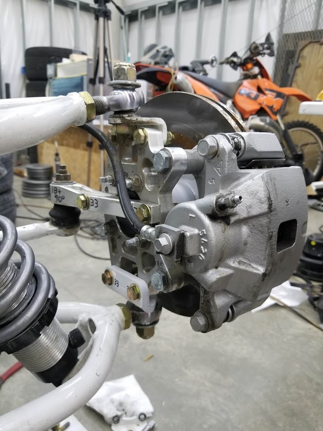

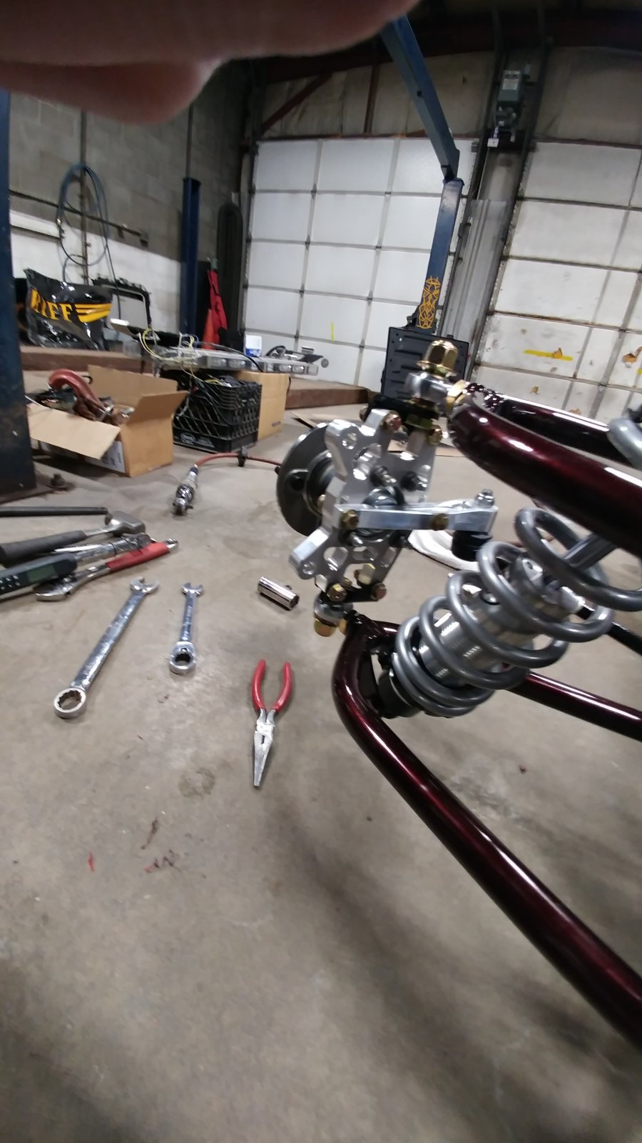

Little bit at a time, waiting on some gaskets and thermostat.
On the front brakes are the old videos still current? I think I'm missing the front brake hardware unless something has changed, I did search for the upright brackets forever until I realised they were now steel brackets and not the old style aluminum ones.

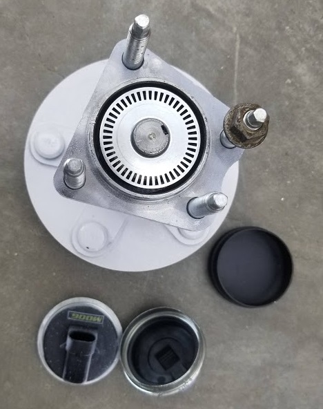

You already identified the main change. Other than that, if your hubs have an electrical connector that interfers with the DF parts, your can get a 3D printed hub bearing cap from DF.
11398
The rubber brake line now is longer, and no longer has a steel line on the swing arm. It goes from the brake caliper to the main frame all in one rubber line.

I bought new non abs hubs and stainless lines, guess I'll call df Monday for the hardware.

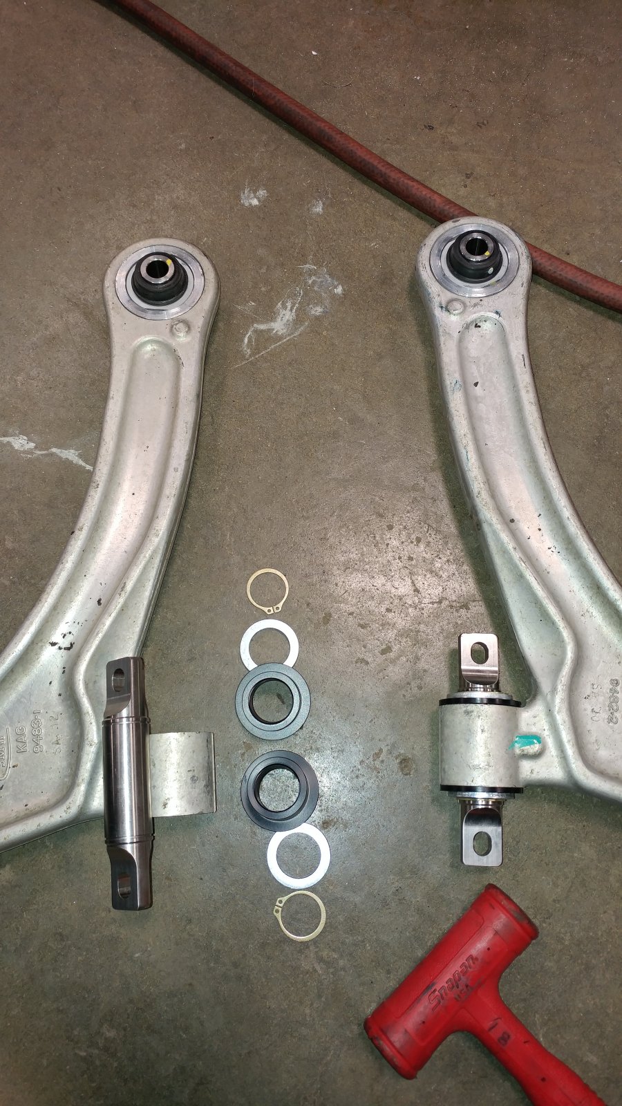

Got my ottp control arm bushings all installed today. I hope to get my supercharger painted and bolted on by the end of the week then the engine can come off the stand and have its first meeting with the new transmission and clutch.

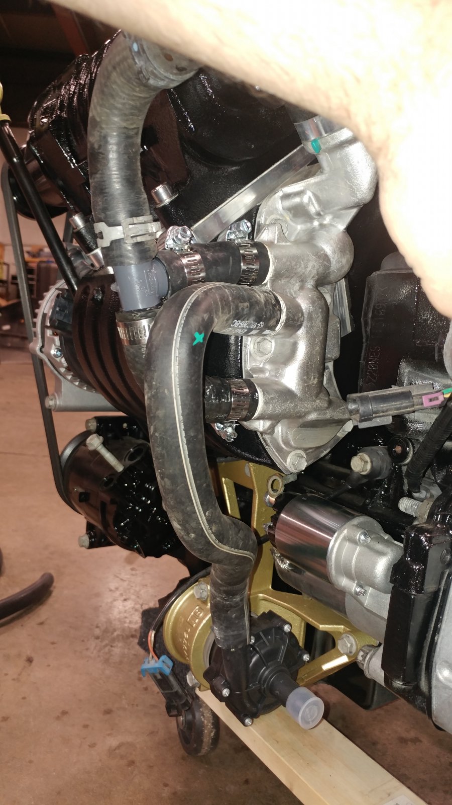

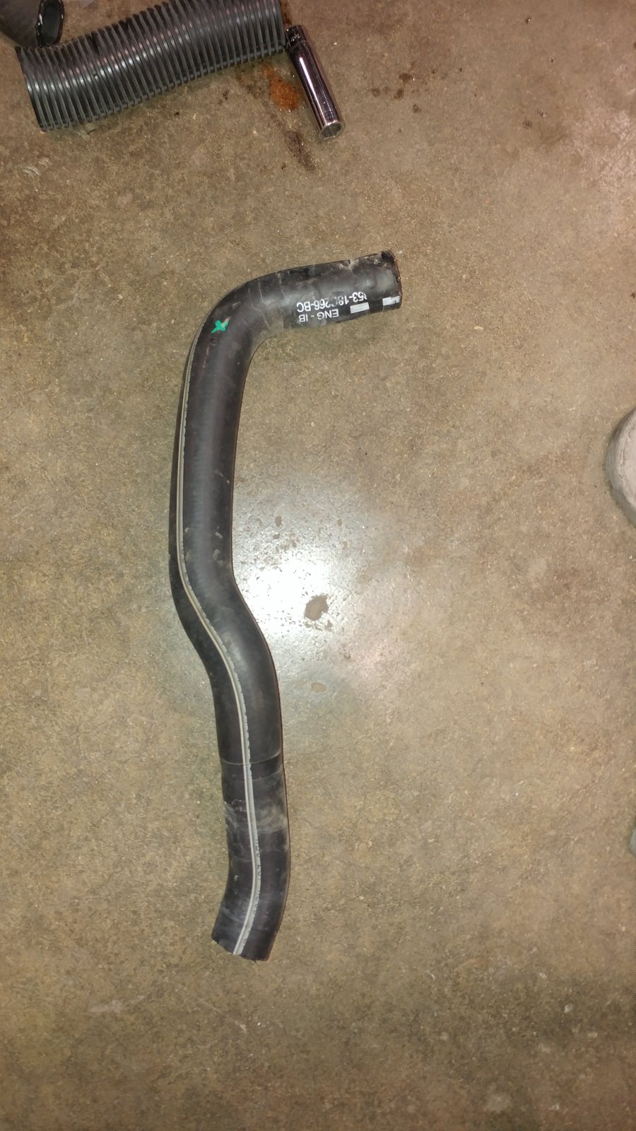

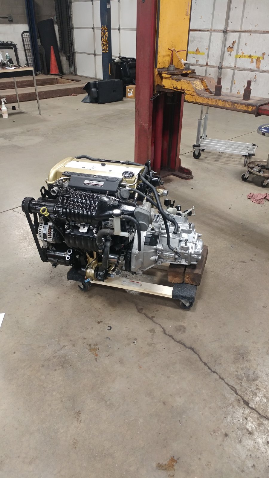

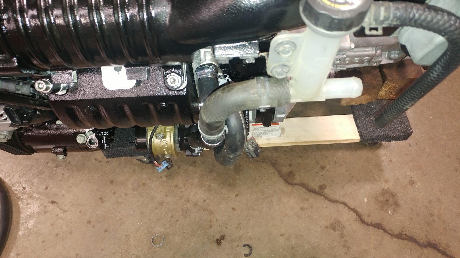

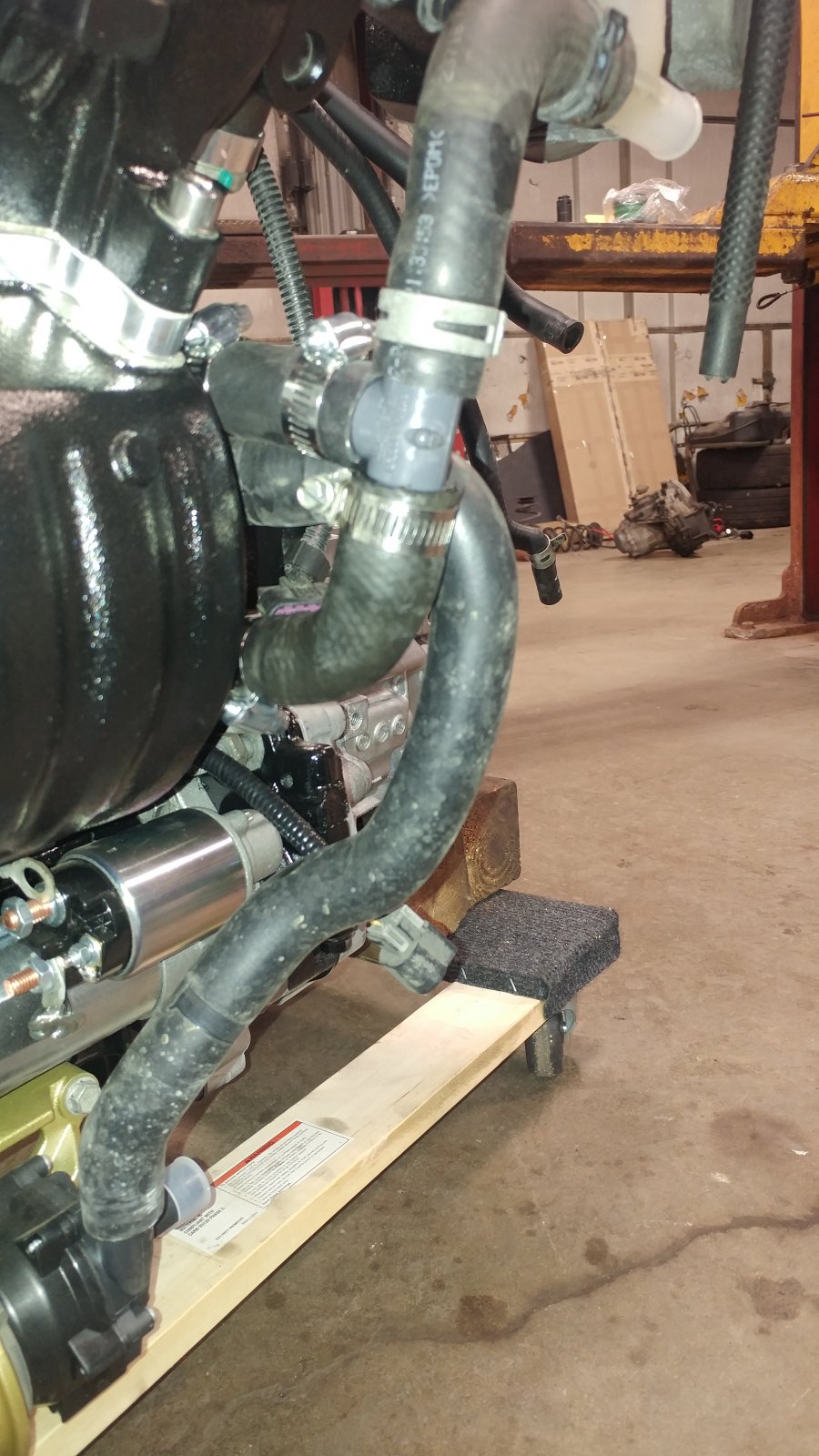

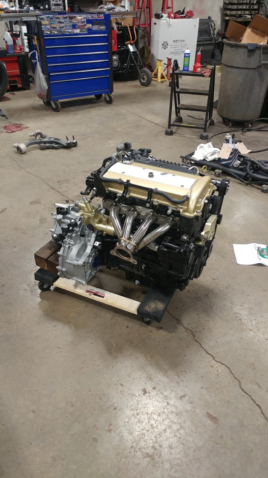

Got my engine and transmission mated, new flywheel, gmpp clutch kit, new f35. I found a hose for the dual pass that works perfect (just have to cut off one inch), its a heater core hose off a police interceptor utility. if anyone is interested I can get a part number later.
Subframe and some other partswill hopefully be ready to pick up from the powdercoaters Friday. Just have to finish the last wiring video and everything can go in

Were the bushing difficult to install? Do you need a press or special tools?
