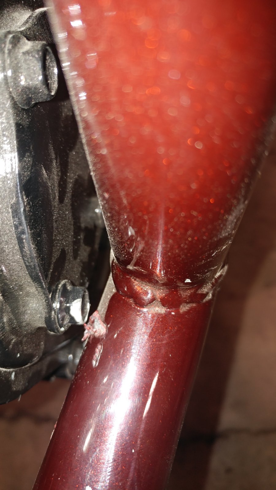

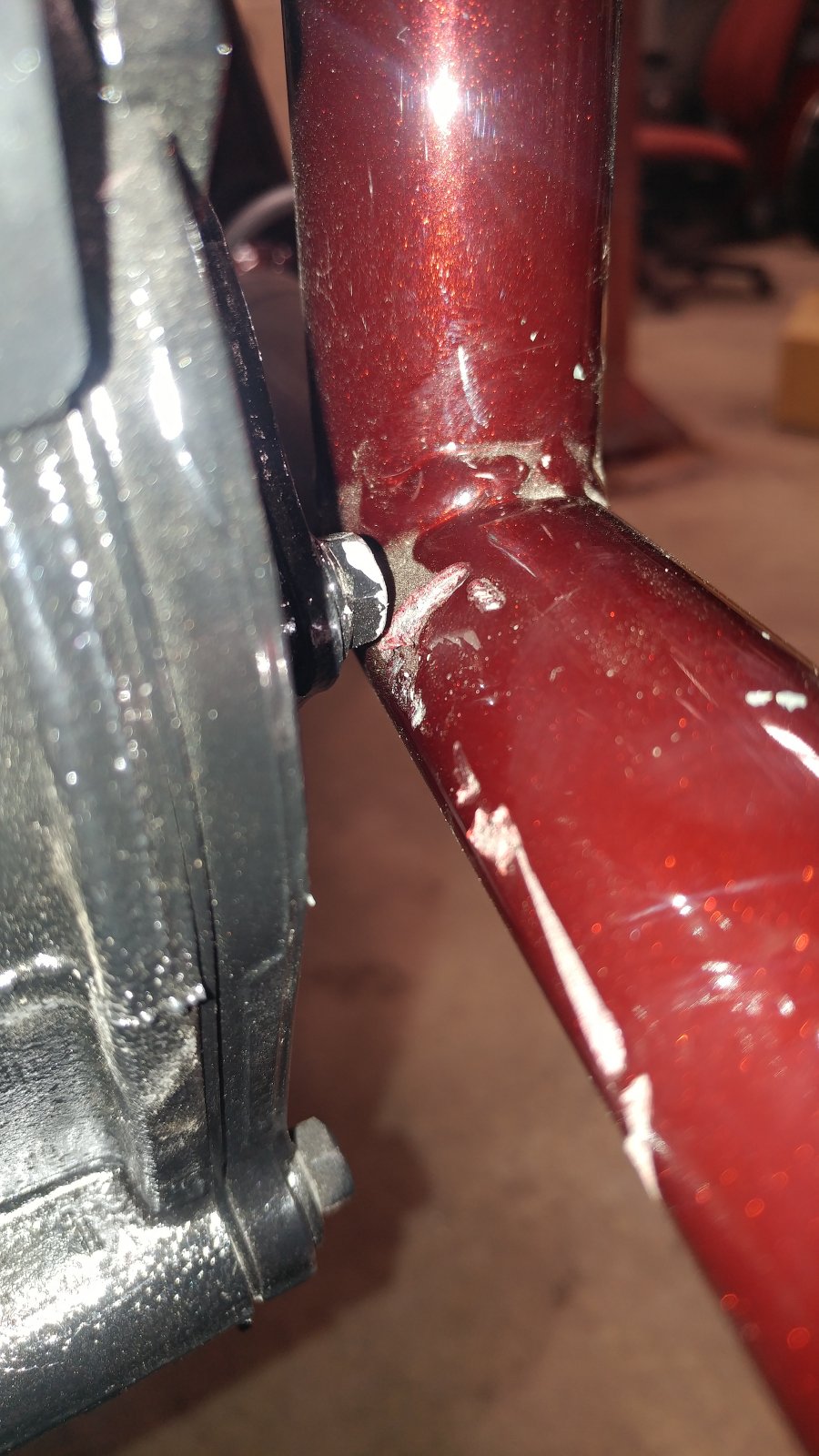

Anyone else murder their frame with the water pump cover bolts? Its in though.
Vwsaabvt
So sorry I would hate to have that happen as I’m very sure you do
Ehh, it probably won't be the last time.
Ouch. Powder coat? Maybe find some fingernail polish in the matching color? It comes in every color imaginable, is glossy and should seal the scratches against water intrusion.
yeah, powder coat. Ill find something close, It's not in a super visible spot anyways.

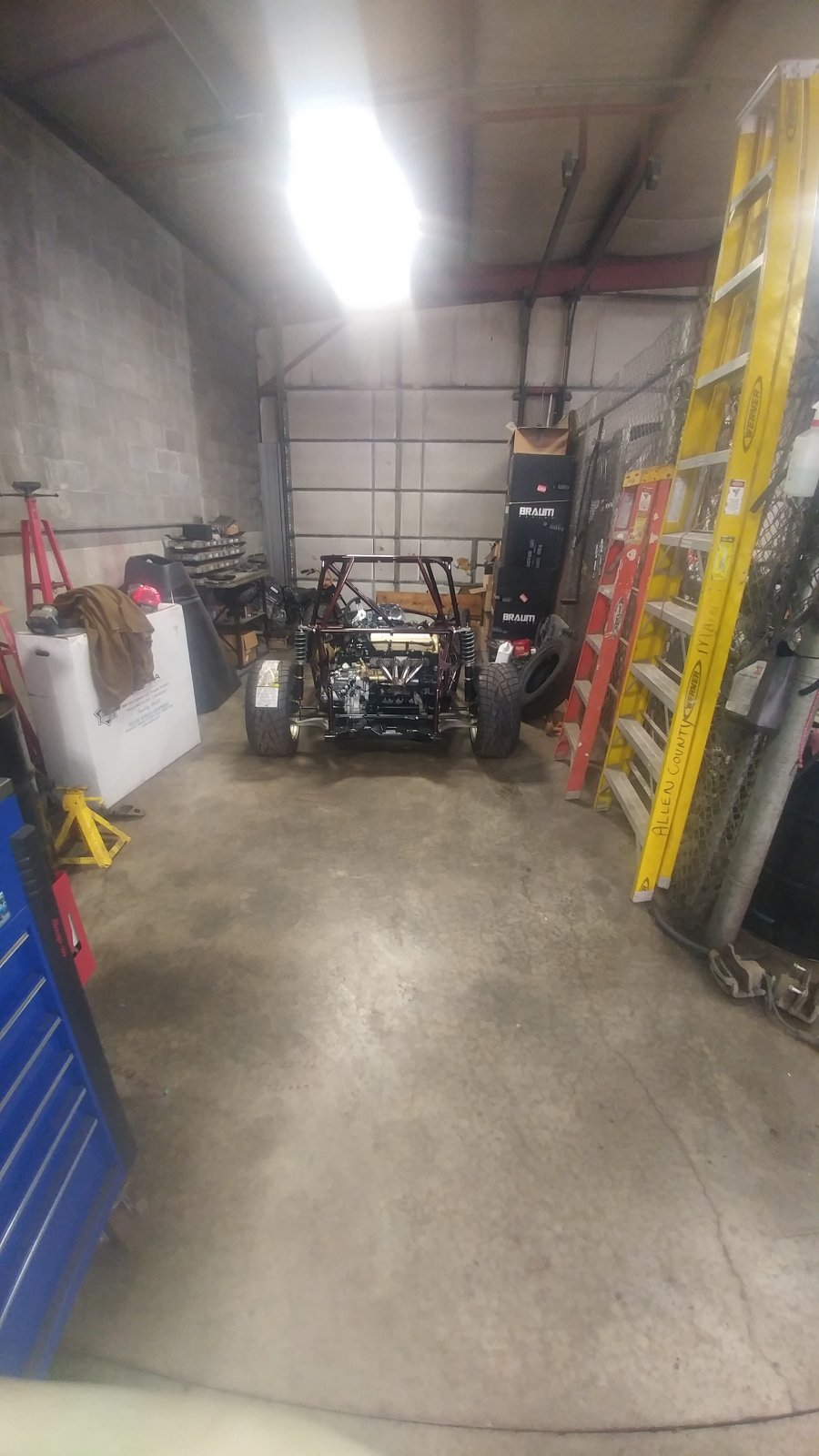

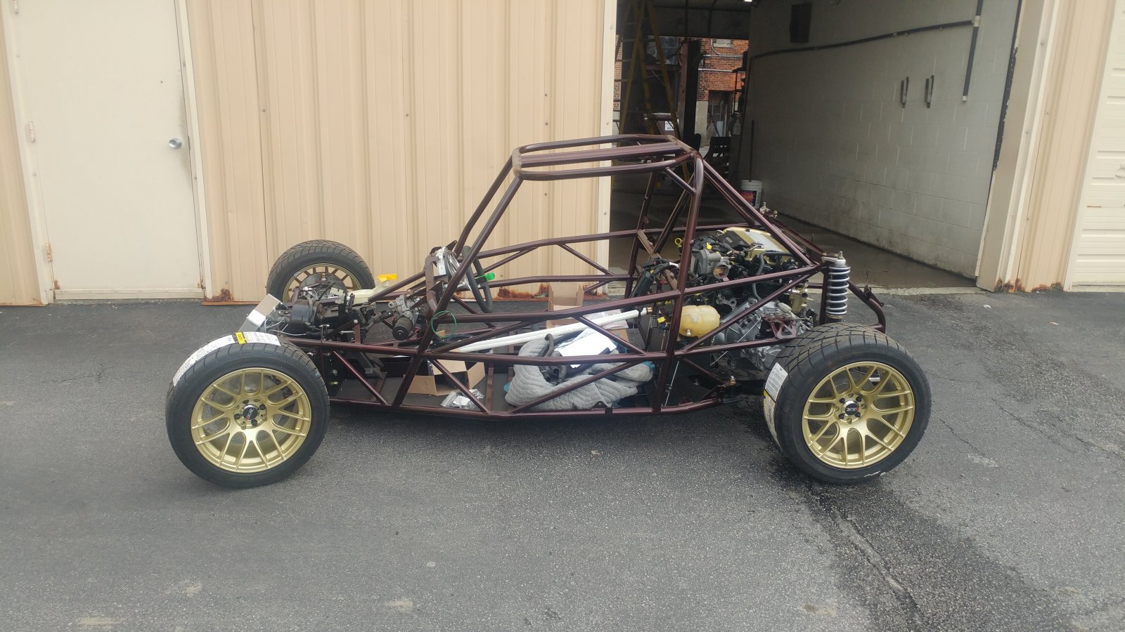

Haven't updated for a while.
I have it sitting on wheels, just have to get the brakes on and I can bleed the clutch and brakes then lay the wiring in. I picked up the same braided lines that Jeff put on his for the resevoir to master cylinder
Not gonna meet my goal for first start by the end of this month, but hopefully next month. I've been too busy working on everyone else's stuff to work on my own. So the goblin got pushed into the corner and is in timeout again.
The goblin was a good excuse to buy a truck though, since I am going to need to trailer it up to zzp by the end of the year hopefully.

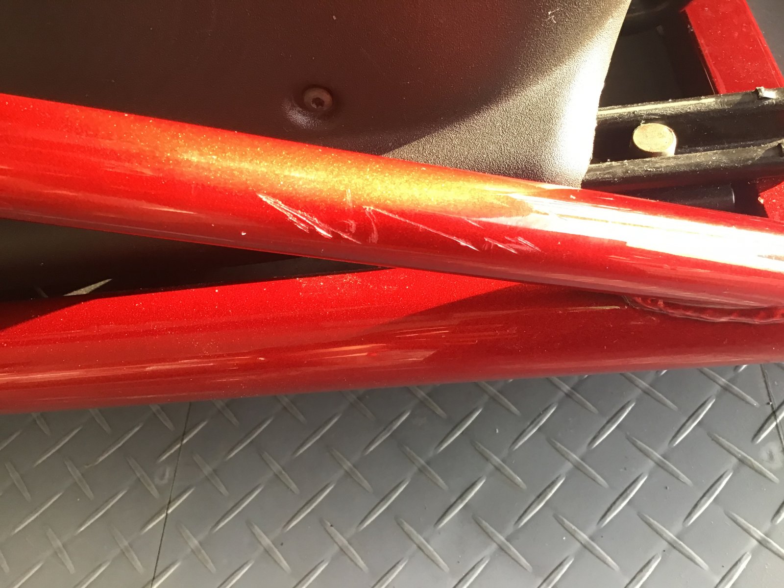

You will do something similar when installing the seats. Hard to avoid.
I scratched my powder coat doing the seats at least the side panels Will cover it up. Don’t even ask how I scratched the outside
I'm sure we've all got some little dings here and there in our powder coat. I managed to bang mine up a little bit on the return trip home from the powder coater, there was a speed bump and it managed to bounce the frame a little bit and my bungee job wasn't good enough to keep it off the front wall of the trailer.

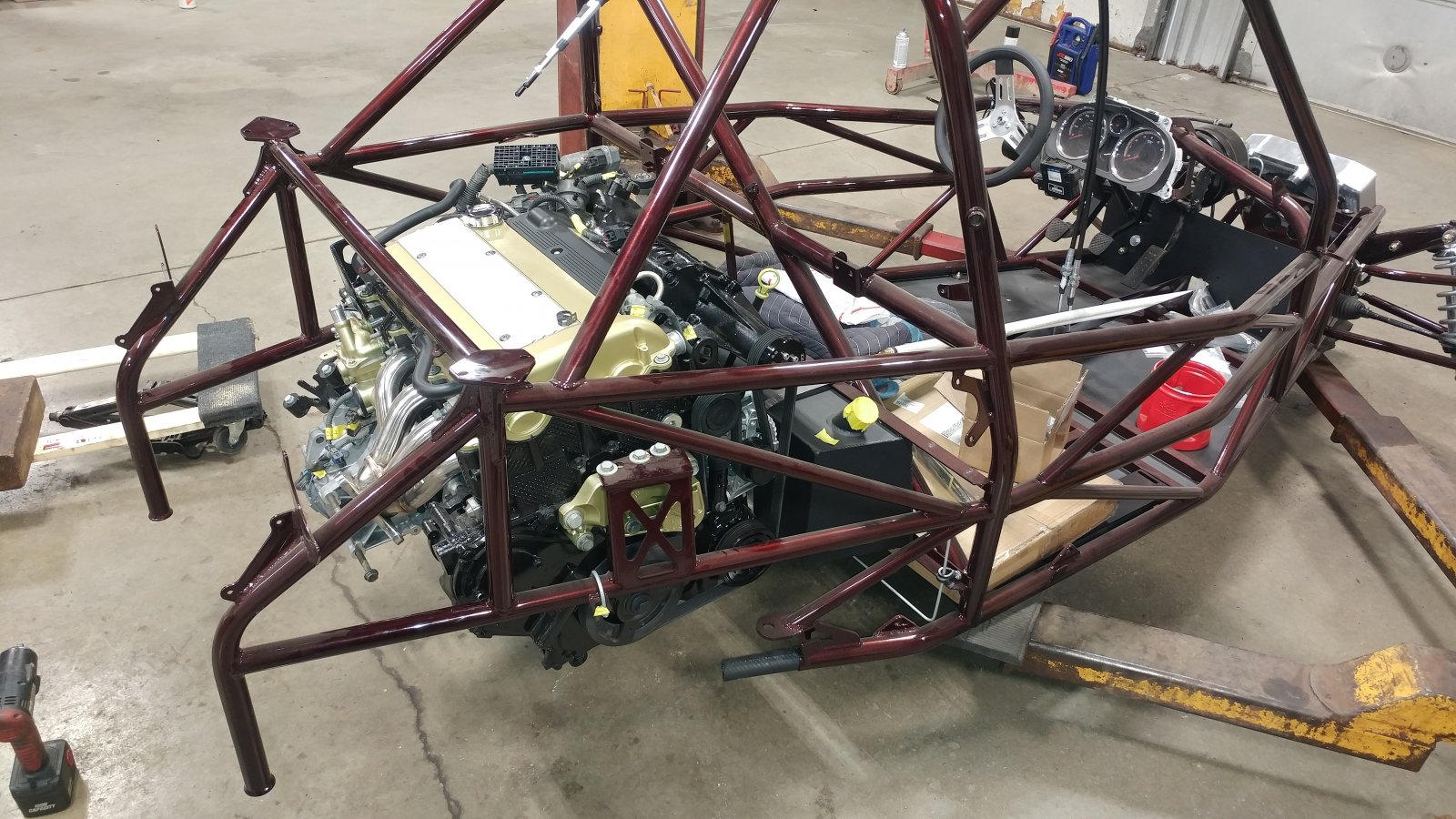

It runs, I posted to the facebook groups a while ago with the video too.
Wouldn't crank at first, found that I didnt have the engine grounded well enough. I'm going to run the ground cable from a bellhousing bolt to the frame.
After figuring that out it would crank but not start, I thought I may have put the cam sensor in 180* out of time, so I pulled that out and moved it 180* while pouring oil on my new transmission and painted engine.
Still no start, swap the coil harness with the other plug that fits the same, move the cam sensor back to where it originally was and hey it starts.
Now I need to get all my coolant lines plumbed, intake put in, install the tunnel cap, get the shifter all set and I'll be able to get my first drive.
Body panels are at the body shop for paint, the Ronies have my 5 point harness' held up in shipping for now. My goal is to maybe end up at the ecotechnation tail of dragon drive in October if work slows down. I've worked 10-12hrs days every weekday since May.

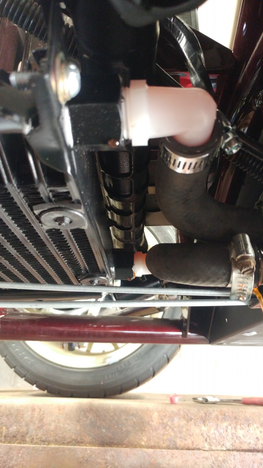

Well teflon tape didn't work for the heat exchanger fittings. Time for something different.
Vwsaabvt
I grabbed some permatex seal and lock.

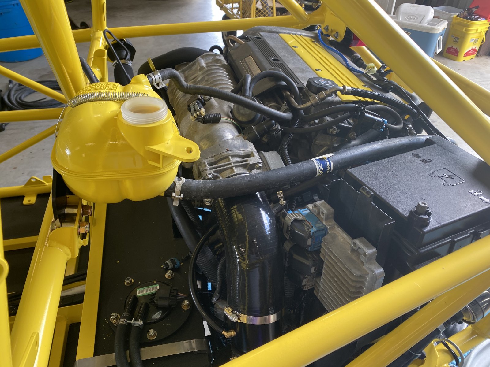

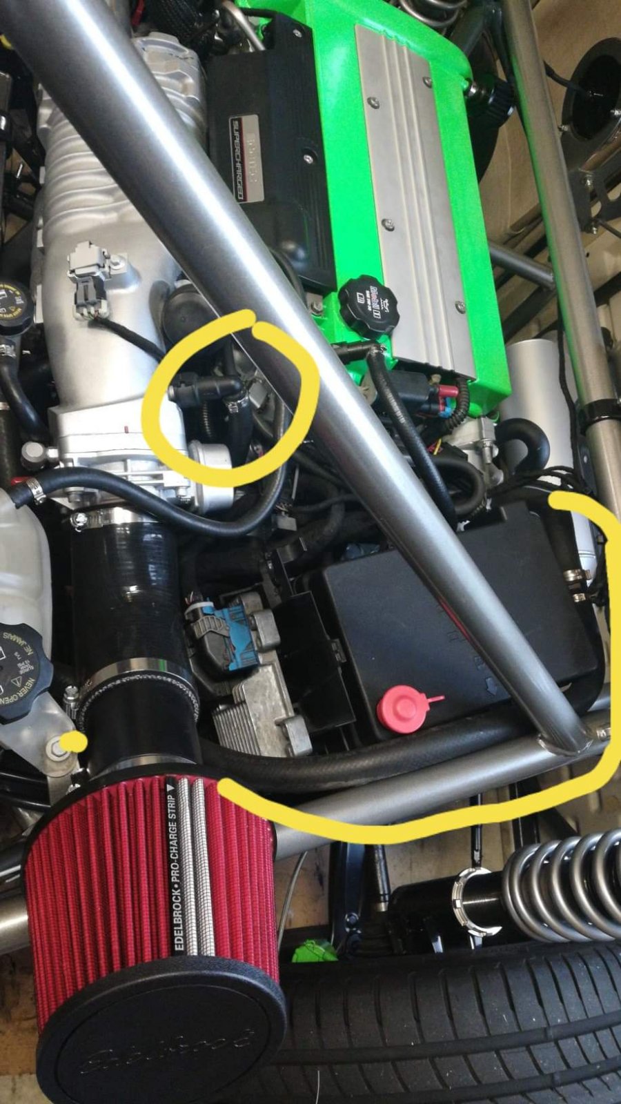

Where is everyone routing their hose from the thermostat housing to coolant reservoir? things are getting pretty tight on that side of the engine bay.
Murcielago311
I think this is one of those personal preference type items, but I ran around the fuse box and I like it. The area under the fuse box is kind of tight and wanted to keep the shift arms clear. (Ignore the brake booster circle in pic)

it looks like you have the same doner
I used an old Goodyear hose I had at the office. It’s a heater hose off a 98 c2500 Truck. goodyear got bought out by continental and I think they got bought out by Gates?
anyways the old Goodyear/continental number is 63936. Cut it down and it looks like it belongs there.
gates number 28471
