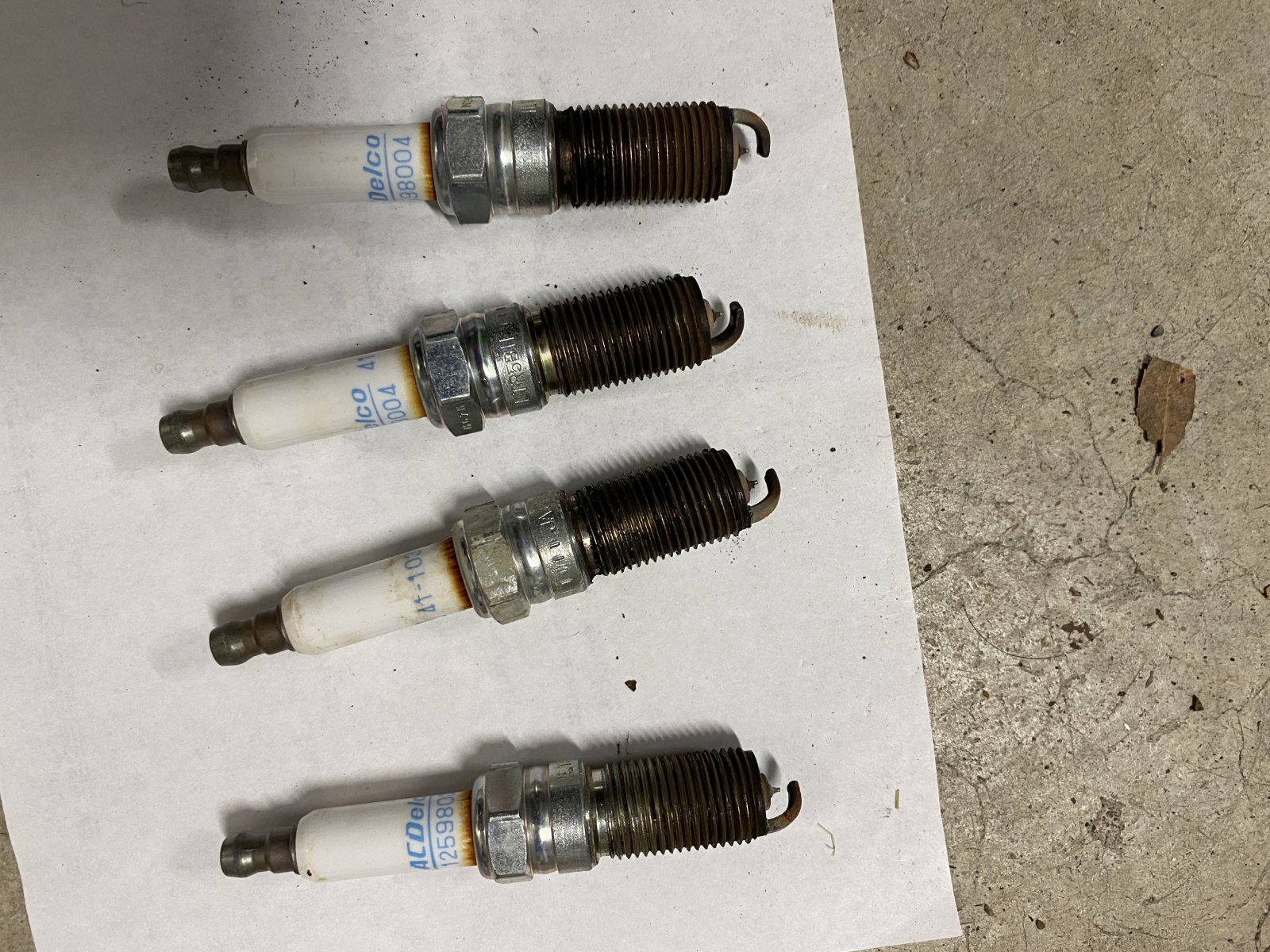

Anyone else think this might have been causing the misfires :D
16600
I swapped them out with nice new spark plugs, so hopefully that should be addressed. Also, I went and re-tightened the vacuum brake hose connections again. While staring at the engine thinking what else I could tighten down, I realized that I might have skipped a step from the videos, and going back, I had. Right at the start of video 20 (
) some 30 seconds in, we're told to cap the intake port. I'm staring at an open intake port on my engine. :( No wonder I'm having issues! Next trip to the store will require getting some sort of silicon caps to close that port off. Also will grab some throttle body cleaner and clean that out as well tomorrow night. This should hopefully clear up the issues.

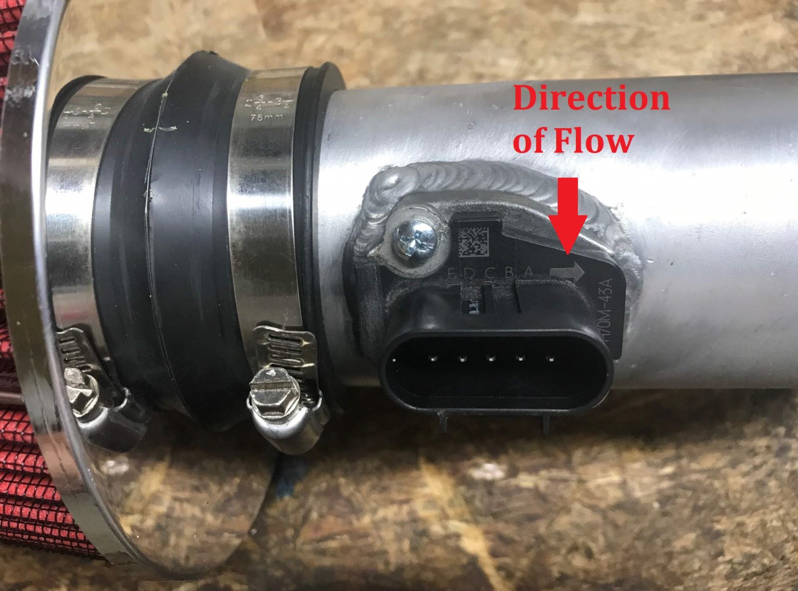

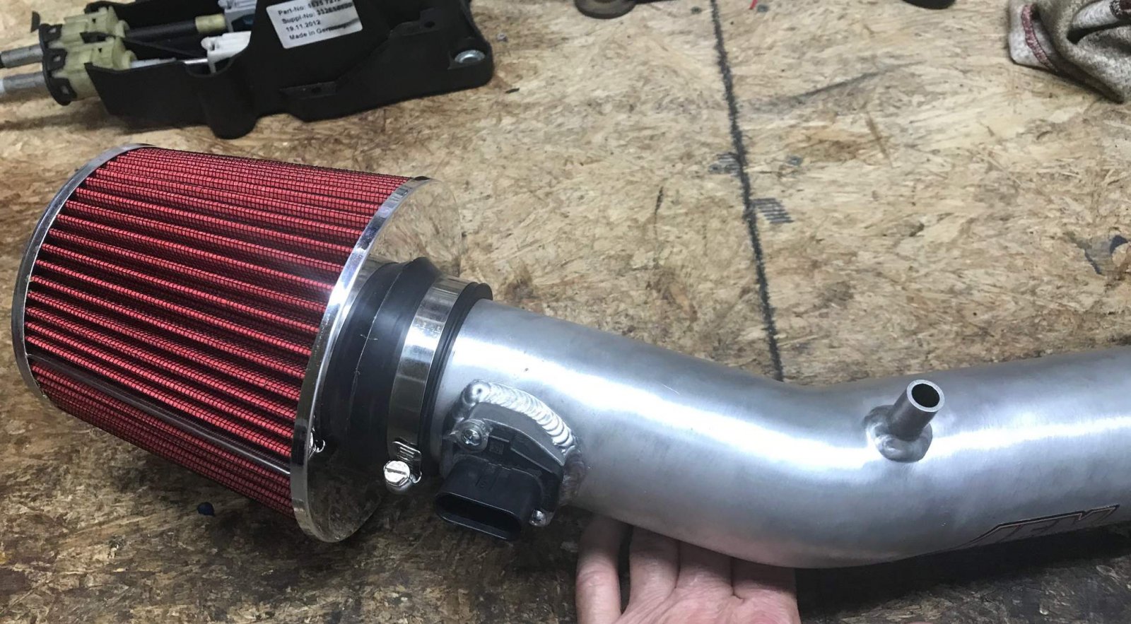

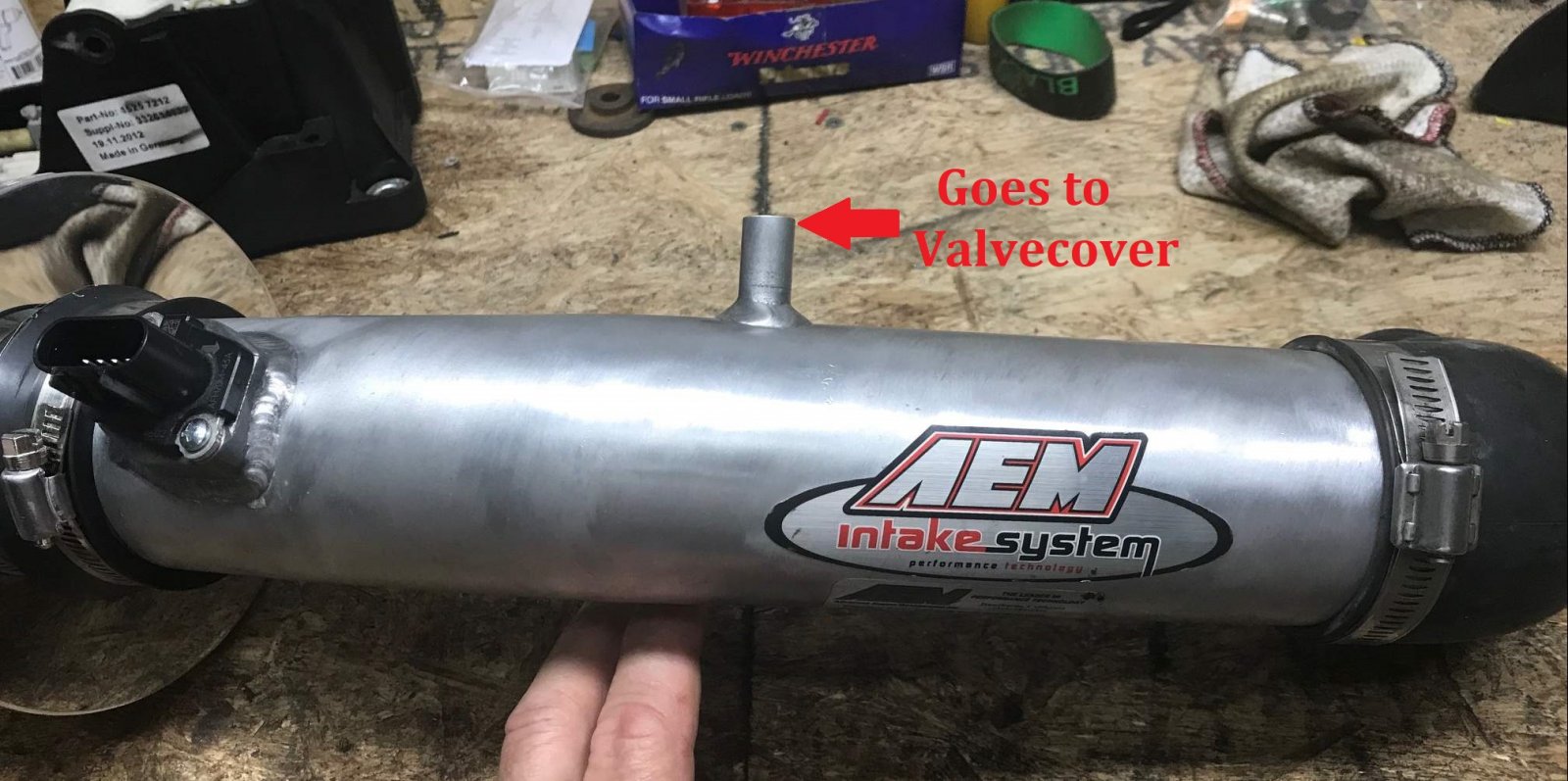

CaptFrank2001

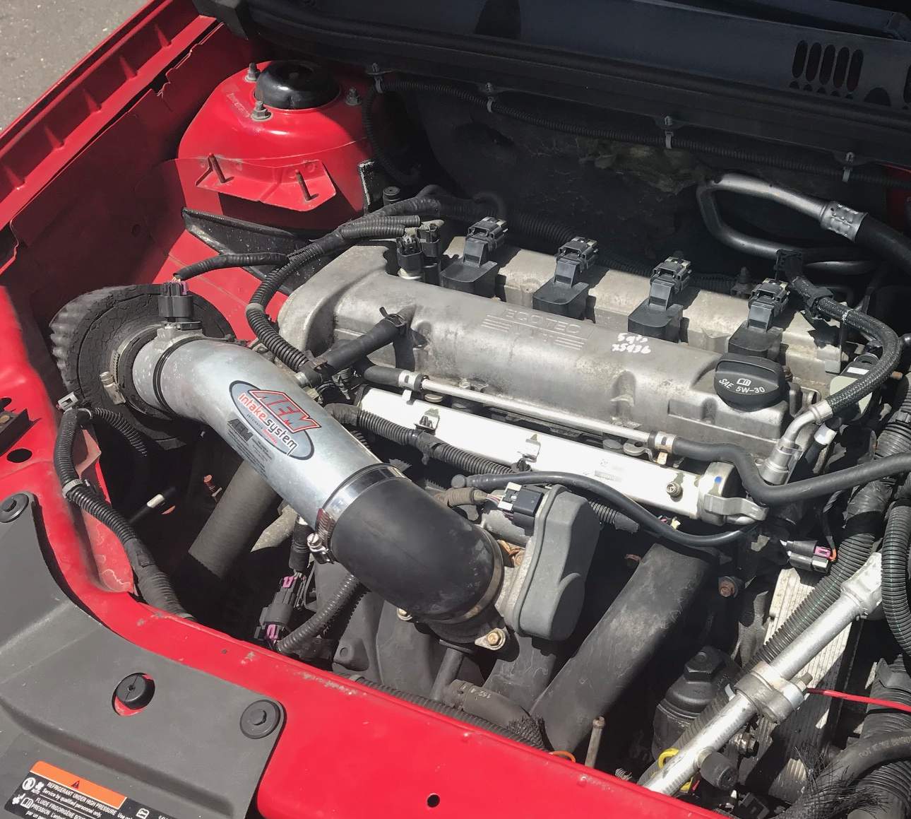

This was on my donor and will go on my Goblin. It's manufactured by AEM Intake Systems. The MAF sensod can not be put in backwards. The screws are offset and it can only mount one way. Also there is an arrow on the MAF (as shown) that shows the direction of flow. ON my setup the MAF is right next to the intake filter. The MAF needs an undisturbed flow of air so I believe that brass fitting just in front of it is not good. The breather goes after the MAF and not before it. As you can see there is breather port on the side that goes to the Valve Cover.
As I recall there is a rubber seal where the MAF meets the intake. I would make sure that is intact and not damaged. Good luck.

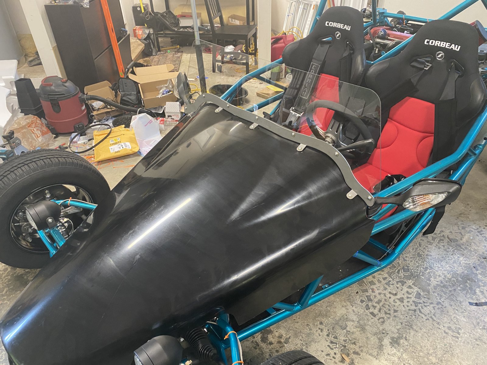

Hood and windshield installed last night:
When I drive the car over ~40mph it's very twitchy and wants to skittle all over the lane. Is this an alignment issue or is it an overly sensitive power steering issue? If it's power steering, would it be possible to add in a manual switch that controls power to the power steering on demand? Would there be an adverse impacts to cutting power and then restoring power to the power steering while driving? Or is this something that I need to get used to driving?
what are your alignment specs? I ran less camber all the way around and less caster in the front, than is what is recommended. It seems fine up to 70 or so going down the freeway. I did -1.0 camber all the way around and (roughly) 8.5* caster.
Anks329
Ok, I’ve rechecked my alignment (I followed the instructions in the forums) and my caster off in the front. Fixed that and I’ll go on a drive tomorrow morning to see how it feels.
I did get the hood and windshield installed, so looks much better now!
16703
Anks329
Woah.. fixed the steering issues, handles beautifully into the 60s this evening. Also the misfire and idle issues are cleared up. Here are current faults:

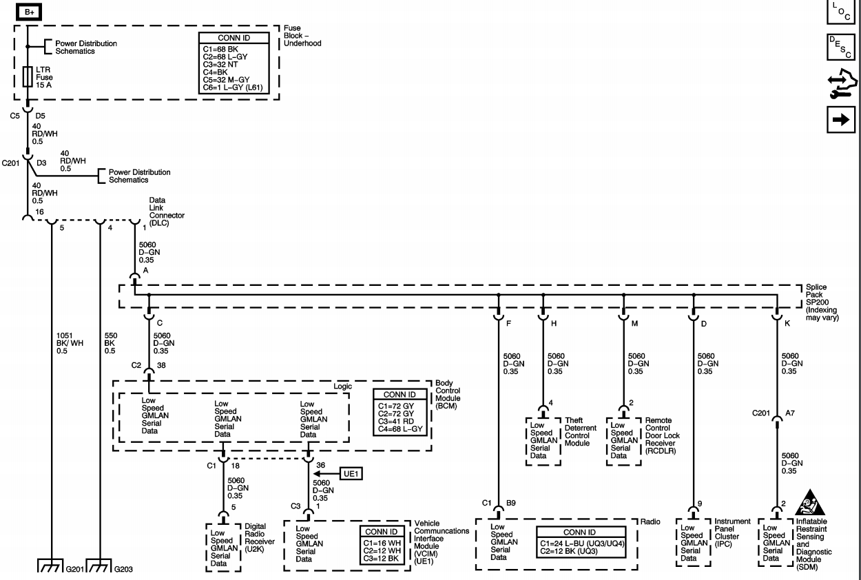

I've been trying to track down my panel issue. I've tested that I have continuity:
  • from pin 9 on the instrument panel to pin 1 on the data link connector
  • from pin 9 on the instrument panel to pin 38 on BCM 2
  • from pin 1 on DLC to pin 38 on BCM 2
BCM 1 is what is giving me problems. According to the alldata info (for a 2006 SC) and Chilton Library (for my 07 LS) I should have low speed GMLAN on pin 18 and pin 36 on BCM 1, but I've got nothing there; the pin is empty. So, tracing that further back, pin 18 should be connected to a "Digital Radio Receiver" and pin 36 should go to the VCIM. Neither of which were in the original donor car.
17198
So, what am I missing here? Should I wire pins 18 and 36 into the panel anyway? Or I saw elsewhere that the back of the BCM has a screw hole that should be grounded. Or is this a gremlin that coming from something else?
Thanks!
CaptFrank2001
Really need to re-check your grounds. Be absolutely sure no paint (or powder coat) is under your grounds. Scrape it off. The ground itself will cover the missing paint. Some things can operate with a marginal ground and others will not. A good ground is critical.
