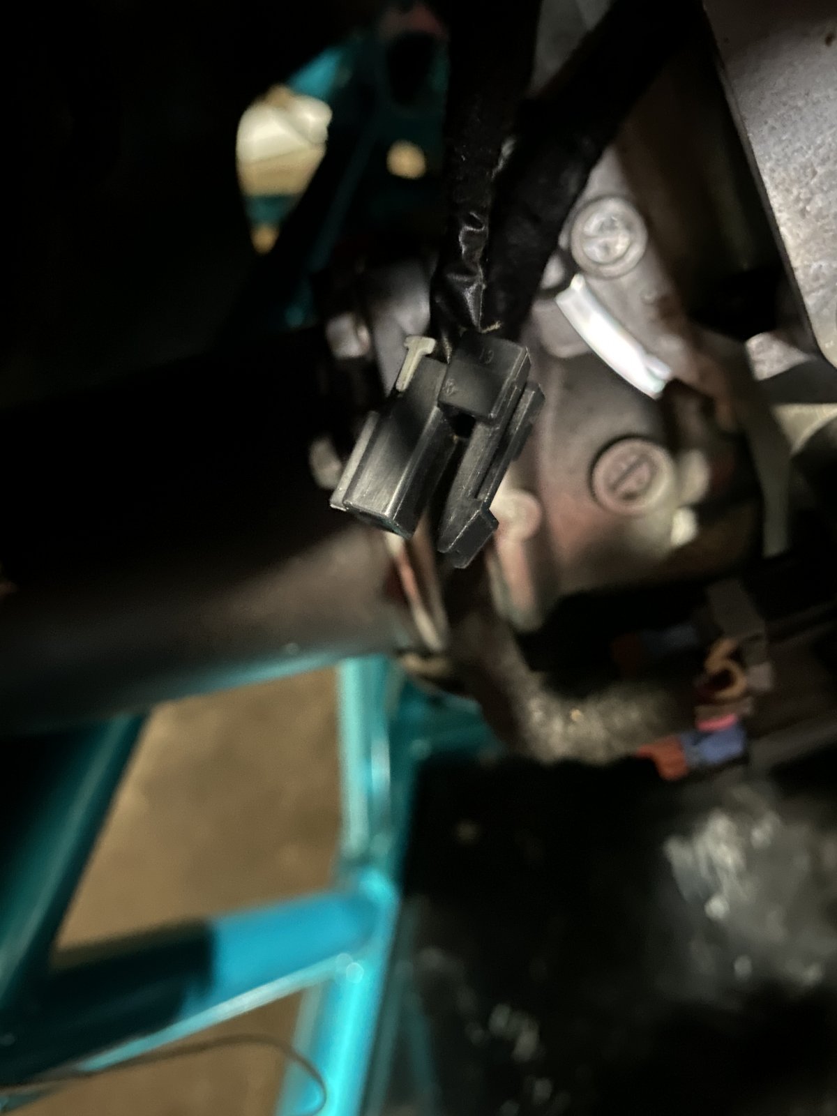

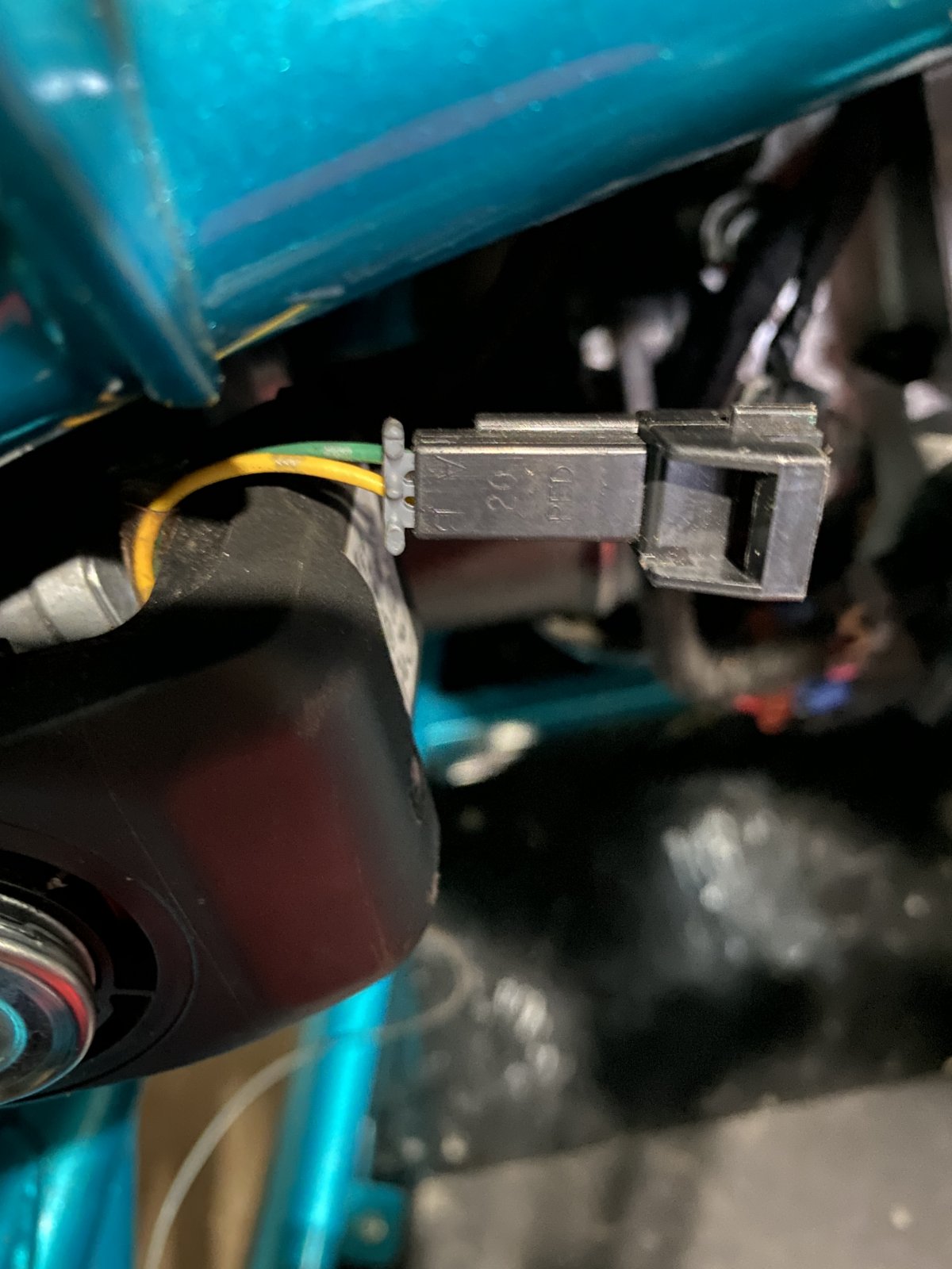

Next up was testing @bradr starter adapter to build a push to start system. It didn't work exactly how I wanted it to work, and in my troubleshooting, I unplugged some wires from the ignition/key area and my instrument cluster started working again! Buttons work, speed, rpm, odometer readings, everything is displaying again! I went for a test drive, and no issues with keeping these wires unplugged, but I'm trying to figure out what they are for, and what I might have possible done to mess up my instrument cluster in the first place?
Here's an image of what I unplugged:
19358
And here is what I get plugged into on the ignition/key area:
19359
My only guess is that I might have accidently soldered the green wire together in my low speed wires and it's actually supposed to go somewhere else. So having it plugged in confused the instrument cluster (but not my ODB2 reader), and having it unplugged clears up that issue. Any thoughts on what this might relate to?

Green and yellow wire near the cluster should be the ambient light sensor.

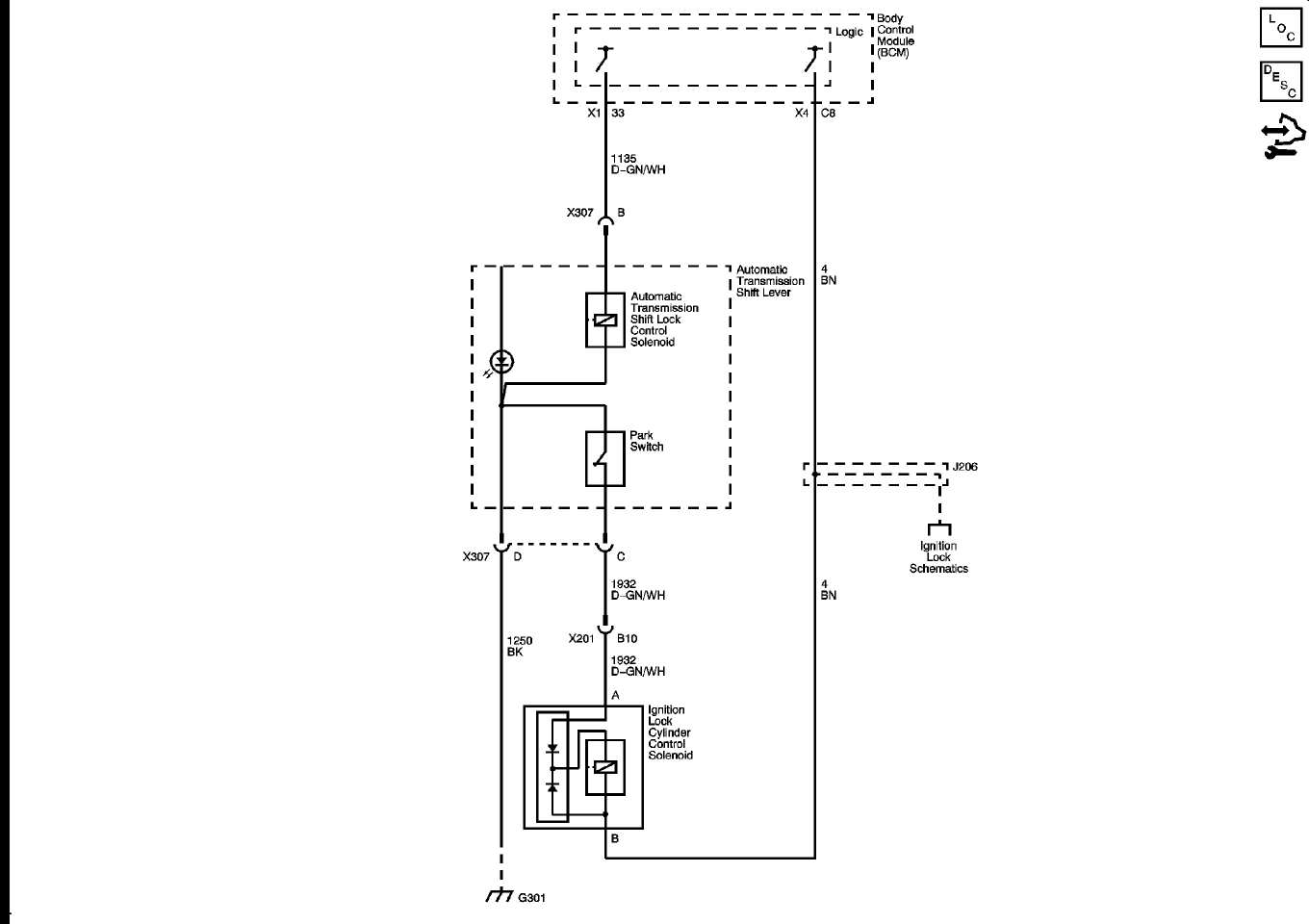

That’s actually the ignition lock cylinder control solenoid. Here’s the schematic.
Any problems taking it out of park with it unplugged?

Goblin Graber
Those wires do two things. They unlock your ignition so you can take the key out then feed power to your shifter to unlock it when you step in the brake.

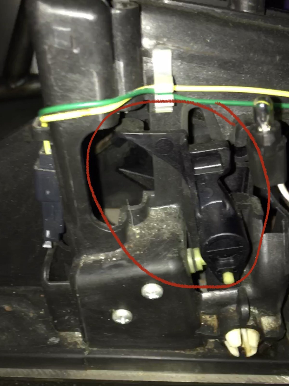

Does your shifter still have this piece circled in red? I haven’t put the DF parts in my shifter yet but I have a feeling you get rid of it.

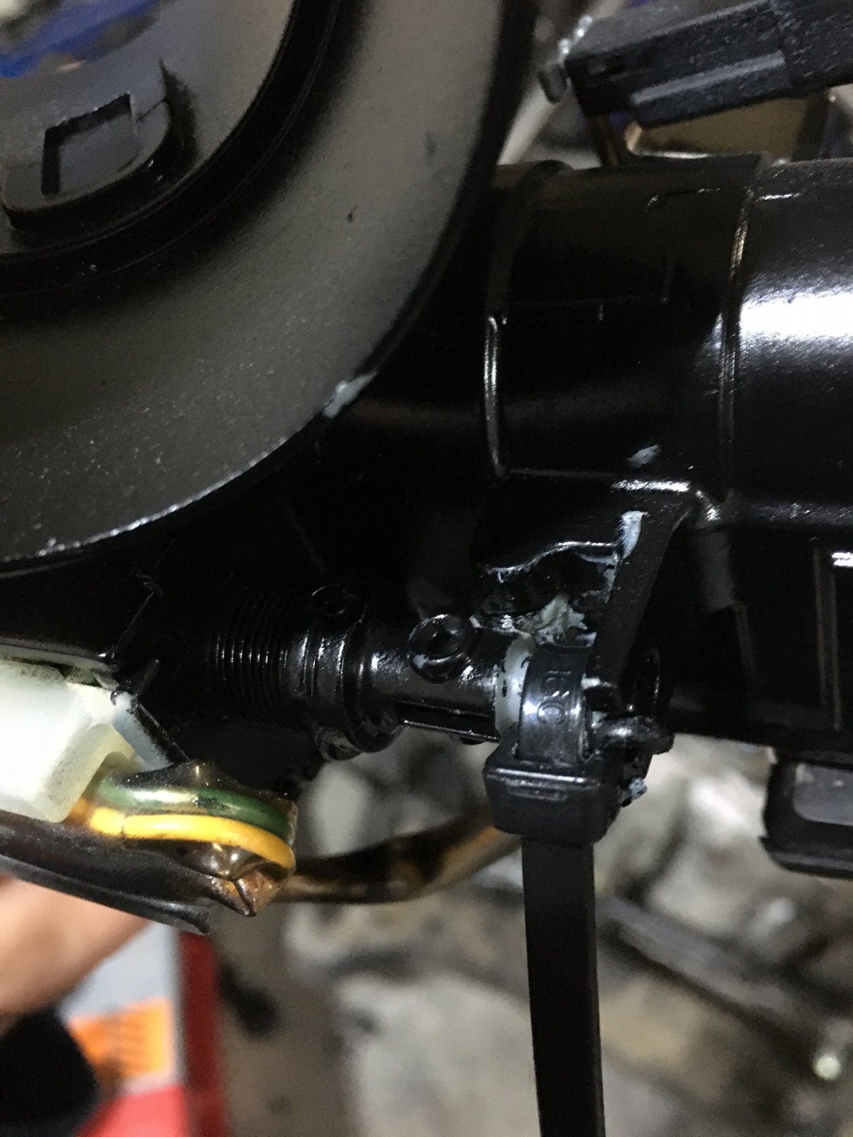

The other part can easily be bypassed with a zip tie on the ignition switch. Just slide the lock back and put a zip tie on it. Now you don’t need to hook it back up
k.rollin
I didn't remove that part when I modified my auto shifter. The new arm is a bent steel weldment rather than a machined aluminum piece, but the installation is essentially the same.
Anks329
Ah! That's gotta be it! I always had an issue taking the key out of the ignition, and have been manually pressing that button to get the key out. Thanks for the diagram. Honestly, fixing this will be pretty low on my task list, maybe when I'm cleaning up the wiring in the front for the USB chargers I'll pull another wire from the BCM to this connecter and see that solves the problem. And as @k.rollin said there's no real change to the auto shifter in the Goblin vs the Cobalt.
