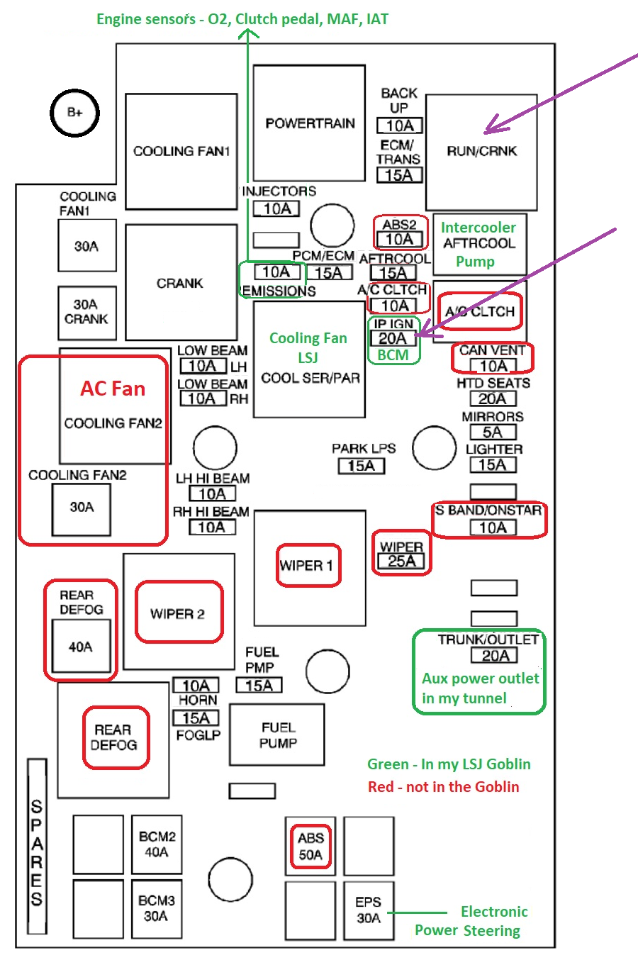

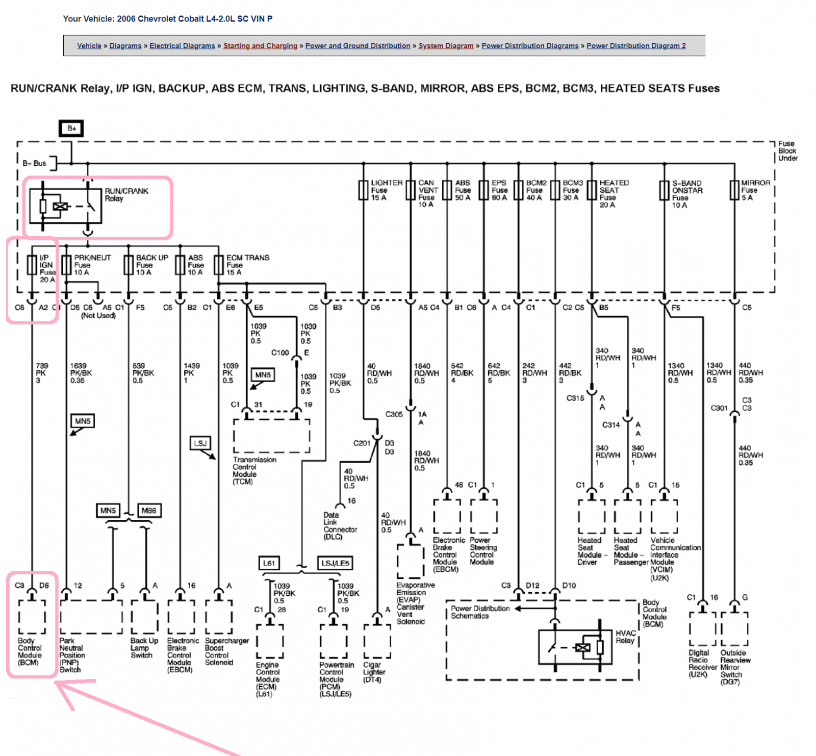

Looks like I am back to my original question, how should I poke the wires coming out of the bcm and fuse box multiplugs if they are plugged in when the car is turned on?

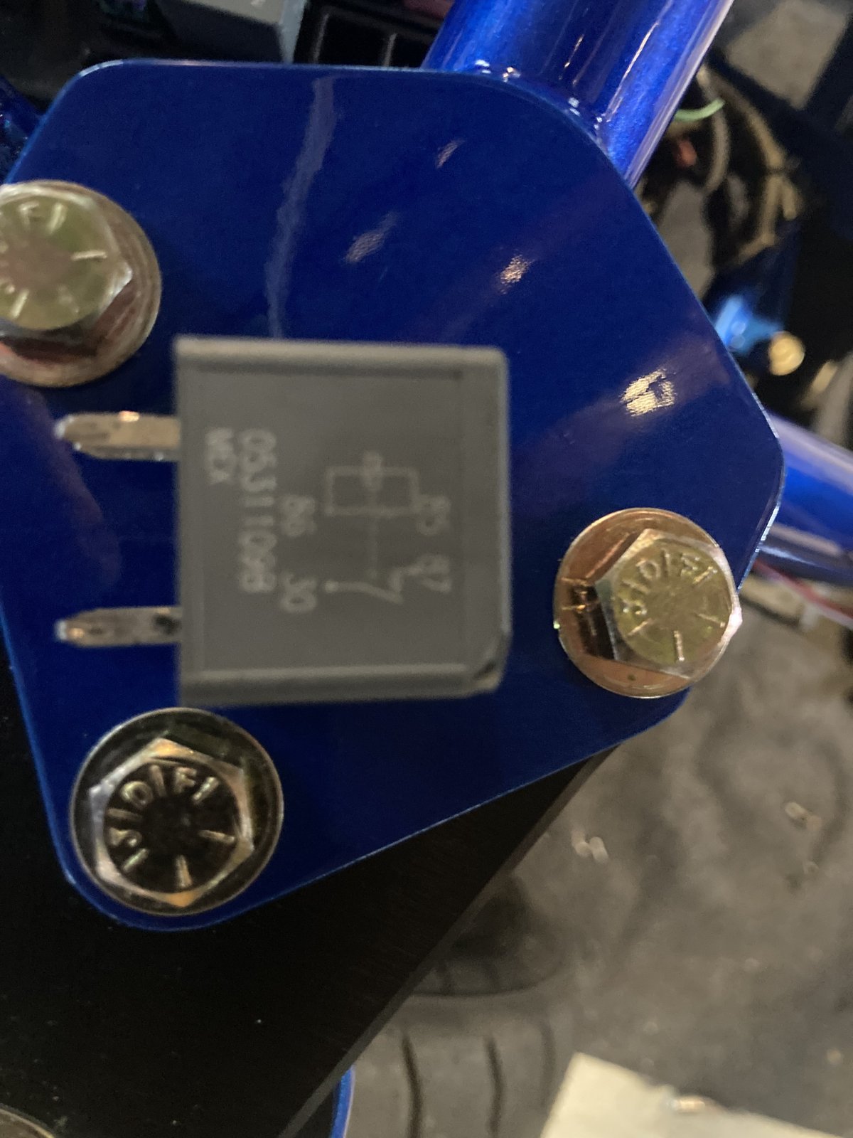

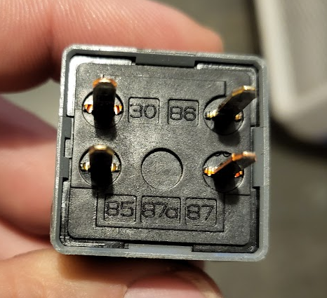

you can swap the crank relay with another relay in the fuse box that is the name part number and see if the problem changes.
