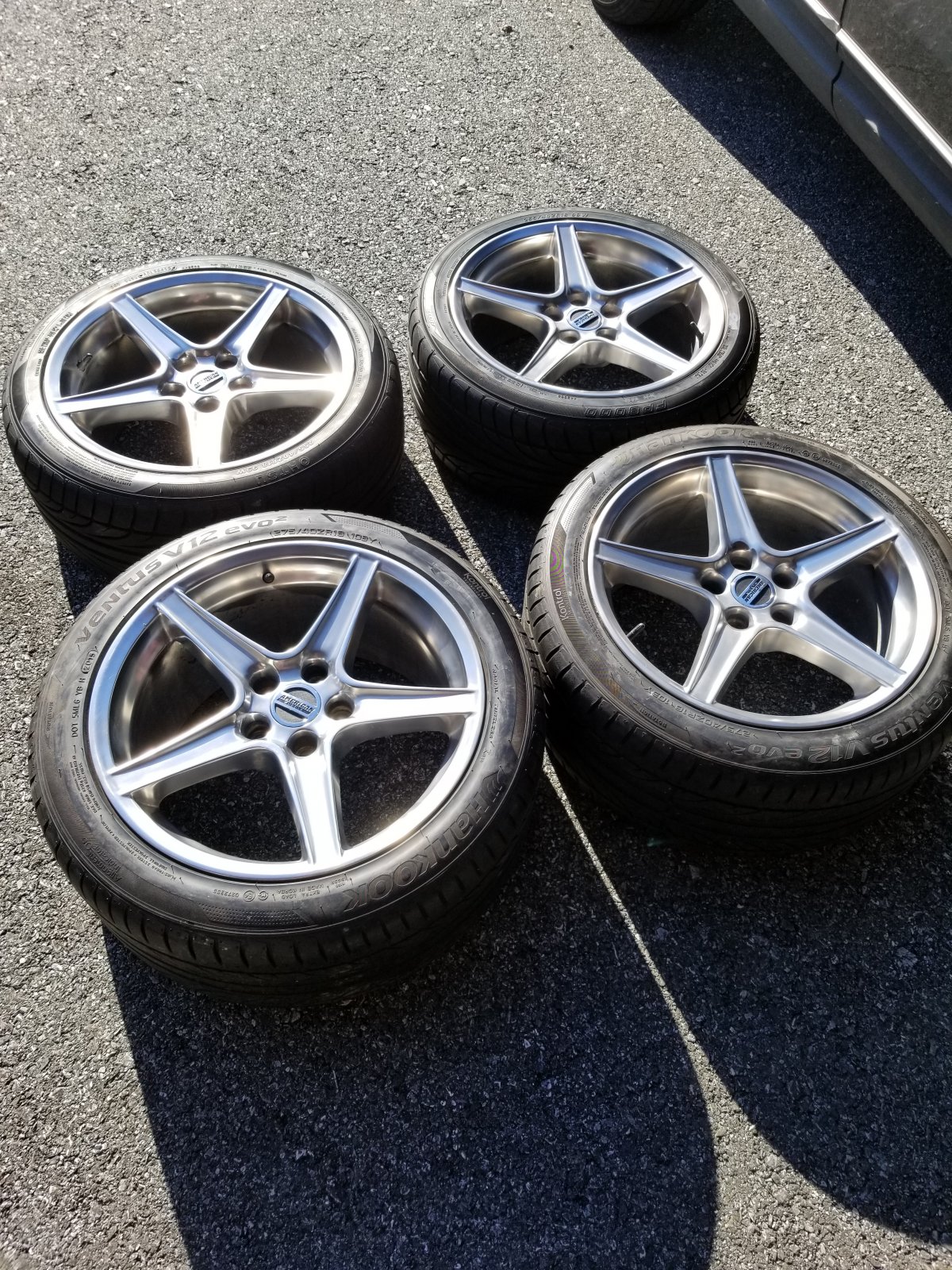

Today was a nice day outside so I figured I'd fix a mistake I made a month or two ago. I had my wheels/tires stacked on top of each other in my garage, and I stupidly used that as a "table" when I was de-rusting a bunch of hardware with Metal Rescue. I spilled some of it when I moved the pan I had all the hardware soaking in, and it dribbled down the inside of the wheels. I didn't realize how badly it would mark the wheels at the time, but it sure did. So I took the back wheels out, used abrasive aluminum cleaner and a 3M scuffing pad, and scrubbed the marks off, then re-polished them. Turned out pretty good.
Tomorrow, I'll do the fronts, then I'll piddle around seeing what else I can do while awaiting the next wiring harness video.
*edit* Finished them up today so here's a completed pic, instead.

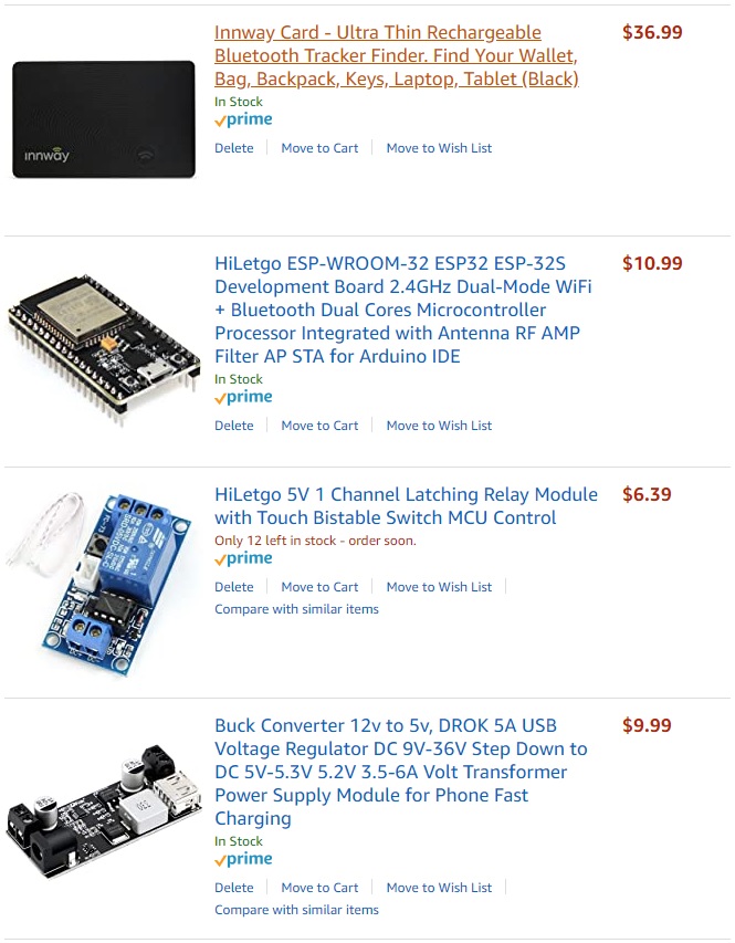

All that being said, in my Amazon shopping cart currently is some stuff to develop proper security for the push-button starter. I'm not sure I'm going to go on this without Bradr's PK3+ disable actively being in my hands, but the price isn't high so I might just do it for the experience. I will need other odds and ends (some wires, a case, maybe a breadboard?) but yeah.
So I ordered the above stuff, and will start developing my keyless start solution as soon as I get it.

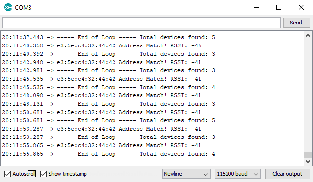

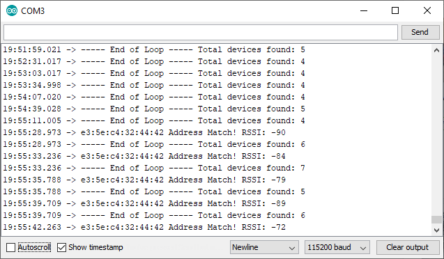

What you're seeing is the code on the ESP32 looping. Every loop consists of the ESP32 scanning all available Bluetooth/BLE MAC's, until it finds one that matches my hard-coded beacon MAC or until 30 seconds pass, whichever occurs first. Once the loop completes, the ESP32 writes a string via serial to show that a loop has completed, and a quick enumeration to express how many different Bluetooth/BLE MAC's it detected during that loop, even if they are not matches. If a detected MAC matches my hard-coded MAC, it exits the loop immediately and displays notice of a match, and the RSSI (signal strength) of the matched MAC, with "lower" negative numbers indicating a stronger signal.
In the first screenshot, you're seeing the output while the BLE beacon was out of range, then more while I slowly went and moved it to within range.
Then in the second screenshot, you're seeing the output while the BLE beacon is sitting right next to the ESP32.

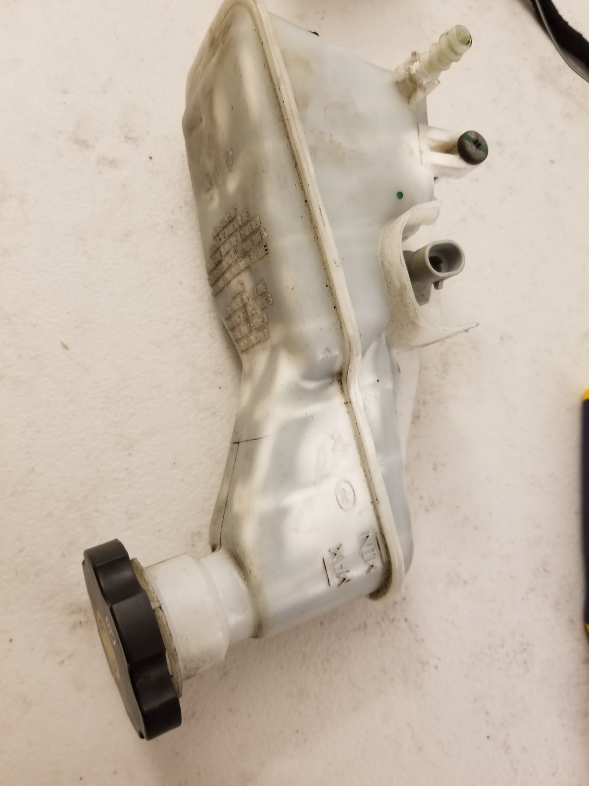

Is there a good/safe way to clean this thing out? I'm thinking remove the sensor, and soak it in a sink with something like Dawn dish detergent. It's really gross inside.
