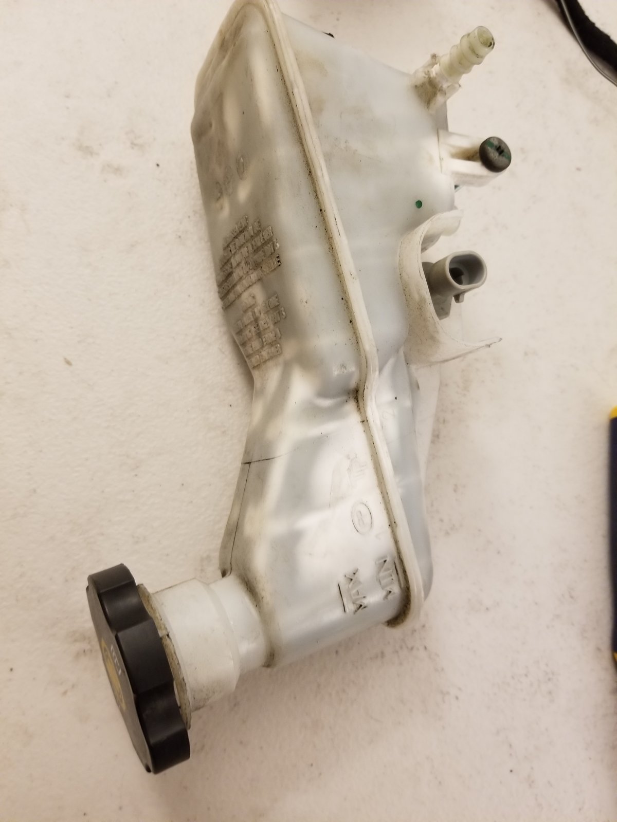

You get a new one with the kit don’t you.
I cleaned my out with Zep full strength, Turned out very good. Before I read you get one with the kit
I don't think you get a new reservoir with the kit ... only an adapter kit to move it and face it the opposite direction, for hood clearance.
*edit* On that note, I forgot all about the half gallon of concentrated Zep I still have in my garage. Good call on that, it worked great!

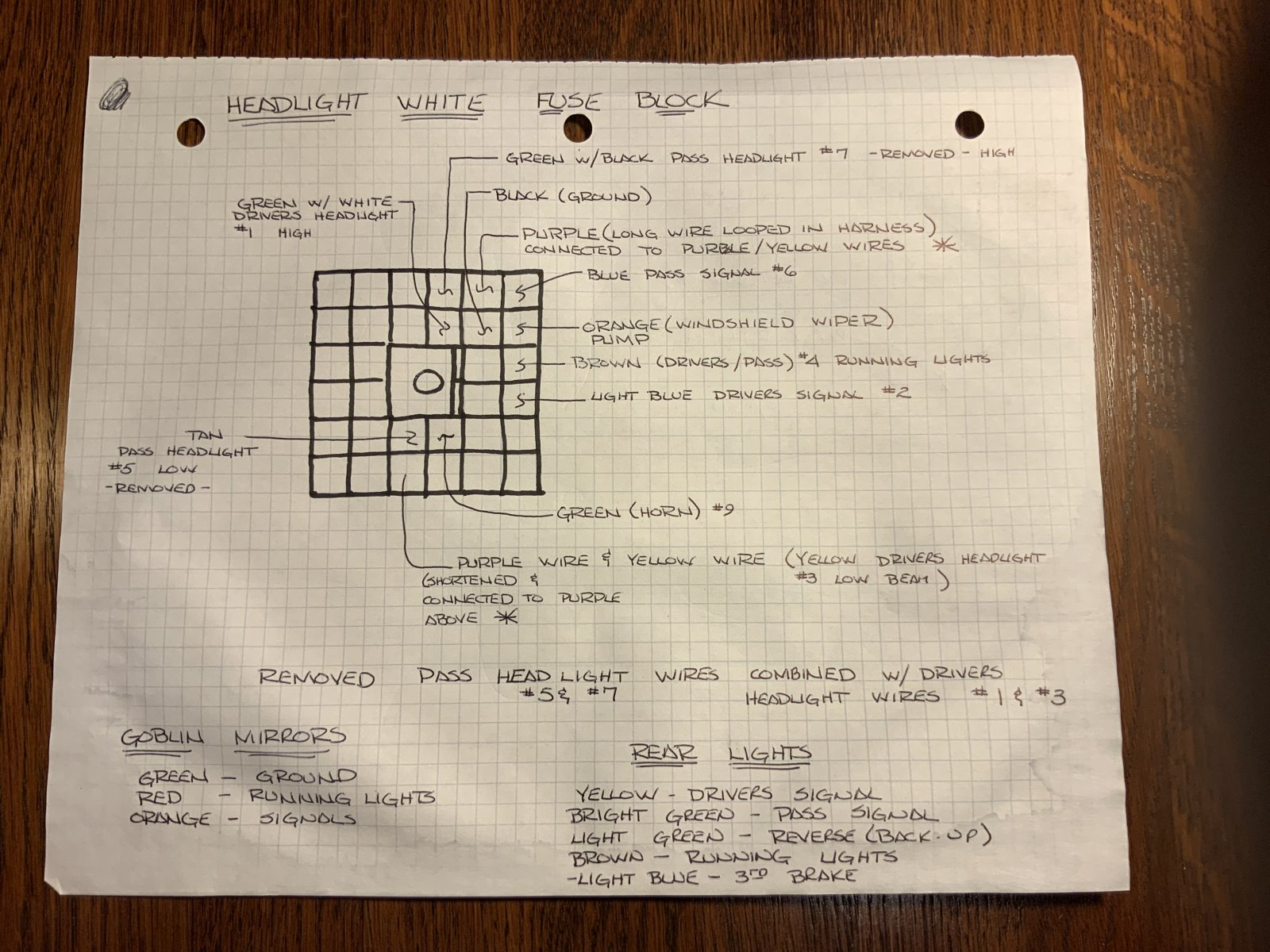

Some months back, when I first started working on my first set of wiring from the 07 donor, I reached a point in the old videos where you extend the clusters of headlight wires. At the time, I didn't have a whole lot of different LONG wires to choose from to extend them, so I did not match up the colors. I also didn't bother to make notes on what color extension matched with which wire. BAR-AIR to the rescue.
12957
His well-done notes helped me determine what was what, using the headlight harness fuse block connector and a continuity tester. Yes, I made good notes of my own this time around.

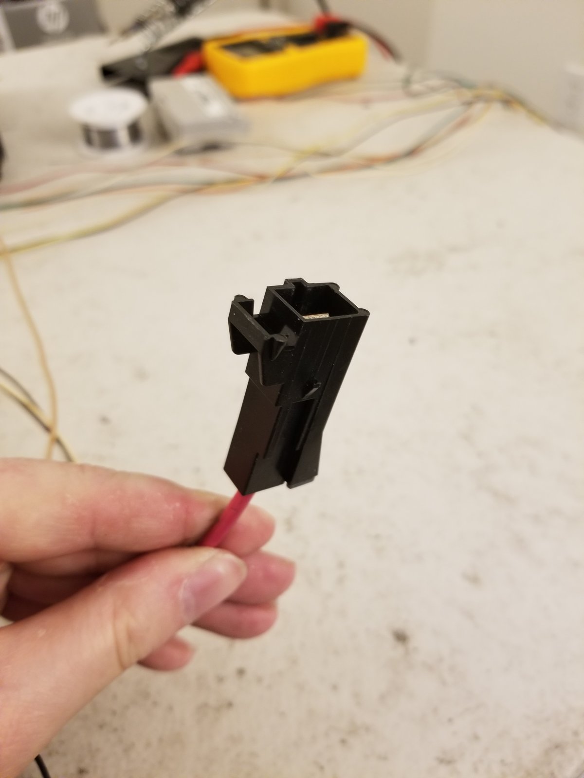

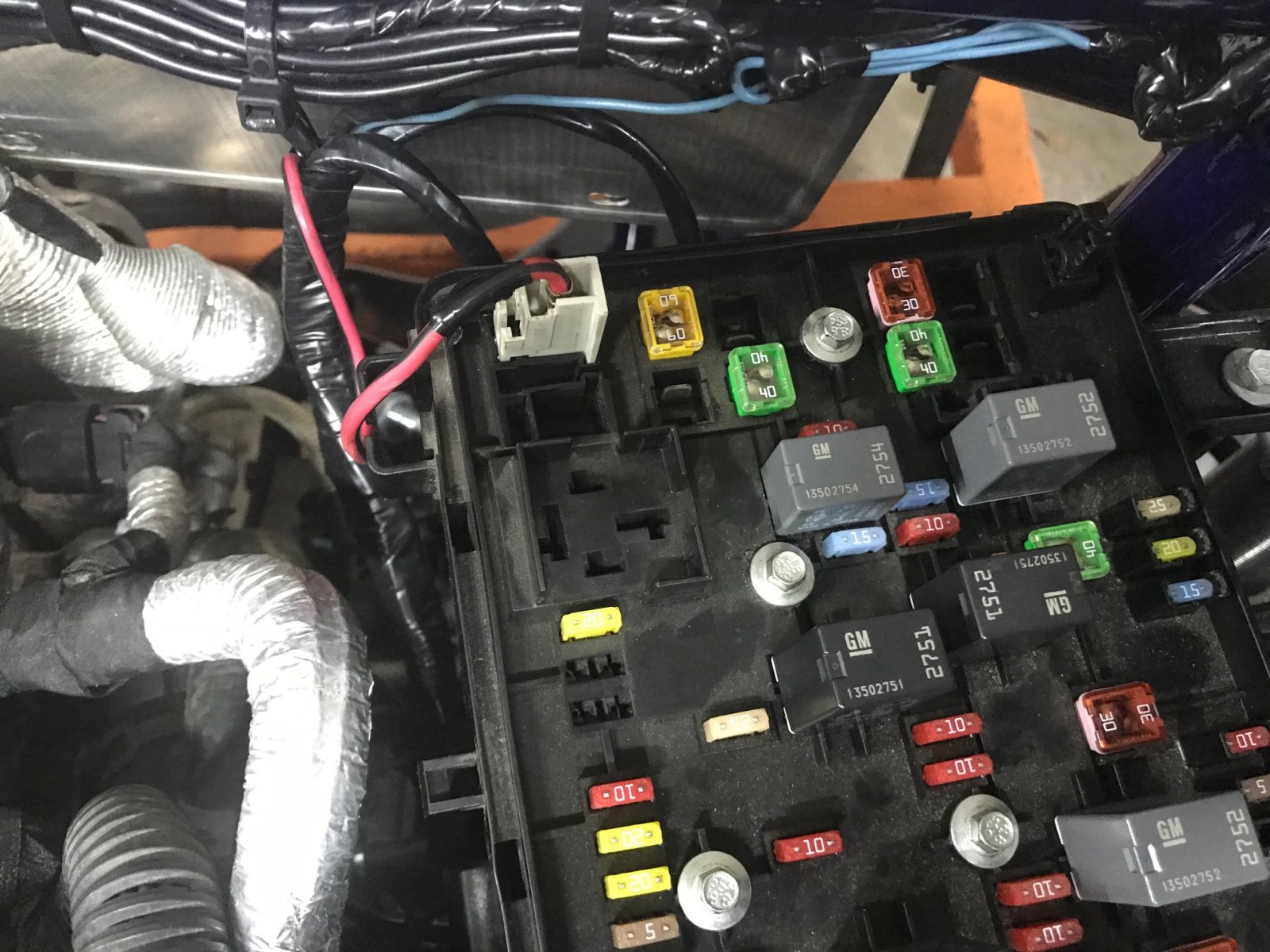

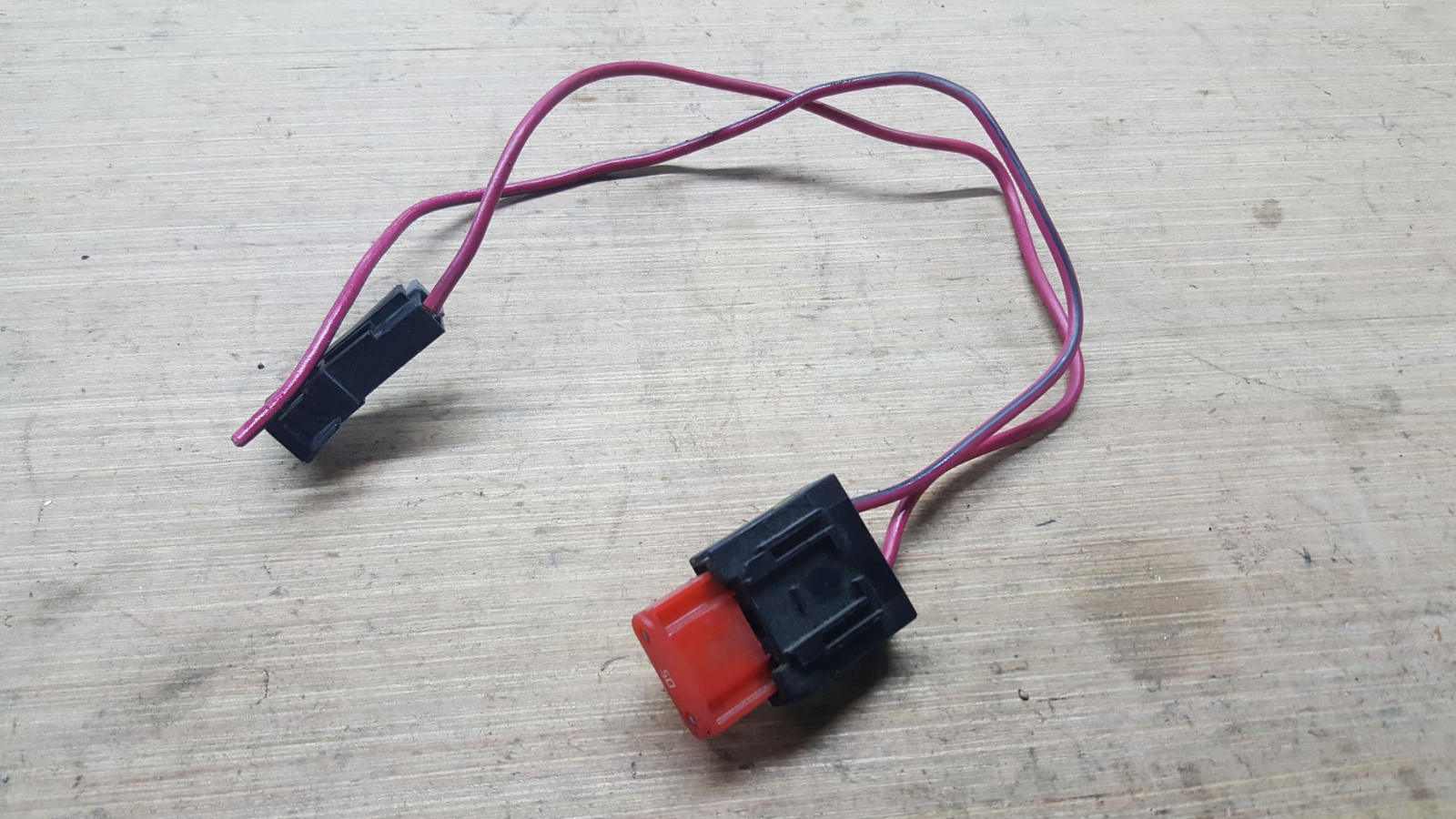

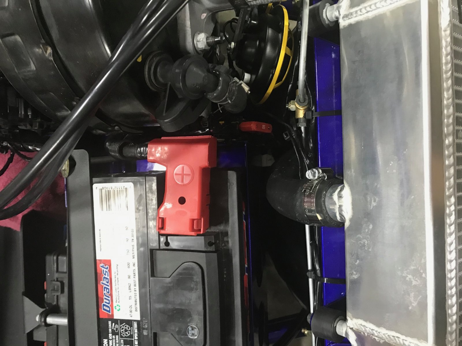

Oh, one other thing. I think I have been staring at wires for too long ... could someone please kindly remind me, where this guy plugs in? It's the black connector on the fused BCM wire.
JBINTX is correct, I had forgotten there's a connector for it to plug into on the positive battery terminal, thank you for the reminder.
However, now I am a bit confused. I might have missed something in one of the videos ... what is the entire path of that wire? I know it starts at the positive battery terminal, goes into the dash harness, and then to the body harness, but that that point, it seems like it need to go to both the BCM and to the power steering connector at the fuse box. Which does it go to first?
The rest of that connector should look like this. It hooks to a connector on the large battery positive cable and supplies power to your BCM.
Thank you Lonny and all. Looks like the power steering wire just goes straight from the EPS connector in the dash harness, to the connector on the fuse box then, without intersecting with the BCM power wire at all. I think I missed cutting the EPS power wire at some point, I will re-watch the videos (again!).
