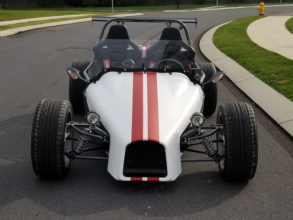

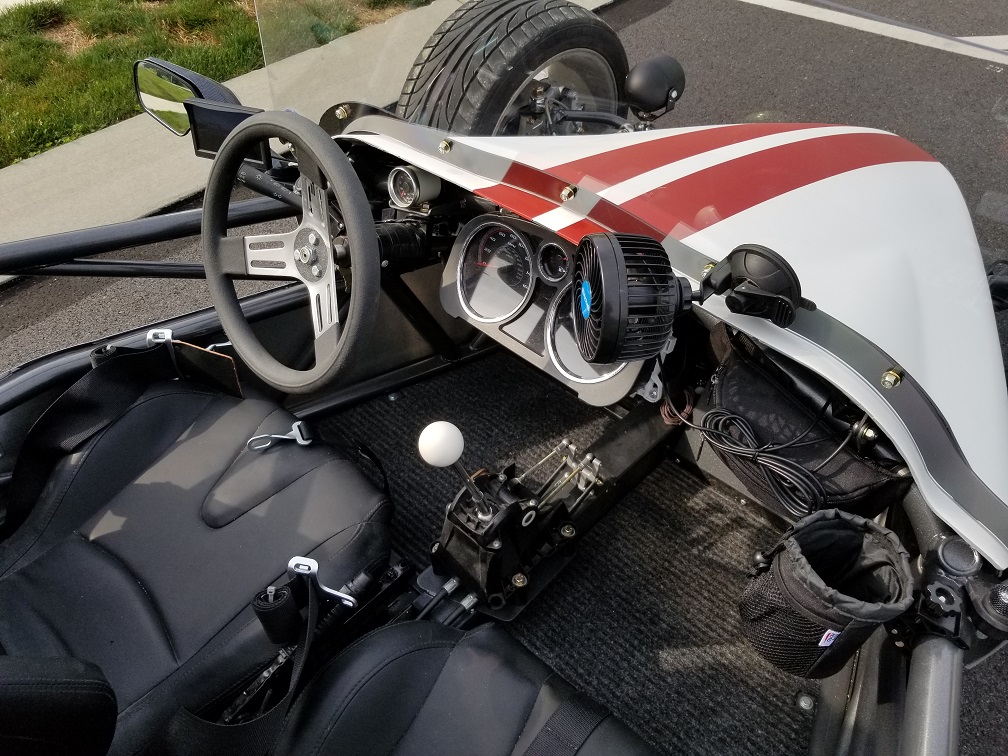

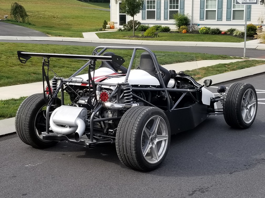

V1 Ark's City Goblin #187 (2008 SS/TC donor)
Some more "officially done" pics.

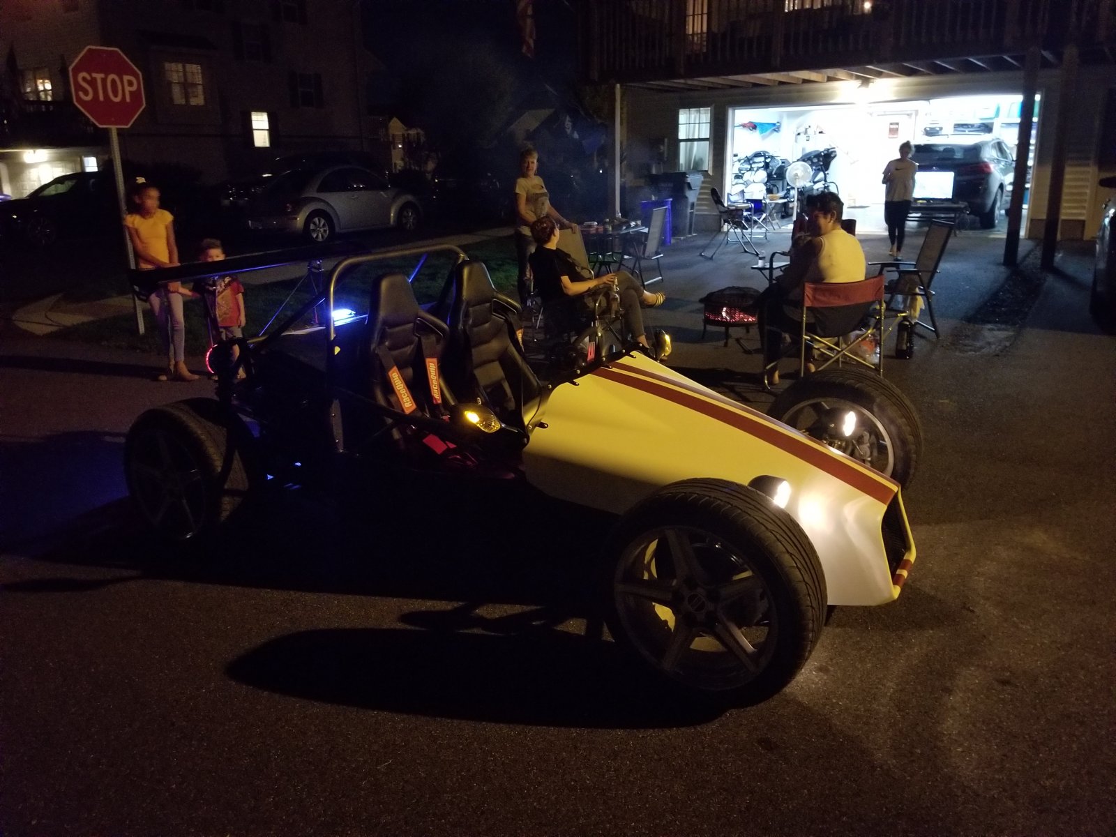

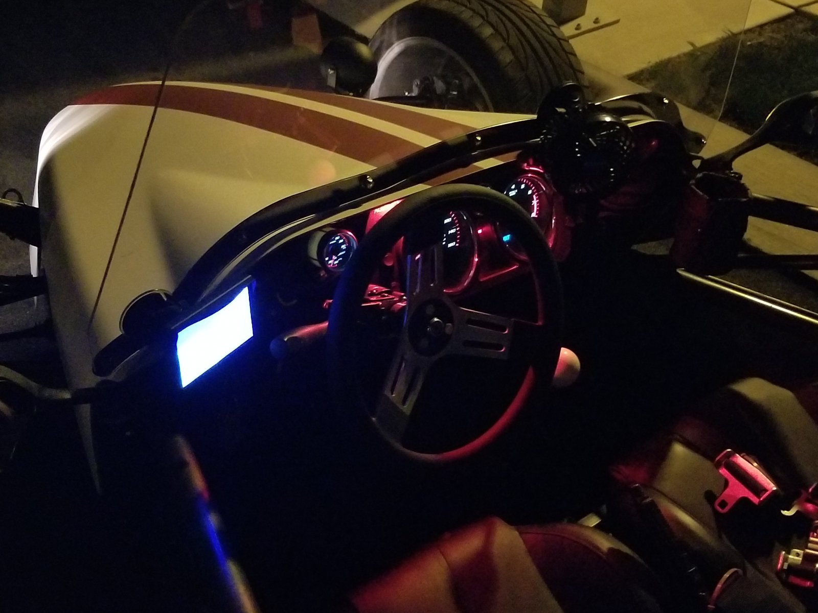

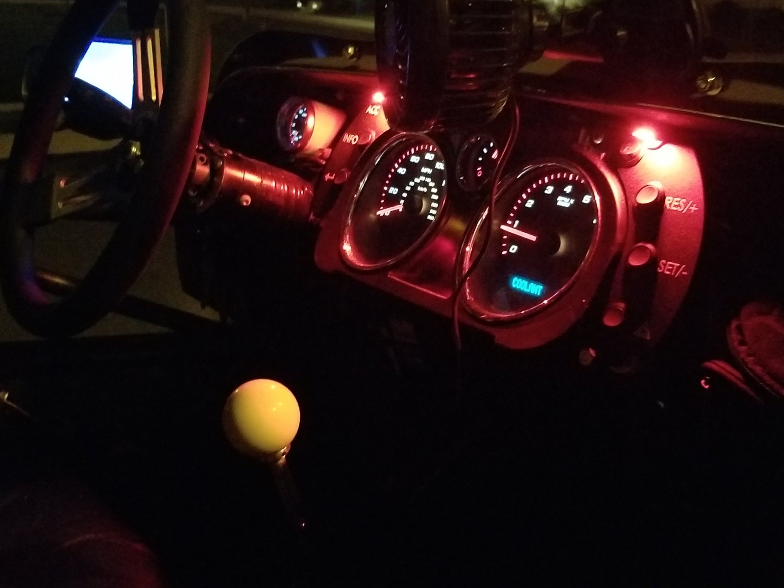

I spent today installing my cluster lighting. I ordered two pairs of LED's (one pair is a harsh white, the other pair is red) and a dimmer. Initially I installed the harsh white ones, but then swapped over to the red ones and I think I'm going to stay with those. I like how the cockpit looks at night and I think the dimmer was a very good investment, too.
I even got hailed down by a bunch of friendly neighbors who were sitting around a fire pit, watching Dallas lose to Seattle. /cheer!

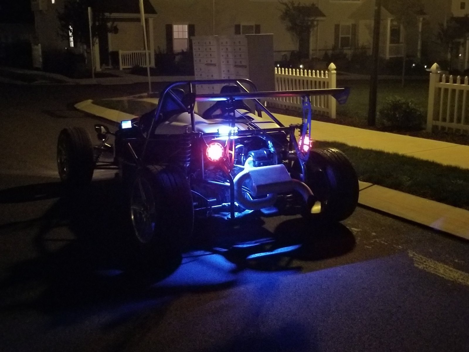

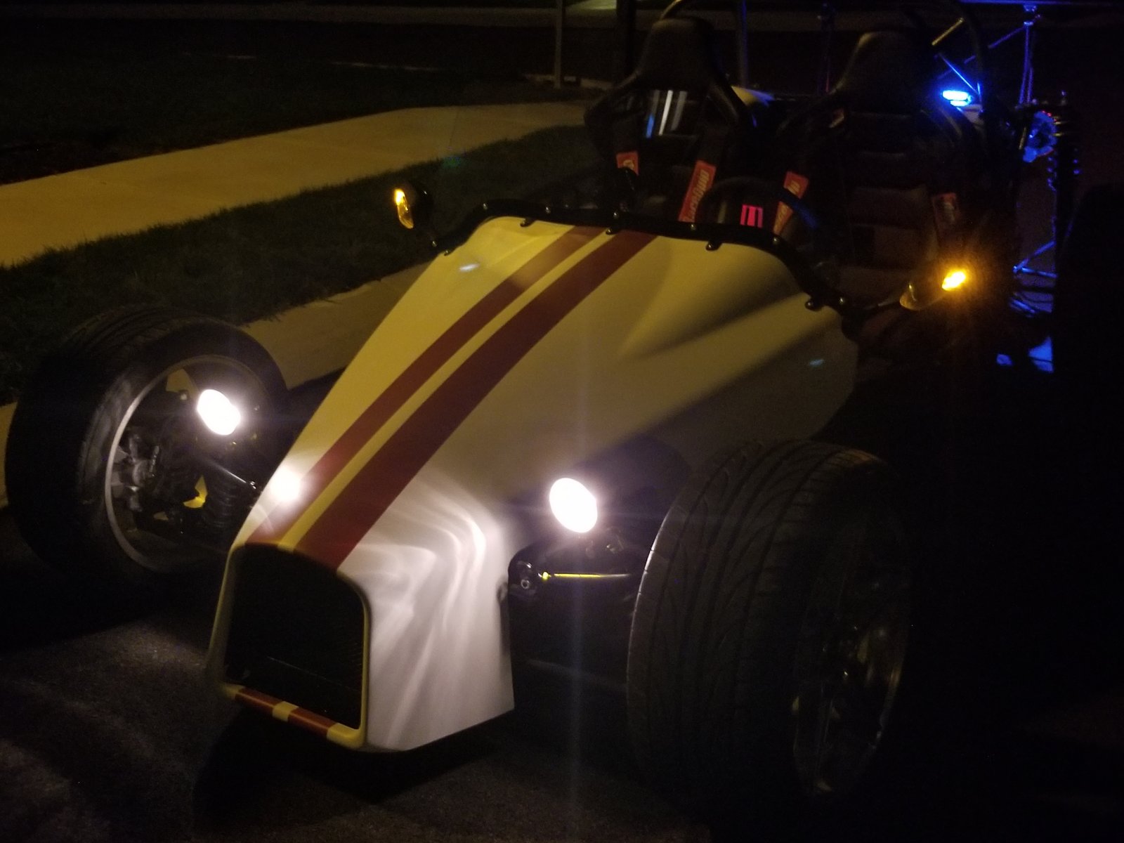

A few more night shots...
