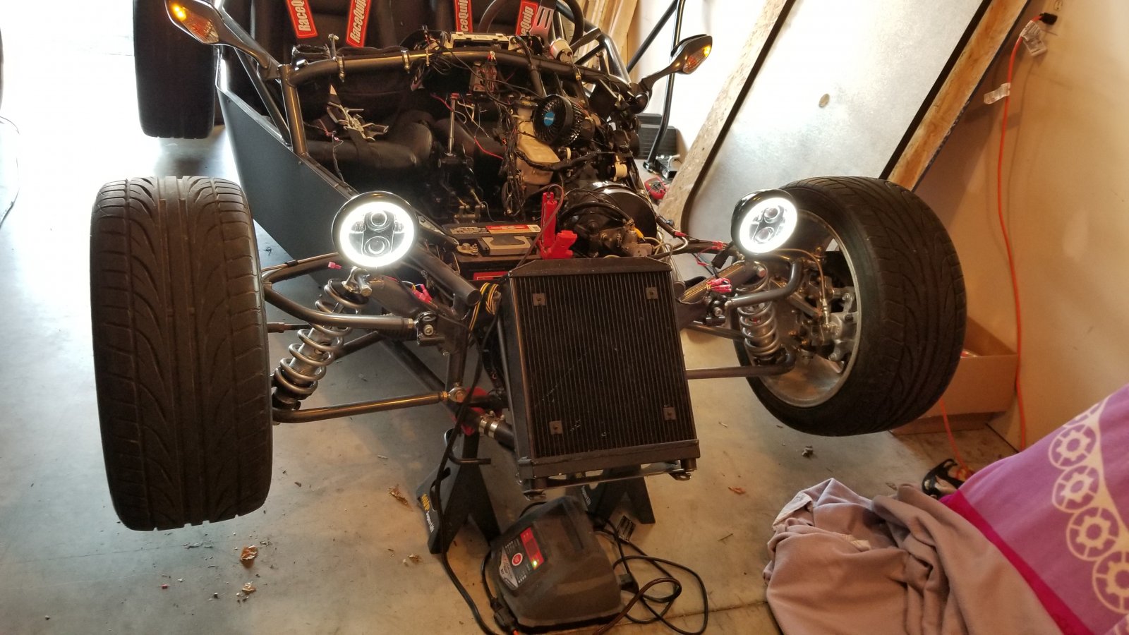

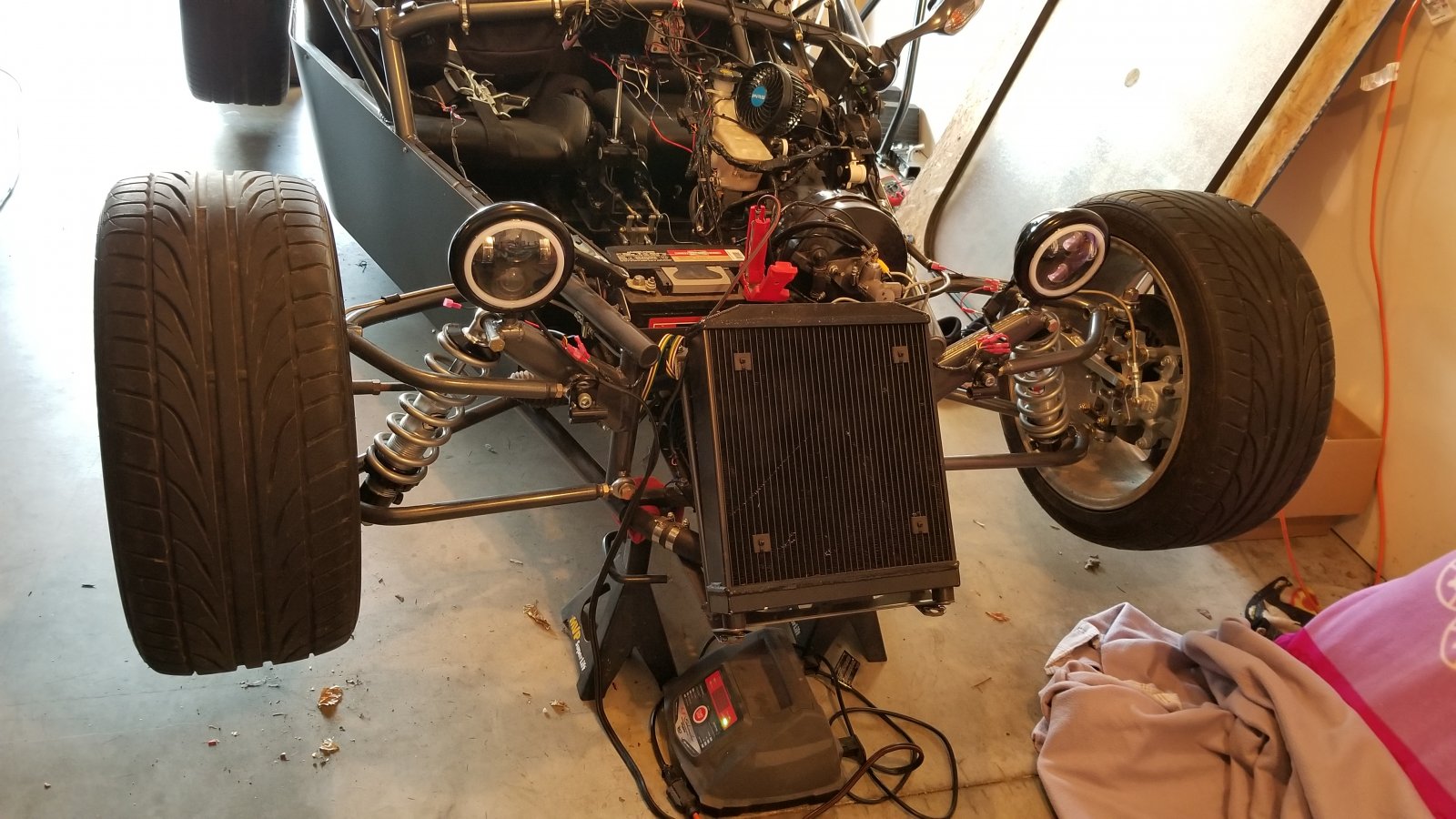

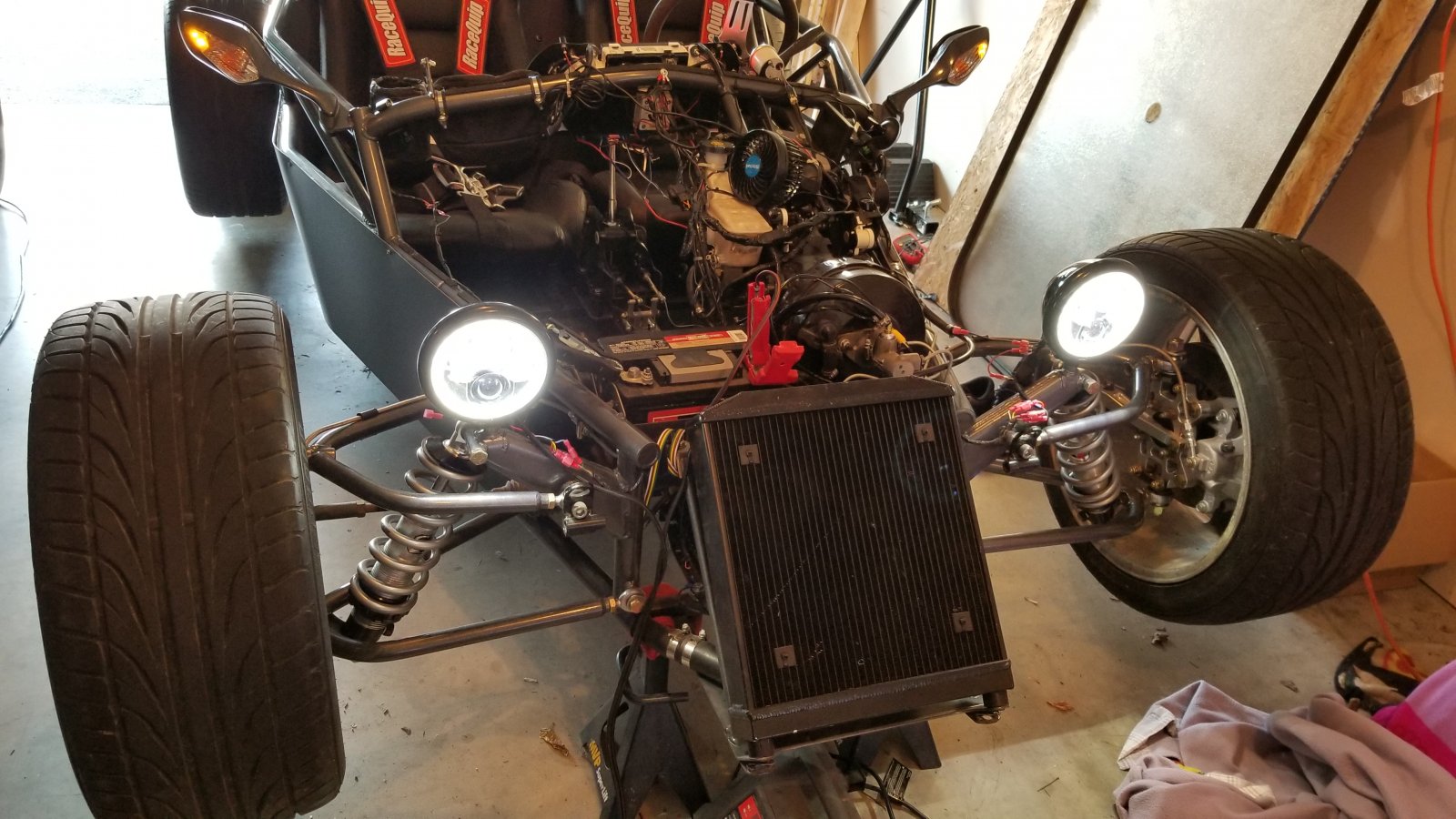

That being said, I've left the Goblin sit since November because it's too cold to work on it in my garage. With the passing of my dad, I decided to focus on finishing up some of the little stuff I never did get done in the fall. Even though it was 29 degrees this morning, I started early and learned I can tolerate it as long as I spend a few minutes thawing out every half hour or so. I cut out and disposed of all the extra wiring I had ran in the fall to support my spoiler light. I tidied up some wiring while I was at it. I also installed the LED headlights I got a while back (thanks for the mounts and adapter rings @Mayor West ). I didn't finish off the wiring because I still have to run turn signal wires to the headlights, to support the turn signals included in the headlights.
View attachment 20095View attachment 20096View attachment 20097

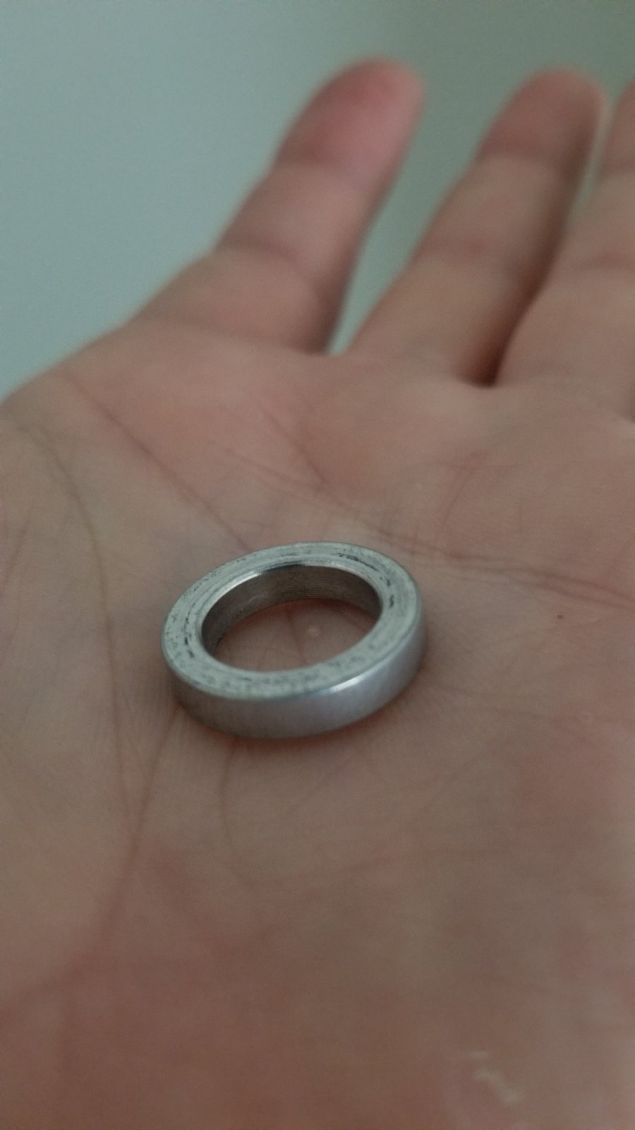

Did the 3D printed parts I sent you work out ok?
