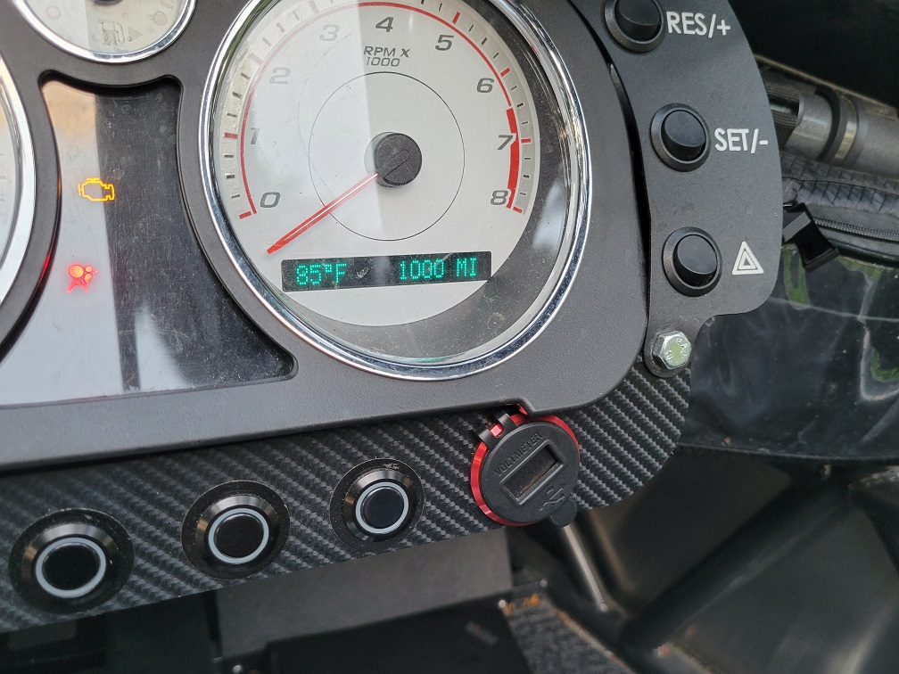

Hit that first big milestone last night. Need to get the front end up in the air and tweak the camber on the front wheels a little bit, as well as finish off tweaking the levels on my audio solution. Otherwise, I've just been enjoying the s*** out of it this summer!
Congrats!!!!!
Maybe DF could start sending out little stickers as we reach mileage milestones. Kind of like Mercedes used to do with their grill badges.. :)
And that air bag needs to be checked..... :0
Congrats!!!!!
I know right? Still waiting on Bradr's device to eliminate that light.
...and permission from the Boss to get into HP Tuners to hopefully eliminate the CEL also.
jennam
Several folks have opened their clusters and put a small piece of electrical tape over the airbag light so it doesn't show through.
Good point, I have to take my cluster back apart anyway. Tach needle isn't in there right, I have to fix that so I might as well just mask the lights at the same time.
