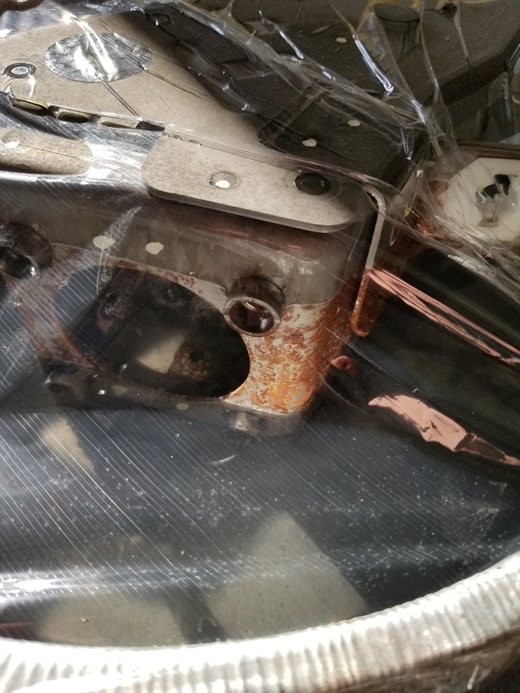

Had to cut the exhaust off since I broke off two of the bolts trying to crack them loose... fun times man, fun times.

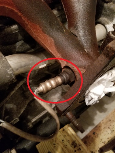

Just discovered those aren't bolts I snapped off, they were studs that were part of the exhaust manifold/header. So I guess I need a new one. Just as well, this one is rusty as hell and I wasn't looking forward to cleaning it up.
Question; is this an oxygen sensor?

Studs can be drilled out and replaced. But the stainless header looks good till you drive it once.....

Yes, that is an O2 sensor.

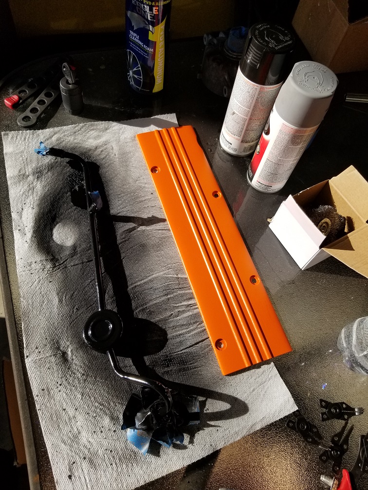

Cleaning the engine and other stuff has begun in earnest though. I'm planning to go with a black and orange color scheme on the finished Goblin so I've begun painting parts of the engine. I don't plan on painting the whole block, but I will paint the valve cover, supercharger, fuel rail, etc. on the top of the engine gloss black, with the coil cover pumpkin orange.

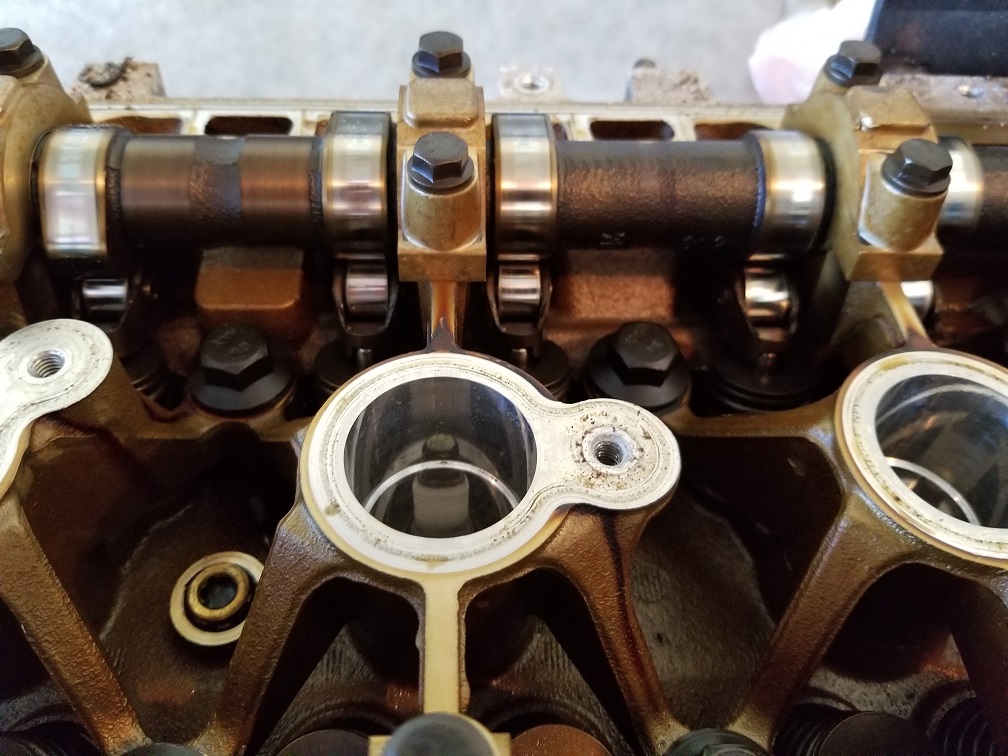

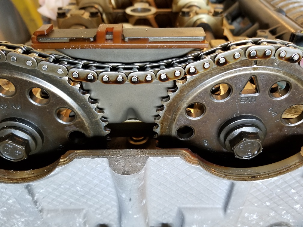

So this morning I decided to truly begin working on the engine, getting the timing set installed and cleaning up the exterior to a degree. I was also hoping to get some insight on why the engine does not run. And boy, did I .... I'm going to need some help with this.
I started by taking the valve cover off so I could prep/clean it, and sooner or later, paint it. The first thing I saw when I took the valve cover off was this:
Correct me if I am wrong, but the timing chain should have no slack, correct? Upon touching it, I was able to easily move it with my finger, which doesn't strike me as a good thing.
So I continued on, and examined the cams. The first cam I looked at, looked like this:
All good, as far as I can tell.

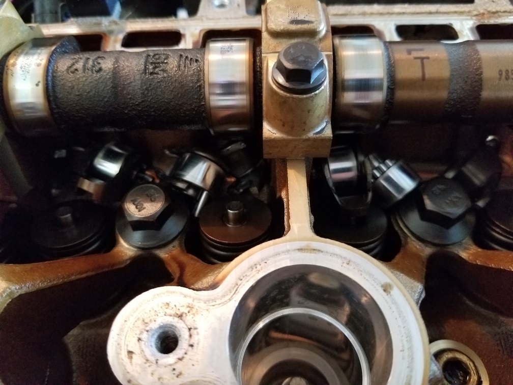

However, the second cam looked like this:

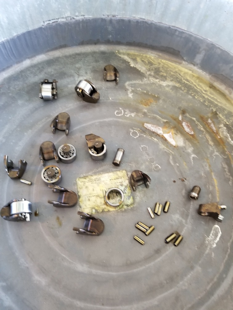

I guess I found the source of my "jingling" from when I turned the crankshaft by hand a while ago. I got to picking with some needlenose pliers, and ended up with this:
I don't even know what these little things are called, let alone of the engine could be ruined. Any thoughts, resident experts??
What an adventure!
I'm guessing the valves came in contact with the pistons...
The cam chain shouldn't be loose, and the valve train rollers shouldn't be broken off.
Pull the head, and you will know. Or put a camera down the spark plug hole, if you own an inspection camera.
If you're lucky the block is saveable, but probably the pistons, valves, rockers with rollers, and a cam are toast. Head saveable? You'll have to look.

I just attempted to turn the crank by hand, and the chain is just hopping somewhere under the timing cover.
