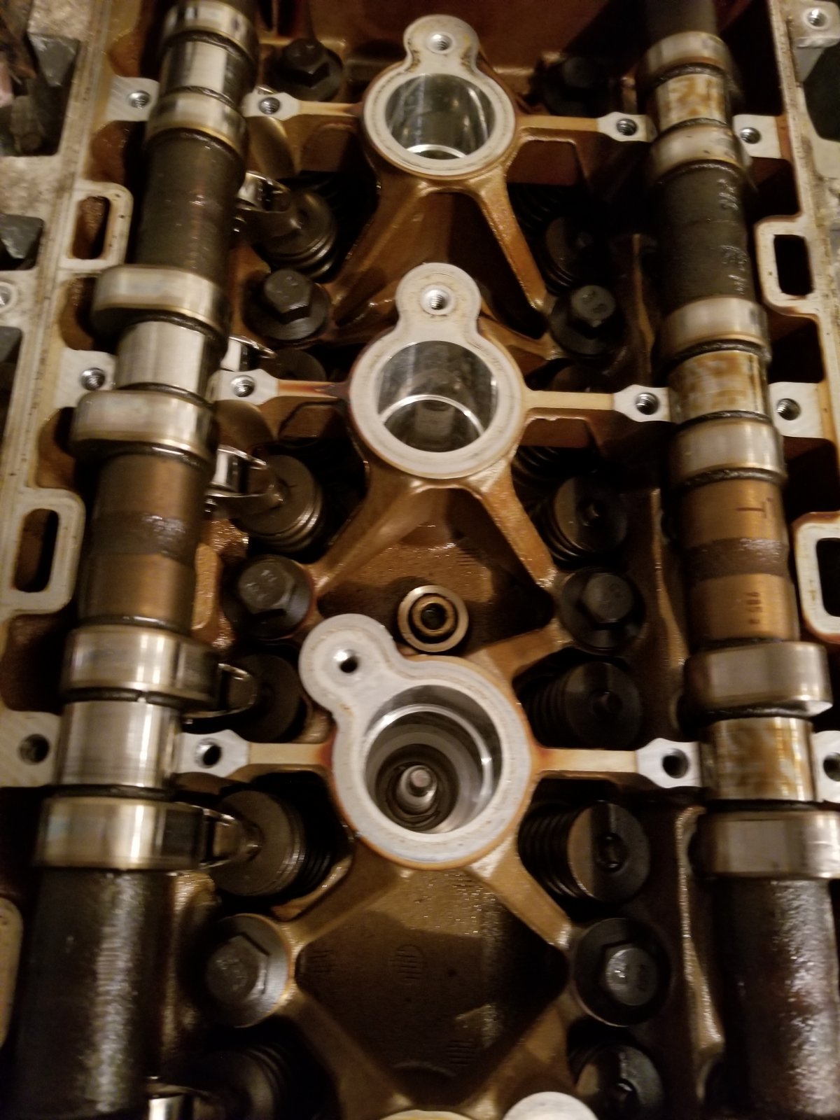

I couldn't leave it alone. After I simmered down a little bit, I put in some time to get to the bottom of things.
I didn't yet pull the head (not enough time left today), and I may not need to. After a thorough examination of everything under the valve cover, I noticed one of the "nipples" that serves as a mounting point for one of the destroyed/missing rockers is broken off. Being that that is part of the head, I am looking at buying a head in addition to anything else that might be damaged further in.

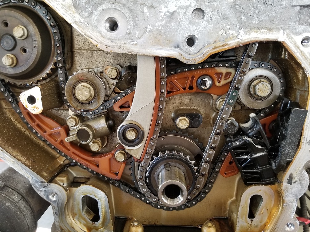

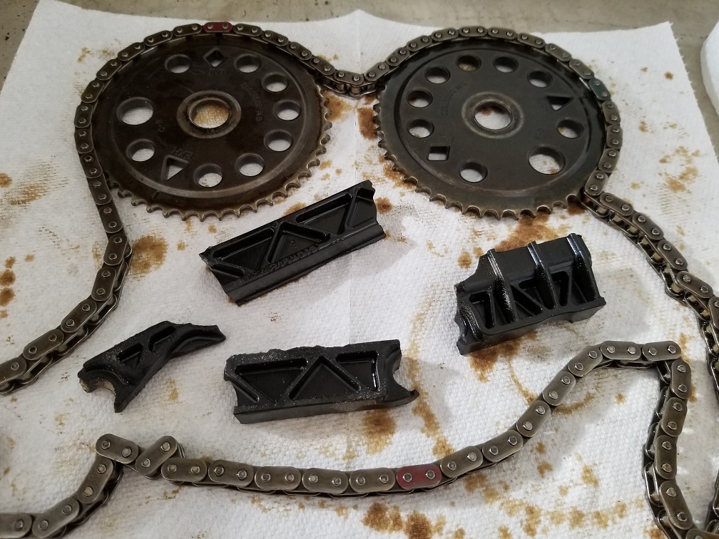

I couldn't get it out of my mind that the timing chain seemed loose. So, I took the timing cover off and was pretty much stunned at what I found.
Yes indeed, that IS one of the timing chain guides, broken into multiple pieces and just laying about inside the cover. Also another one of the missing rockers.

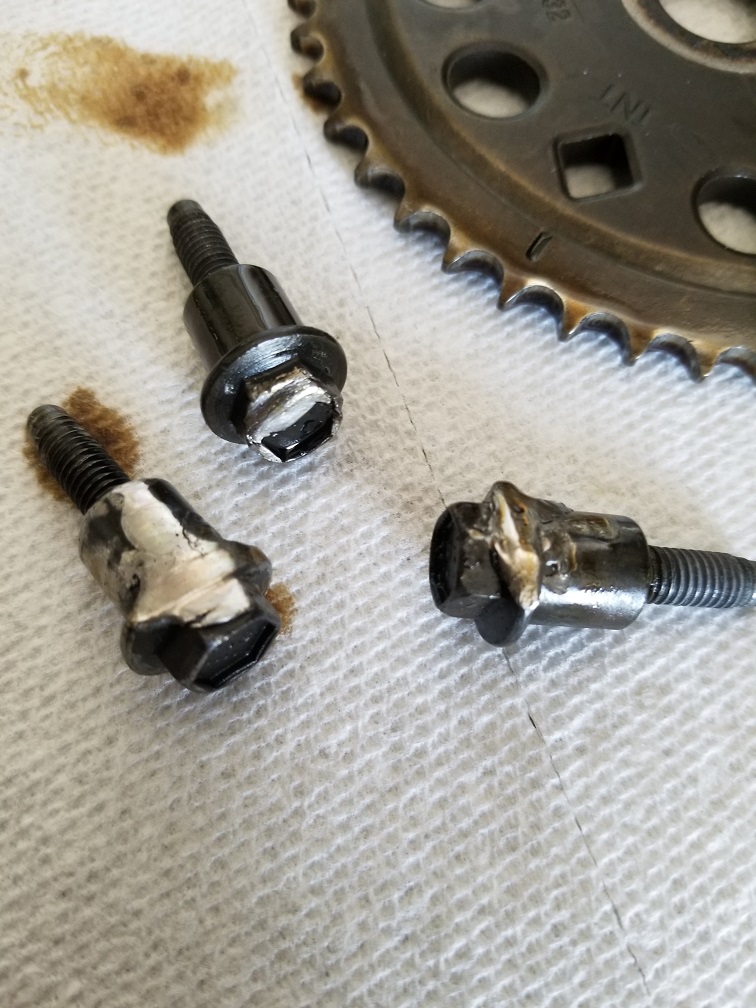

A few of the bolts under the timing cover.
I cannot believe that the timing chain is fully intact. There also does not appear to be any damage to the engine itself, at least not under the timing cover...
None of that may matter though. I have to, at minimum, buy a new head. I'll still take the head off to survey the damage, but this is already looking like another donor is necessary.

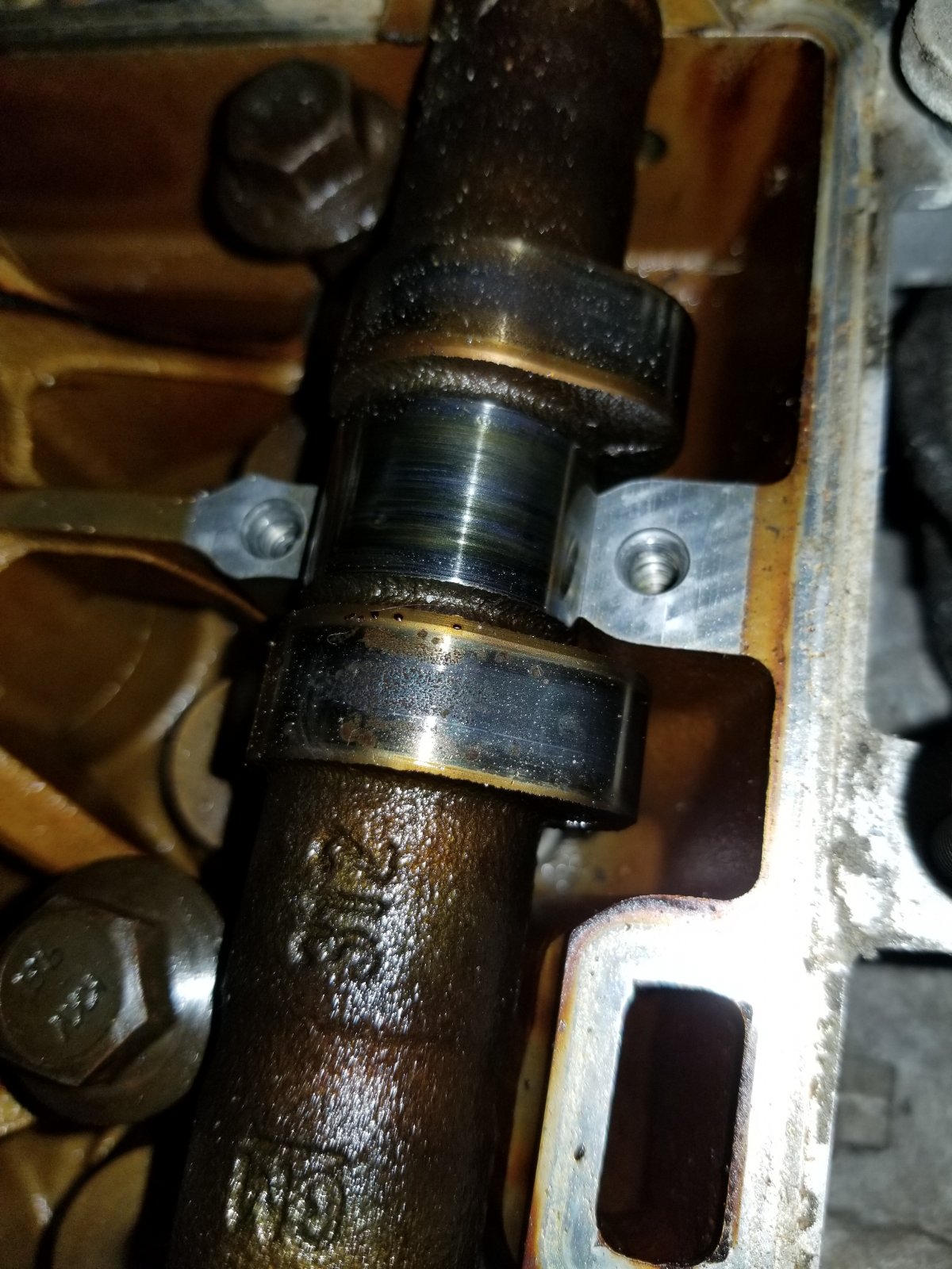

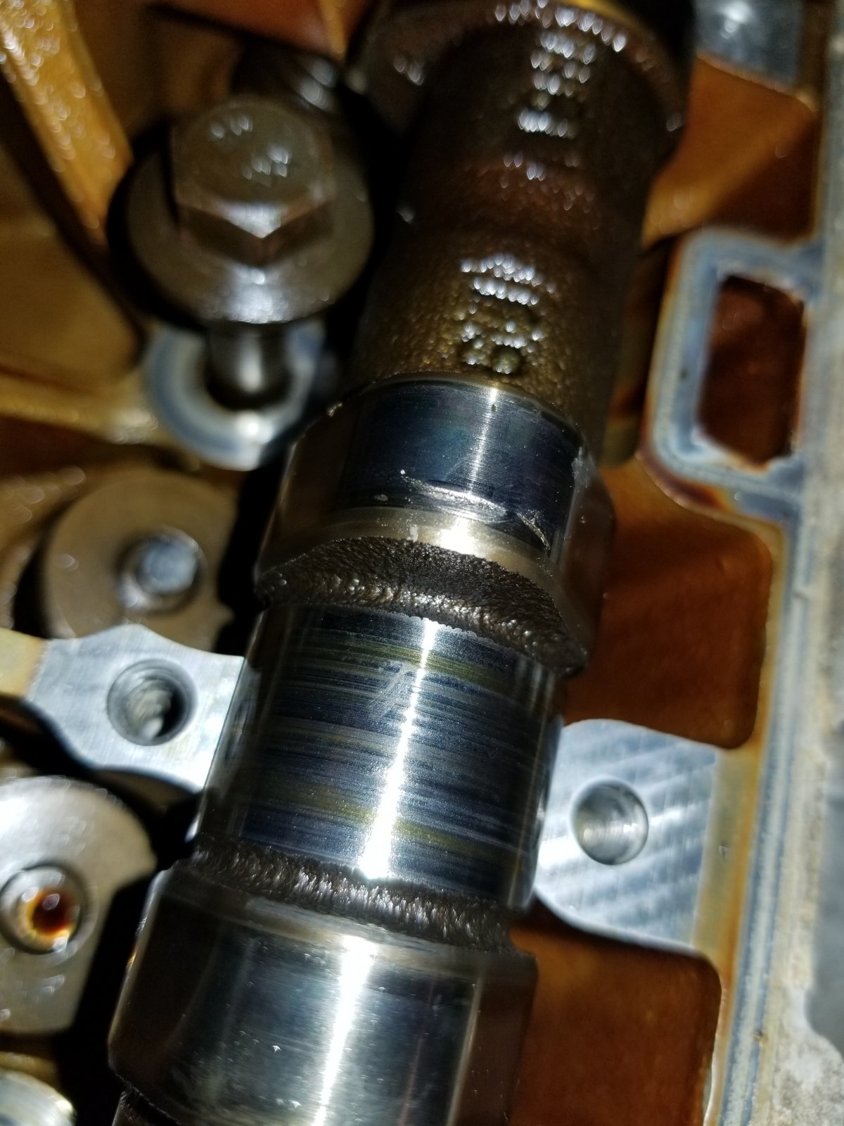

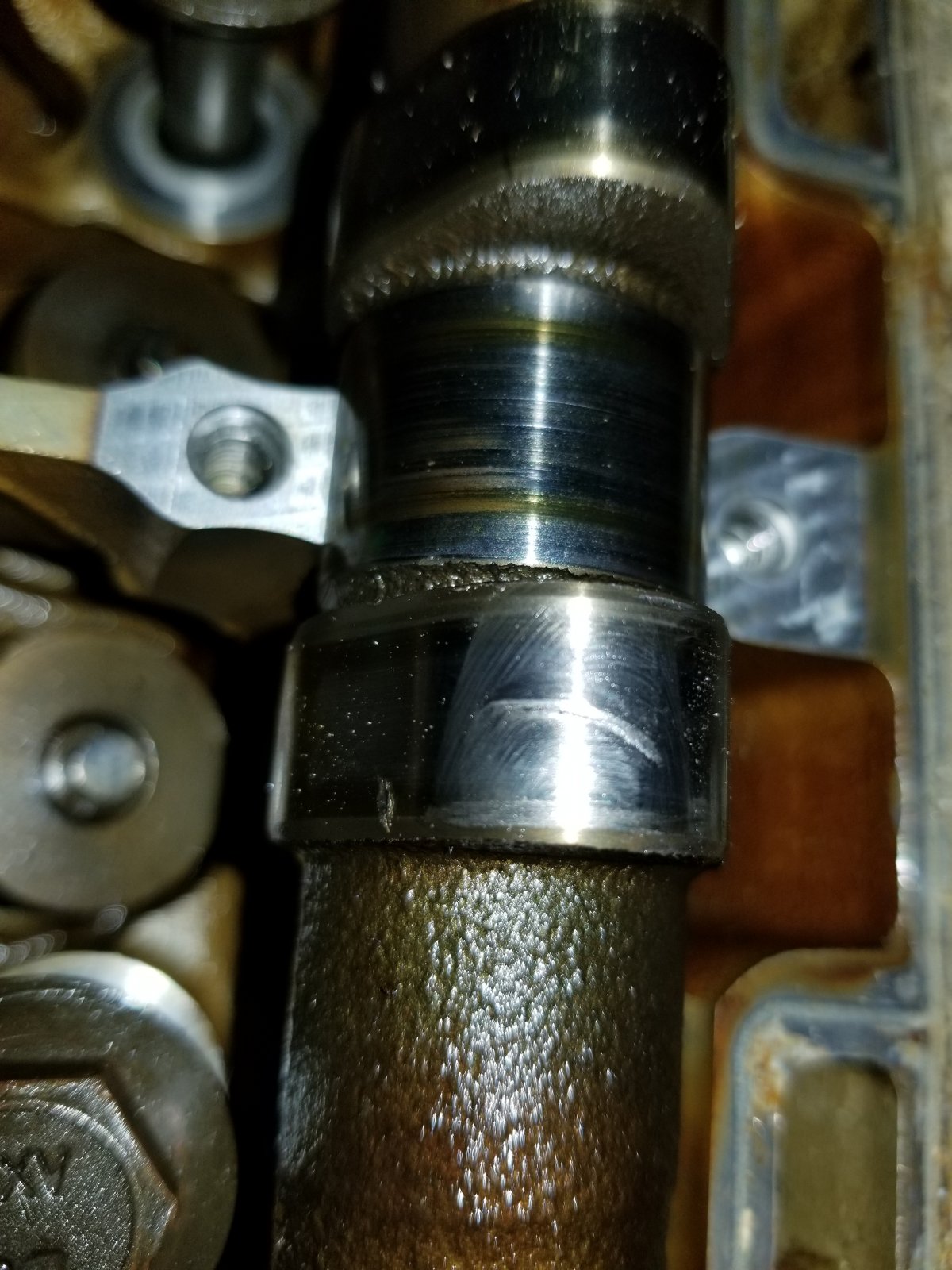

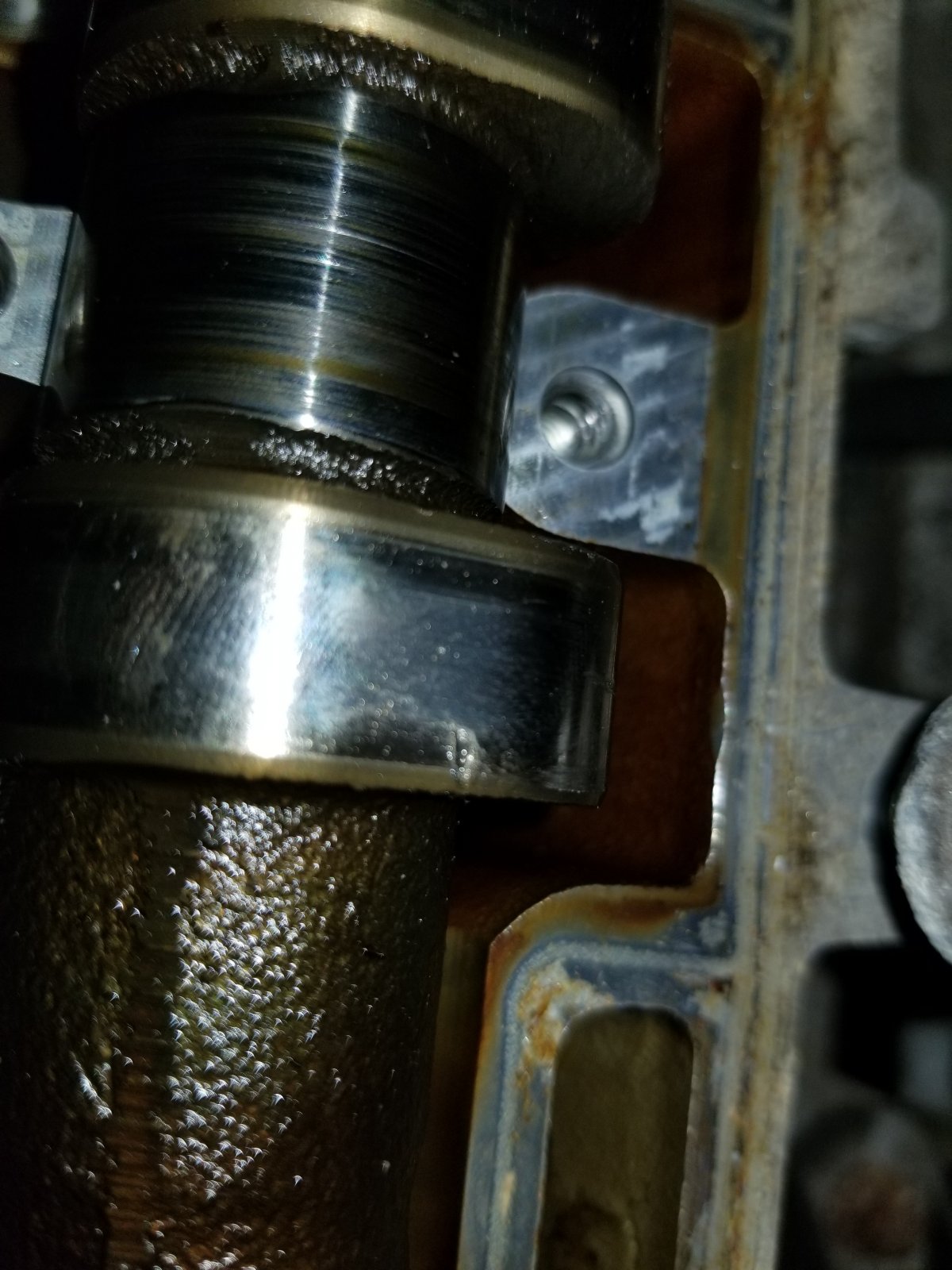

I still didn't have time to remove the cylinder head because I work an 8-5 Mon-Fri and have a wife and kid, but I did do a little further inspection tonight. If I just need a head and rockers, then this project is still doable ... but I wanted to get a look at the cams.
First of all, all the damage is on the intake side. The exhaust side seems perfectly fine. Attached are some shots of the intake cam.
On the first image, I noticed the intake cam has oil around the inside of where the mounting clamps were before I removed them. The exhaust side does not. Is that an issue?
For the rest, I noticed the intake cam has some discoloration in some spots (I tried to capture them in pics as best I could) and in some spots, a few small nicks/grooves. Does that necessitate a new cam? I believe it does, but someone here will be able to tell me I think.
Basically at this point, I am considering two directions:
1) Replace parts on the current engine. This is only an option if ALL I NEED are a cylinder head and rockers.
2) Pursue a new donor. I've seen a couple that might be good targets but none of them are SS's.
Thoughts on the cam? Thank you guys!

With luck, the pistons and head survived. You would need valves, rockers, cams, timing chain set, gaskets, etc.
With less luck, you could do a performance rebuild, forged pistons, connecting rods, head, etc.
The cam is gouged and the cam bearing journal is scorched, its a goner.
The next thing that need to be looked at is the lifter bores to see if they are damaged. If they are, the head may not be reusable unless the lifter bore can be sleeved.
I'm not in it for all that. I'd sell the motor to a rebuilder before I get that far in. I'm adventurous enough to tackle a donor strip and Goblin build, but not an engine rebuild. :(
@Desert Sasqwatch I already know the head is toast, one of the "nipples" that the rockers sit on is busted off.
