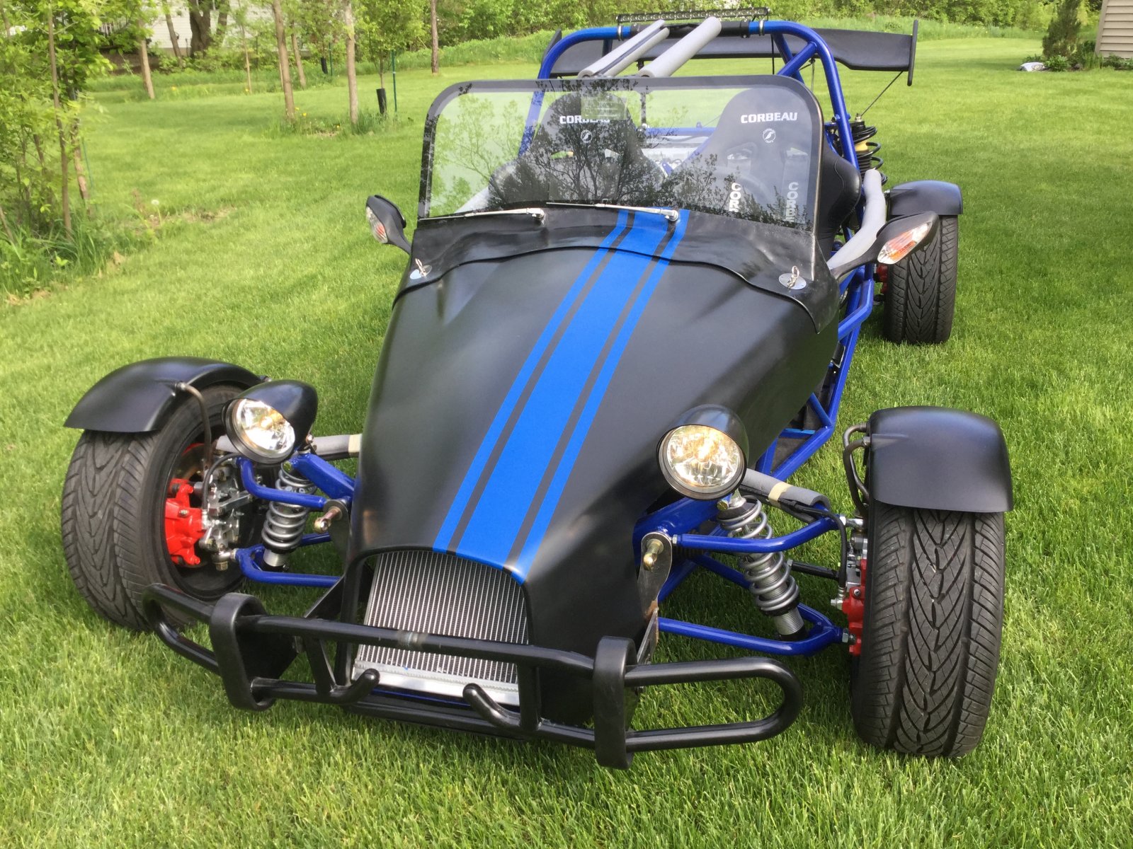

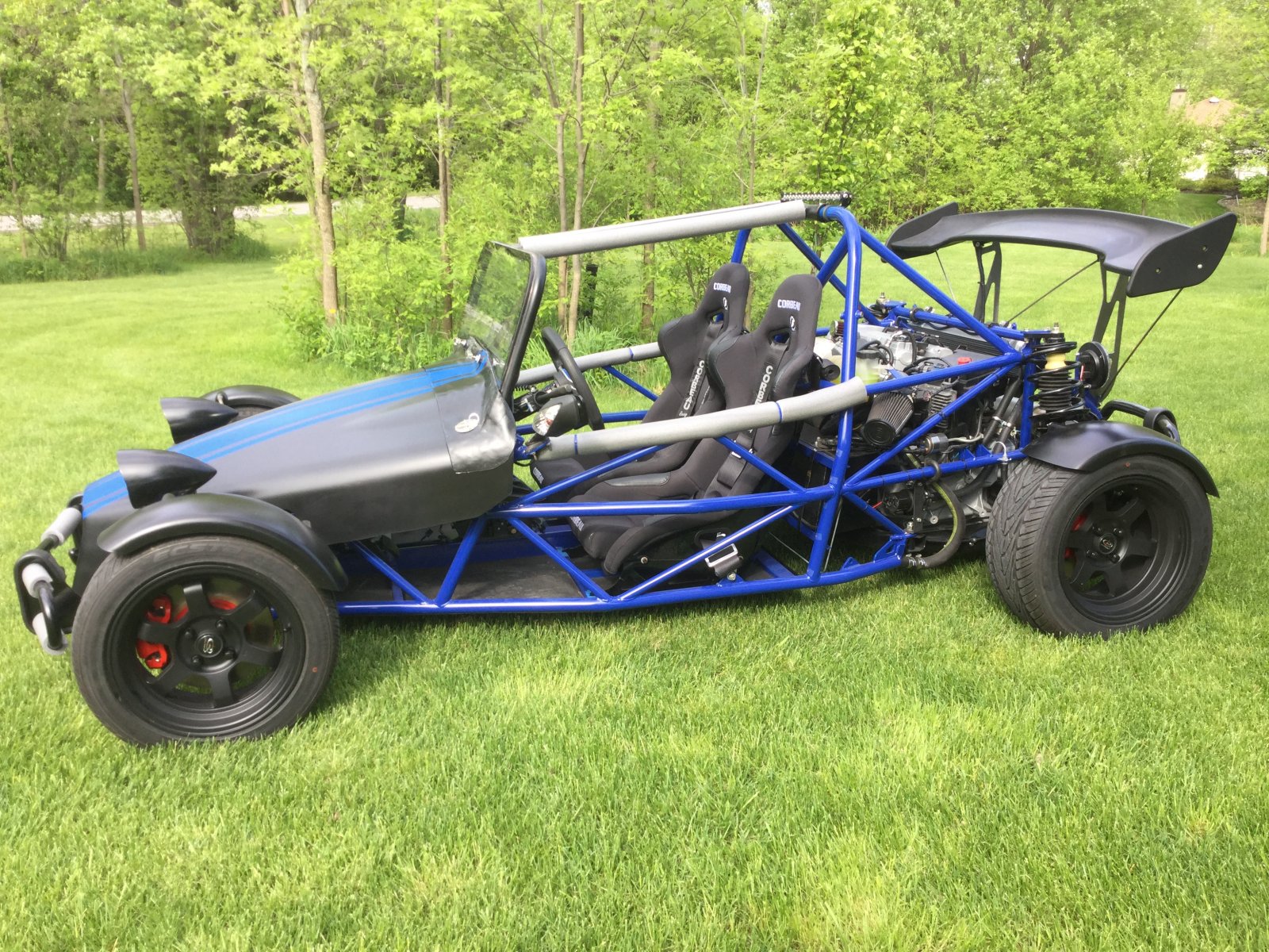

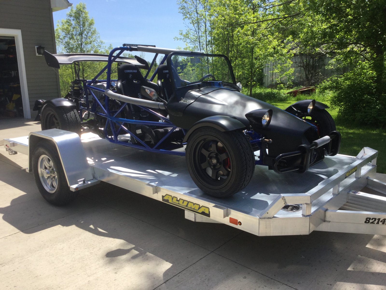

Just updating some pictures.

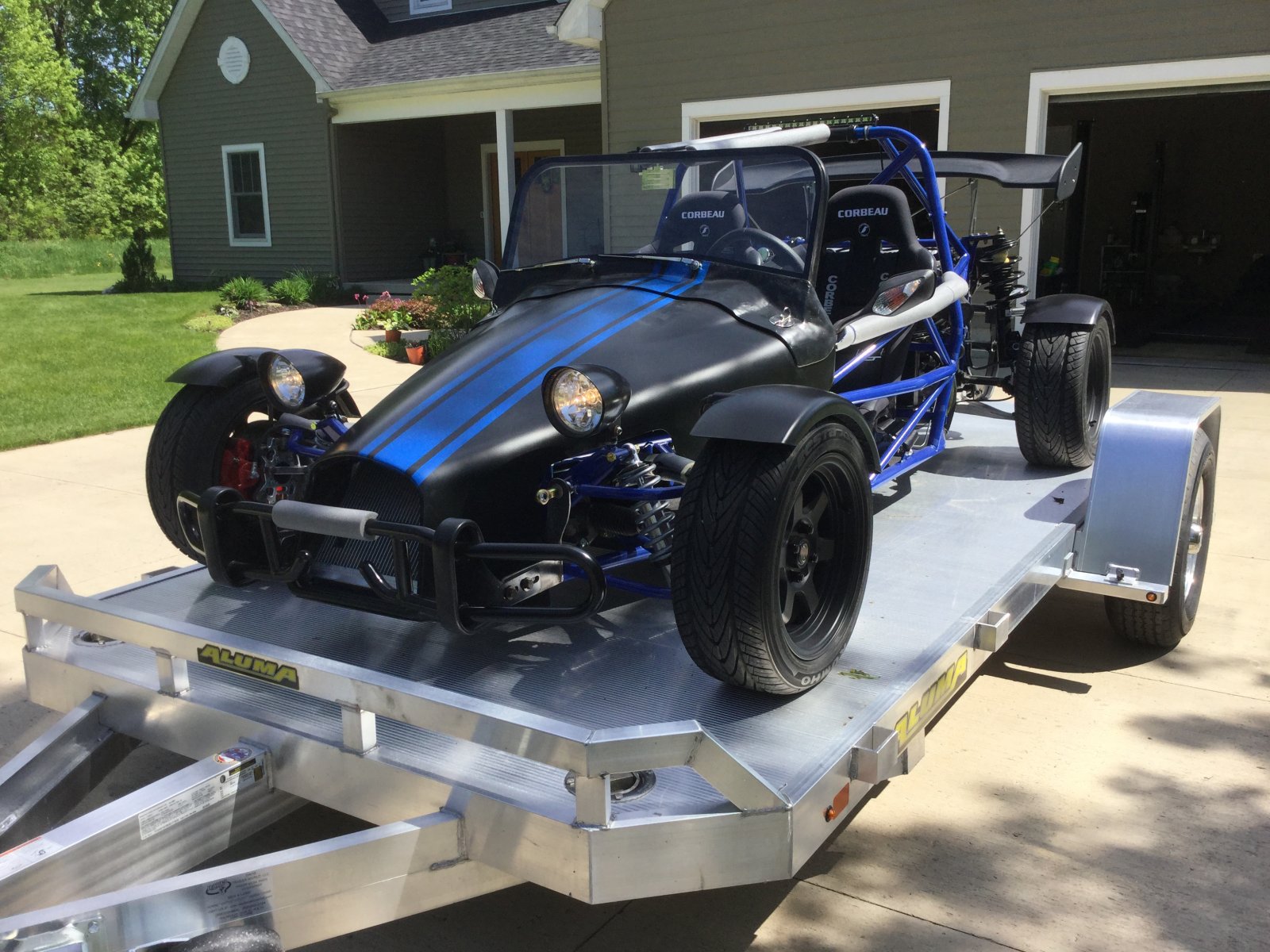

Ended up trading in my trailer for a bigger one. My 6’x12’ was a great trailer the problem is my car actually ended up being 6’-2” so I couldn’t back it onto it. So here is my 7’x14’ trailer I can actually pull the Goblin on and the weight is far enough forward. (Need to make a forward rock guard).
Friend pointed out that I missed the stripe on the rear wing.

If you are actively selling the car, why did you get a trailer for it?
One thing we have to very careful of is these cars are very rear heavy and they don't trailer well unless you pull them forward on the trailer to keep too much weight off the rear. Otherwise they will fishtail really bad. I'm sure you know this already - this is meant more for the casual reader.
Beautiful trailer by the way. This trailer looks like the wheels are back far enough to balance this car well.

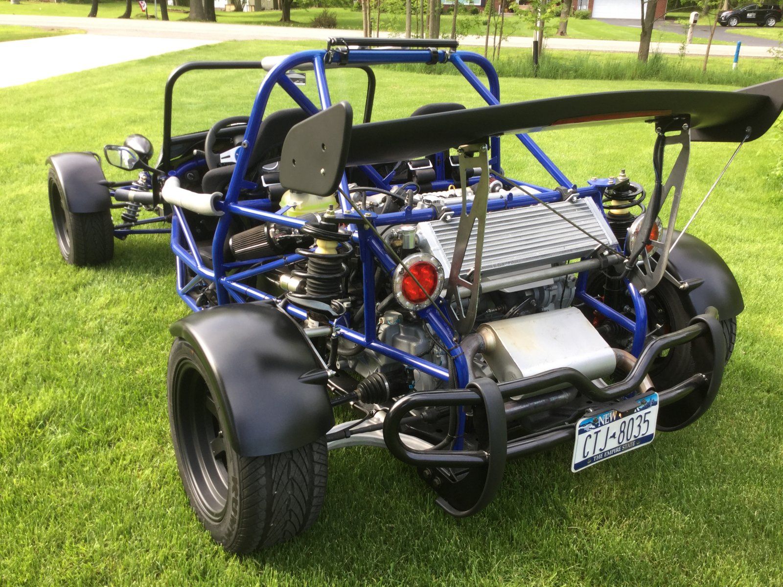

do you feel that you get enough air flow through your inter-cooler where it is located? I could see it possibly being more effective mounted off your wing mounting struts?? just an idea, the car looks amazing.

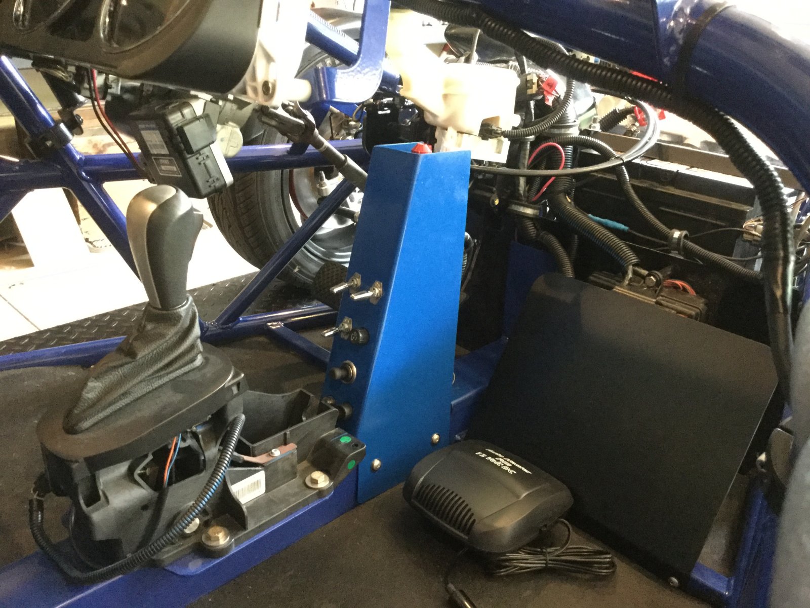

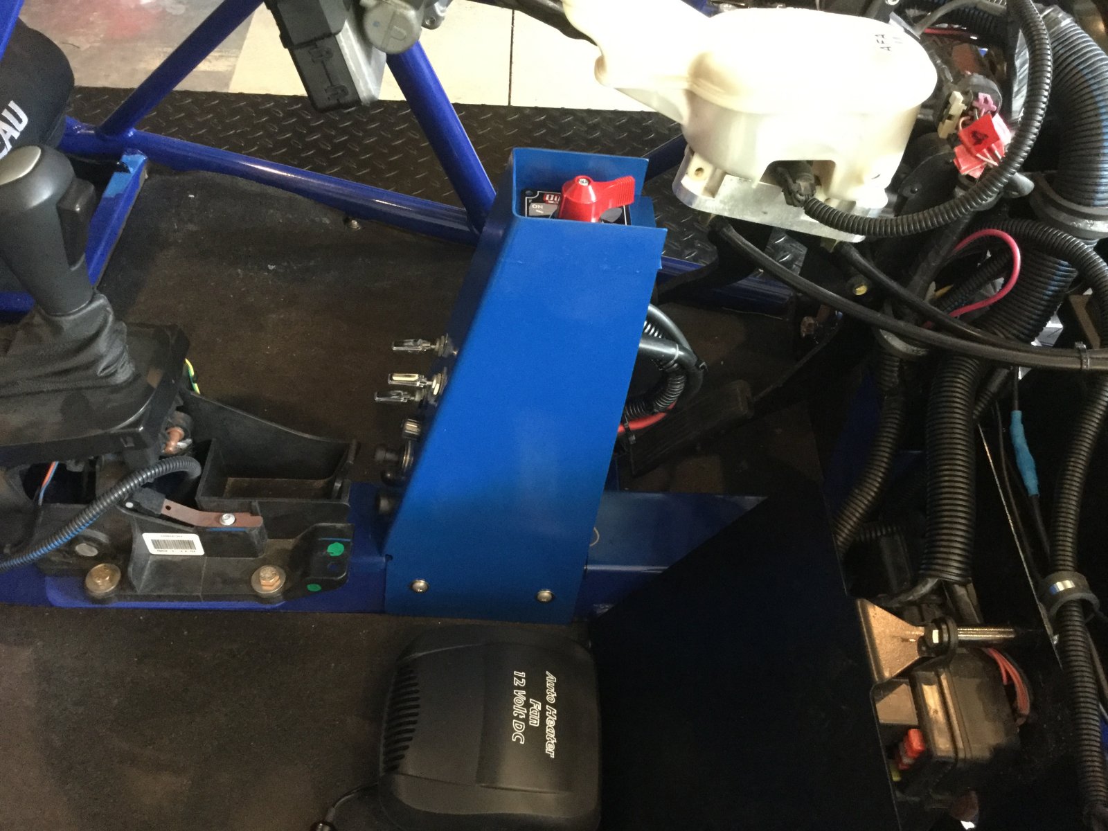

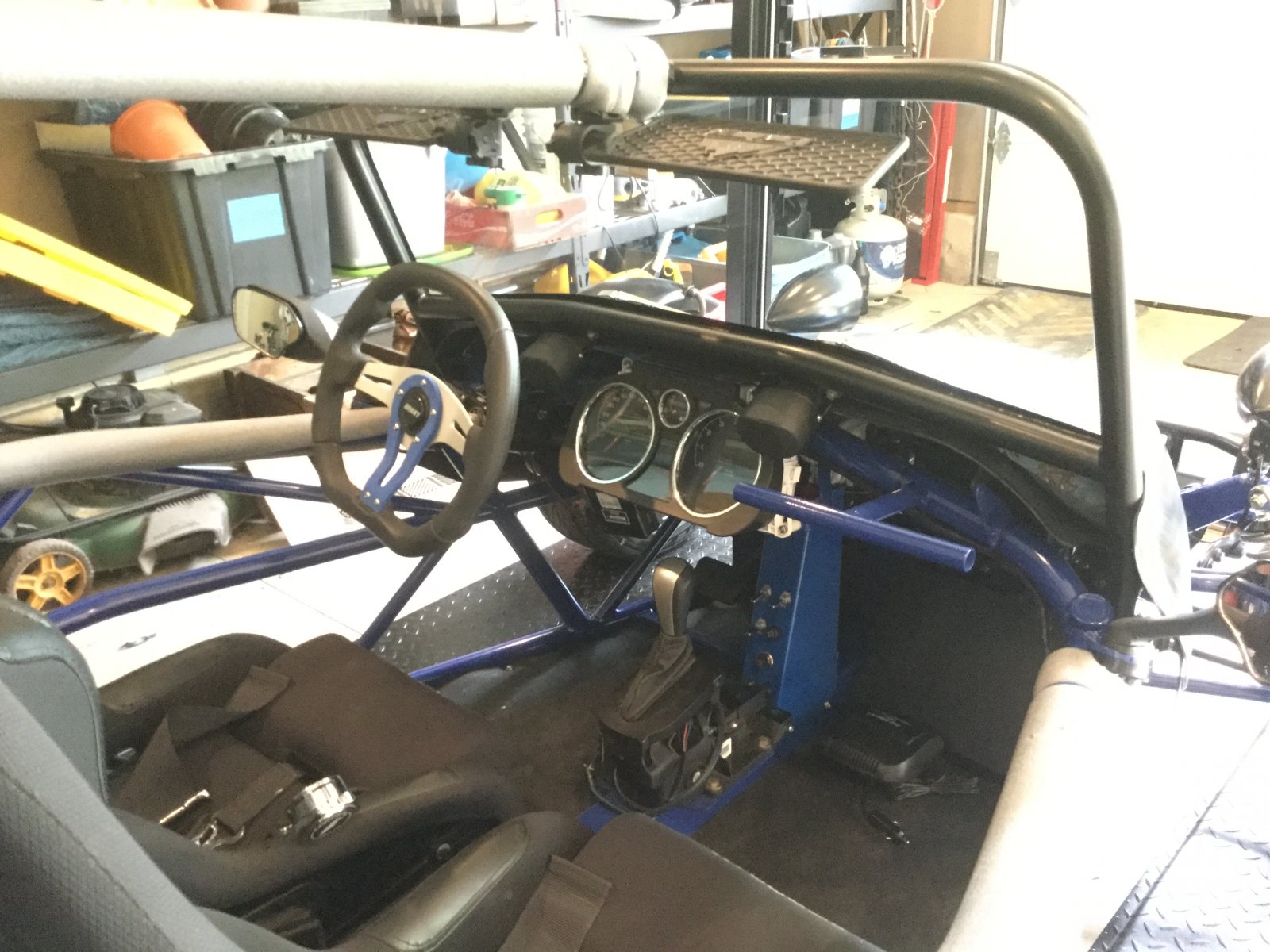

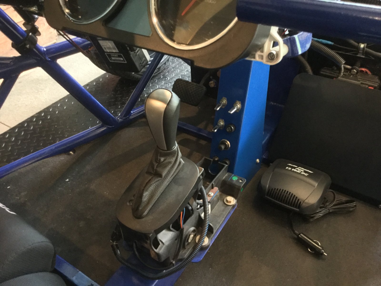

Just trying to finish up some of the last requirements for NYS DOT inspection. Still need to finish padding the sun visors and the dash.
I was able to finish up a small upright center console to house a master power shut off on the top (can’t really see it with the hood on - hated to leave the battery connected when the car sits for any length of time but to pull the hood to disconnect the battery was a pain). Console also has the switches for the hazard lights, dash dimmer, cigarette lighter (to power defroster), couple of spares.

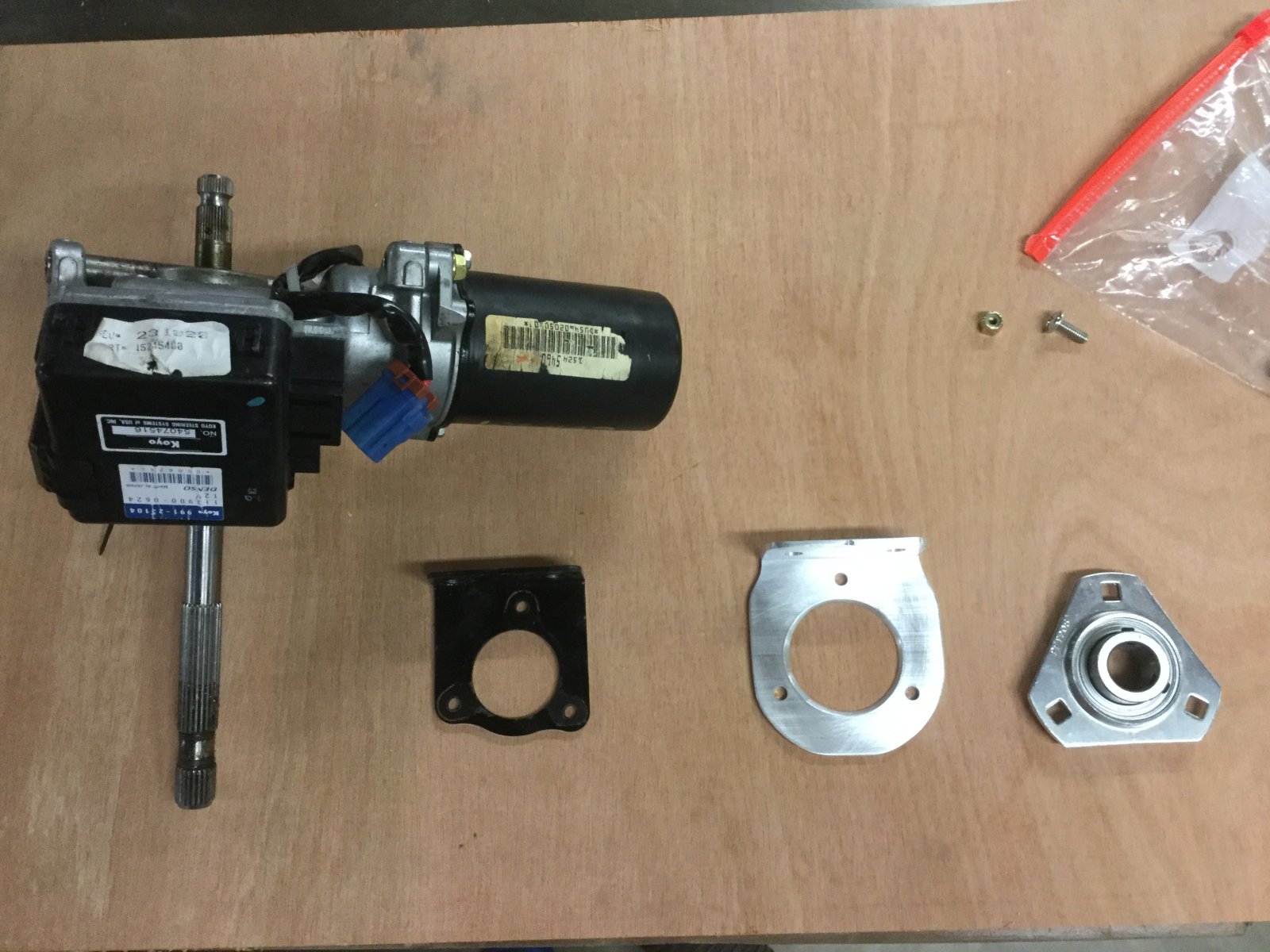

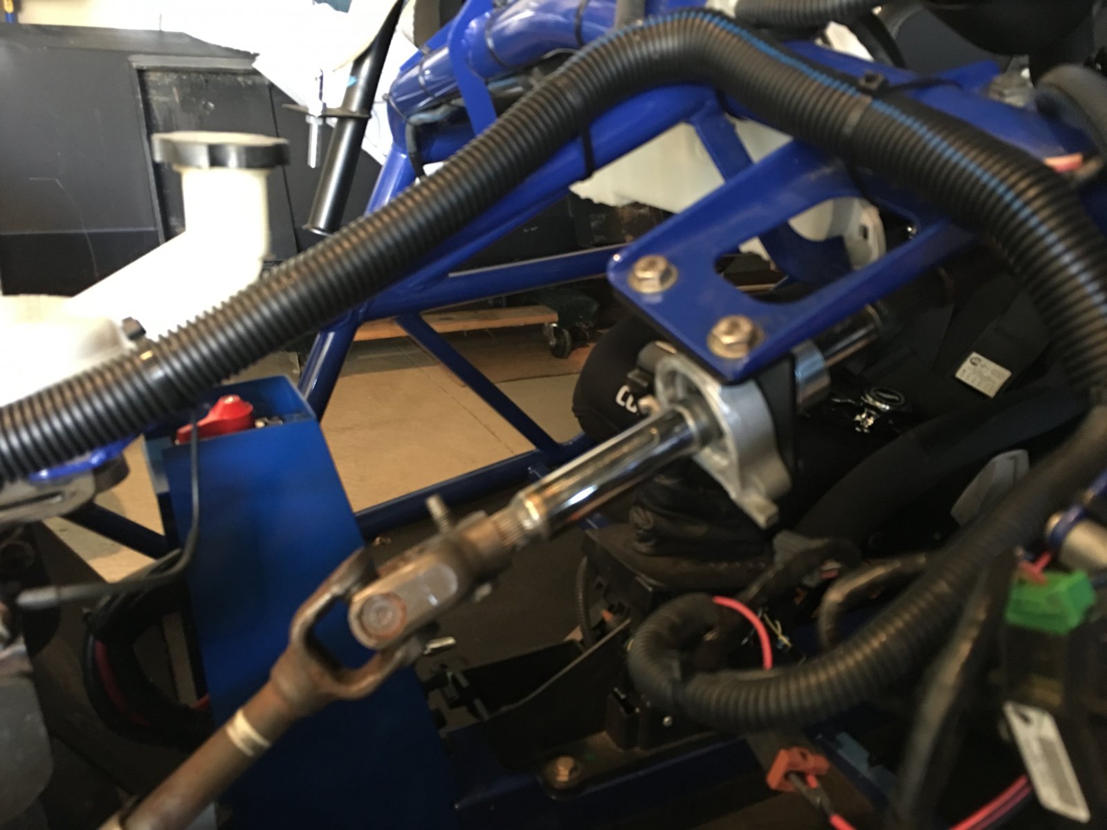

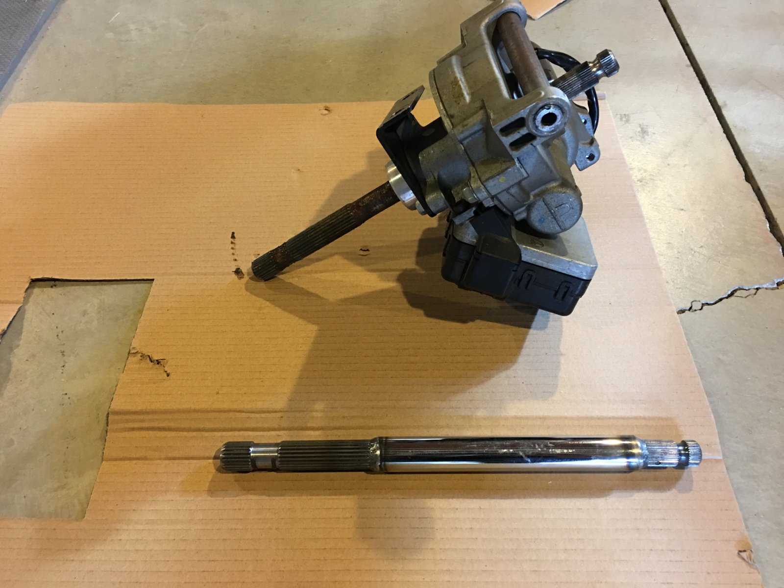

Good Afternoon,

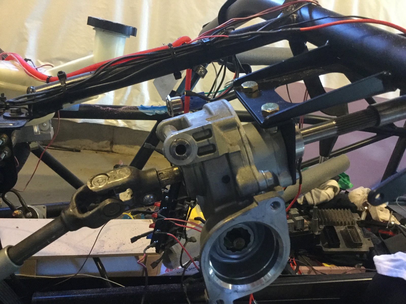

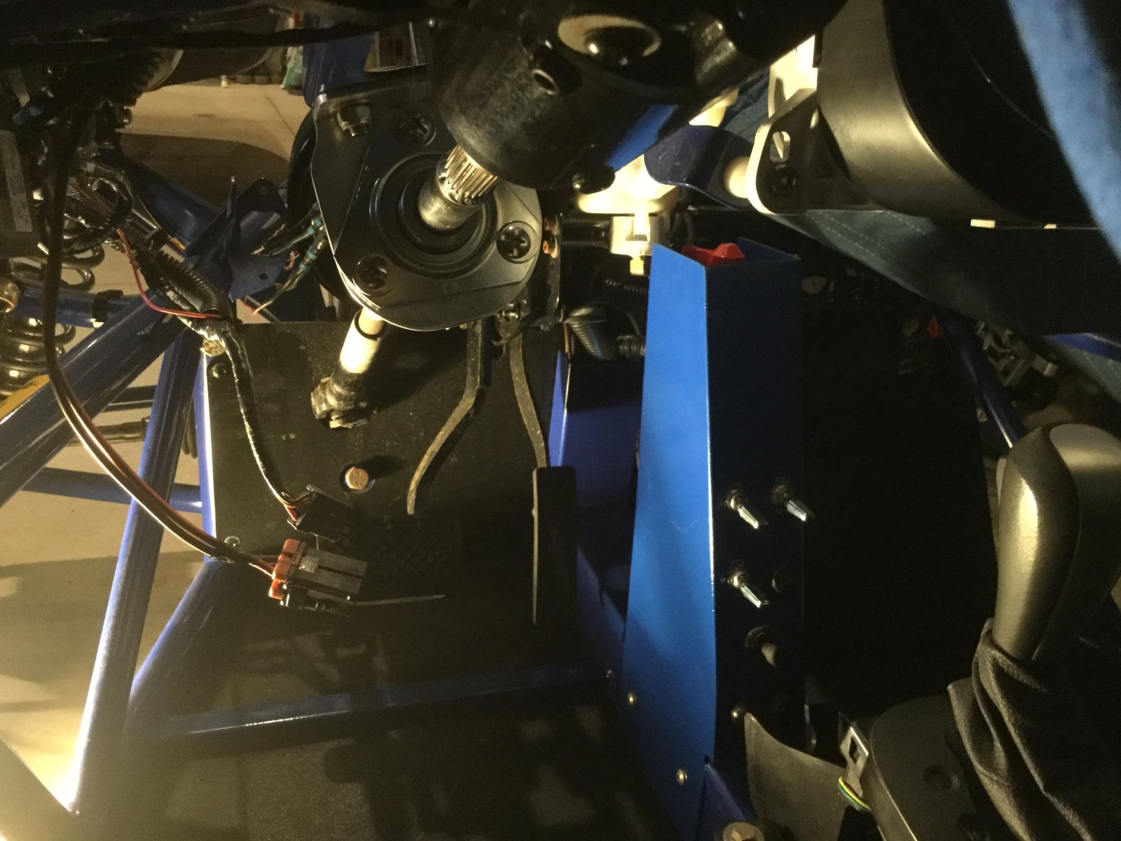

Had a little time to play around with removing the electric steering motor. I have been driving the car with it un plugged anyway so thought it was time to remove some dead weight.
Here is the unit in the car without the motor..

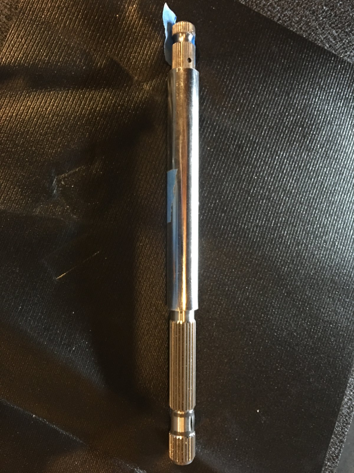

Here is the new intermediate shaft in the car... currently just using the old bearing housing until my new bearing shows up...
Substantial weight and complexity savings without the motor and gearing.
Simple shaft was able to cut the ends off the donor shaft then a piece of 7/8” VW Dune buggy steering shaft to fill in the remainder (had it and - ID and OD worked perfectly - LUCK over skill )....

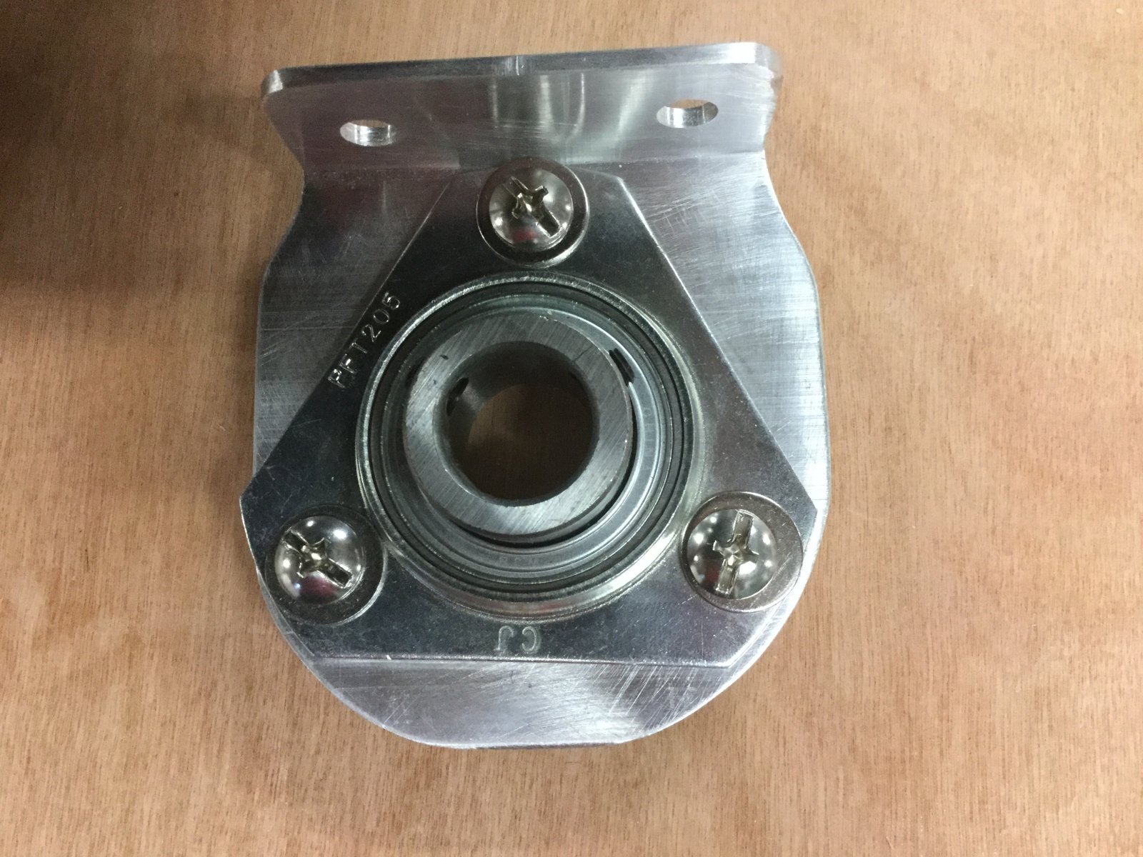

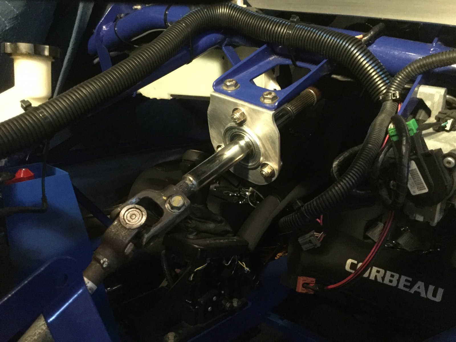

BAR-AIR
Good Evening,
Had a little time to finish up the new intermediate steering shaft bearing. It really does clean up the front of the car a lot. (I have been driving it with it disconnected for a while and actually preferred it off).
Here is the electric booster and the old bracket on the left and the new bearing and bracket on the right.
Bearing attracted to new bracket
All mounted up in the car.
Just put an order in for the Wilwood master cylinders so that should finish cleaning up the front of the cars. With the removal of the brake boosters.

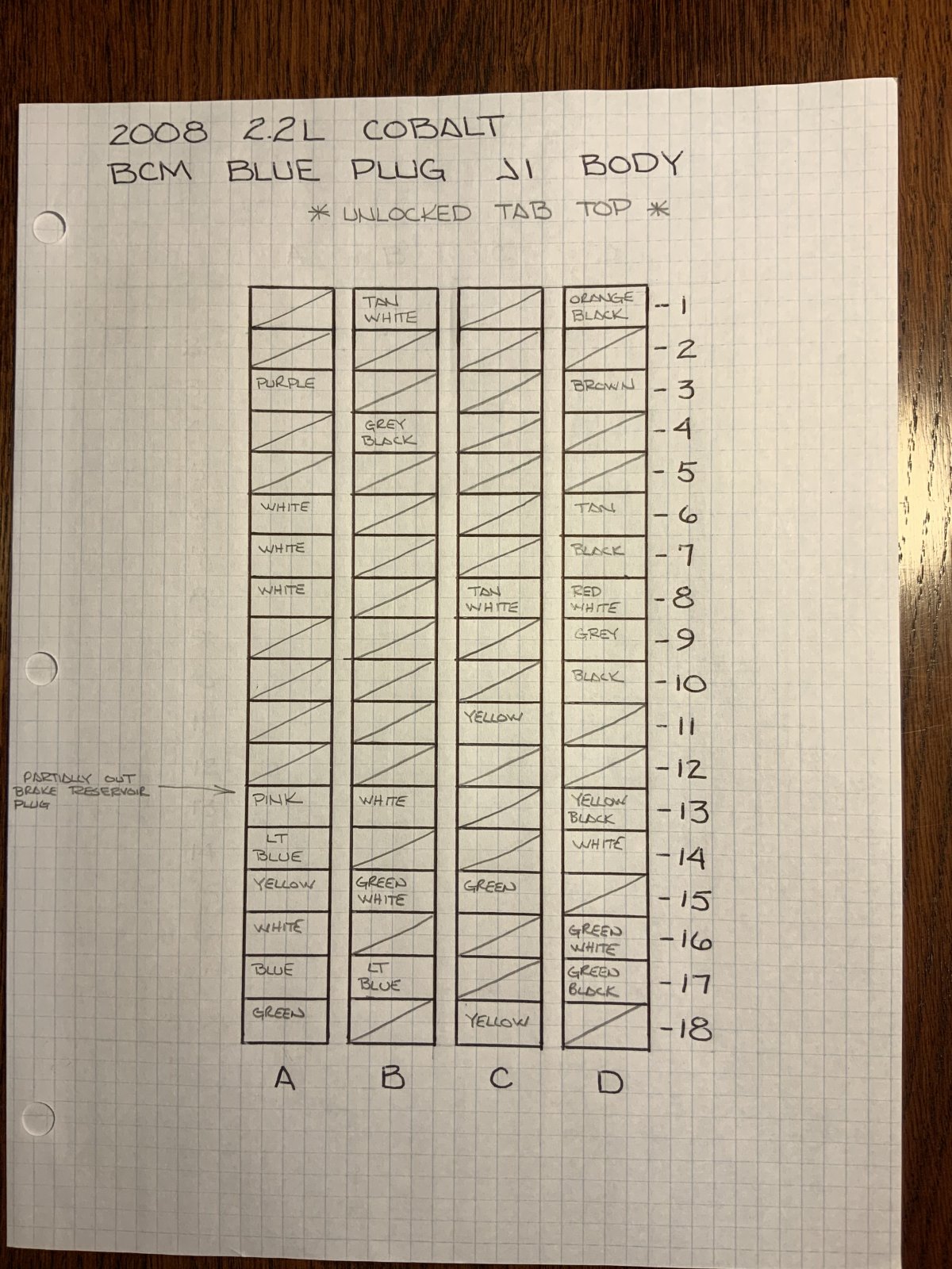

Good Evening,

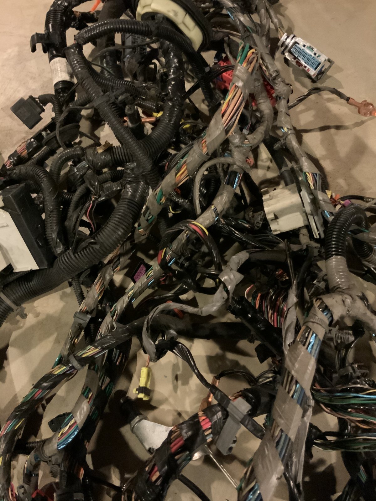

I posted a smaller portion of this (July 2, 2016). Basically they are my notes from the electrical portion of the build. Seeing that I was working on the original harness for the Goblin I updated a lot of my notes plus I was sick of trying the chase down where a wire started and terminated inside of the wrapped harnesses. First I’m not that great with a multi meter plus it always seem to be a distance that I can’t reach both ends any way.
So here goes...
This will actually be 12 individual posts.... one for each of the major plugs or blocks...
Starting with the BCM
1. BCM Blue Plug J1 Body

So this is the starting point...
Hope it will be helpful to someone out there..
