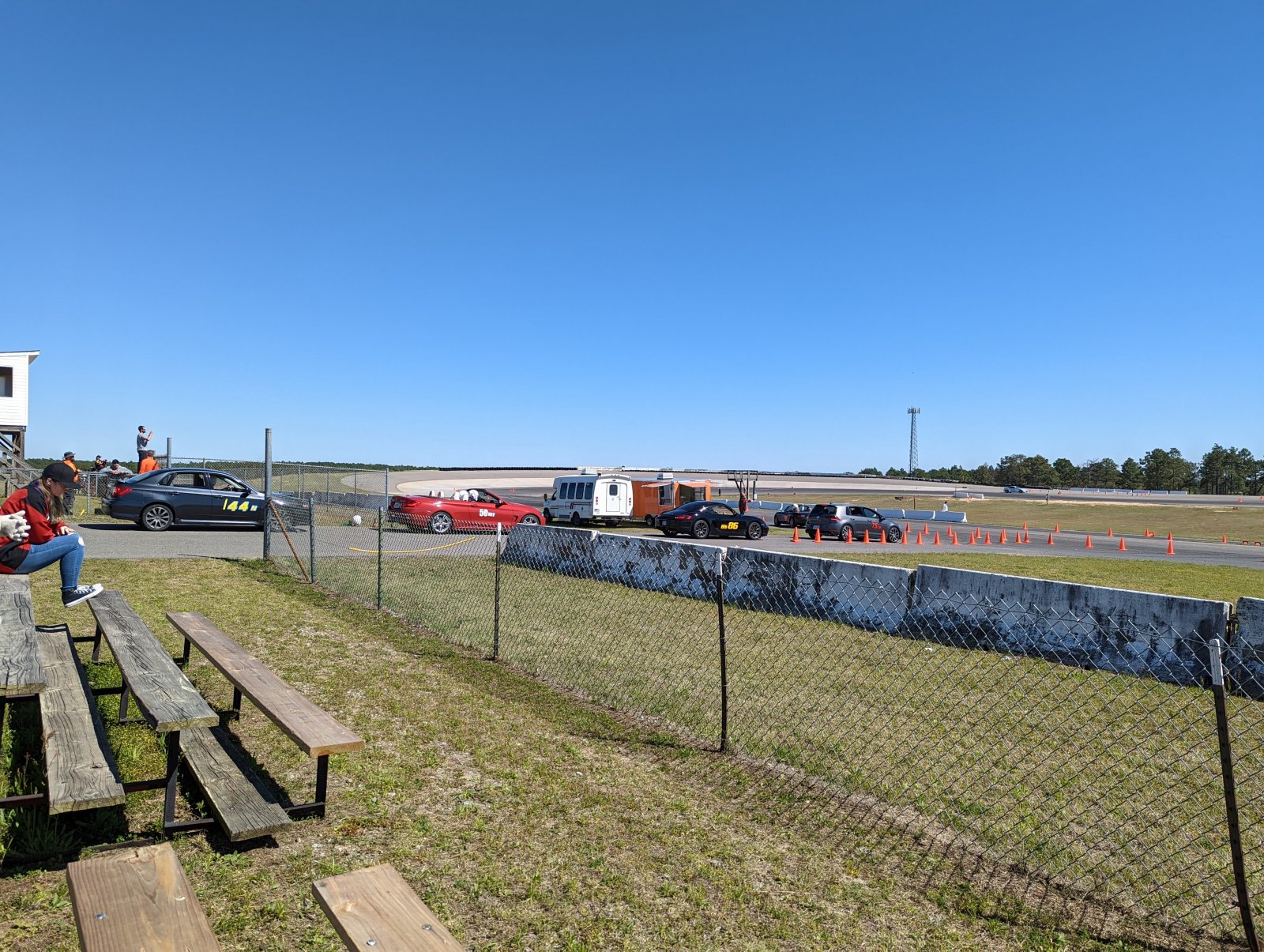

Overall a neat day at autocross yesterday, was on the "Little Rock" track outside the main Rockingham Speedway.
32235
32236
32238
From folks that do autocross a lot, there wasn't a lot of grip on the track. Surprisingly the banking wasn't too weird for me. Unfortunately I did end up spinning out on my first run... again... across the finish line. At least this time I didn't hit the cones at the finish, only after the finish. Whether that 1st run should be a DNF for taking out 3+ cones after the finish didn't matter since my 4th run was only .002 slower. Ended up that my 1st run was my fastest, when I tried to push harder on the 5th run I ended up sliding on the inner loop and being .2 slower, I figure I lost at least .5 from that slide. I'm not good enough yet to know if my tires really have any more capability but I didn't really feel like I had any more grip in the later runs or which direction I should adjust my shocks. I'm sure a lot of it has to do with smoothness on the inputs which isn't my strong suit so far, hence my spins at the finish. I'd rather learn my car better before replacing the tires though I will be replacing them at some point this year since my initial alignment badly wore the front tires (currently on the rear). I'll need to look into what type of tires I want but am kind of surprised at the current pricing, the tires I bought in 2019 are now 40% more expensive, they used to be on the cheap end.

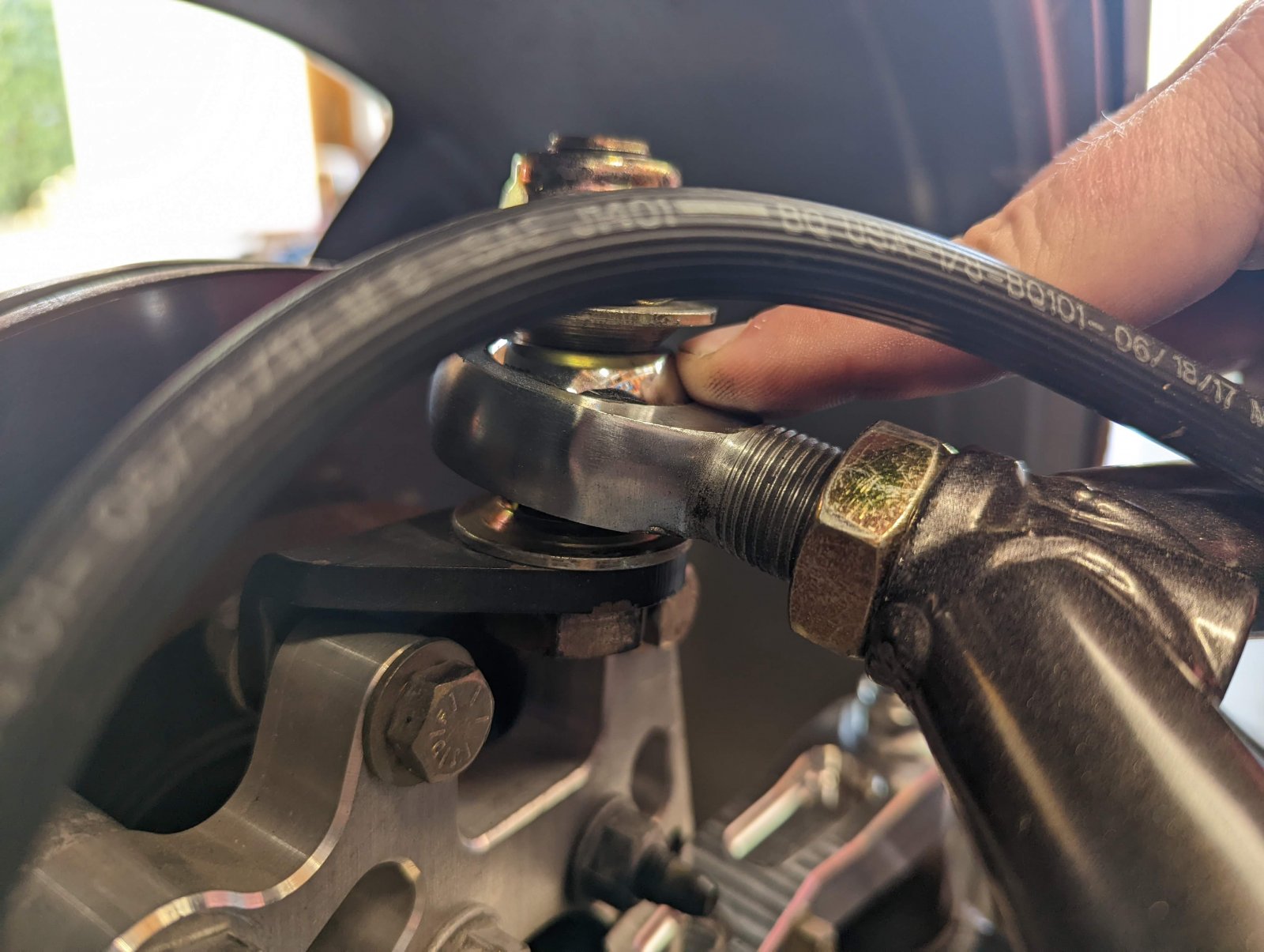

During tech inspection, they noticed a slight clunk when pushing/pulling on the front wheels. They still let me run but where wondering if it was the bearings. I took a closer look back home and it seems that it's the heim joint sphere inside of the bushing. The portion I'm pointing at in the picuter. With a finger tip on the sphere, you can feel it move relative to the eye bolt portion (not sure of the correct names here). The bushing isn't moving, just the sphere. It's not a slip of the upright bolt within the sphere, and it's not the threaded end of the heim joint to the control arm. I don't see any correlation between the distance threaded out and this clunk, the lock nut has remained solidly tight and any wear on the bushing should be independent of the threaded length, after 2 autocross events with 2 full spins I feel comfortable with the engaged length on a car this light. I feel a very similar movement on the driver side, maybe just slightly less clunk sound though. I don't feel any clunk from the lower heim joint, either driver or passenger. You can feel the clunk through the upper control arm when pushing/pulling on the wheels (makes sense with it all being bolted together), and nothing on the lower control arm. Not sure if I should order some replacements for these upper heim joints or if this is typical for heim joints. Maybe others can confirm if pushing on the top of the wheel produces a slight clunk/movement from within the upper heim joint?

My upper heim joints can swap sides (top passenger <-> top driver and bottom passenger <-> bottom driver) but my lower heim joints are left hand thread instead of right hand, so I can't swap top to bottom. I probably should just buy 2 of the right hand thread type to have ready to swap in.
Have you tried to tighten the through bolt? Mine was making a similar noise after a few autocross and figured it was a little loose. Gave it a little extra tightening and all noises stopped. Those heims are pretty stout. Wouldn’t think you have a problem with one.
baustin
I'll double check the through bolt torque, maybe the tightness deforms the sphere a little so it's a tighter fit in the bushing.

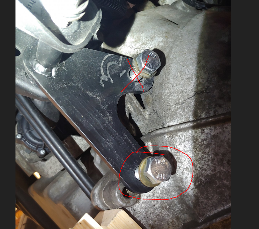

While wiggling the front wheels confirming the clunk at the front was actually the heim joints, which it definitely seems to be, I noticed a jingling sounds coming from the engine area. I checked all around and found the jingle was the washer on the lower bolt to the transmission from the front solid mount... the upper bolt was nowhere to be seen and the lower was halfway out... yay. There were circle marks where the washers had been clamping the bracket so I know I had definitely torqued them down after finishing the paint on the bracket and installing it.
*this is an old pic copied from when I first was installing the transmission mount, X bolt was entirely missing, circled bolt was halfway backed out*
32250
I guess I'll be buying a pair of new grade 10.9 M12x35mm bolts with M12 washers tomorrow. The one that I did find could be threaded out by hand and definitely has the thread peaks flattened slightly so it's a throwaway bolt now.

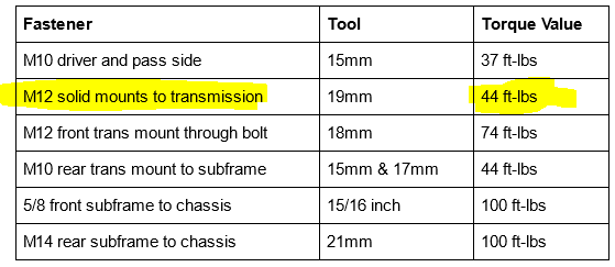

I don't know what torque spec I used previously since it was a while ago but I assume it was in the range listed below. I think these 2 bolts are the 'M12 solid mounts to transmission' and should only be 44ft-lbs since they go into threaded aluminum of the transmission.
snip of Adam's installation guide link here

There's no locking feature with the bolt or flat washer, I want to use some sort of locker so I would lean towards a liquid thread locker but not sure about it being the aluminum case of the transmission. I do have the blue type in my garage already. Any thoughts on what locking method I should use to prevent these from loosening again?
Blue liquid thread locker will work well in aluminum. Also will prevent corrosion/thread galling.
Otherwise you can use thread anti seize with a lock washer. Both methods work.
baustin
Yeah I'll probably do the blue thread locker. Lock washers is a subject I don't want to dive into, mechanical engineer here and I work in the electrical design world where lock washers are a real pain even when done correctly. I really don't want to dive into lock washers... I think that's even been brought up on this forum, always is a topic that is very intricate.
Or lengthen the bolt by 5mm and double nut (lock nut) the bolts. ;) Oops, thought these were though bolts - nevermind!
Ha, yeah. No problem, it's soooo much easier to ensure lock if it's a thru hole.
