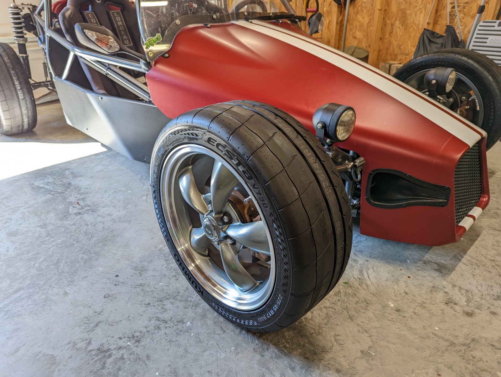

I'm always curious to get the perspectives of folks with similar, but not the same, choices as mine.
What draws you to the A052? And what led you to the V730 over the RT660? I'm running the RT615K+ in the same size and like them. I chewed up my fronts with bent lower rod end mounts (since replaced and realigned) and thought about replacing with the RS4 but decided to stick with the RT615K+ as my rears were still good and wanted to match. Thanks for your input!
I'm sure there are a bunch of good answers for tire choice and it probably just comes down to preference and if the cost is acceptable to you. I used grassroots motorsports info, tire rack research, and if I looked at any car specific forums I tried to limit it to lightweight/open like Ariel and Lotus models. There's a lot of tire research but a lot of it is focused on typical weight cars that just impact their tires very differently than a Goblin. It seems like most of 200 tread wear tires get compared to either the RT660 or A052 if reviewed on 1 on 1 basis.
Priorities:
  • fits 17" x 7.5" wheels, likely sticking with 225/45R17 unless the actual dimensions are similar but listed as alternate size.
  • grip level - Especially easy warm up to get grip since the Goblin isn't a heavyweight vehicle overstressing the tires, Miata's are still heavier so even their data skews to more heat in the tires.
  • price - I'm not going to be buying tires every year and prefer to have a set that last more than just 2-3 years.
  • tread wear - I don't want to be beyond all of the good rubber on the tire after a few autocrosses. Previous tires were 340 tread wear and had great grip initially but it too quickly faded to being hard. I'm concerned the 100 tread wear category won't like my primary street driving, including into the cold mornings in later fall and early spring.
  • easily available to buy
Minor Interests
  • I prefer to be able to swap wheel locations for a full front>back / back>cross rotation, I have a square wheel setup for this reason. I prefer an inside/outside tire not directional so the wheel can go to any corner if needed.
  • noise, quieter here is much better

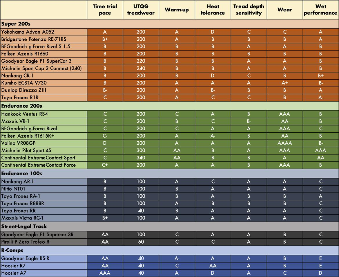

From grassroots motorsports testing (link):
35547
Tire Racks testing report:
https://www.tirerack.com/tires/tests/testDisplay.jsp?ttid=273
The resulting list from tire rack (excluding closeout options) in order from low cost to higher:
$146 - RT615K+
$164 - V730
$168 - RT660 - directional
$190 - RS4 - directional
$197 - N Fera Sport R - I have no recommendations for/against Nexen but I don't want to be the guinea pig here
$207 - Proxes R1R - directional
$213 - Rival S 1.5
$216 - Direzza ZIII
$226 - AD09
$231 - Extremecontact Force
$237 - RE-71RS
$238 - A052
$258 - AD07
Given the costs available from tire rack, that narrows the list down to RT615K+, V730, RT660. In my opinion, the RT615K+ would be better for a heavier car or if I was seriously tracking/racing frequently. Since the RT660 is directional and the V730 is inside/outside, that tipped the scales to say the V730 made the most sense for me. I think when I was looking a few weeks/months ago, the V730 was more towards $185 but it wasn't when I checked this week.

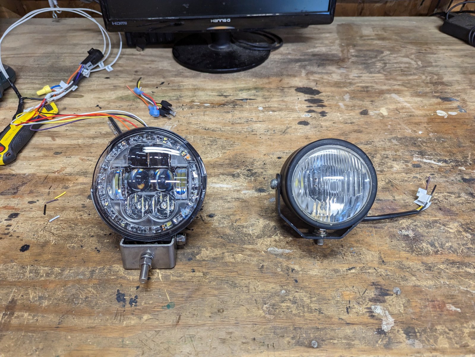

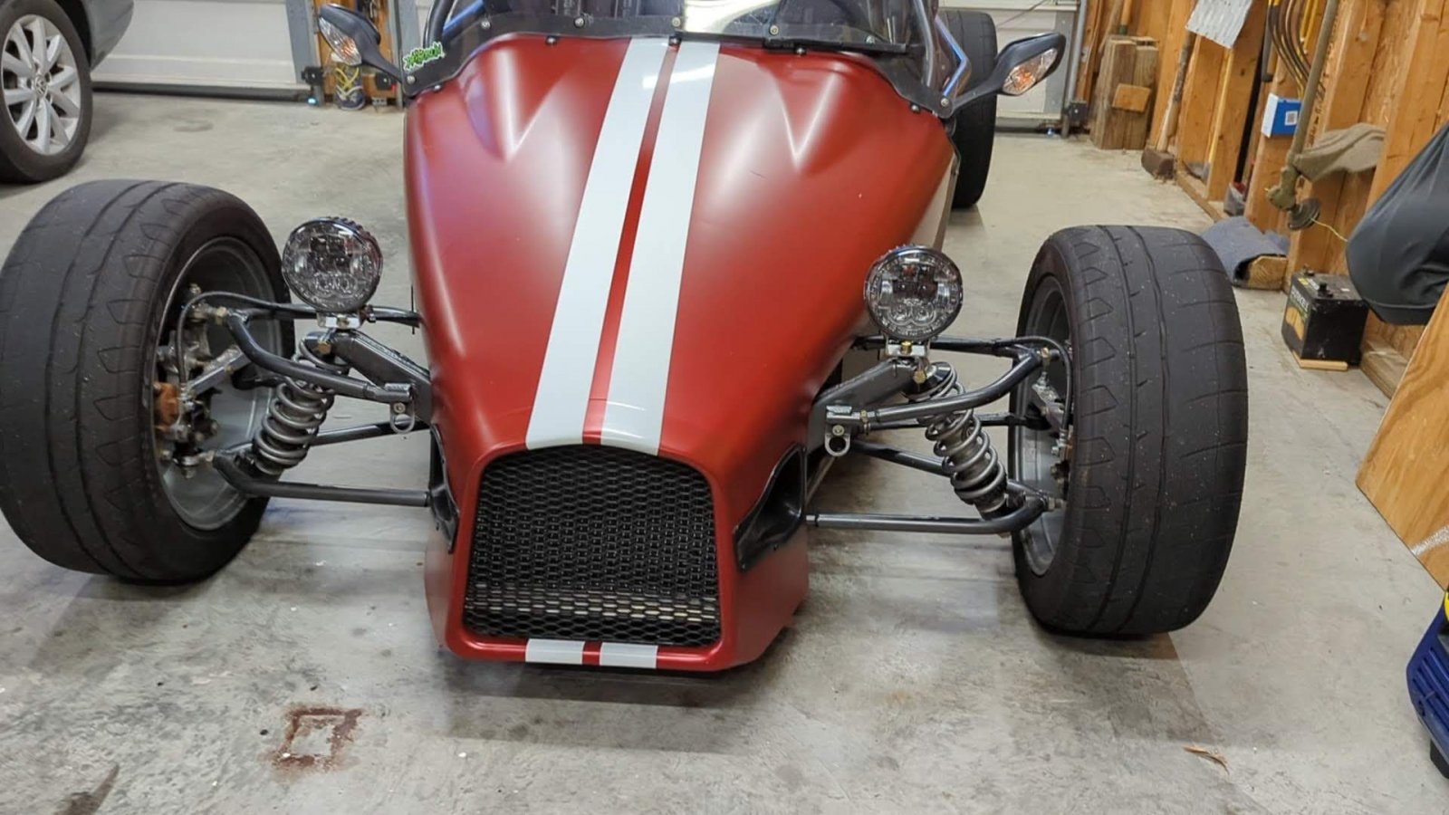

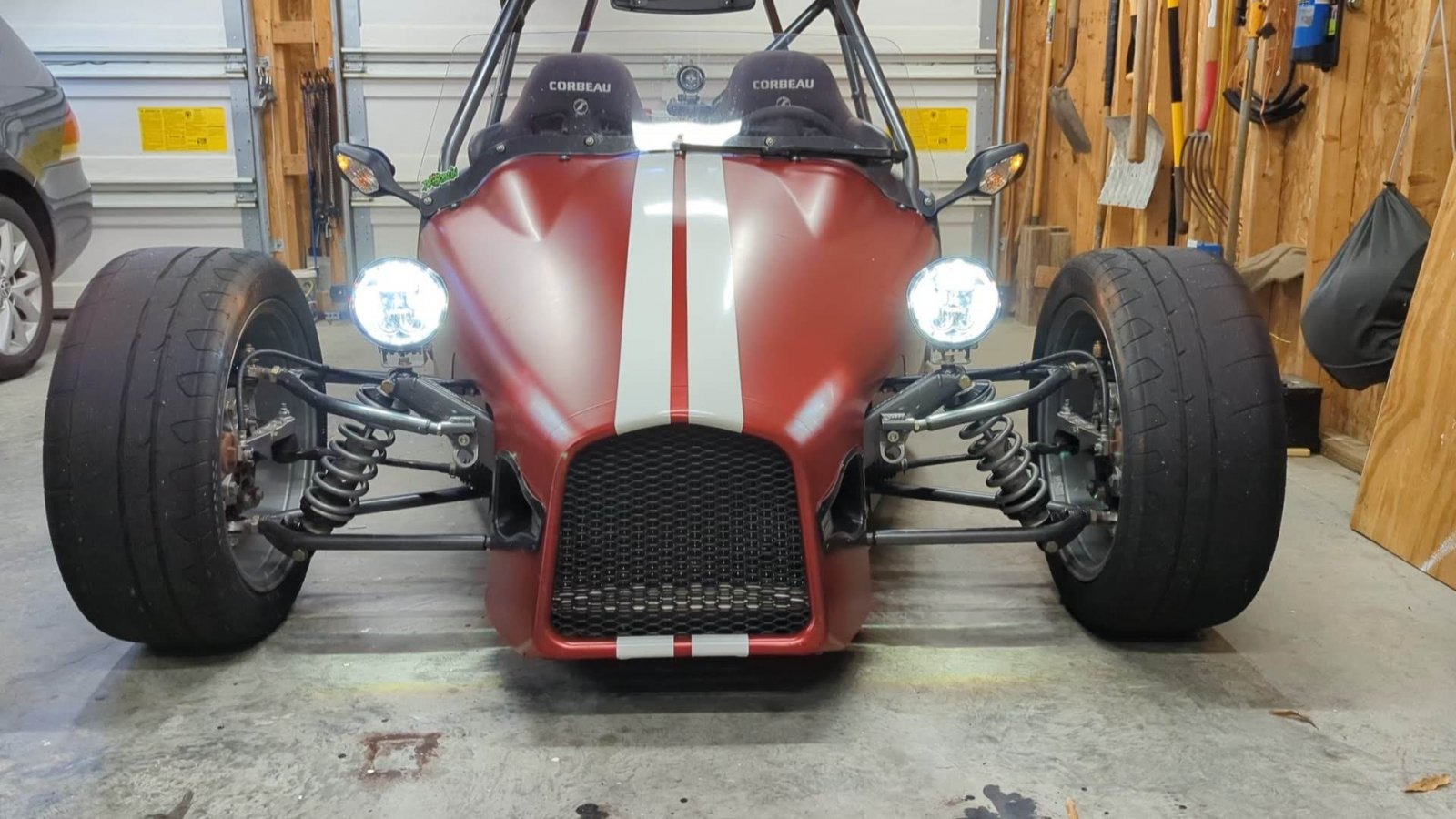

New headlights are installed! Definitely brighter lighting and sharper cutoff than the Dominator's with LED bulbs. A lot more expensive but these are way better. Not cheap but I was feeling blind when driving under green lights since my headlights couldn't shine bright enough to illuminate the road beyond the brightness of the intersection + green lights... Yes it's possible my LED bulbs had darkened with age.
JW Speaker Model 8632
https://www.jwspeaker.com/products/led-headlights-model-8632-evolution/
Specifically I got the 2 light kit with side marker for US traffic (part number 0551983). This kit comes with the pedestal mount which is an exact fit to the DF Goblin bolt points, this is as close to bolt on as aftermarket parts can be on a kit car. These are DOT stamped lights though it hasn't mattered for me yet.
40844
A little bit of cutting/soldering to reuse the connectors I had on my previous lights:
40845

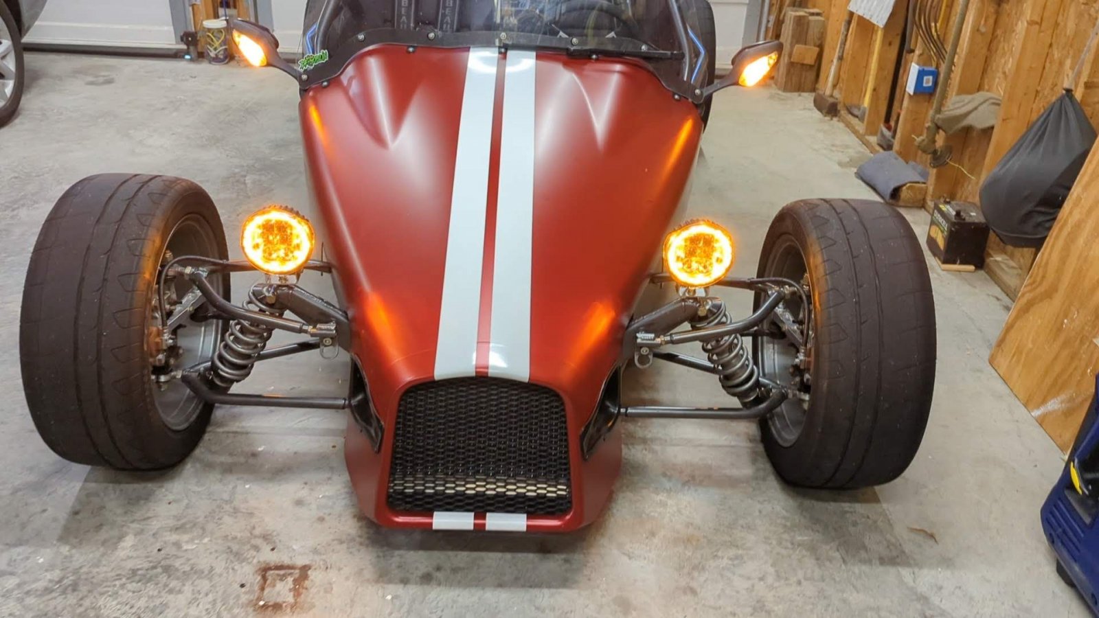

These lights have: high / low / marker (aka parking or position) / turn / DRL. There is a white halo ring and a yellow halo ring, the yellow replaces the white if both are active.
In my '06 setup I don't have a dedicated DRL circuit, Chevy just runs the front turn signals solid for the DRL. I decided to hook up the yellow halo to the turn circuit which means I have front yellow halos and side mirror yellow bulbs on when DRL is active. I connected the white halo to the marker/parking circuit so I have some front light when using marker lights in parking decks or similar. The marker circuit is also active when the low and high beam lights are on.
Low beam on:
40847
DRL on (actually flashers when lights are on):
40848

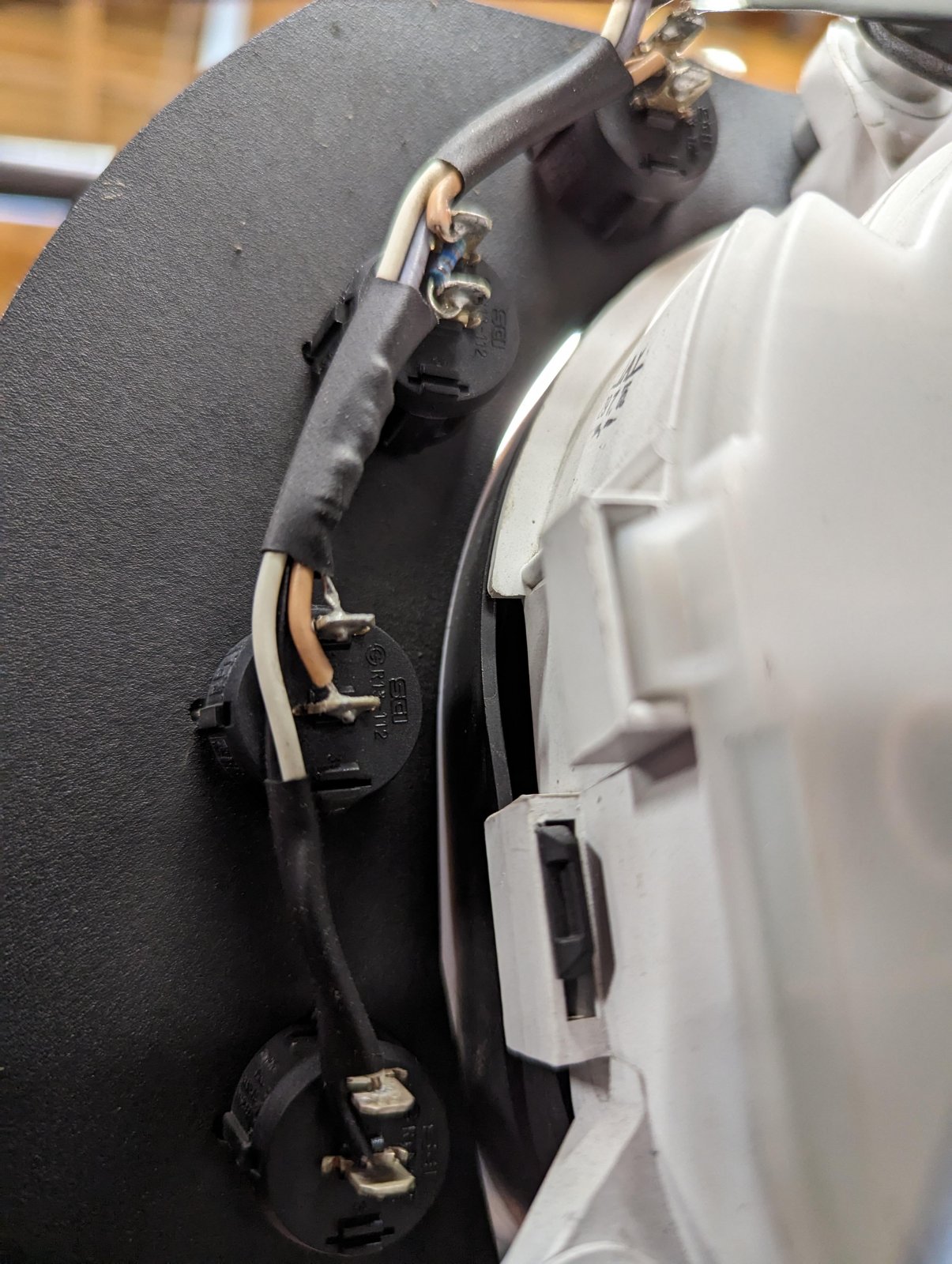

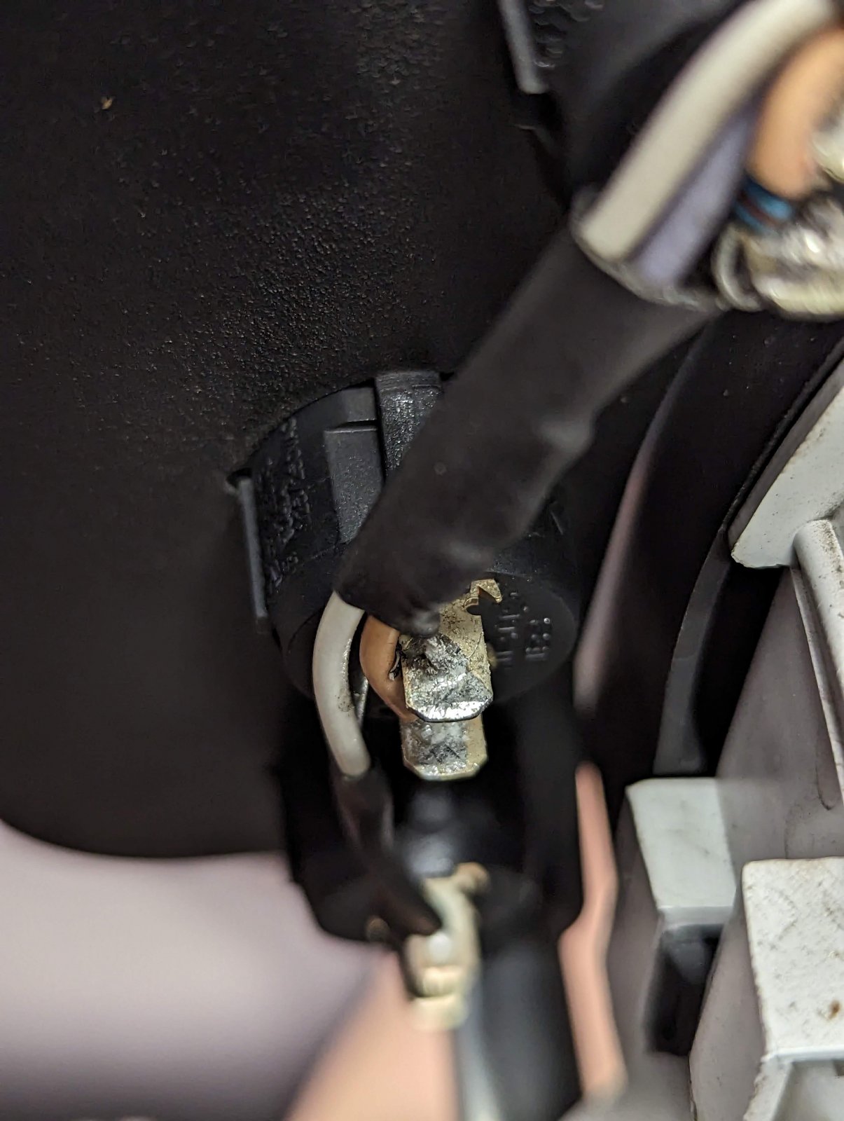

It's been a few weeks now since I revisited my cruise control almost entirely not working. I'm checked the brake and cruise pedal switches, both looked like they were in the correct position and I tested with multimeter and got the change from open to closed, or vice versa, that made sense.
Next up was the wiring on the back of the cruise control buttons. My dash button set was one of the early sets DF sent out where they soldered it all together for me before shipping. I have the entire dash routed to a multiplug so I disconnected this and toggled the buttons to see the total resistance values (mine being early model is different than later models for cruise) and compared them to the info that Lonny posted paying attention to the early model differences. I couldn't get a good resistance value which seemed odd, it kept changing.
The wires were all fully soldered to the tabs just like when I received the dash button set, but looking closer I found 1 wire from the set/- button had failed insulation going around the other set/- tab. I think the BCM kept seeing that I was pressing the set/- button to drop the speed down since the dash button was being bypassed. This arcing through the insulation also explains why it would feel like cruise dropped out occasionally going over large bridge bumps since the wire would move and touch.
The resistors and wiring inside the original heat shrink was all just fine, full image of that side is below. The only concern is the tan wire from the set/- since it didn't have any additional insulation where it was tight around the upper tab.
I took the dash buttons to my workbench and cut away the existing heat shrink so I could loosen the wire bundle and apply some targeted heat shrink and electrical tape on these wires. Now the tan wire isn't tight against the upper tab of the set/- button. Cruise has worked perfectly since then, no issues whatsoever. I just didn't take any pictures before reinstalling in the car. Easily a few hundred miles of driving since then and cruise works again each time.
All the original soldering was still good, all the pedal switches were working correctly, that 1 tan wire where the soldering had melted the insulation and it finally wore through enough to arc seemed to be my problem. Not a big problem, I just didn't catch that would turn into a problem during initial assembly.

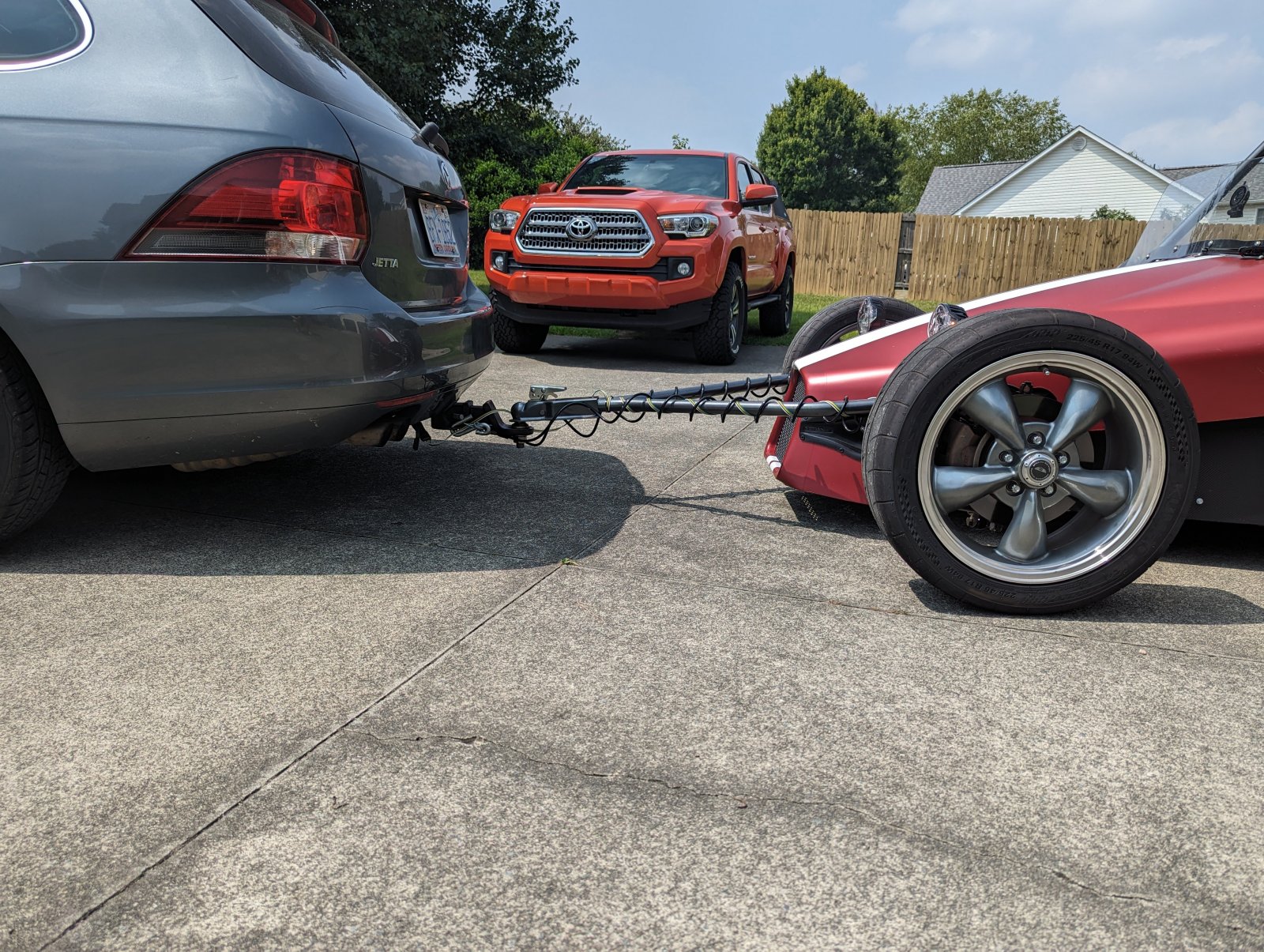

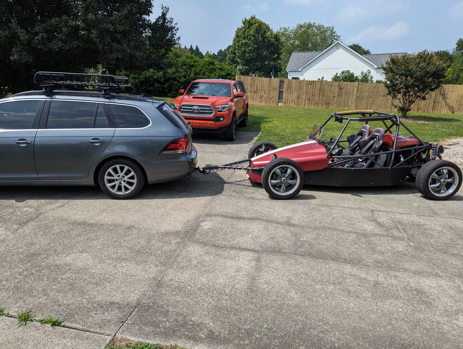

For July 4th weekend, we took a family trip but I would need to come home before my wife and kids. Solution was to flat tow the Goblin behind my wife's car instead of my truck (have done that setup multiple times in the past). Her car is a 2012 VW Jetta Sportwagen 2.5L 5 cylinder gas engine, typical style 6 speed automatic not DSG. We've had a 2" tow hitch on it for years for hitch basket or possibly a utility trailer but didn't have any light wiring installed. I got the light module installed to plug in the Goblin wiring like I do on my truck and it was ready to go!
We sure got a few odd looks from folks confused by what they were seeing but it worked well. I did put the VW transmission in sport mode to hold torque convertor lockup and I think we got about ~18-20mpg depending on speed while towing which isn't too bad from her normal of 23-25mpg. The gas 2.5L doesn't get anywhere close to the mpg that diesel VW's get.
