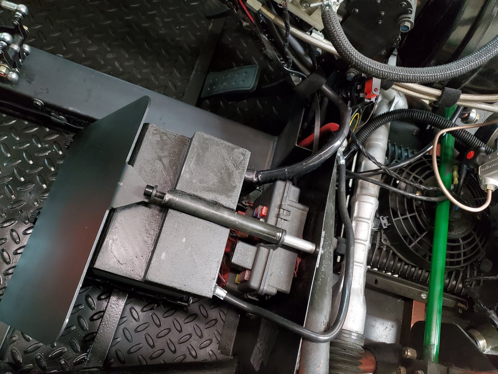

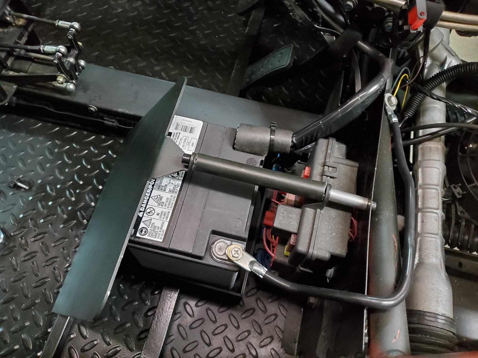

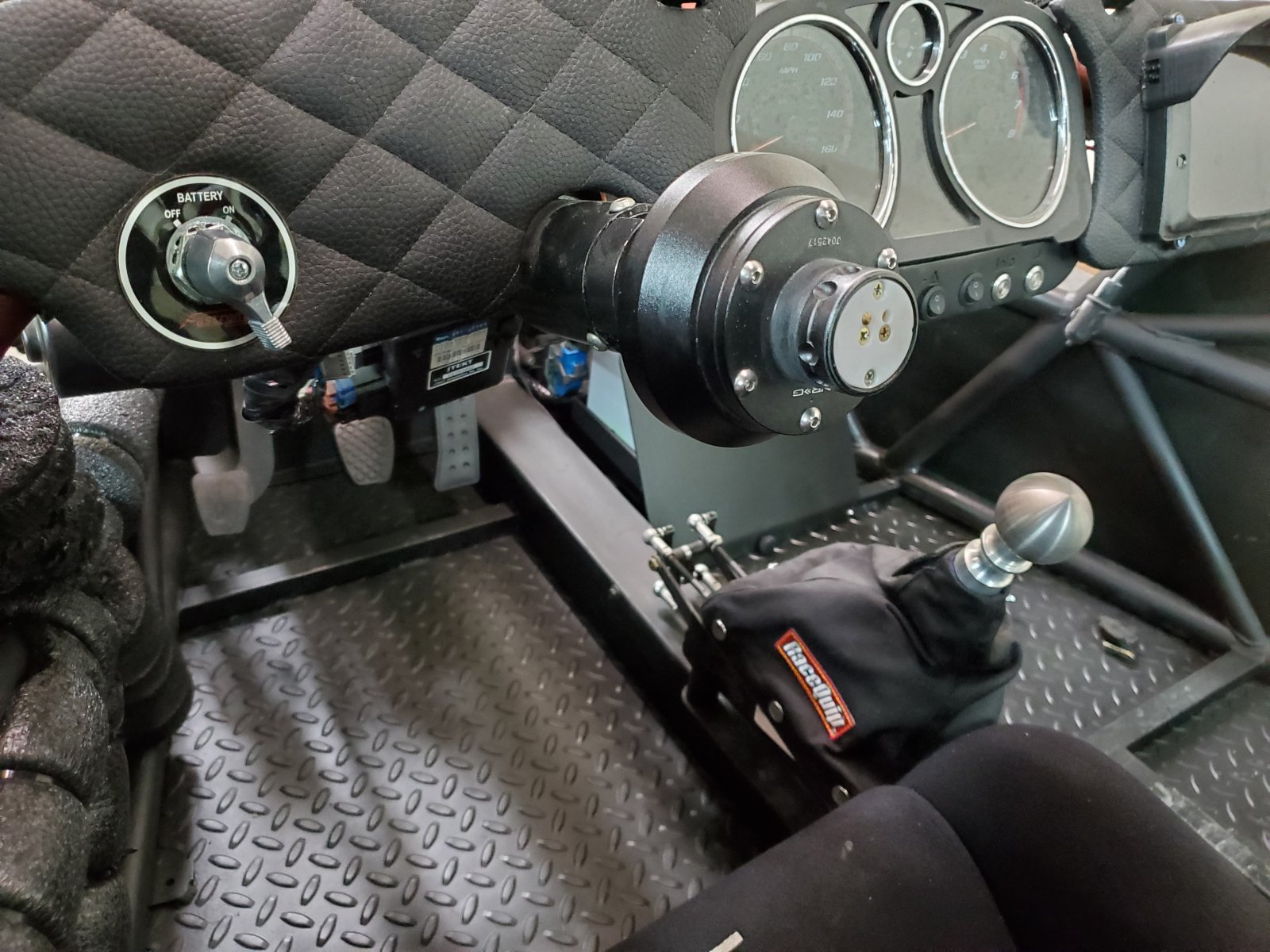

Relocated my battery and ground mostly due to wiring in a shutoff switch. This opened up some space and will able to fully disconnect the battery and not worry about drainage.
E-mod rules look like a master shutoff was added if your not running DOT approved tires. Having the switch also allows me to run whatever cheap takeoffs I can get.
Purchased a battery relocate kit ran a 2g wire to the starter and took the alternator wire off the starter. Now the alternator runs directly to the pos battery post via another 2g wire that feeds to one side of the shutoff switch and the other goes back to the starter and power steering.

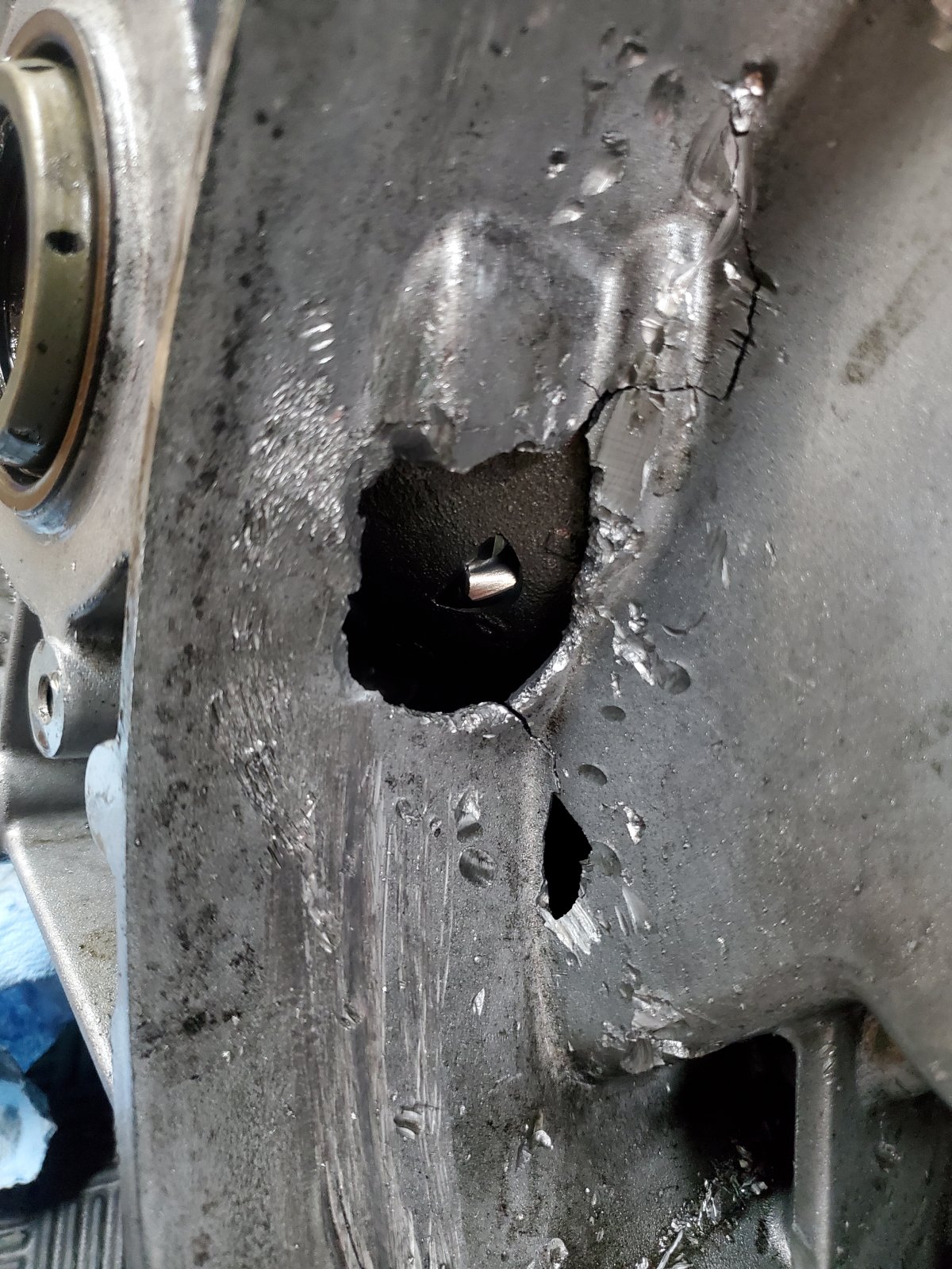

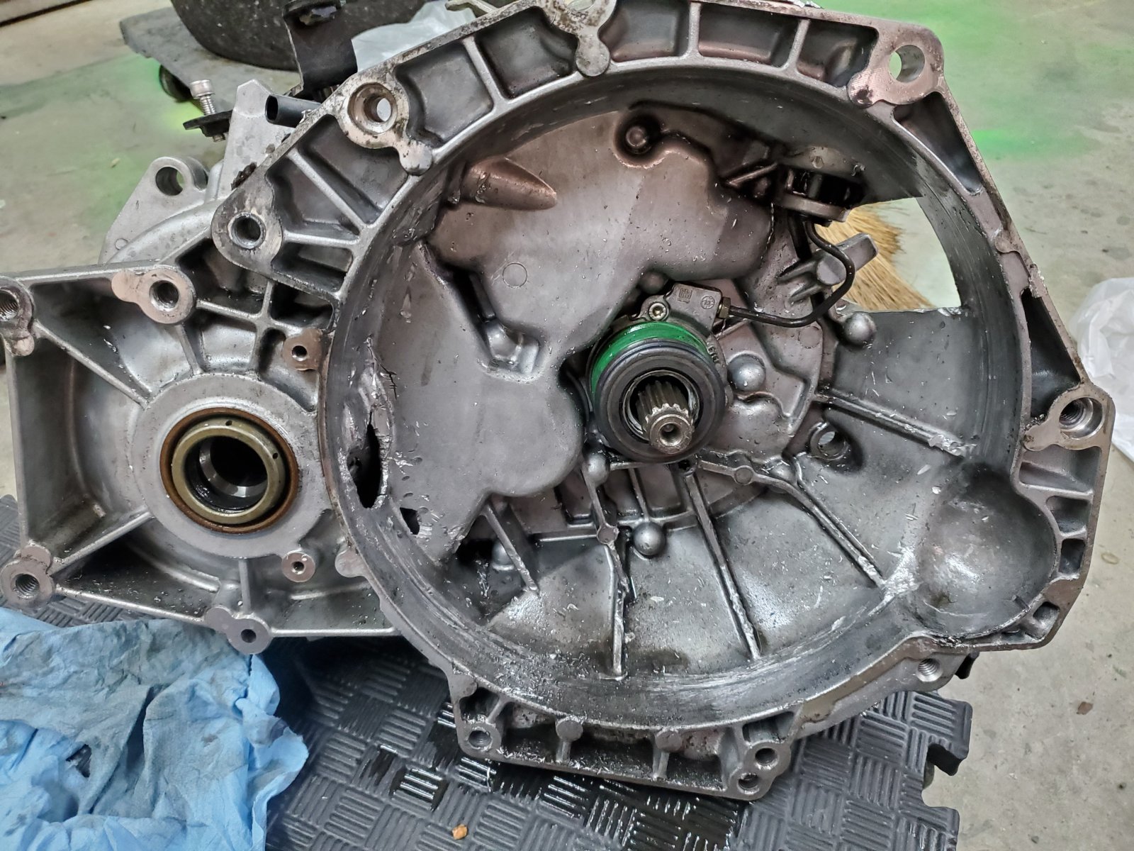

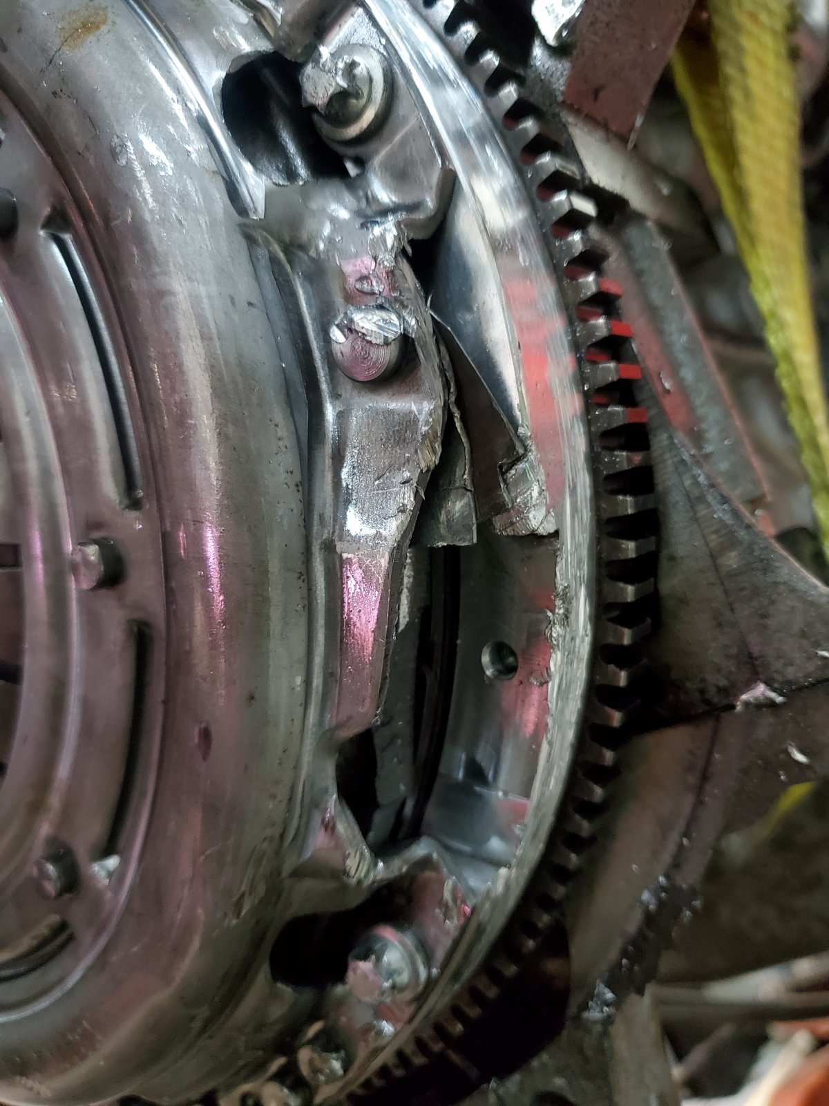

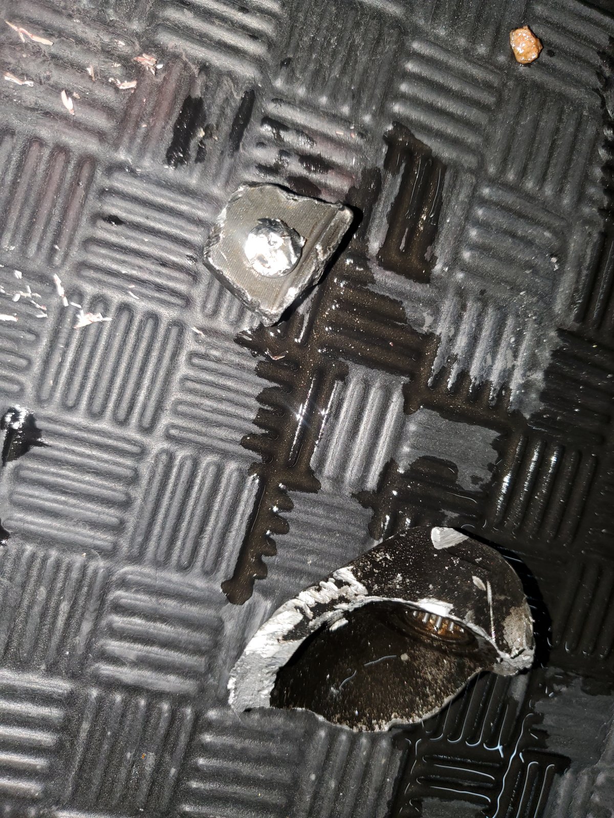

Got the car out to a a local practice this Saturday to do a shakedown. Got 1 good run in and on my second run heard a loud bang then loss of power. Was able to drive the car back to the trailer with a ticking noise. Gear oil was seeping out and found a large chunk of the pressure plate.
Somehow part of the pressure plate came off broke the starter, destroyed the aluminum flywheel and managed to knock a hole in the new f35 transmission.

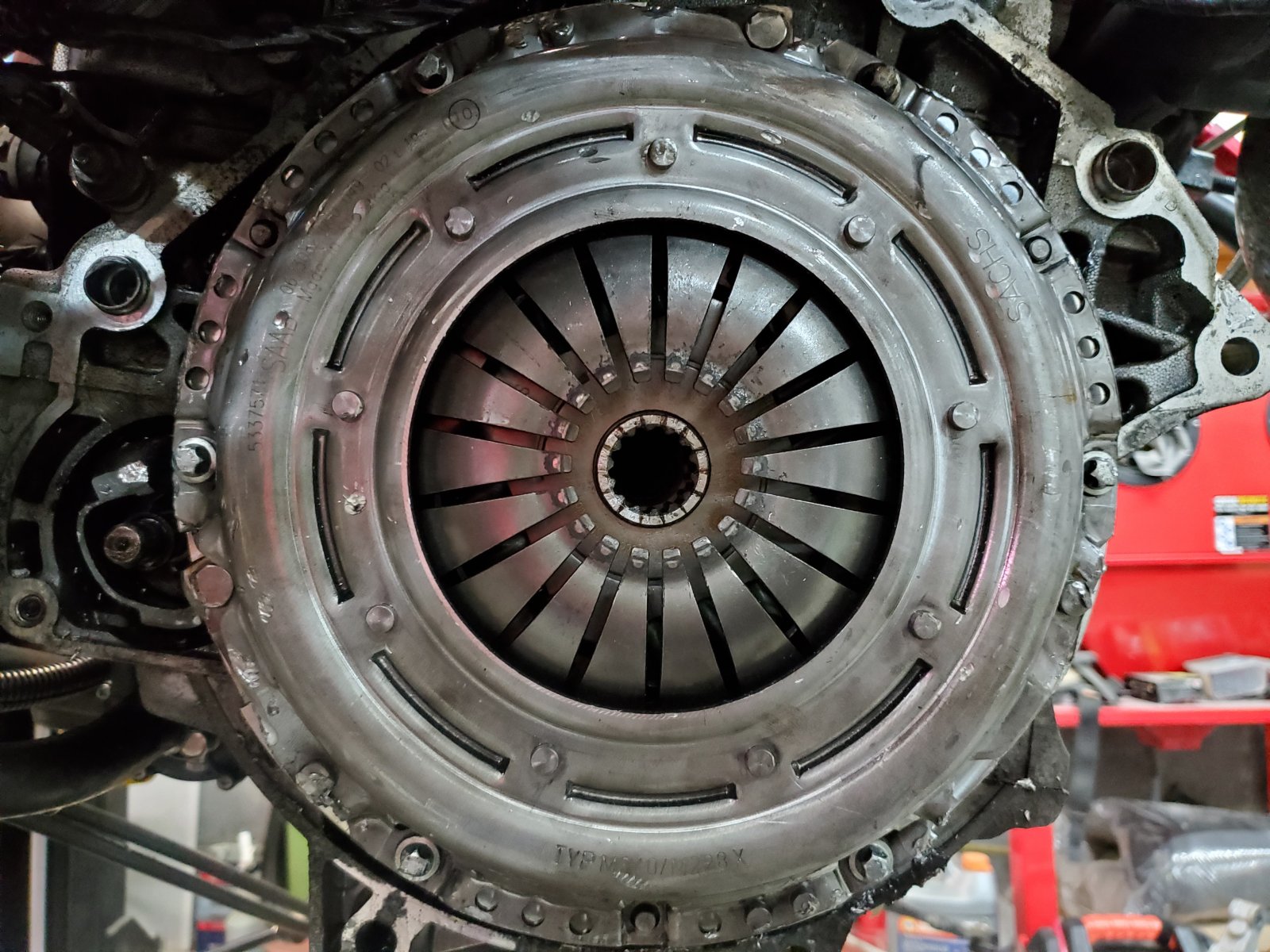

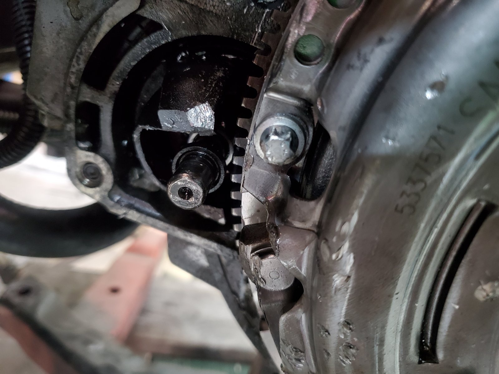

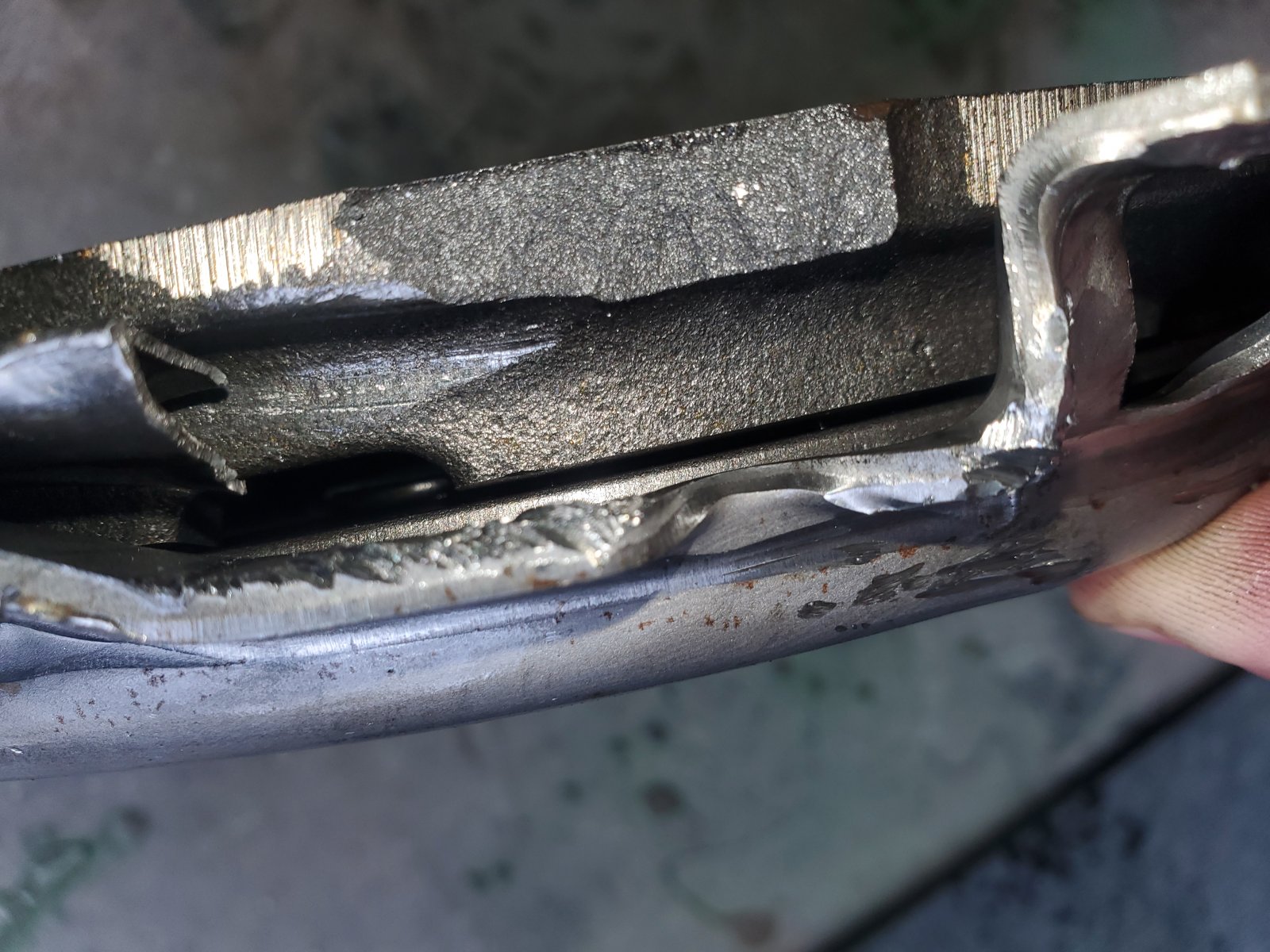

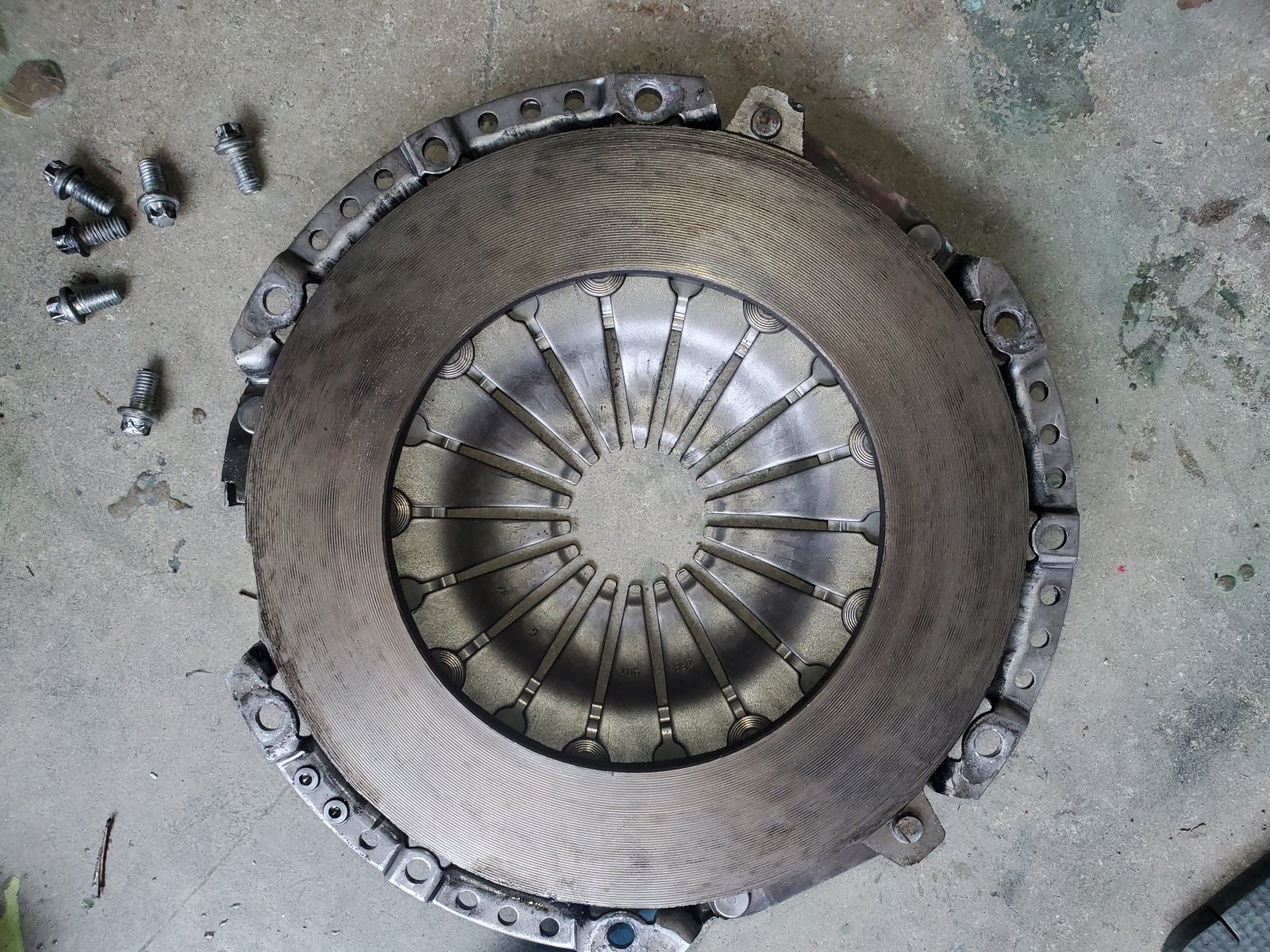

Looks like one of the fulcrum tabs broke off. I thought pressure plates usually crack or break. Got the new starter in yesterday and pulled the flywheel. New oem flywheel bolts pressure plate bolts and the act flywheel comes with new bolts also are on the way. Don't know if I trust this aluminum flywheel after it's been all scratched up.

What do you think caused the break? Too much power? Weak component? just a failed part that probably shouldn’t have?
ccannx
Half a small bolt fell out when I cracked the case off the block. Best I can guess it got between the friction surface and pressure plate. Never too much power ! it should just slip in that situation.

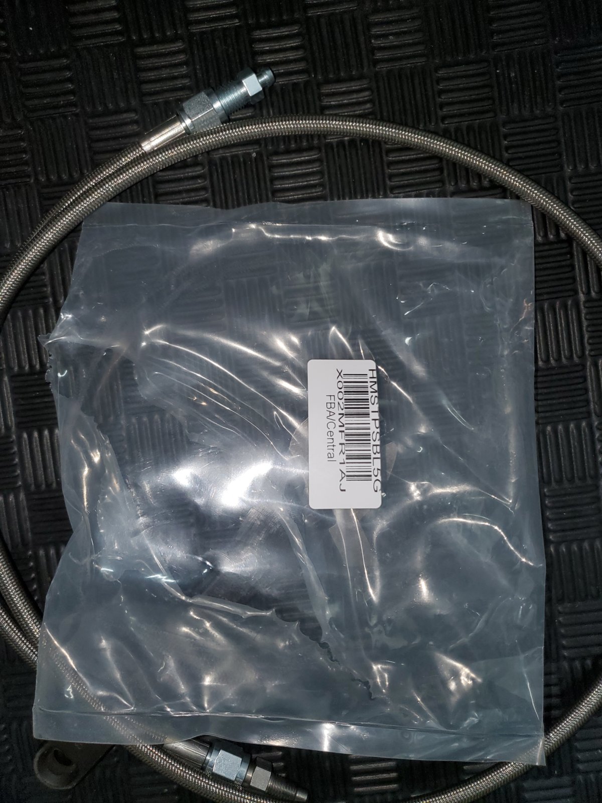

Good news ! The Amazon remote bleeder ordered fits , this will make purging the air out of the throw out bearing much easier.
Got a link to this part? It would've been pretty clutch (get it?) before I installed the trans and bled the slave but for the right price I might go ahead and throw it in the car anyway. I remember putting my engine/trans back together and thinking there was no way I'd put the clutch hydraulics back together correctly because how could you EVER bleed the clutch with the bleeder tucked away like it is... but from the condition of the brake fluid that came out of my donor, the answer was probably just "don't bleed it".
ccannx
Here you go !
