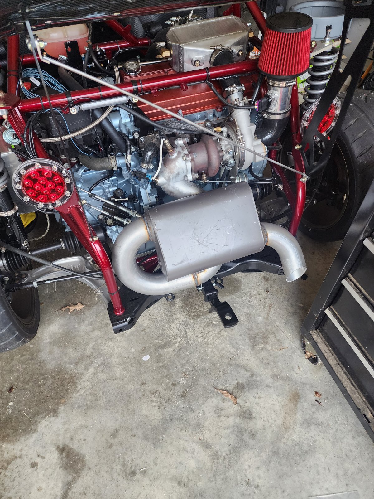

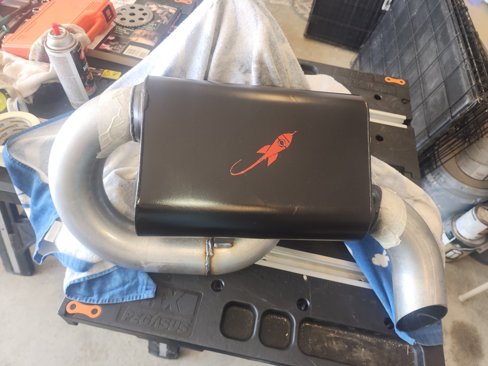

Are you having any issues with the MAF being on the cold side of the turbo? How is it supposed to read boost pressure at this location?Entertainment and Exhaust installedView attachment 40070
You are correct but wouldn't the flow change on the hot side of the turbo? I am just used to seeing the MAF on the hot side in most builds. I may be mistaken wouldn't be the first timeMAF doesn't measure boost. MAP measures boost. He has basically a factory layout, unless I'm missing something.
Learn something new everyday thanks.Volume of air doesn't change. Air into turbo equals air out. There are reasons why blow through maf is considered better, mostly in relation to a BOV. But the stock system is designed as draw through with recirculating air.
