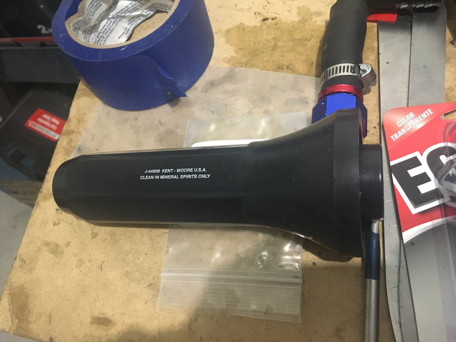

When you replace the axle seals, this tool will save you a big headache!

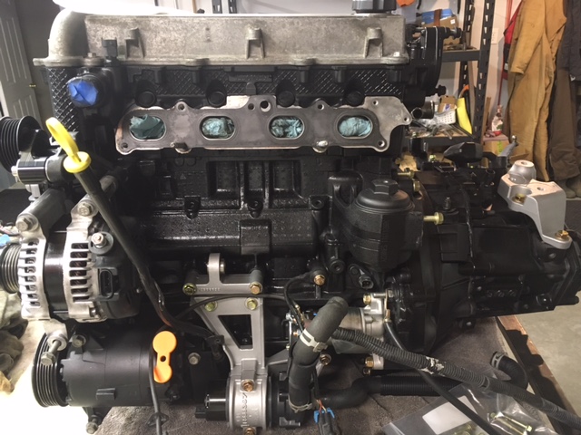

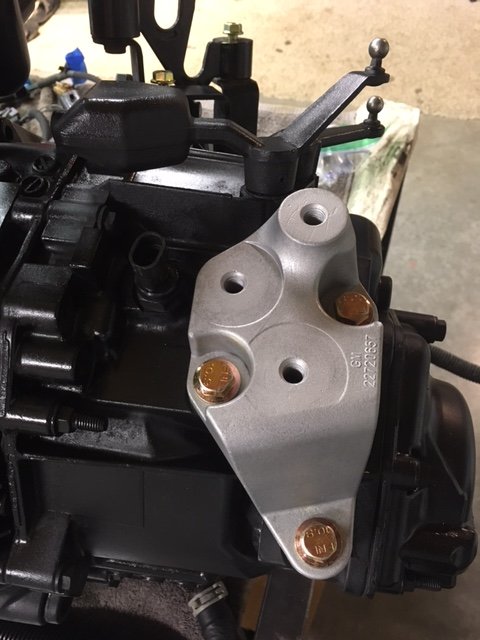

Still working on cleaning up all the parts and the engine. I've painted the engine and will post pictures soon as I get it together more. I was a real pain to tear much of it down and clean it up and paint it, but in the end I think it will be worth it. I don't plan to run a cover over the engine so it will be mostly exposed.

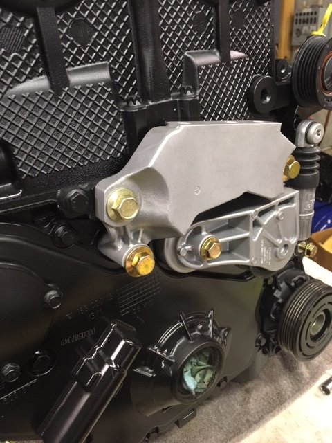

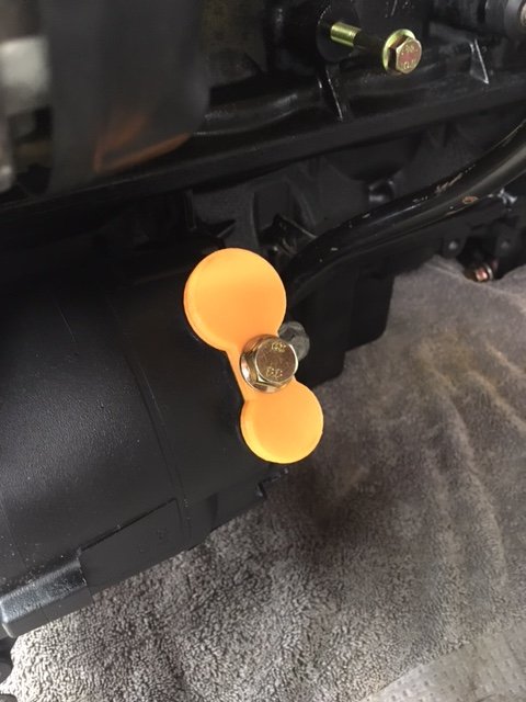

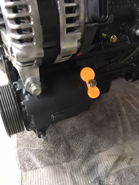

Here is a little teaser of what I have been doing. I removed the guts of the AC compressor and I'm just using it at a bracket for the pulley. You could almost get by with just the two front mounting bolts and leave to rest of the body off of the compressor but I was afraid of putting the pulley and bracket in a bind under tension from the belt. Not wanting to get the compressor full of water and other debris, my son designed a cover for the ports and 3D printed it for me. I think it turned out nice.

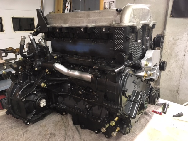

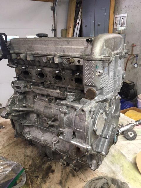

I'm overdue updating my build. Been busy reading and watching everyone else. Actually I've been plugging along just cleaning up the engine and making it a bit more presentable. Here is a before shot. What you can't see it the extreme amount on oxidation from all of the moisture and salt over the years. The whole outside was a powder. I just couldn't stand the sight of it. Seems like many of the other engines posted looked much better. This is after hours of a wire brush on the die grinder so it doesn't look too bad.

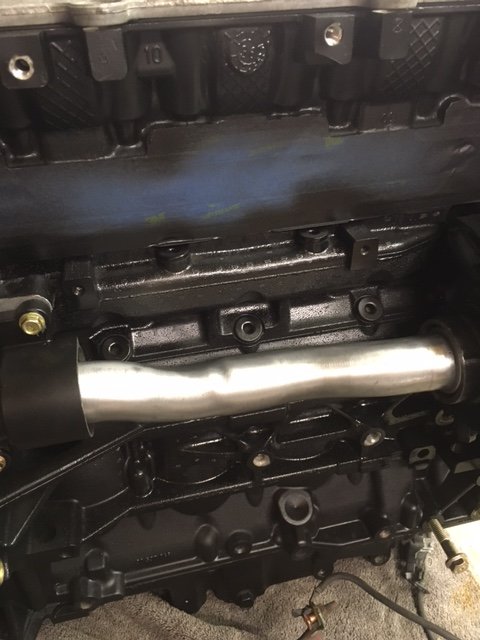

This is after painting with a ceramic engine paint from Eastwood with activator. I really liked the paint and how it sprayed on or could be brushed. A little paint went a long way! I hung the engine from the loader while painting it and left it out in the sun for hours to bake.
Many of the smaller pieces I took to the local precision machine shop and they have some type of bath and blasting that they do that makes the cast parts look better than new! I was so happy with the outcome I'm addicted to it. They are so clean that the least little bit of dirt or oil on your fingers will show up. I had to darn near wear gloves until I could get a coat of clear satin on them.

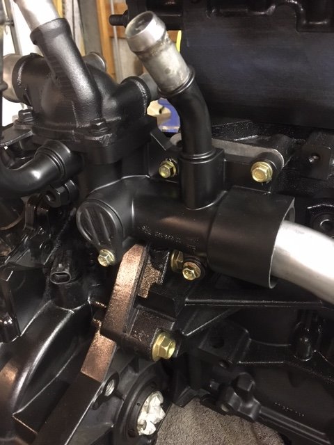

Also replaced a lot of the old rusty bolts with yellow zinc coated flange bolts from Fastenal. Chased all of the threaded holes with a tap to clean them up. Nothing like a new bolt in a new hole. Everything went together using my fingers and then a torque wrench to finish them off.
I cleaned up and polished the pipe and finished with a light wire brushing and then a clear coat.

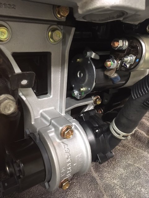

The bottom bolt of the thermostat housing was a real pain to find. Only one place on the internet had that size/length. That is a $9 bolt with shipping.
Still working on putting everything together so not everything is bolted down tight. I had to replace the starter because one of the terminal broke off trying to get the nut off. It was just a problem waiting to happen. And yes, that is a new Bosch pump. I found out my original was dead, brushes were worn completely down-gone!

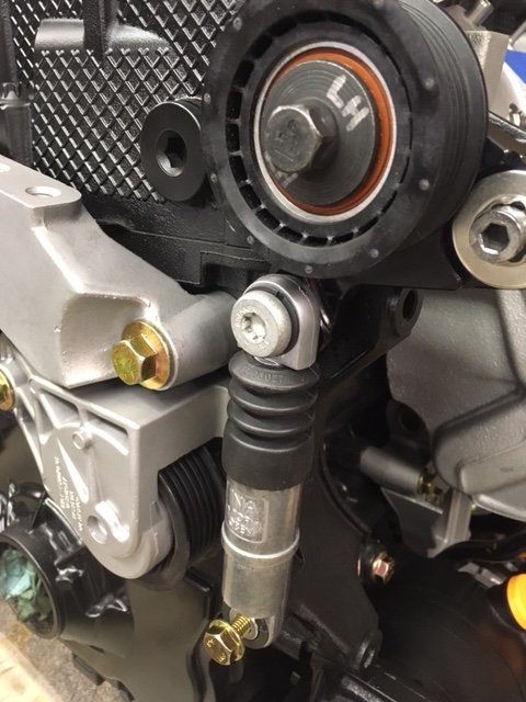

Again, some of it is just mocked up for now. This is the ZZP adjustable tensioner.

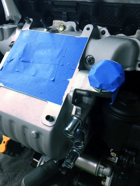

This picture does not do it justice. The intake came out so clean a bright. It's almost white. I was so happy with their work. I installed the dual pass water housing for the supercharger. In doing so, I pulled the laminova tubes out. The fins were getting pretty dirty with oil from the K&N filter that was used. Inside the intake, the walls were covered in black grease along with the IAT sensor. A strong aerosol spray cleaner made short work of cleaning the laminova tubes.

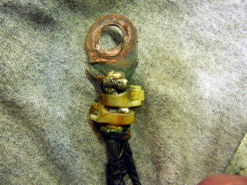

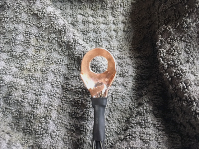

Today was cleaning up the engine harness. I knew there was a ground strap in the harness that bolts to the block but for the life of me, I could not find it. Then I found it, this is what I found. I sure am glad I found this so it could be taken care of. Can you imaging the gremlins this could have caused? Someone attempted to solder blob it.
I was not able to find a suitable copper ground lug that I was happy with so I spent way too much time today fabricating one out of a piece of 3/4" copper coupler. I made this one just a bit smaller then the original since it doesn't need the ground for the radiator fan anymore. You just can't find one with a large enough hole but still made for a couple of 16GA wire. This one is soldered properly.
