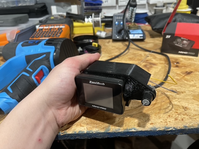

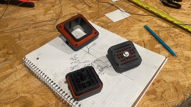

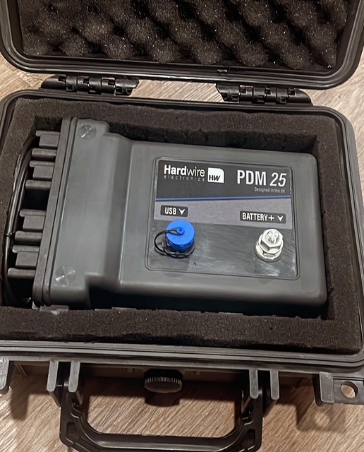

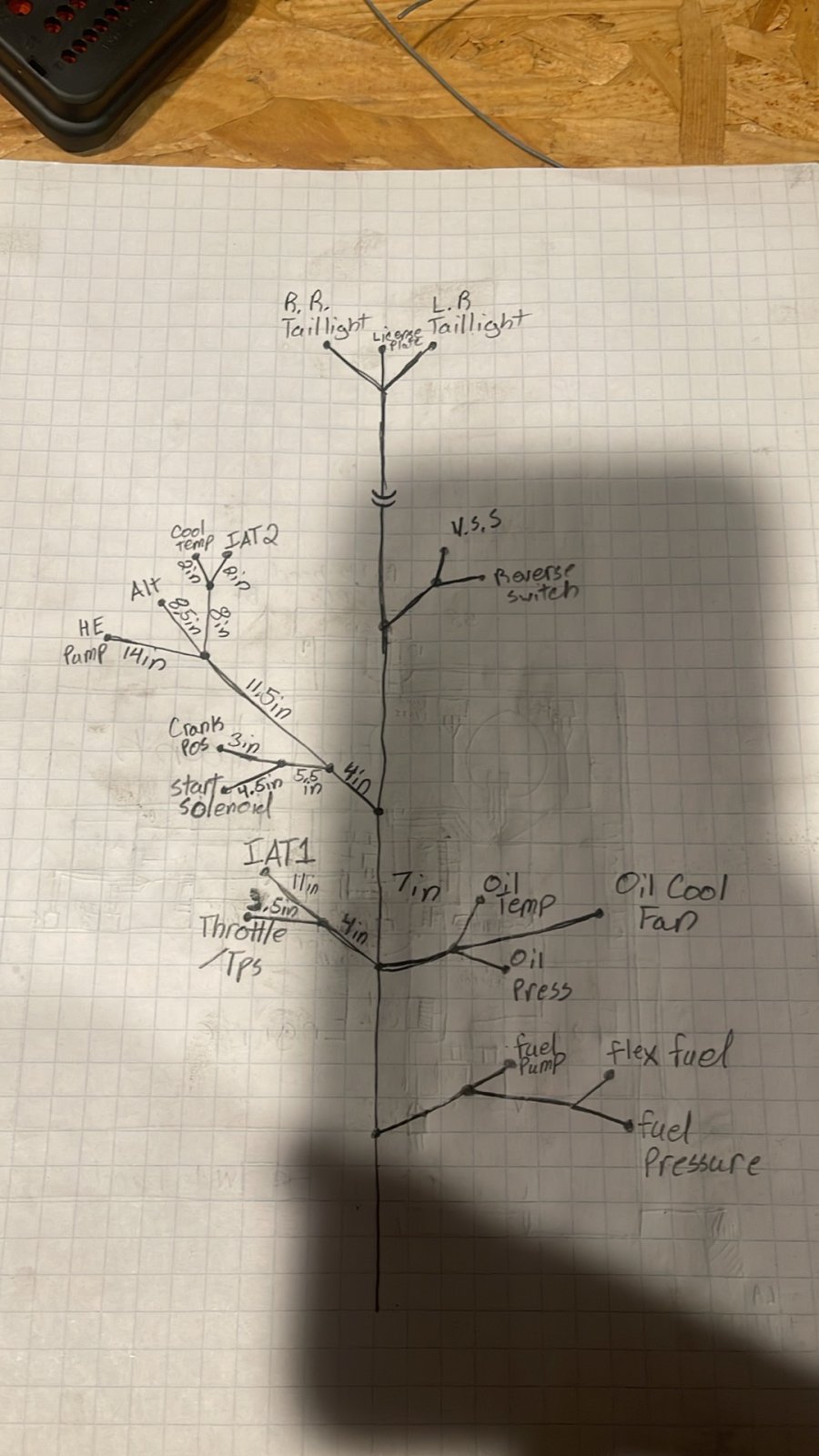

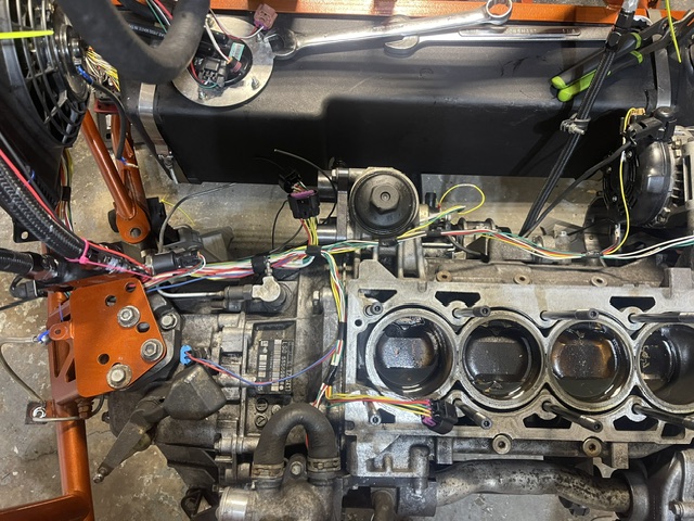

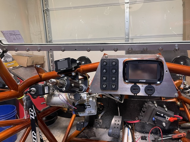

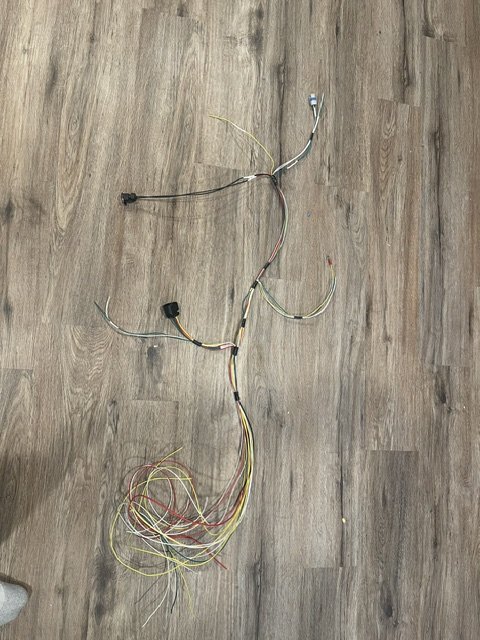

Fueltech FT550, Hardwire PDM, and Custom Wiring
I did complete the custom harness for the FT550 with lots of learning and late nights and it is working great, Most of the time lol. I had a single wiring issue when at my first event a wire coming out of the tunnel rubbed through and was grounding out. I really enjoyed making the new wiring harness and would absolutely do it again if anyone wants to swap over to an aftermarket ECU.

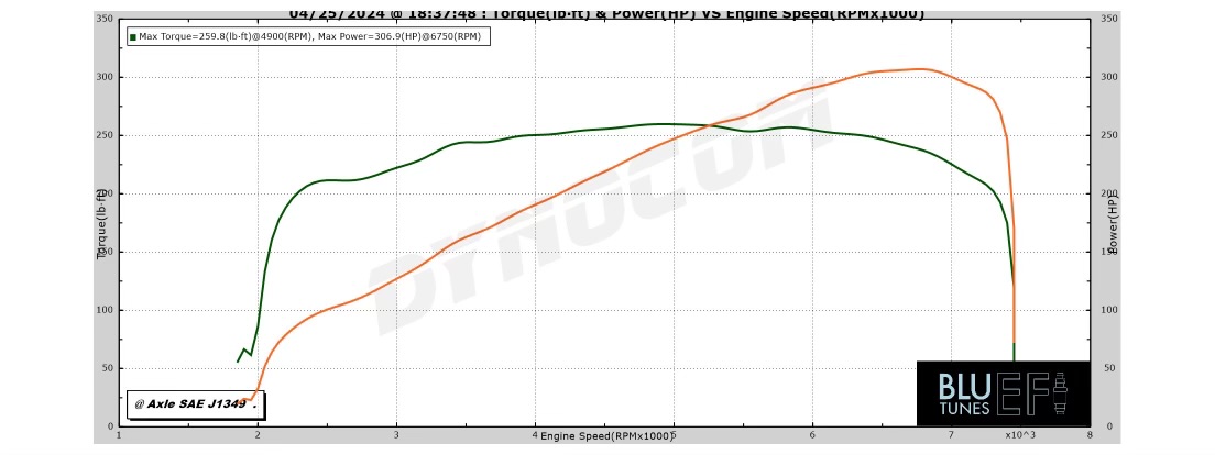

Dyno Tuning
The first startup and tuning of the Goblin did not go very well initially. We were trying to use sequential injection and spark but the engine turns over too slowly to get a cam sync. I was looking for a way to make the engine turn over faster but did not come across aftermarket starter for a cobalt and I didn't want to modify my existing starter and possibly hurt the reliability/lifespan. Eventually we figured it out and got the car to make 307 HP and 260 ft*lbs of torque on a hub dyno. The car was tuned by BluTunesEFI down in Spring Grove, PA, Jon is a really nice guy, very understanding, and reasonably priced for his great service and commitment.

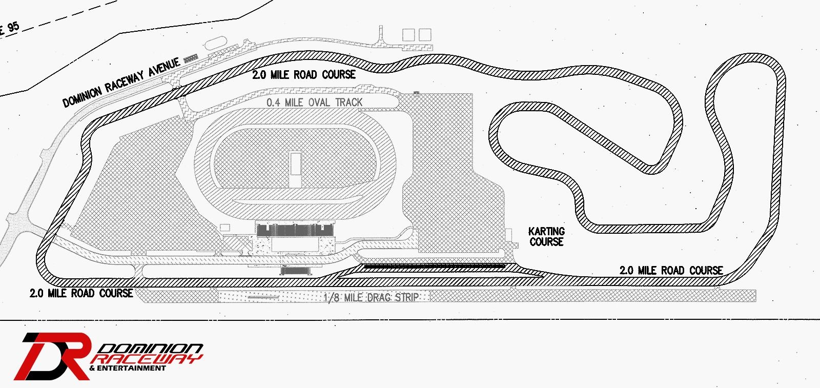

The second event of MACF was a track day on the 2 Mile Dominion Raceway track just after we finished on the oval. This was my first track event and I was just starting to get into it when I ran into my first issue of the weekend. On the back straight of the track I found that the car just wouldn't accelerate and more past about 5k rpm in 3rd gear, This caused a lot of heat to build up behind the exhaust and I ended up melting through a shifter cable. I am convinced this issue was caused by the lack of E85 in virginia and the car is down about 70HP on 93 octane. I ended up being able to free up the melted shifter cable by cycling it and dripping oil down inside the case. I unfortunately only got one session on the track due to the broken shifter cable. The other issue that arrived at the track is a large leak when making higher G turns, I am still unsure what was leaking but when I would take a turn it would spray all over the back of my seats and on the exhaust leaving a big mess everywhere.
After the day at Dominion Raceway we stayed in a Hotel at the track then woke up and drove to Mason Dixon Dragway for our next event. I have never gone down a drag strip and actually found it to be a lot of fun with friends. When we got to the Drag strip I was still on 93 octane fuel and the best I could run was a 14.2 at about 90 mph. I honestly expected the goblin to be a lot faster but the most I know on drag racing is watching Cleetus on YouTube lol. I was searching for gas stations nearby with E85 and found one about 25 minutes away. I emptied my tank to about 2 gallons into a friends car then left to find the gas station. The car instantly was happier even before getting back to the track. My final fastest time was a 13.195s at 100MPH. Maybe the goblin could go faster but I could barely get any grip on the track so maybe the prep wasn't very good. After our private track rental at Mason Dixon, We left taking scenic roads through the Appalachians to stay in a hotel in Altoona for our next event.

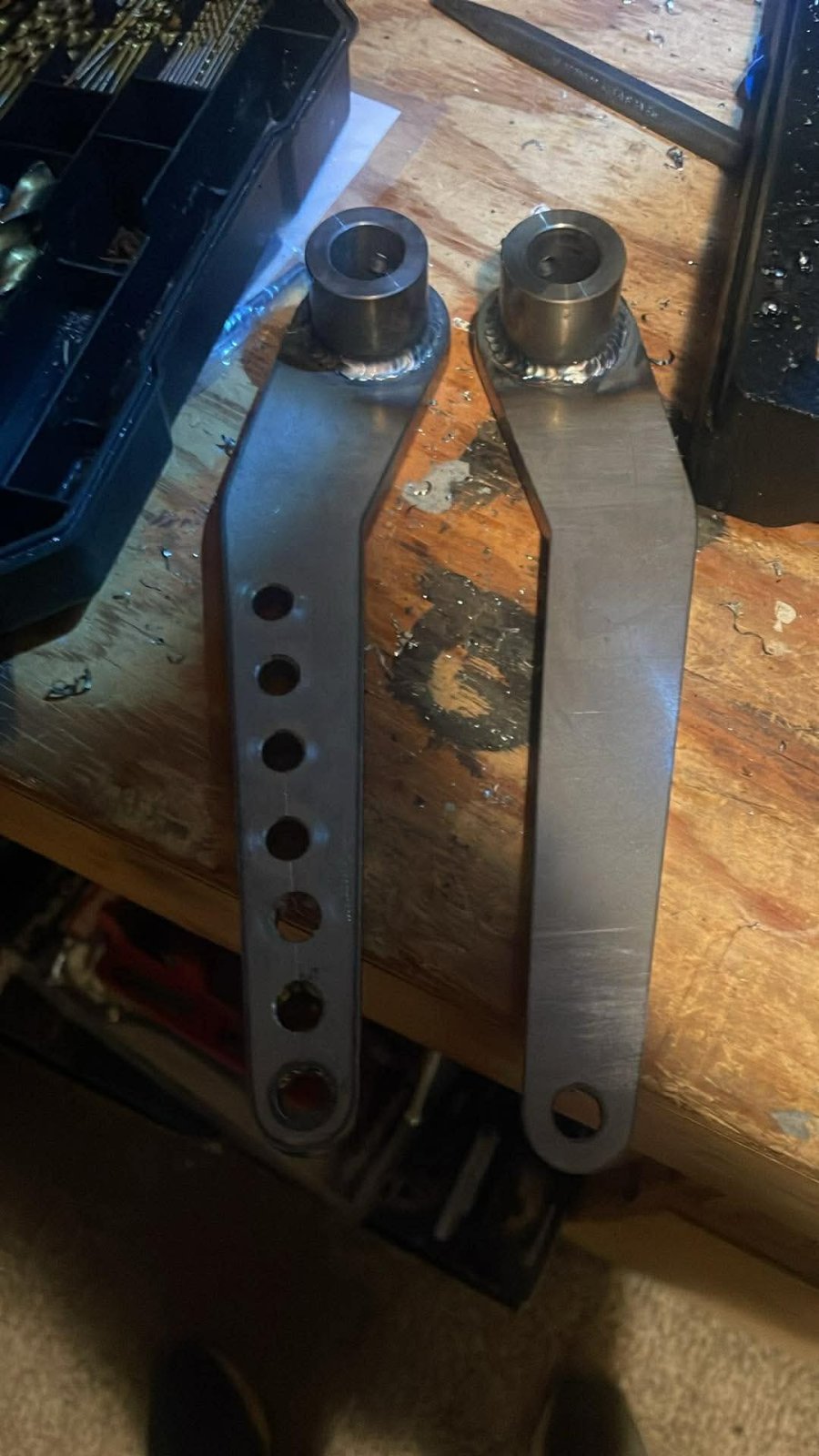

- Powder coat and install replacement rear control arms

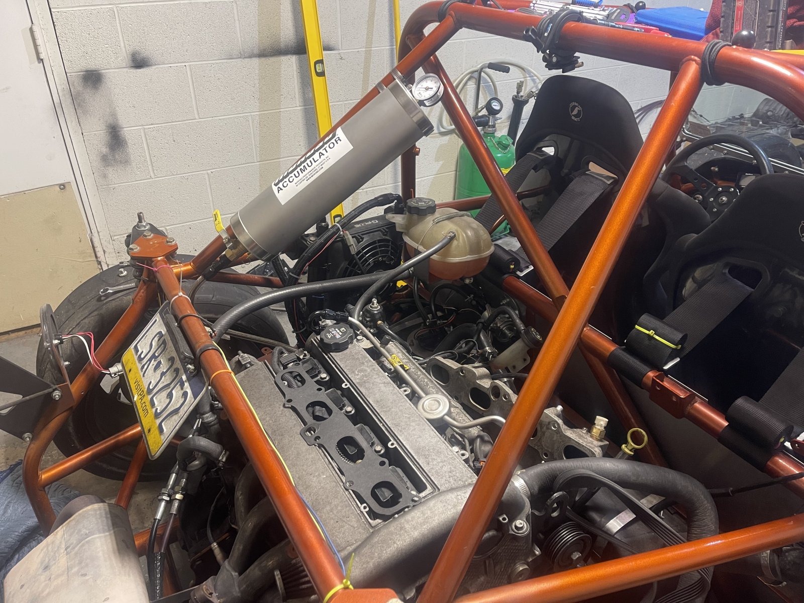

  • Can you share some info on your oil accumulator, where you connected it and if you're using an electronic or manual valve or what?

  • It looks like you powered all your accessories (lights, horn, etc.) through a PDM, is that correct? Did you rewire everything or did you reuse any of your original wiring?

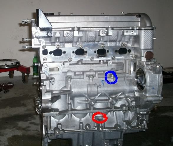

The oil Accumulator is a Moroso 23900 3 Quart that I purchased as recommended by a few of the faster guys in the goblin community. I mounted it using large hose clamps to the chassis for MACF in october. I will probably move it somewhere else cause I'm not a huge fan of it's current mount. I use a manual valve and run it directly to the crank oil galley via the plugs on the side of the block under the intake.
Blue Circle is the galley port I used. I used an M12x1.75 to 6an fitting from racetronics.
I made my own completely custom harness from scratch. I guess I can't necessarily say complete scratch cause I used an ft550 unterminated harness that I then modified to what I needed. Here is a link to the Google Sheetz that I planned the entire harness out in: Fueltech Wiring

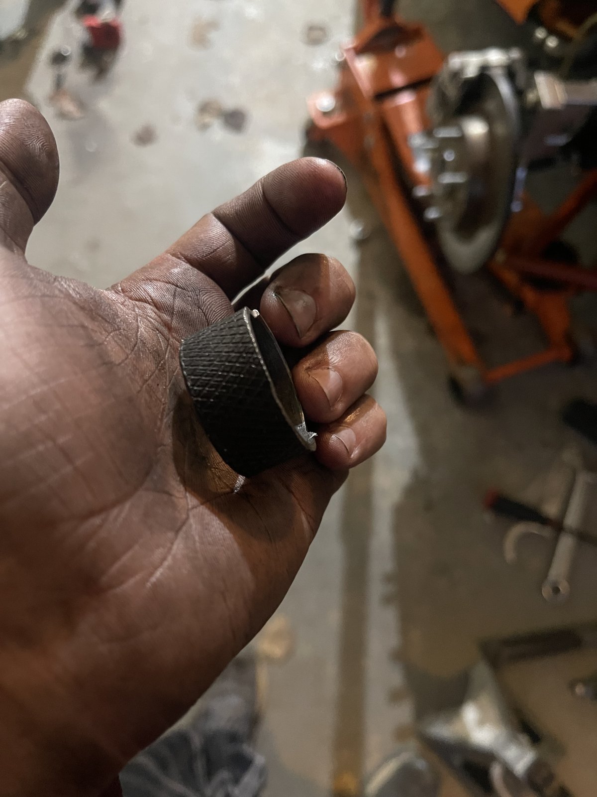

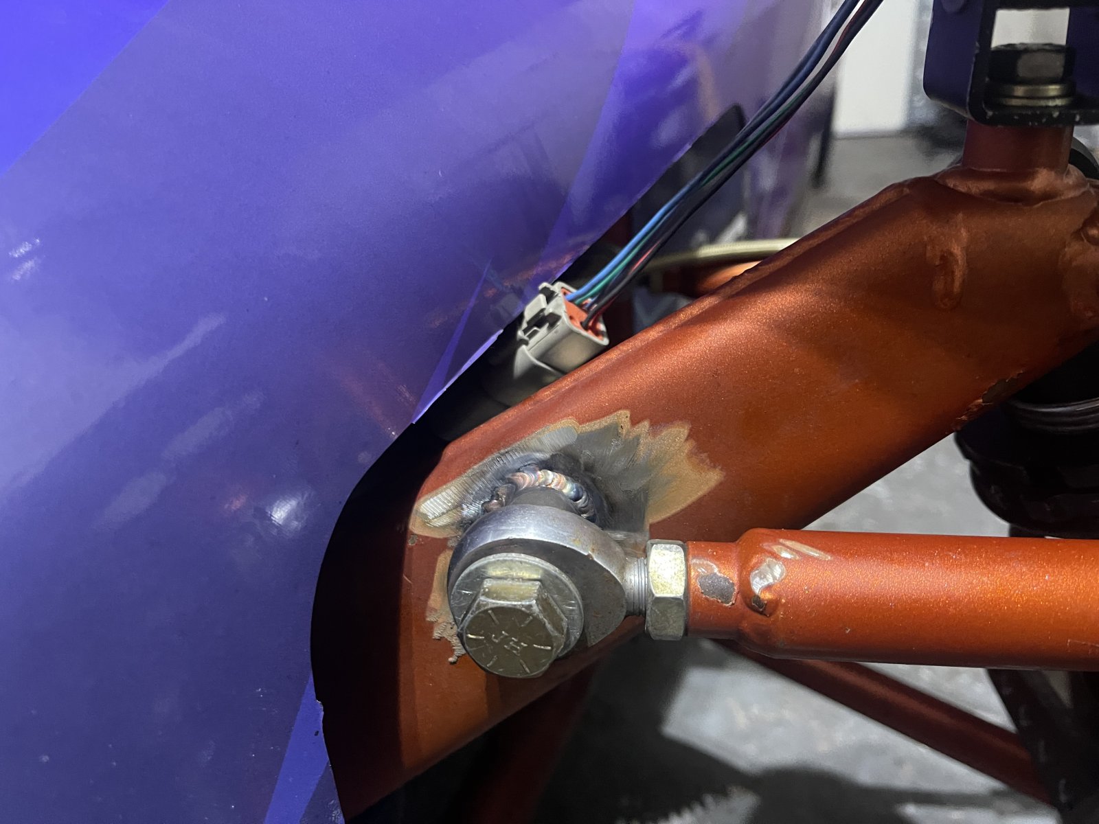

I don't really think you need any ideas or help to find your fluid leak, but just to make sure this is on your list for inspection- I had a leak from the input shaft seal that you can see here.
Also looked back through your build thread and thought I'd tag @Ross to see if there were any updates on your thermostat housing project.
Keckster
you hit the nail on the head on the first thing on my list to check ;). It is between that or some threads I stripped out on the clutch cylinder and “fixed” with JB weld. I think another problem getting fluid everywhere is the gasket on the fuel tank and blow coming from my valve cover vent.
As for the heater core I was designing, I couldn’t really find a way to get it made affordably. I was tempted to try doing some plaster lost plastic casting but haven’t gotten around to it. I could dig the project back up but am a little short on money right now unfortunately.
I'd imagine if the throwout bearing is not firmly sealed against the inner bellhousing service then you could also get a leak around the face seal and not the input shaft seal. But I'll let you get eyes on and report back to satisfy my curiousity!

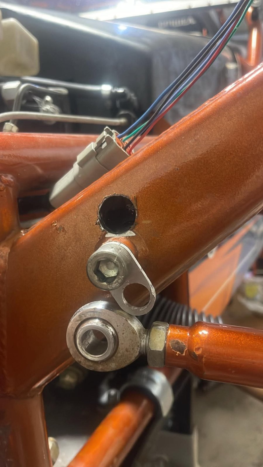

Anti-Dive: Move front UCA mounting point up 3/4"

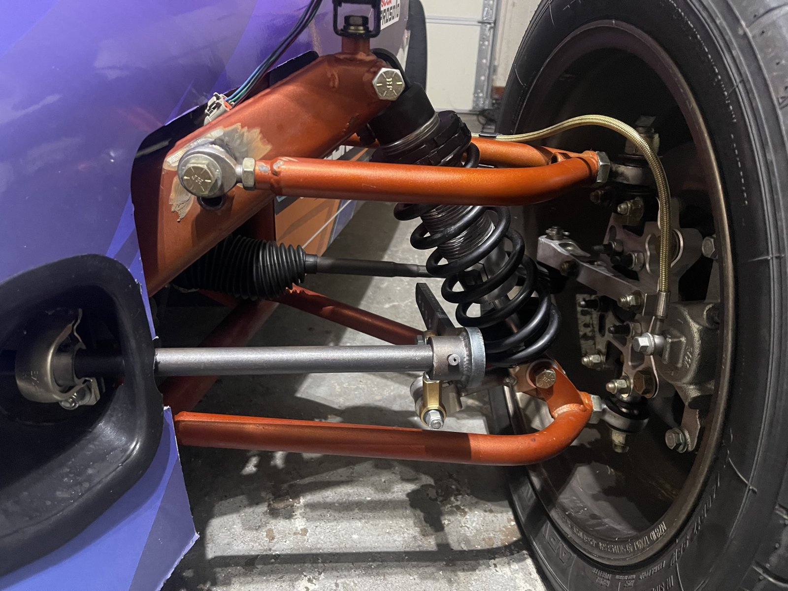

Ride Heights (Measured from center of LCA mounting point on chassis to ground):
Front: 9.3" (25% roll center height w/ 20mm LCA spacer)

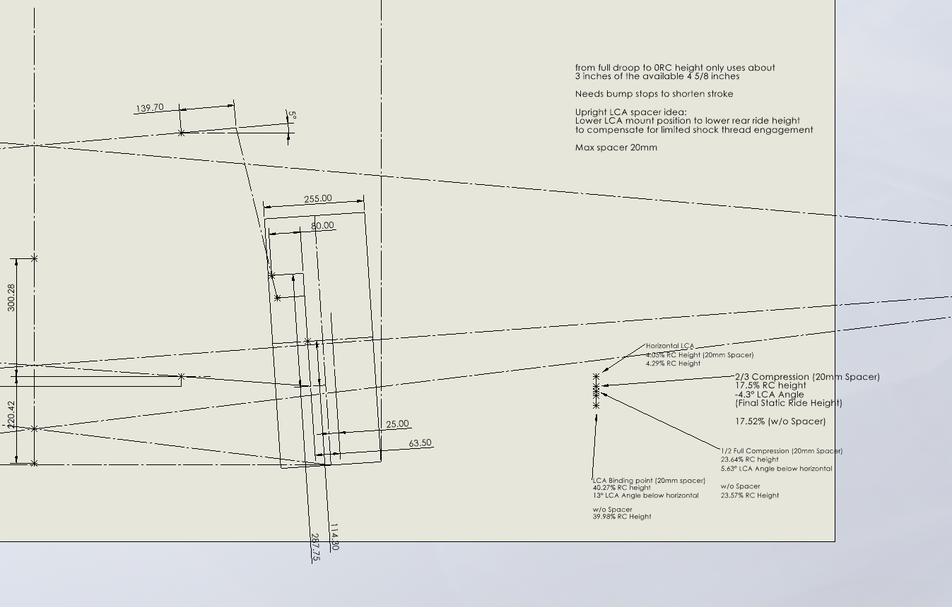

roughly 20° of LCA travel from full droop (Binding) to point where RC intersects the ground plane

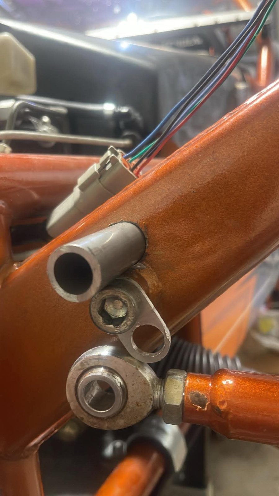

Flipped front LCA so shock mount was on top for more travel(only 14.5° stock) and easier ARB Mounting
Rear: 8.9" (17.5% roll center height w/ 20mm LCA spacer)
roughly 14.25° of LCA travel from full droop(Binding) to point where RC intersects the ground plane
Installed bump stops on rear shocks to shorten stroke where RC intersects the ground

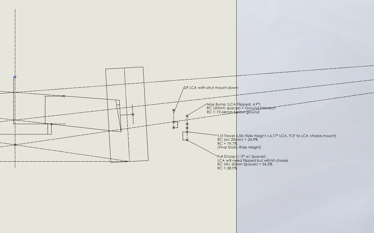

This winter while measuring, studying, and modeling the goblin suspension I learned that when starting with the control arms horizontal we have very little room before our roll center becomes unpredictable. I brought this up to a couple fast engineers/drivers in SCCA and they noticed in pictures how the rear MacPherson strut going past level is very undesirable and the reason when cars are lowered they often use extended ball joints to fix the RC. By increasing the ride height all around to have some downward slope to the lower control arms and installing a spacer on the bottom of the uprights I have given myself more travel while keeping the actual chassis of the goblin at a relatively similar height to stock.

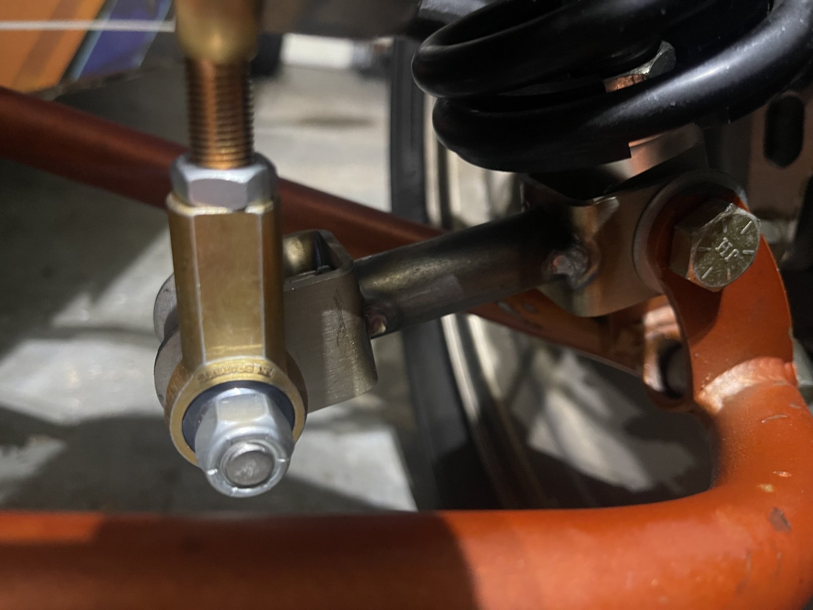

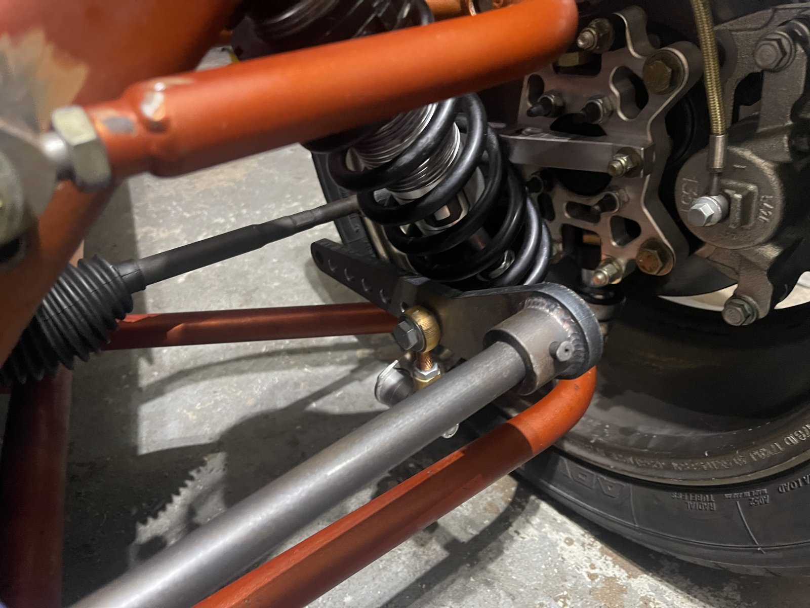

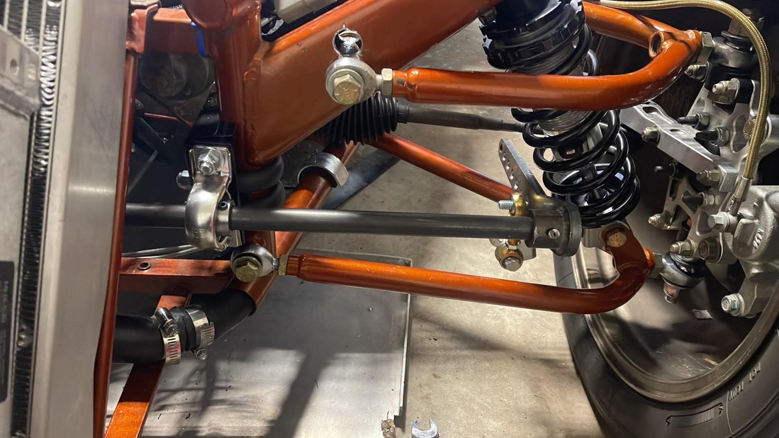

Front Anti-Roll Bar/Sway Bar
3/4" x 40" straight bar
Arms with adjustment from 3.5" to 8"
I believe personally that this sway bar will be the biggest performance boost for my setup. at the stiffest setting on my ARB the front axle weight transfer distribution is roughly 60% and I have adjustability all the way down to 40%. Stock from DF setup guidelines does have roughly 40% from weight transfer however the flat ride percentage is reversed with a higher frequency up front compared to the rear.

Now I am by no means a professional, I'd even be cautious about calling myself intermediate, but the difference between any other setup I've had and this one is in my opinion night and day. The car is still extremely responsive to my input but it is not trying to snap the rear end out constantly and even when i do slide the rear end out it is infinitely easier to recover from. I've attached a video of my fastest run from the test and tune which was 6th fastest raw time for the day and only 2 seconds behind an autocross national champion in a dodge viper.
I am an engineering student with a passion for motorsport that I have found over the last few years. I know I have a lot to learn but really feel like I made some progress with this great starting point of a chassis. Feel free to ask any questions or voice any concerns. I may entertain the idea of putting together some sort of group buy for a front ARB if there seems like a decent amount of interest in it.
Kudos for figuring out the front suspension and raising the forward UCA mounting point by the 3/4 inch. I figured this out a few years ago and did exactly the same modification. Going from 0 percent of antidive to about 19 percent of antidive is a marked improvement. I went further and moved the forward LCA mounting point down by 1/2 inch and added about another 12 percent antidive for 30-31 percent total.
Adding this can cause the caster and possibly camber changes during braking and acceleration. The diverging angles of the UCA/LCA mounting points will make the hub upright move in a longitudinal arc rather than perfectly vertical. This arc, when acting with the lateral camber arc of the UCA/LCAs, can change the camber gain (or loss) during motion - it will not be linear and can add some geometry variability. The 5.5 degrees caster is about 2.5 degrees less than recommended by @Lonny. You may want to try adding more caster to see if it makes any difference, especially when transitioning from braking into a turn to acceleration out of a turn.
The rear strut suspension is really not ideal, especially if using the Cobalt subframe. It is setup for antidive for the front suspension of the donor and is prosquat on the rear suspension. The camber gain curve is far from ideal. I have to assume you have read about the tube subframe option from DF - or do you have one already? The LCA geometry has been adjusted to provide some antisquat and a slightly better camber gain curve. Using a strut suspension has been one of the limitations of the V1 chassis, which you are well aware of from your dialogue. This is the reason that @Lonny is making a UVA/LCA suspension for the rear of the V2. And why I'm working on designing one for my build too.
Keckster
For the Anti-dive I think what I have now is pretty good. I drove the car before with the 220 springs on the front without the anti-dive and it would constantly bottom out under any braking. Now with the amount I've gained from just moving the UCA mount I hit the brakes hard from 70mph at the test n tune with about 1.2 Longitudinal gs without scraping.
Thank you for teaching me this as I did not think about how the caster would change as the suspension cycles but it makes perfect sense! If I'm imagining this correctly with my current setup I will be gaining positive caster in bump and losing caster in droop.
I understand the effects of caster with it's self centering nature as well as how it adds negative camber to the outside wheel. I'm not really sure how I ended up with 5.5° I thought I set it to DF recommended and just haven't touched caster since I first built the car... I will look into changing it to see if I notice any performance differences! As of right now I haven't had issues with poor self centering.
I do already have the tubular subframe. I am aware of the improved anti squat on the rear and my modeling was based off of measurements I pulled from the tubular subframe. For camber curve adjustments in the rear I may have a slightly different setup than others due to requiring shorter control arms for the f35 transmission.

Also would love to know more about your rewiring. Didn't get to it this winter but definitely on for next winter. Would like to rewire everything nicely.
I was R&Ding and making/changing parts a ton in ’24. So much I couldn’t tell you what worked and what didn’t. In ‘25 I decided to just drive and have fun. Now I’m ready(ish) to get back into fixing things, so these are good findings.

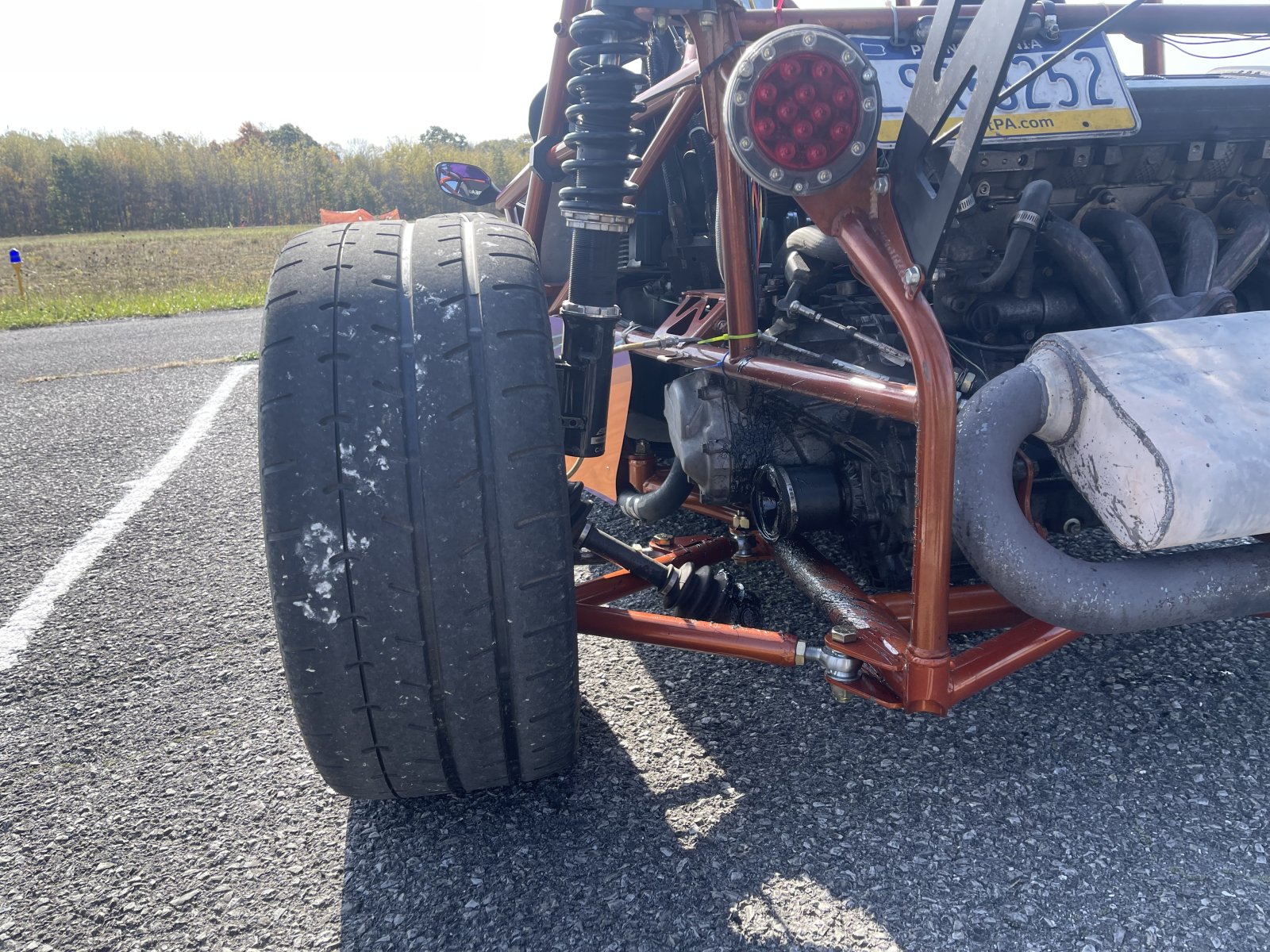

I’m also surprised your caster is so low. Everyone is in the 8-9 range or more. Might be something to play with.
Definantly need a front sway bar. That was in the works when I took my break. Glad I have another visual to work with.
As you know, the rear strut system is one of the biggest holdbacks of the goblin. looking at pictures of our rear suspension compressed in a race is pretty shocking. An upper control arm and spring/shock is definitely the way to go, but it’s gonna take some work. The Df subframe is a good start to build off of though.
the camber seems pretty extreme, but if you can get good roll, then it’ll work. I have my front hitting both ends of the tires, but rear I’m going to have to move around due to new tires that grip better and such. It’s all part of the game.
