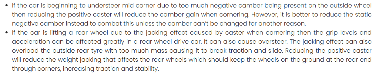

Yeah I honestly wish I took better notes on some of the changes I made. I know I originally built the car with 8.5° of caster and looking back through text messages with my race car friends I only found one instance where we talked about my caster being high and then a few days later I sent a picture of my new alignment settings with the 5.5° just before Mid Atlantic Car Fest 2025. TBH I don't think being at 5.5° is currently an issue for me, Car drives straight as an arrow at triple digit speeds and isn't heavy to steer. Doing some research since Mr Sasqwatch noticed my caster number I think a low number could possibly help the goblin.
56351
Here a snippet from the website suspension secrets which outlines two problems the goblin already seems to struggle with that the lower caster could be helping with slightly. On the 2025 setup when I would get a good run out of a corner I did notice lifting the rear inside tire causing the diff to unlock.
