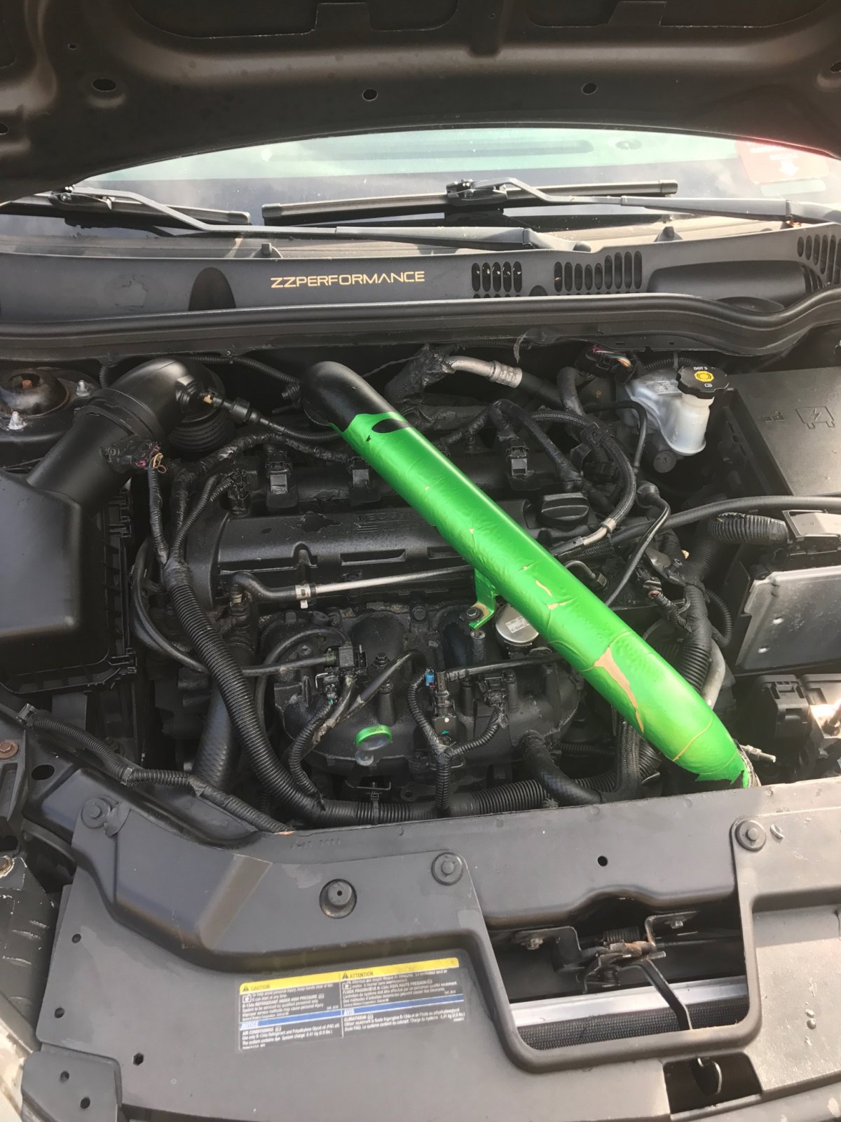

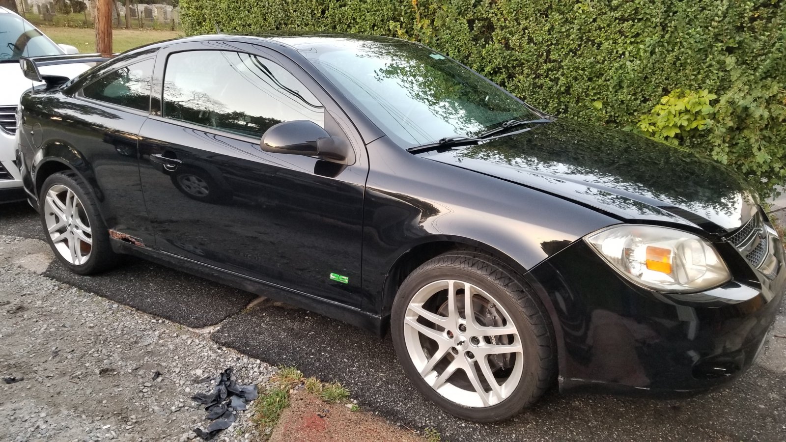

This is my build log I live in NJ my plans for my build is to make it street legal not going to be easy in jersey but it will get done little by little. In will be taking it to the track while trying to get it on the road I'm starting with a 08 SS/TC with 110,000 miles with no LSD but maybe I can find a cheap one around my plan is to have 380 to 400 whp with some meth. I'm going to be asking lots of questions since I'm not a mechanic im a plumber but I do work on cars a little so it shouldn't be that bad
So the biggest problem that I'm going to have is that I bought it from a dealer that bought it in Cali and it was owned by a kid that loved plasti dip and he sprayed that everywhere in the whole engine and bay and I tried to power wash it out and no luck so I'm going to take extra time to clean engine before painting it sorry for the long intro
Doesn't look bad in pictures but it's bad it's black plasti dip

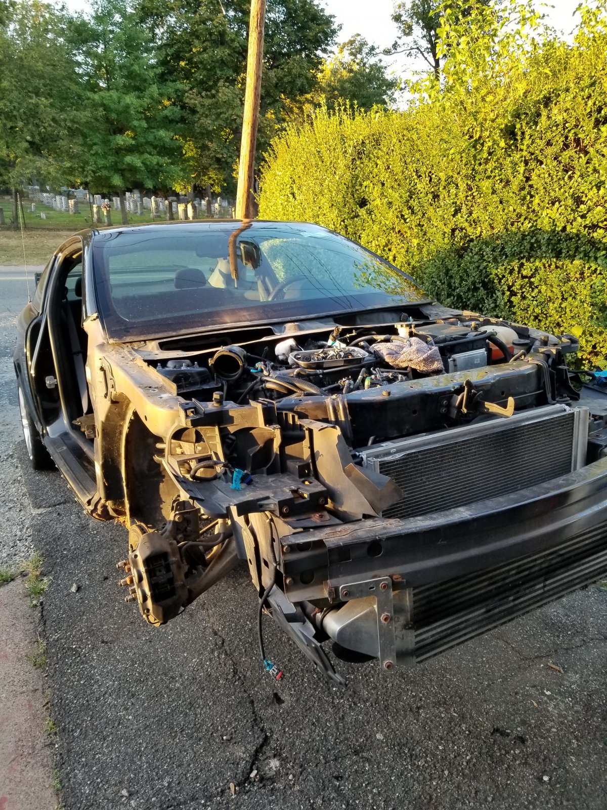

So I got thru steps 1and 2 today everything want nice and smooth expect that the car came from Cali near the beach and there is rust everywhere but the hardest part was taking off the wipers they where on there real good

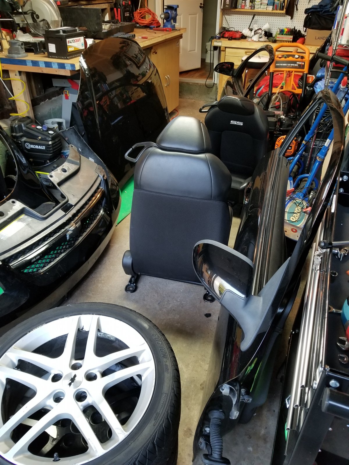

Some of the parts that I'm going to try to sell
