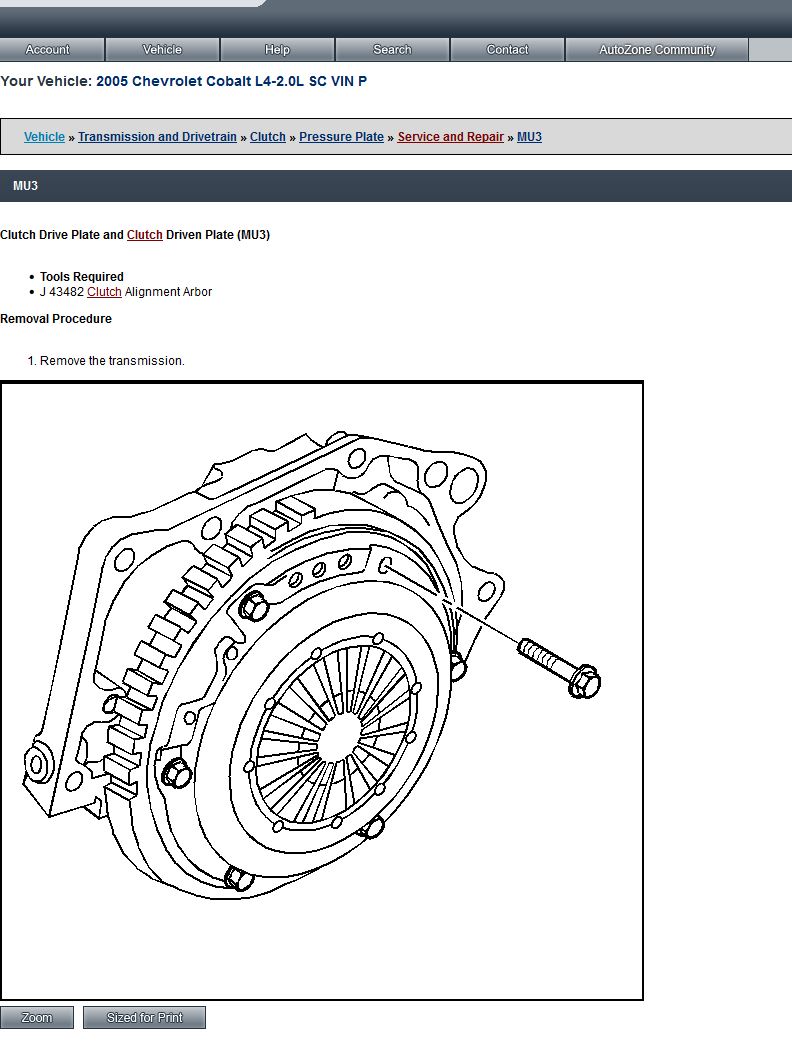

I found all the clutch data - see this picture for location in "service and repair" under Vehicle>Transmission and Drivetrain>Clutch>Pressure Plate>Service and Repair> MU3 The whole procedure then pops up with all torque values, etc..

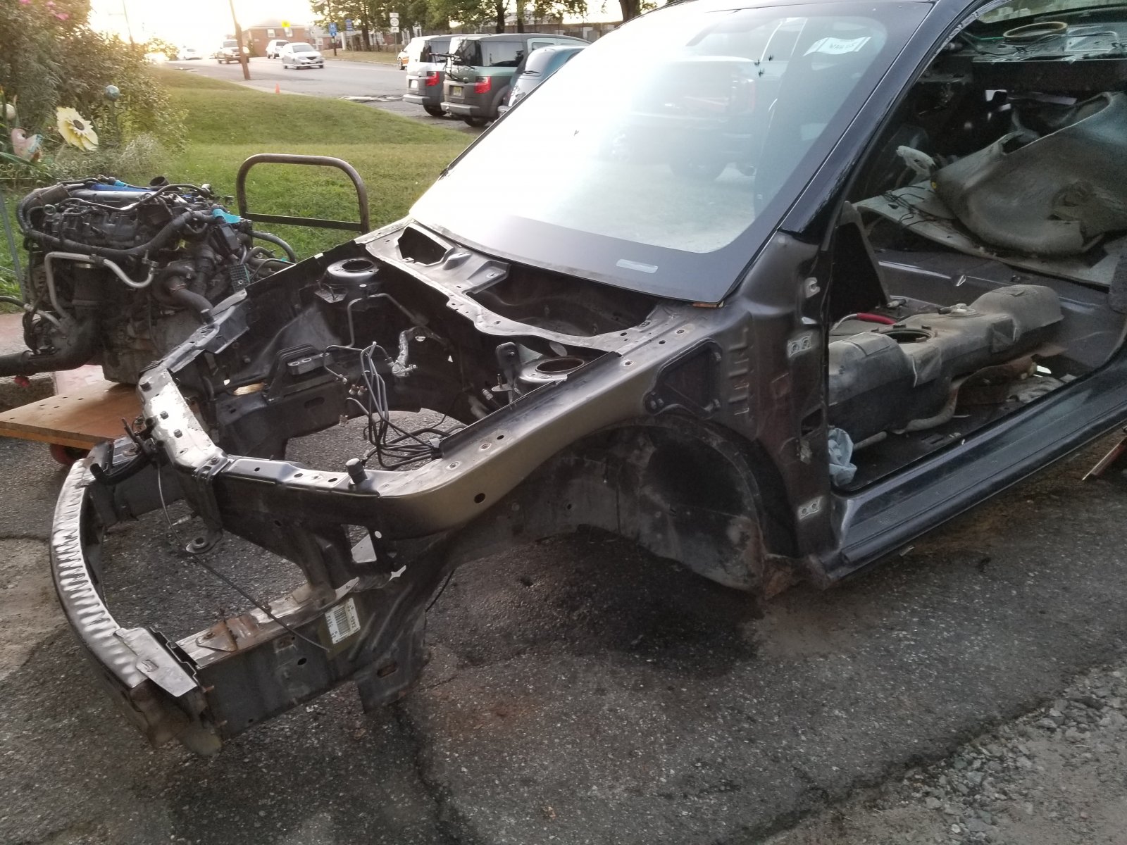

So I'm all done with the strip down of the donor before someone comes and takes it I want to make sure I Did not miss anything what have guys forgot to take off before they junked it

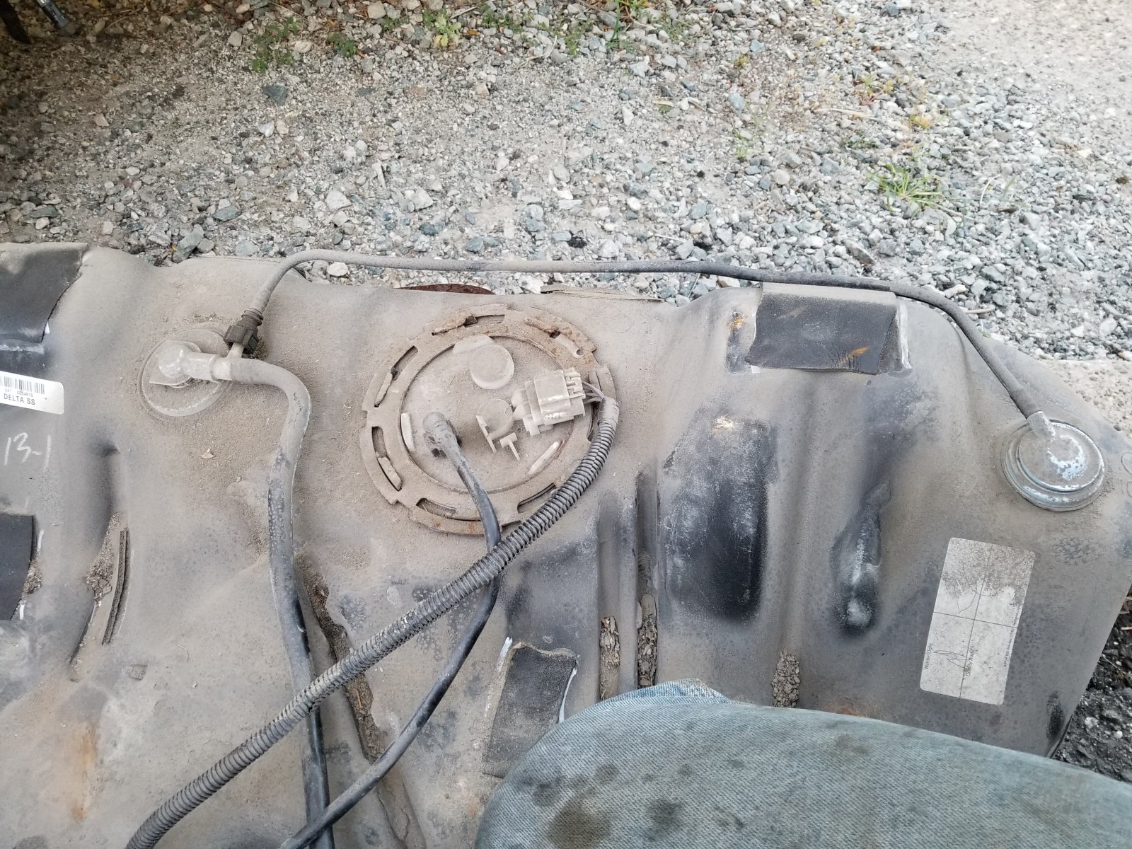

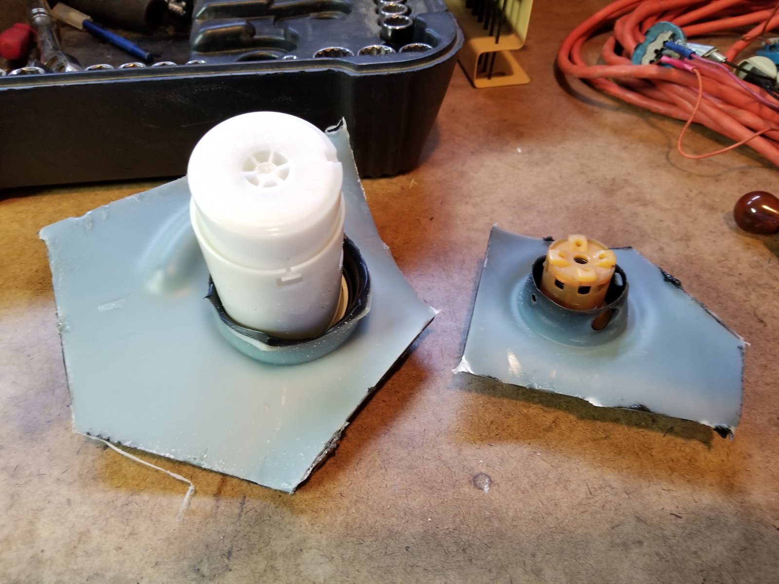

So i have a question the FTP sensor on the gas tank and also the grade vent valve I tired to take it out of the old gas tank but I did not know how to take them out or do i have to buy new sensor do be able tonuse it on the new tank so i can hook up the evap system
David
Will I'm think I should try to cut it out of the tank and save the ftp sensor and the grade vent valve just in case i can reuse it some how what do you guys think

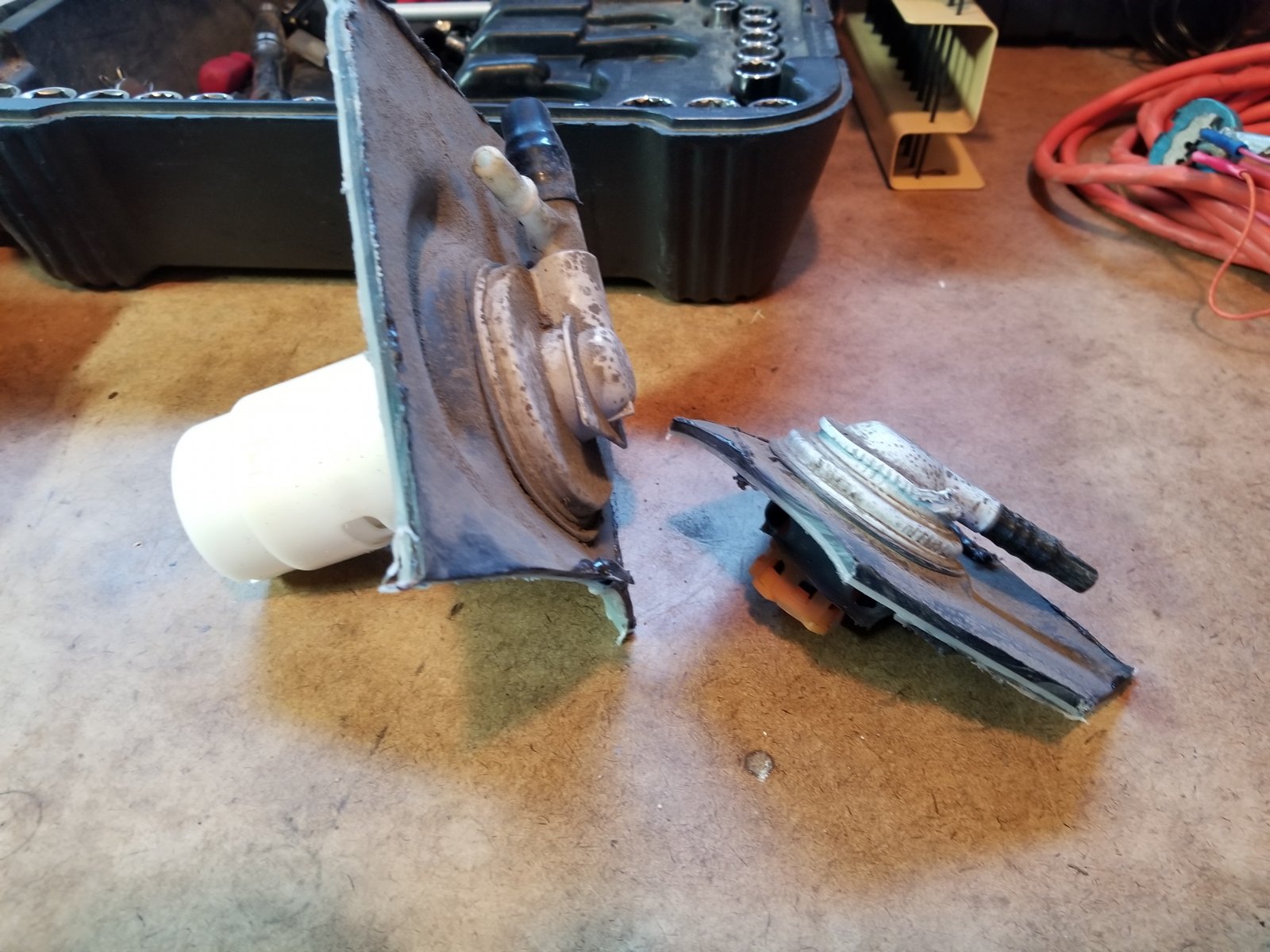

So I cut it out I took some pictures just in case someone wants to know how it looks
Know my question is how do you think I can install them in the new tank with out having it leak

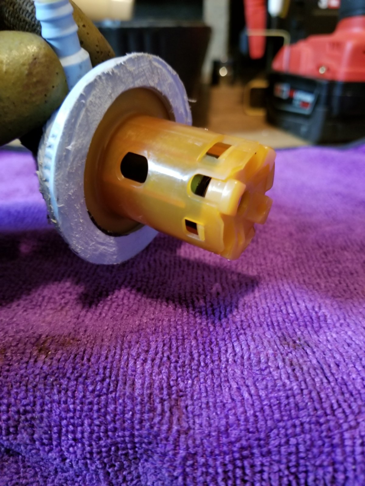

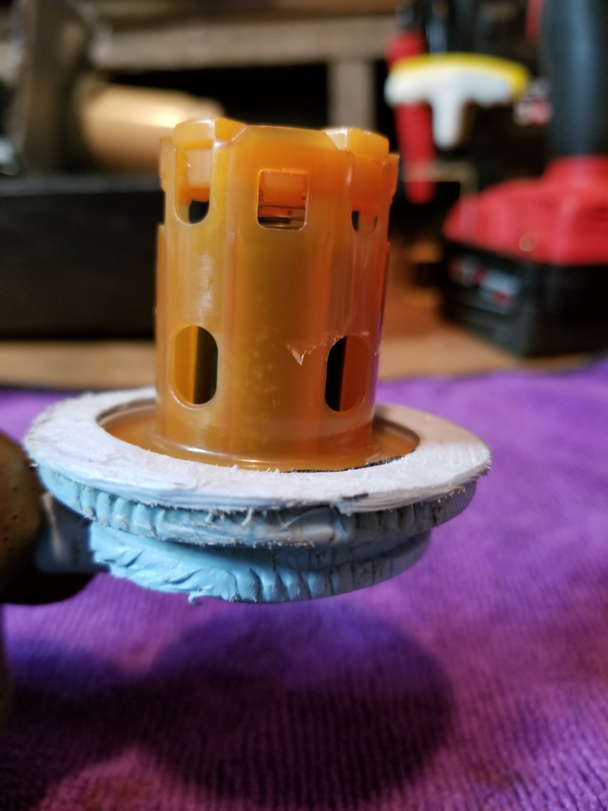

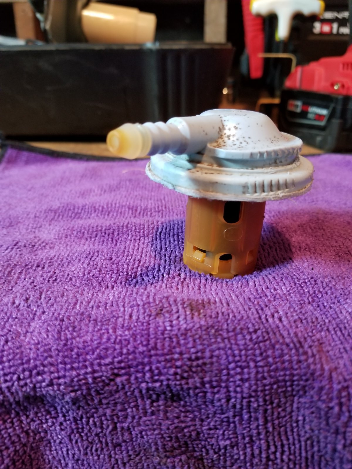

Better picture of one that I cleaned up there are Fused on the gas tank not easy to cut out but does anyone know what this is

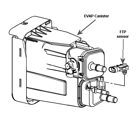

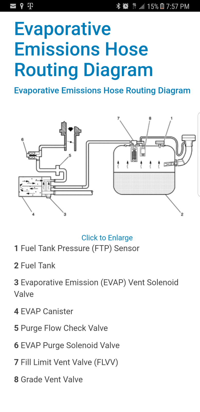

So this is what the Chilton manual has for a diagram for my car but it's not accurate at all since my ftp sensor is on my canister but I see now what is the fill limiter vent valve , grade vent valve but I'm guessing it does not have a prv valve so now I'm assuming I'm going to have to make them fit the new gas tank some how

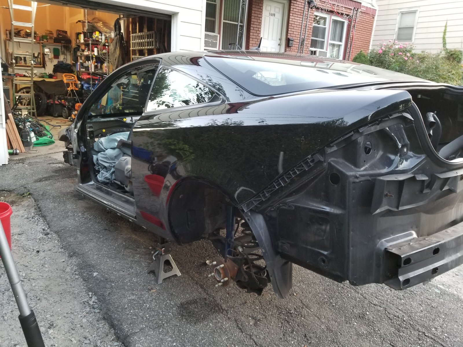

So quick question for everyone who striped a cobalt ss what did you guys do with the shell everyone by me wants to charge me to pick it up did you guys pay or found a scrap yard and took it yourself
Silverback
Sold the tires/wheels and radio off of mine. The SS seats had holes. A few nibbles, but no bites on CraigsList for other parts I didn't need. I found an outfit that buys junk cars and told them they could have it if they could get it without wheels. They did. Others wanted to know every detail about it before they would commit. Glad to see it gone.
