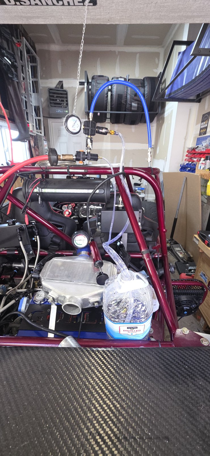

Well I had to pull the vacuum tester and filled system with distilled water. Took a while for little tear drop to appear. Found 3 tear drops on a tee on the turbo side. Pressure tested for 25 min at 15psi. No drop at all. Moving on to the scary side the engine.
David
Now this is weird, did the same procedure on the engine side but with coolant. No pressure drop at all. Held 15PSI for 25 min, crazy but I guess ill take it. Let see what happens.

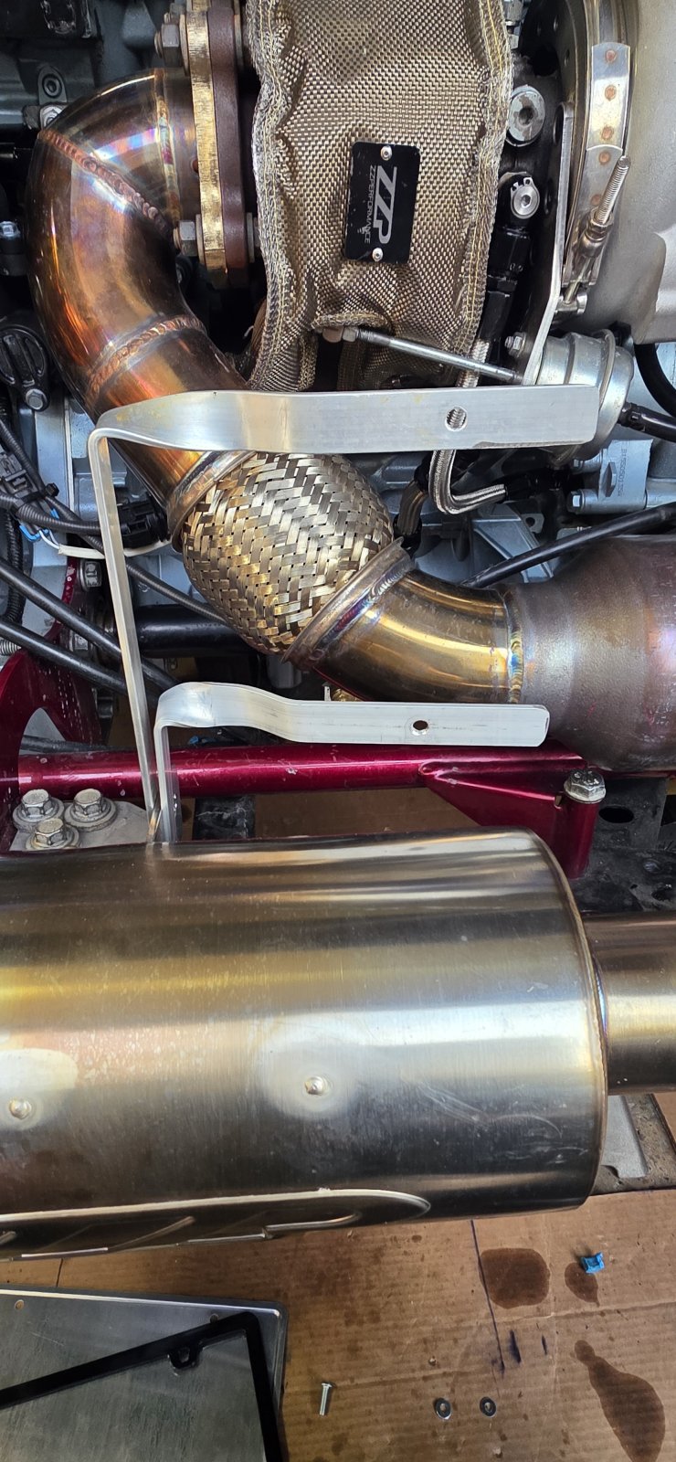

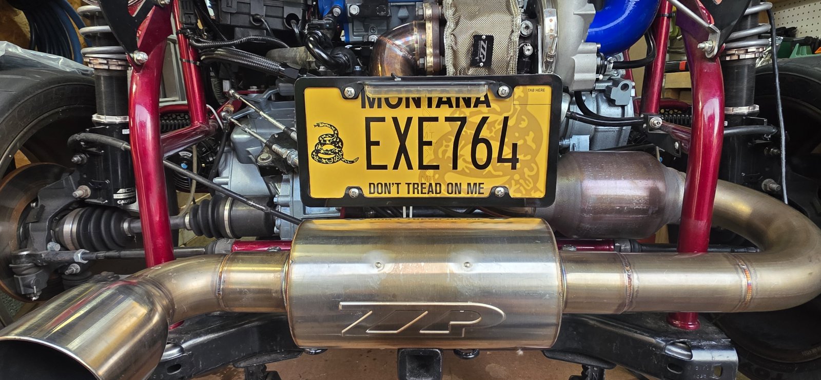

On another note installed a exhaust and made a bracket for the plate.
Ps. Im twin turbo now lol

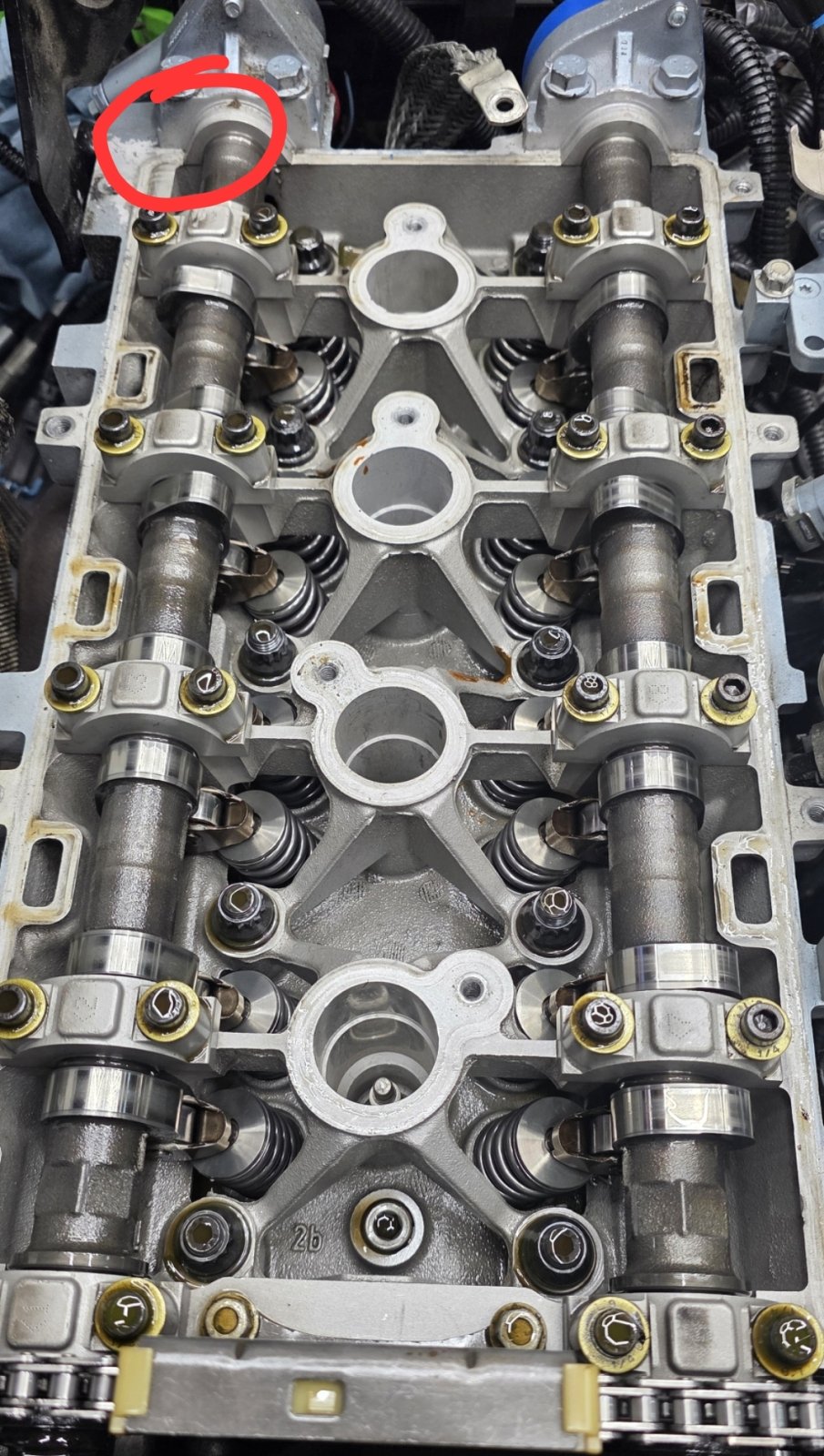

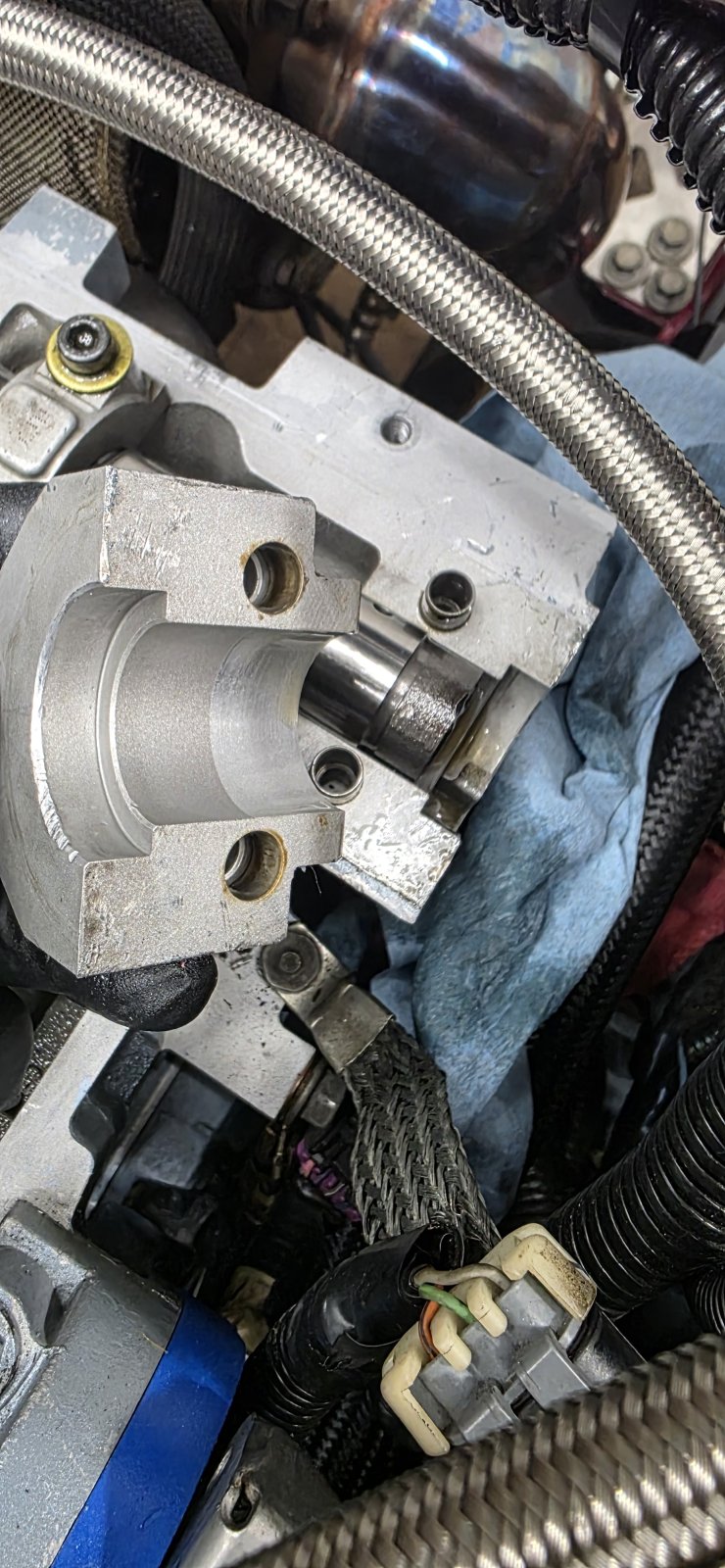

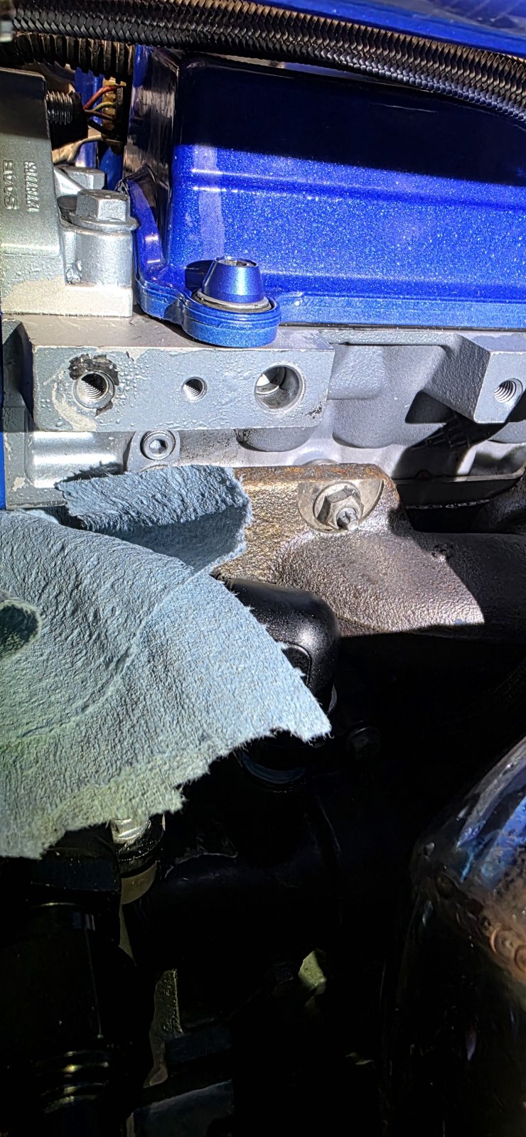

So finally got everything together and cranked her and started right up. Do have a CEL but didn't look i to yet as a started to notice an oil leak. Looks like its from the valve cover which has new gasket. Its in the corner of the cam position sensor.
Has anyone had issues with gasket not sealing correctly over the half moon? Im guessing its from there as that's where the oil is collecting.
Markm
Could be leaking from the cam cap or the valve cover gasket. Did it get a little dab of silicone in those corners where the cap meets the cylinder head when the valve cover was installed? Sometimes the caps can leak if anaerobic sealer wasn’t used.

I personally didn't put no RTV on the valve cover. Should I have used some on those corners? Guessing I need to take everything out and apply RTV. Should I take the cam cap off and put RTV ?

So I took everything apart snice I wouldn't be able to sleep knowing I had a leak. Yes im crazy like that lol.
So I found that the cam cap where installed without anaerobic sealer because I see no residue.
