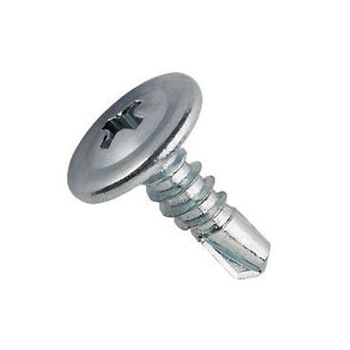

I used these little self tappers where the rivets were supposed to go. We have a metric **** ton of them at work and use them on everything.
over time they may loosen up, but we will see.

I knew my cap had to come right back of so these are what we used also. I was worried about the "drill" portion of the screw, so we cut those off and rounded them after the initial install. Just takes a minute to pull the cap now.

Previous owner of my sandrail used a lot of those. The only ones I've really noticed loosening up are the ones that are holding up the subwoofer/amp due to the vibration. Add some rubber washers to them and they seem to do pretty well.

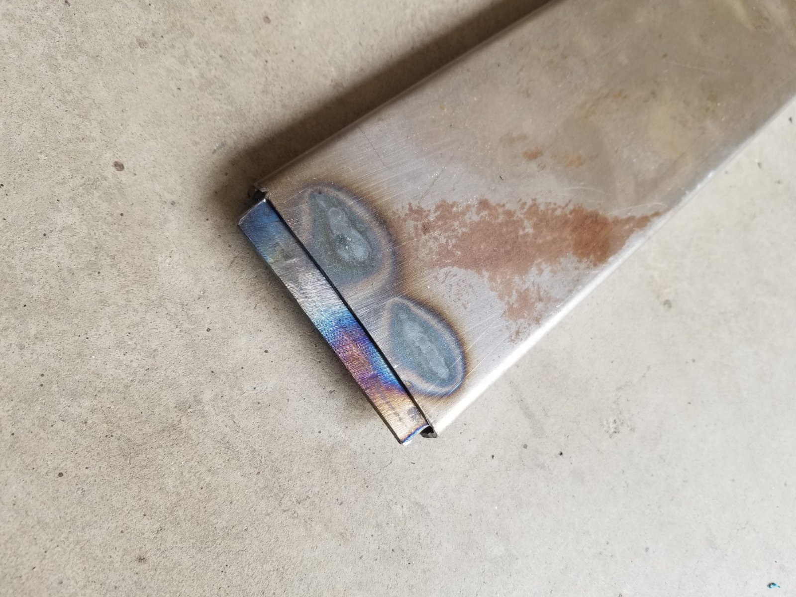

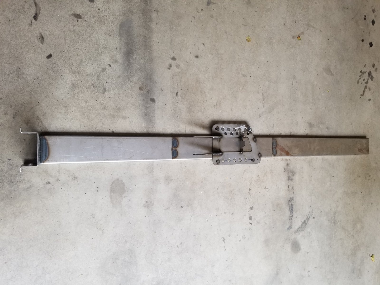

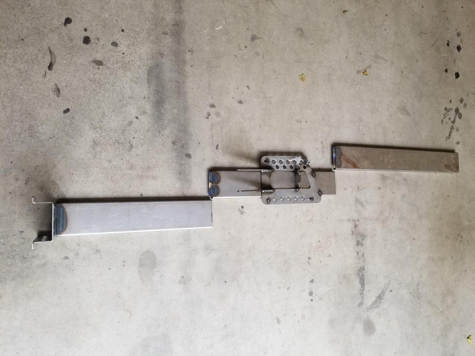

Ark and others, photos of where I cut my tunnel. Note I added a small plate to fill the gap between the pieces welded to the rear most and center pieces.
