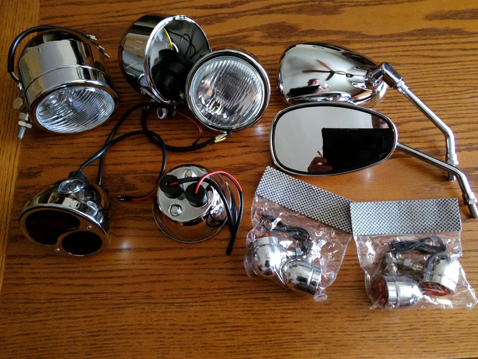

I received some more goodies I've ordered - can't do anything else, just too **** hot - so EBay and Amazon have been getting some of my business. Lots of chrome parts - mirrors, turn signals, tail lights - that match up perfectly with my chrome headlights (old school cool :cool:), along with some cooling system fittings, gauges to monitor air temp (pre and post intercooler) and the intercooler coolant temp, and some aerodynamic parts (thanks Jim) ;). My storage shelves are getting full and I don't have a Goblin to mount them to yet - still a frame in progress. :rolleyes:

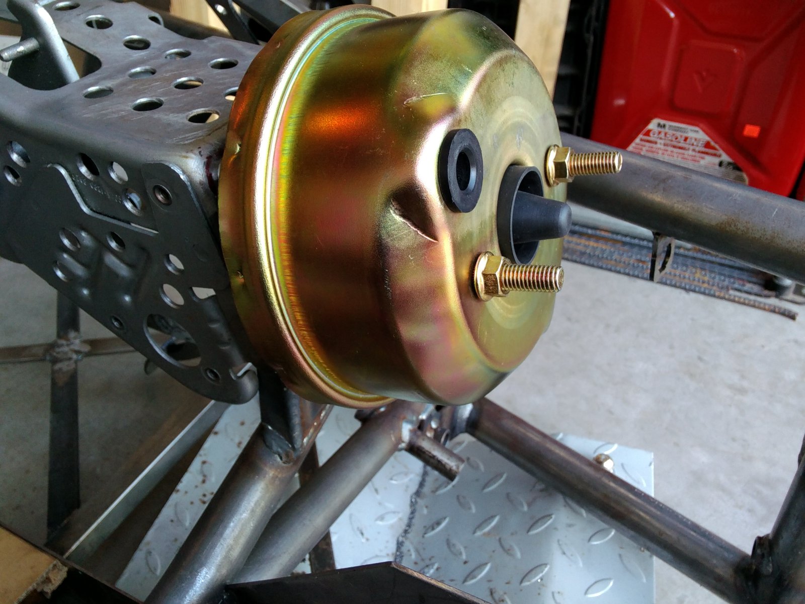

Braving the record heat here in Arizona (35 days and counting at 110* or higher :eek:) I finally got around to modifying the brake booster mount to accept the 7 inch single diaphragm one I purchased quite a while ago. Had to weld shut the 'metric' booster mounting holes in the pedal assy and frame bracket to re-drill for the standard GM 'universal' 4 bolt mounting pattern, which is wider by 1/4 inch.
This new booster is 3 inches smaller in diameter than the Cobalt booster, weighs significantly less and will accept many different brake master cylinders - which can be better matched to the Goblin braking requirements. It also has more under hood clearance for the cockpit air vent mods I made to the underside of the hood. I haven't decided the brake master cylinder yet, but looking at some aluminum Corvette disc/disc units - with chrome cap. ;)

Tim, do you plan on doing some type of proportioning devise? We have problems locking the front. Mostly the left front. The boys said it is super easy to press the brakes, but I want to wait until I have hand controls in it before we start changing things.
Here is the photo from a previous post showing the difference in booster size. http://dfkitcar.com/forum/index.php...ack-extended-08-ss-tc-lnf-f40.1003/post-21631
Jim, yes I do have a proportion valve that I can install to make the front to rear balance correct, once I get to that point. As you can see my frame is still bare and I am still doing a bunch of welding, among other things. I'm fairly confident going from a 10 inch dual diaphragm booster to a 7 inch single diaphragm booster will make a difference in the pedal feel and allow for better pedal modulation before brake lockup. Plus the master cylinder will play into this and I'm still collecting info on this before pulling the trigger to buy one.
