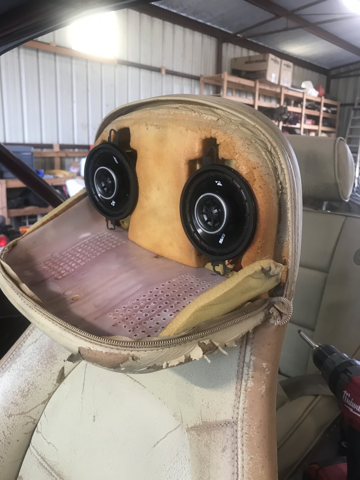

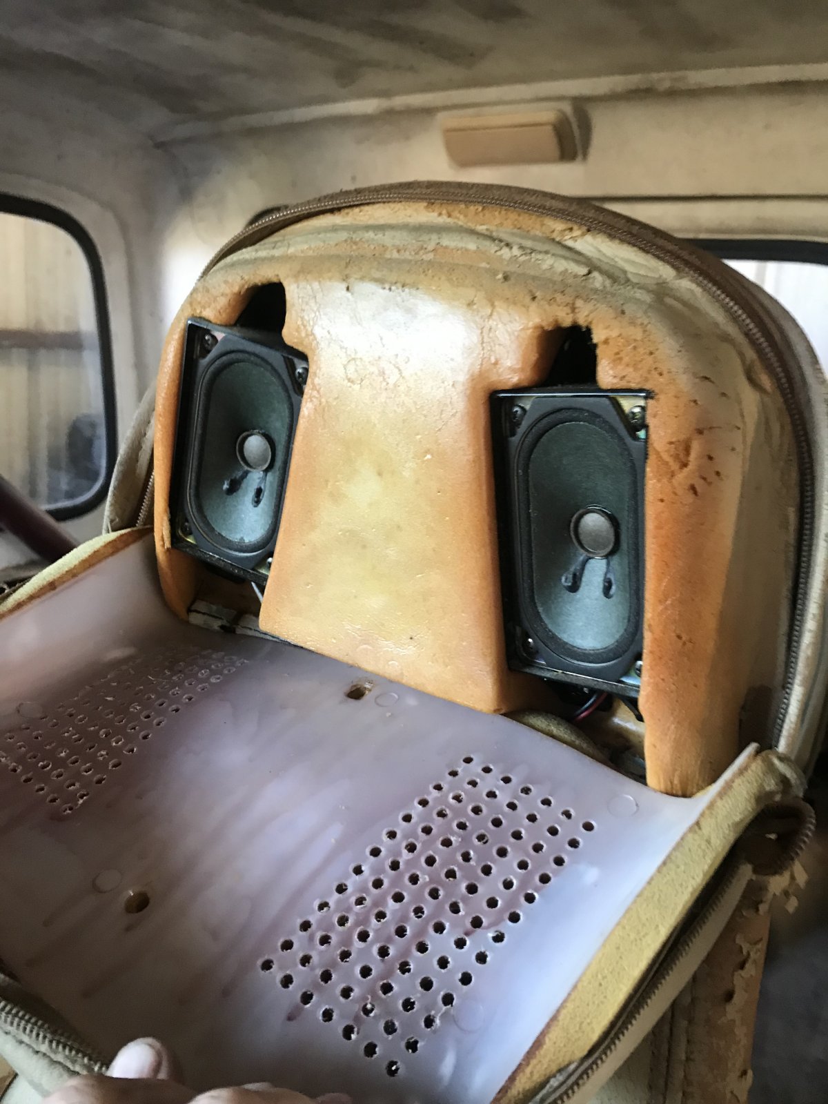

Meh. I put Mazda Miata seats in my CJ with the speakers in the headrest. Decent sound, right at my ears. :D

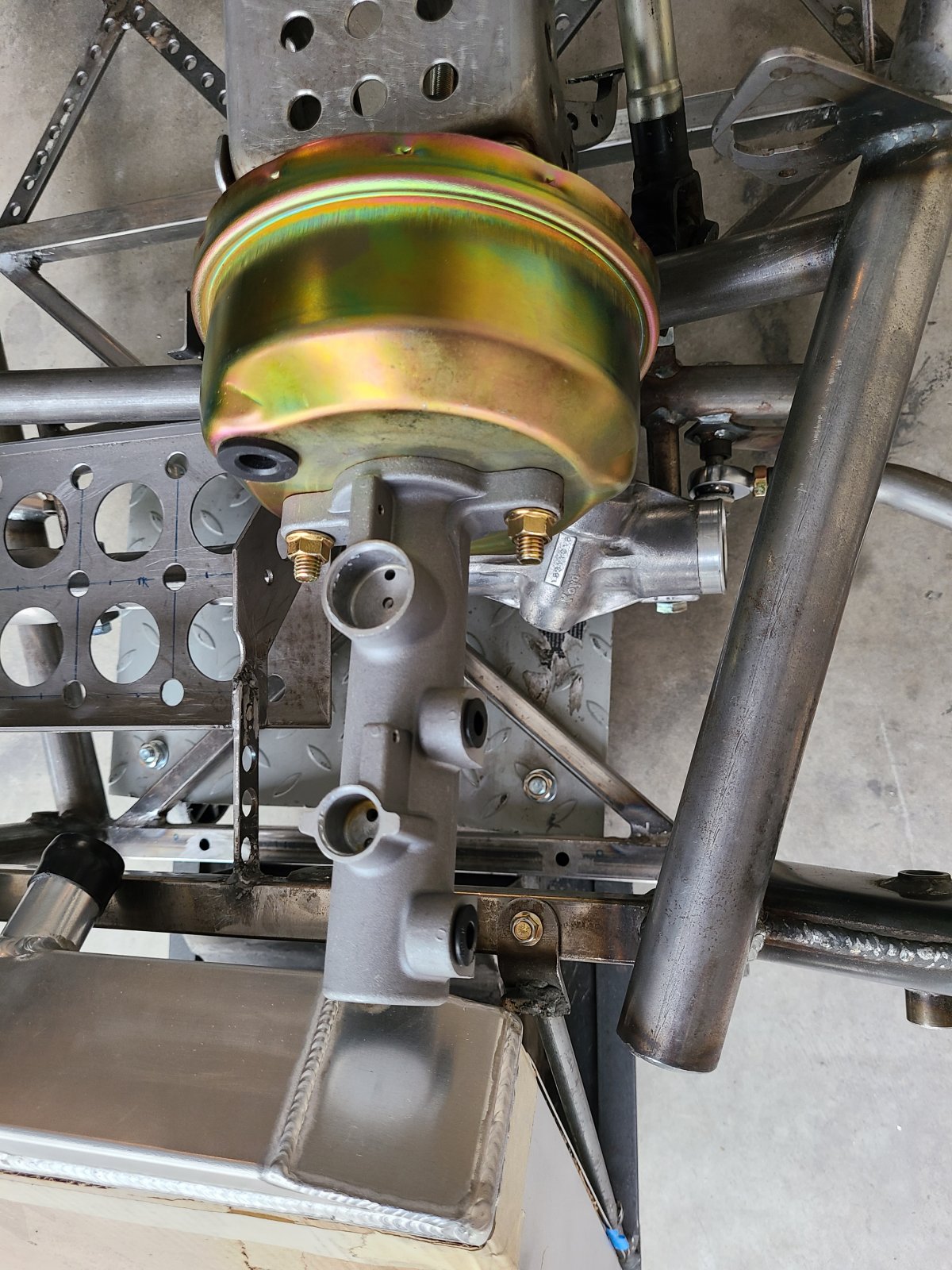

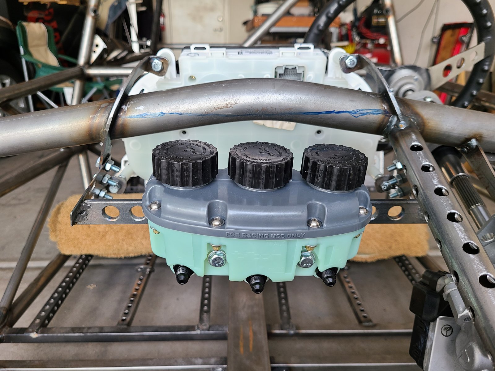

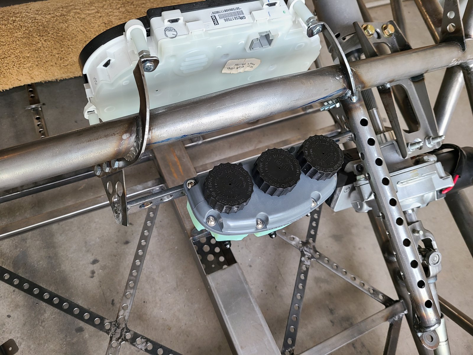

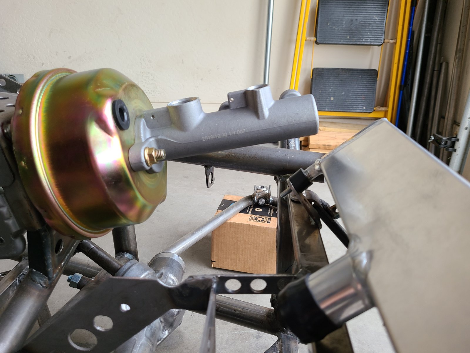

The Tilton reservoir arrived today, bolts right in with plenty of room on the bracket. There is about a 4 inch drop between the reservoir outlets and the top of the brake master cylinder, no 'up-hill' path for the hose routing. Will need to obtain the AN4 fittings and brake line hoses.
Also double checked the clearance for the brake master cylinder to radiator again. Plenty of clearance to angle the booster/master cylinder assembly down about 3/4 of an inch to improve the pushrod to brake pedal angle inside the pedal box.
I will wait for someone to comment on the size of the master cylinder to brake booster - I admit, it does look somewhat out of proportion to the stock Cobalt setup.
I will need to find (or make) adapters to fit into the master cylinder inlets, maybe someone with a 3d printer?

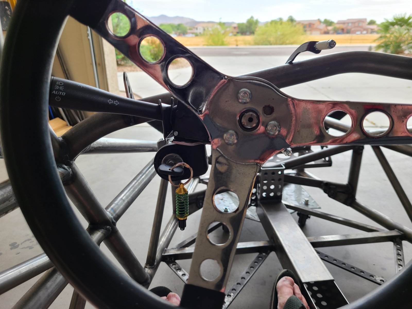

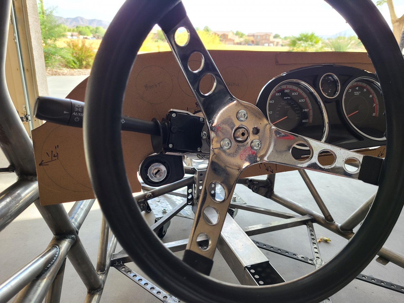

Relocated the ignition switch to make room on the left side of the dash - gotta have room for those tunes (dash speaker).
I also determined that having a steel dash panel in front of the ignition switch sensor (plastic) ring will not read the chip in the ignition key most of the time - it interferes with the RFID signal. So my ignition switch is moved to the lower edge of the dash and is forward enough for the plastic sensor to protrude slightly from where the dash panel will be mounted.
Since you are determined to save weight, why not eliminate that clunky ignition switch altogether and replace with something smaller and more lightweight? The key can be ziptied to the TDM and relocated somewhere.

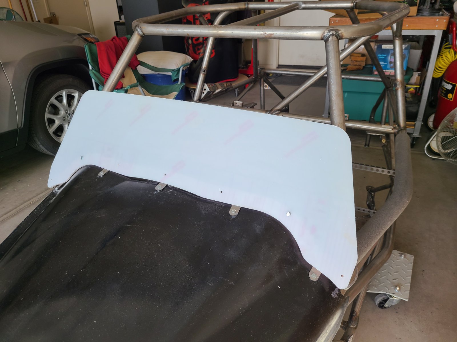

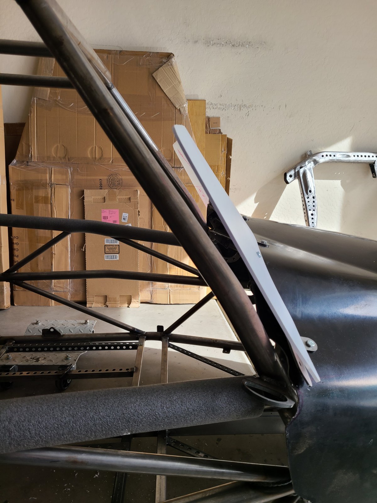

Playing with the windshield mount to change the angle, was definitely too straight from DF. Judicious bending of the hood mounting tabs, trimming of the bottom edge of the frame to match the hood contour, and putting some more bow into the frame gets the angle just right. ;)
Thinking the frame will look good in chrome. :cool:
And yes the plexiglass is on the outside just for the mock up.

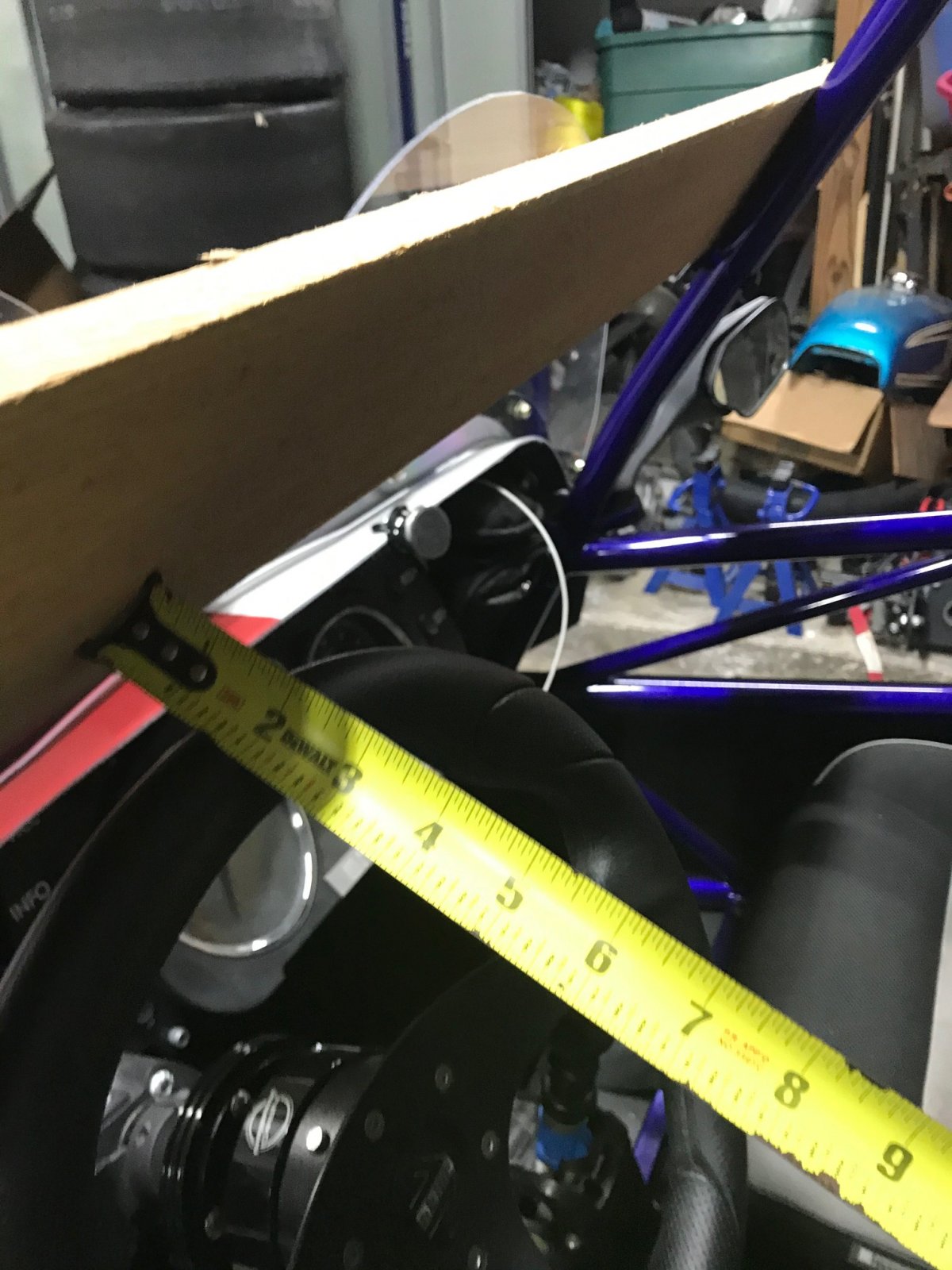

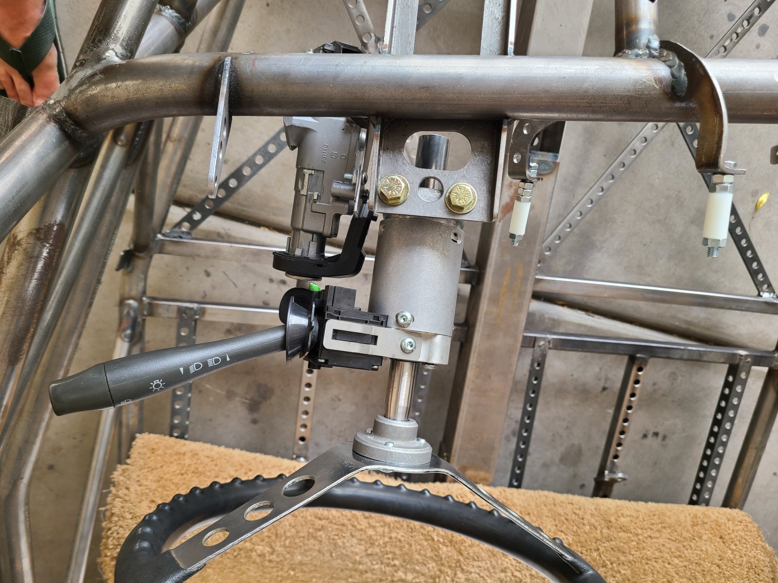

Tim: I assume you are going with a quick release for the steering wheel? Just asking since that will move the wheel closer to the driver.
You may want to get your wheel in place to ensure clearance with the windshield.
I have a quick release and just took the pic below for you to see how close it is.
I know that Scott @SACTX did a full windshield already. Not sure about his clearance. He may be able to give you a similar measurement.
Just a heads up! ;)
Yep, fully aware of the steering wheel to windshield clearance and I will be installing a quick release to have the knuckle room. I personally like the steering wheel closer than most people, so having it closer to the drivers seat is ok with me. :D
