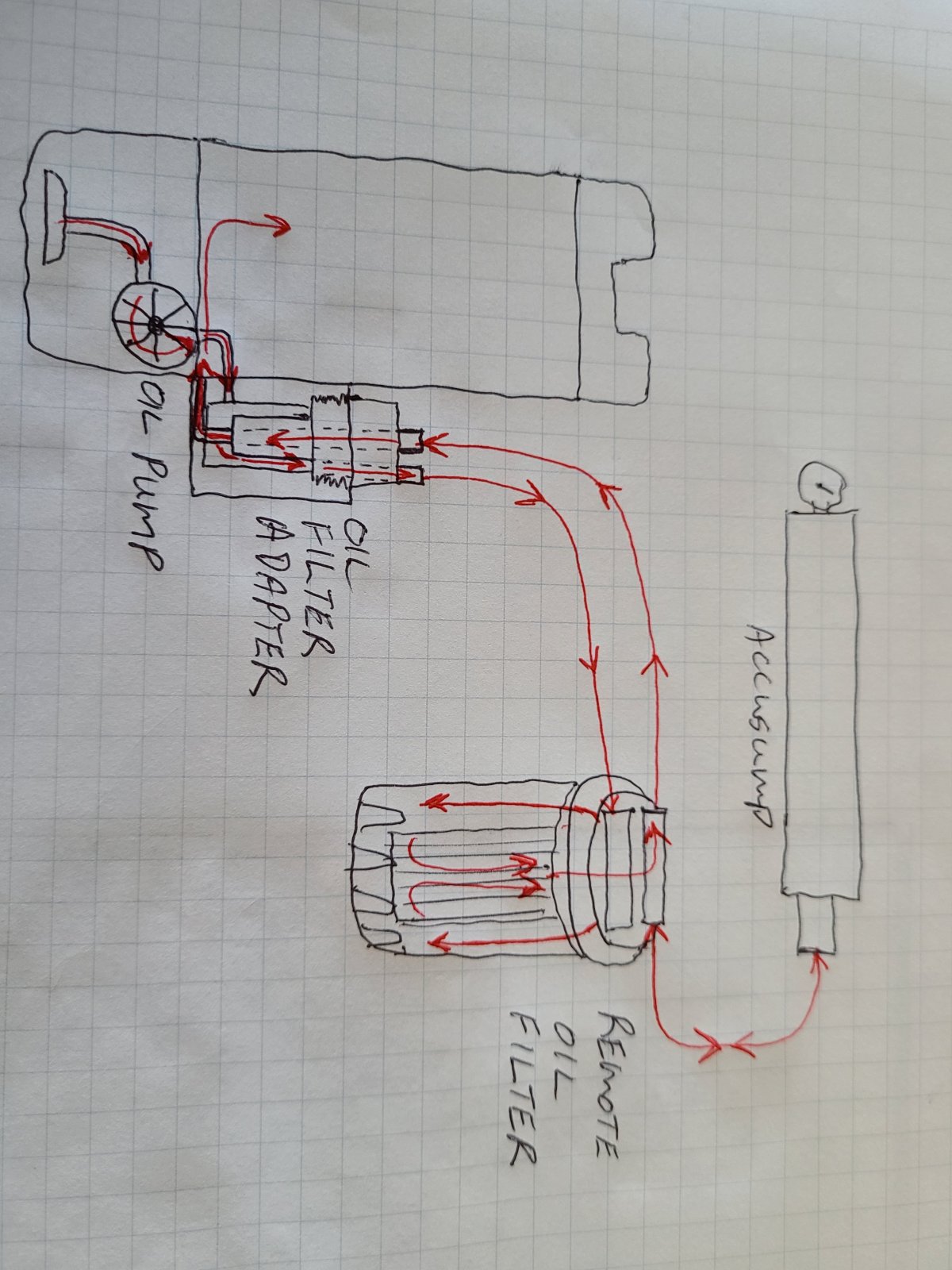

Here is a diagram of the oil flow in the Ecotec with the DDM oil filter adapter to a remote oil filter and back to the engine. The Accusump gets plumbed right into the remote oil filter at the return to the engine. The oil pressure check valve is located at the base of the oil filter boss on the engine right after the oil pump. It is there to keep all of the oil from the stock oil filter from draining back to the oil pan through the pump. Keeps the engine from a 'dry start that would have to pump oil into the oil filter before getting oil pressure into the engine.Ok, I was thinking too much last night about the remote oil filter I will be installing and if it would be possible to add an Accusump to the system for startup oiling and potential loss of oil pressure. Several other builders have incorporated the Accusump for this purpose, but are plumbing it into the oil galley system in the block - which is perfectly fine.
Since I will be utilizing a remote filter mount, why not just plumbing it into the return port (center plug) on the filter mount? (See the attached eBay part) The center port feeds directly to the block oil galley (through the DDM oil filter adapter I have on order). At start up and oil pressure loss it is the same oil galley feed as the oil from the pump through the oil filter. This seems like very logical way to take care of my oil filter access problem and an easy way to incorporate an Accusump.
BTW, the oil filter boss in the engine block has a built in pressure check valve to prevent backflow into the oil pump - so all the pressure from the Accusump will go into the block oil galleys.
