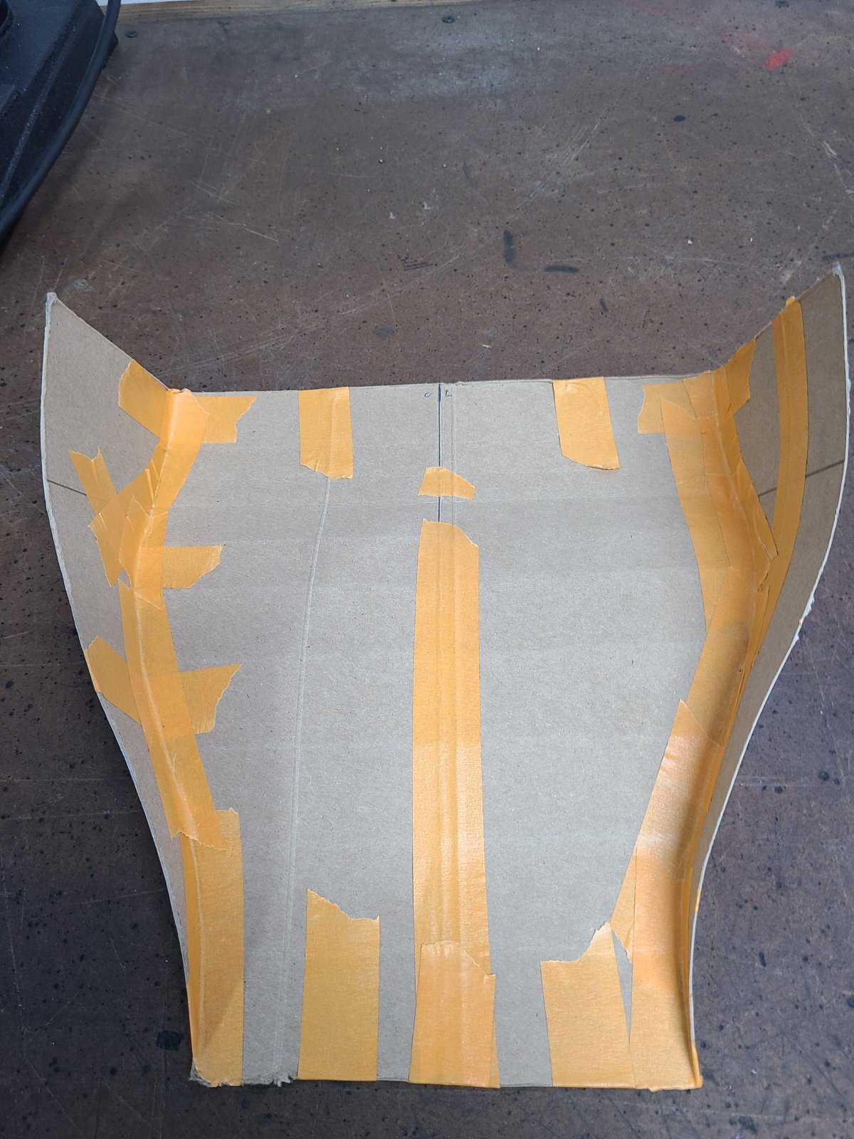

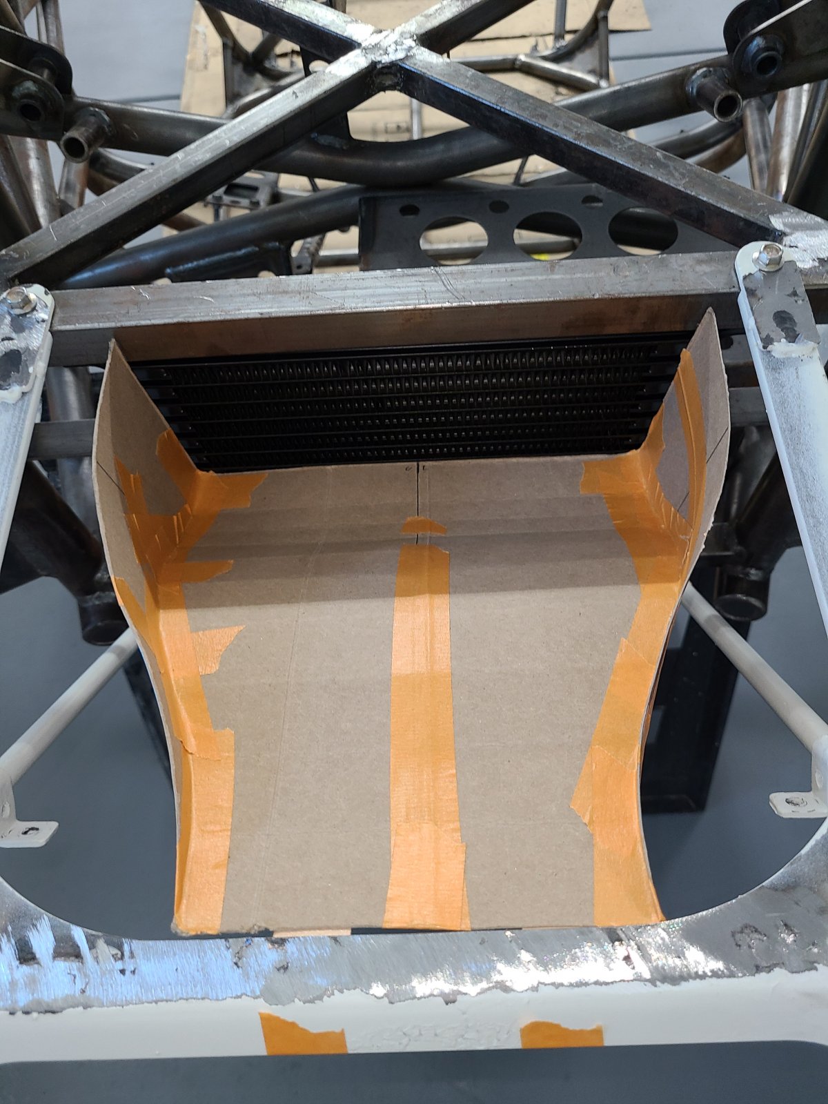

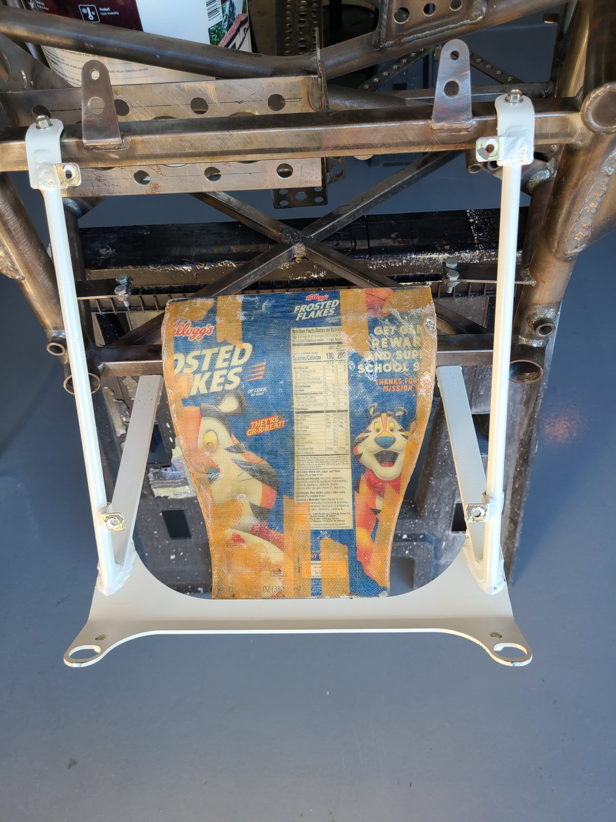

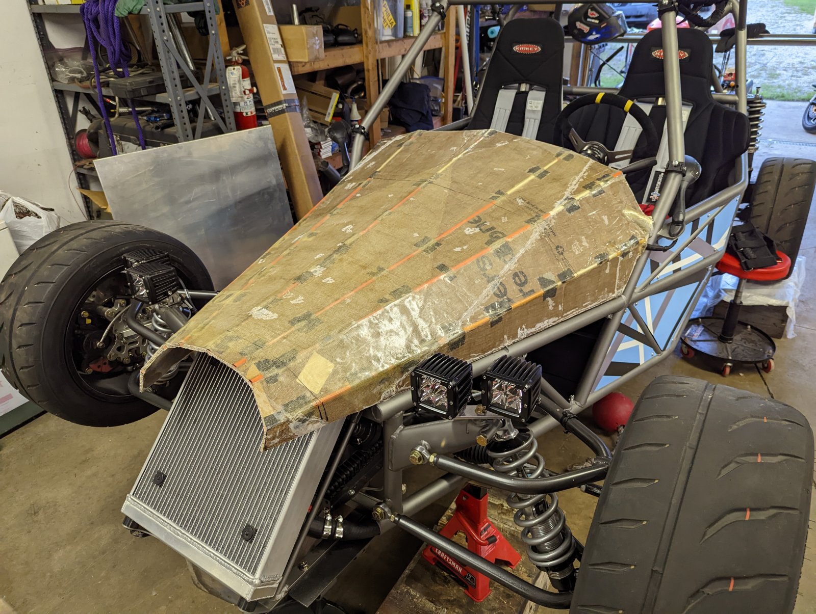

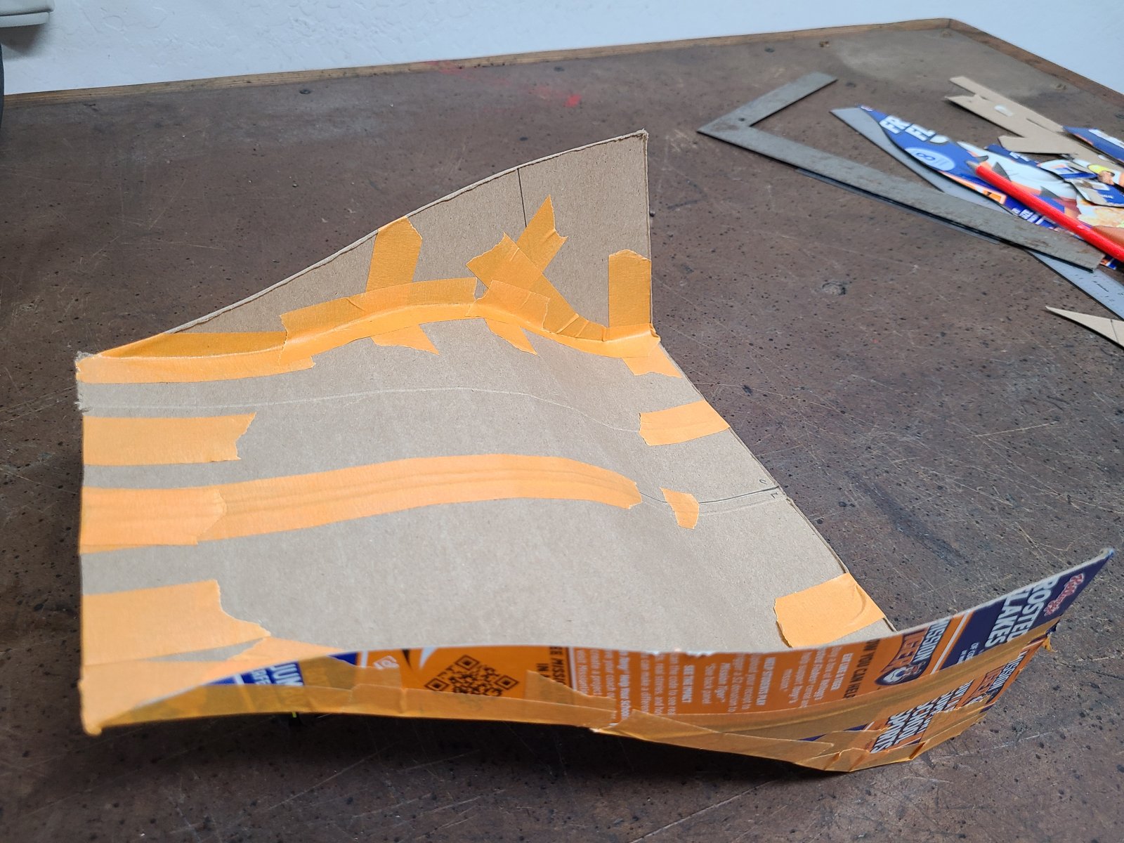

More CADboard mockup for a double width NACA duct:

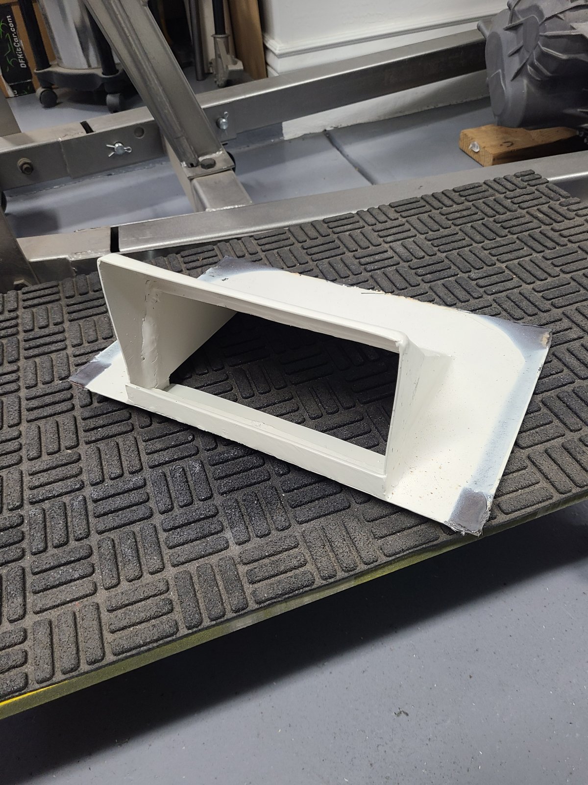

This will be rendered in fiberglass and replace the steel duct/plate that I had previously welded onto the radiator support bracket:
I will be fabricating an aluminum plate with an integral splitter to replace this plate and incorporate the NACA duct into this new aluminum plate, directly under the radiator, to funnel air into the auxiliary cooler that I've discussed in a previous post:
And yes, that's a Frosted Flakes box. :D
Just one more thing in a long list of things (that always seems to be growing o_O) to complete. My wife just shakes her head every time I break out the welder, grinder or fiberglass since it usually means I'm off another tangent that will cost more money and time to get this car built. :eek: She still loves me most days, would hope so after 40 years of putting up with me. :cool:

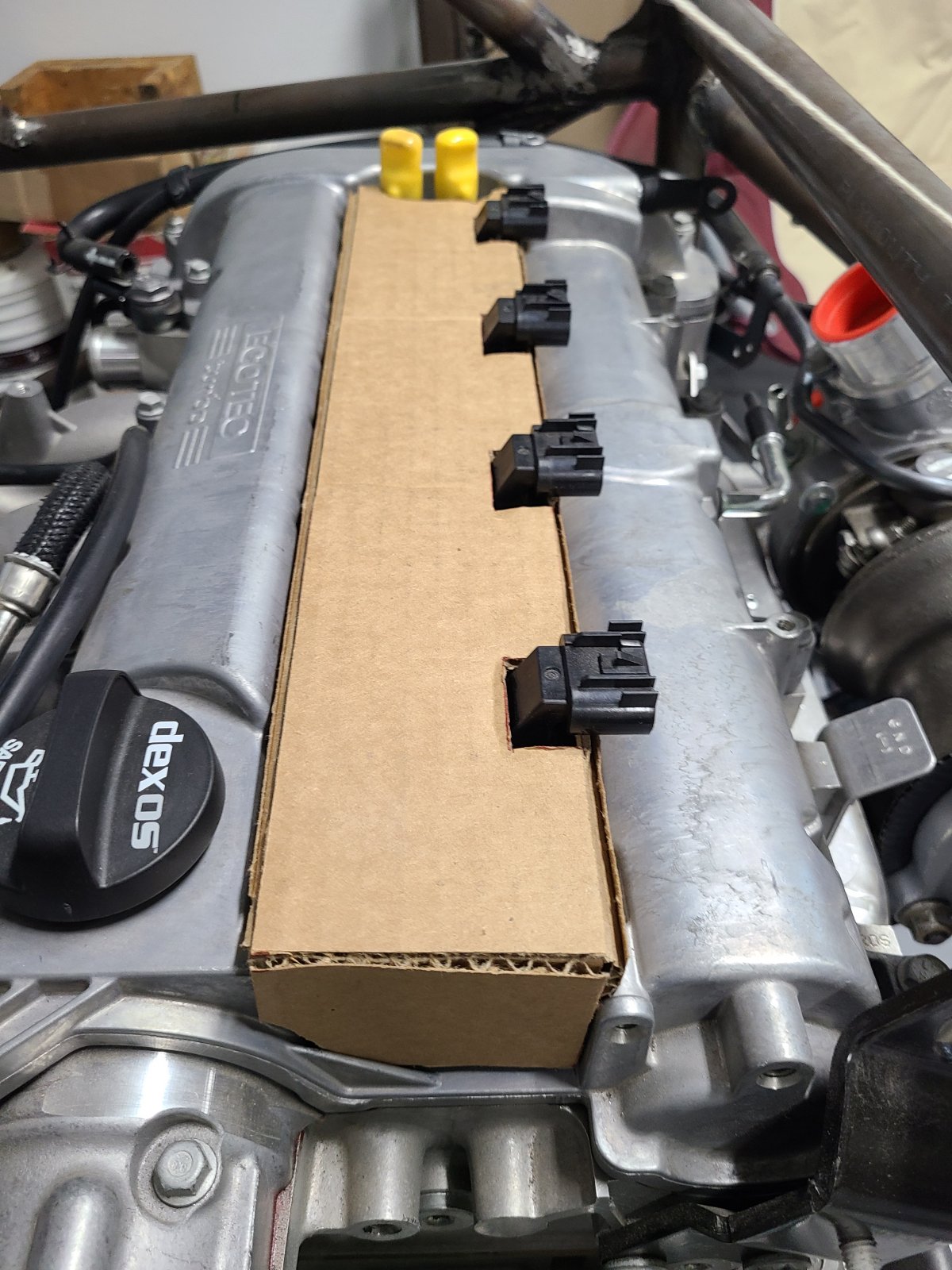

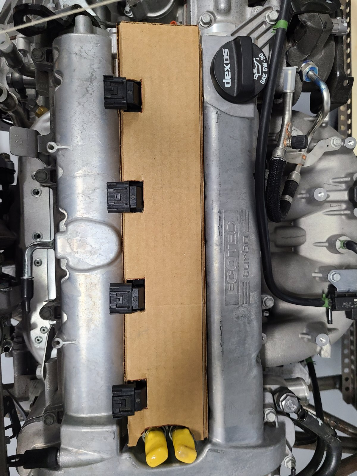

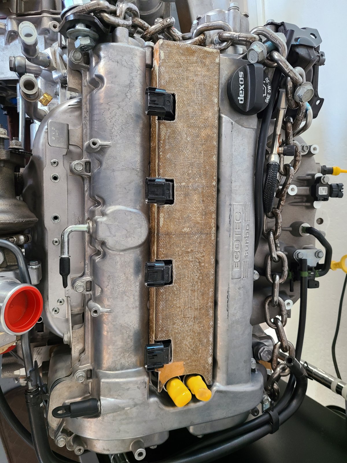

While I'm bored (NOT!) waiting on materials to show up, I broke out the CADboard to play with a valve cover channel cover idea:
View attachment 35472View attachment 35473
It would be made of fiberglass, so no chance of electrical issue with the spark plug coils. Just another thing to occupy my time tinkering until I get the rear suspension fully designed and fabricated. :cool:
Got the channel cover fabbed up and fiberglassed, it fits nicely.

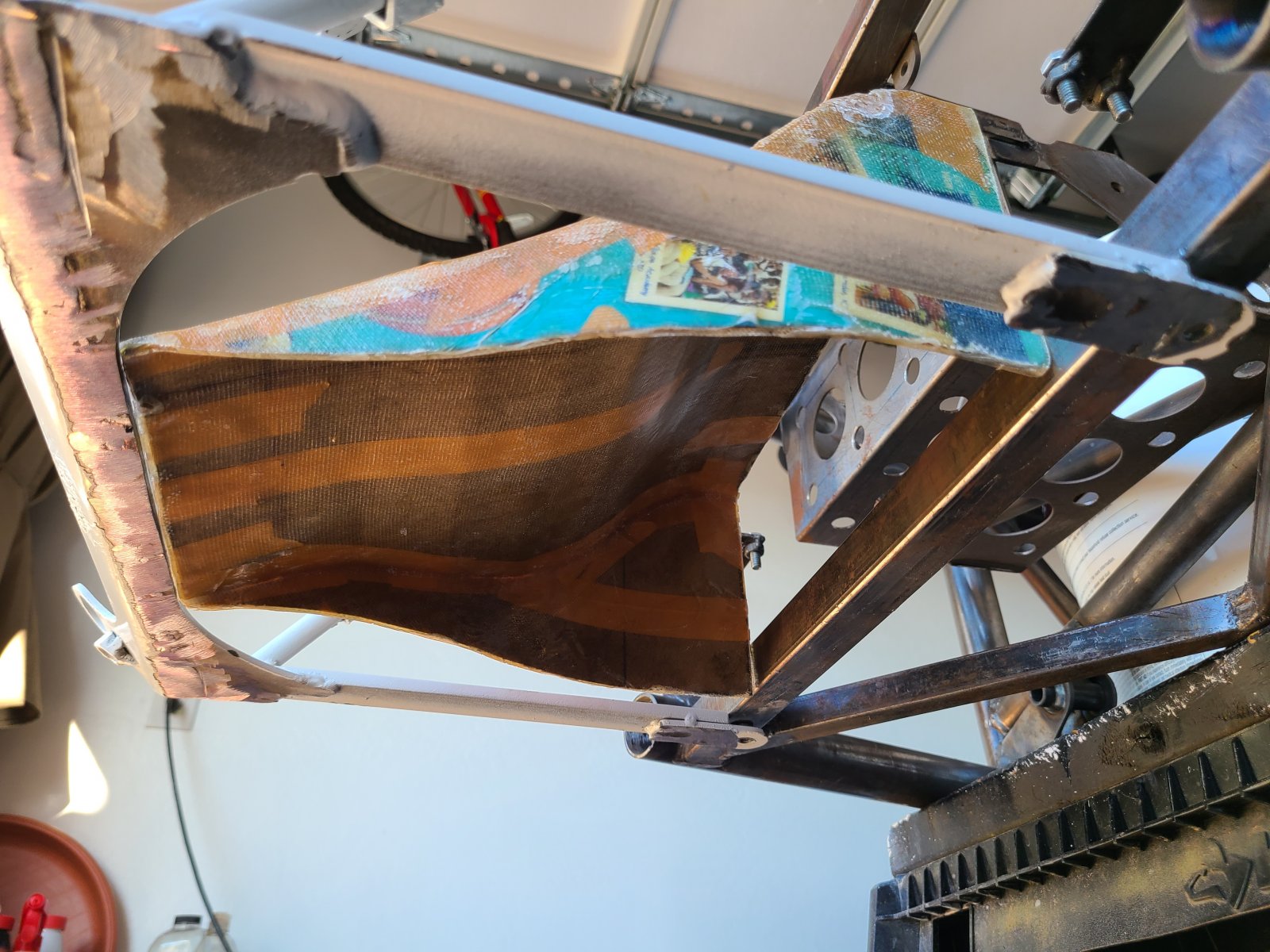

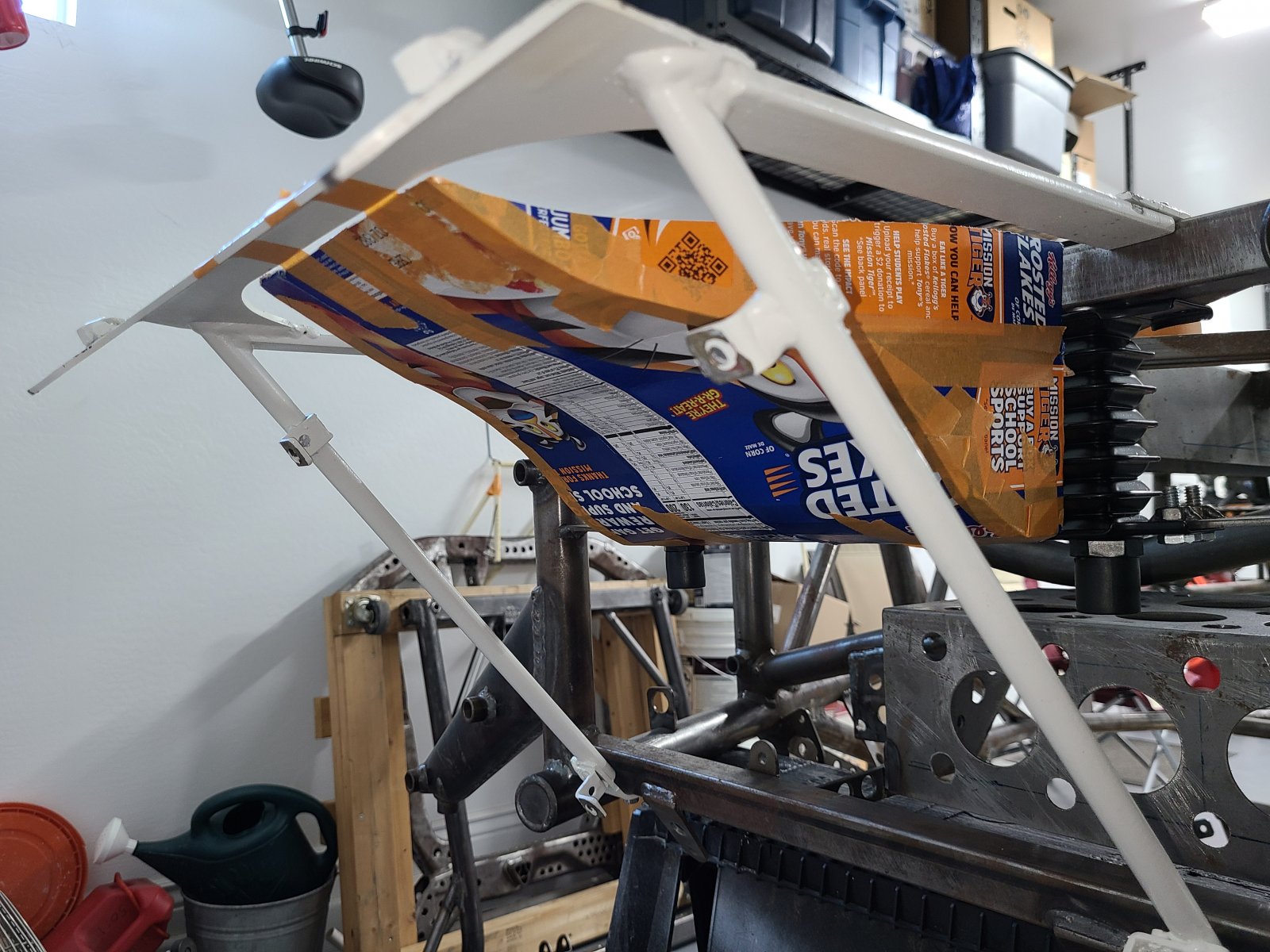

Also completed fiberglassing the NACA scoop to replace the steel one I had previously made.

The valve cover addition is a great idea. Well done, Tim.
The LSJ’s had one. Not sure why GM deleted it on the LNF. I can assure you that area is a gutter for rocks thrown up from sticky tires.
Thanks! It's a Fruit Loops box, cut, folded, taped and a single layer of fiberglass on the inside and outside - so it still has a little flex. I'll do some flex filler to the rough spots and shoot it with some paint eventually.

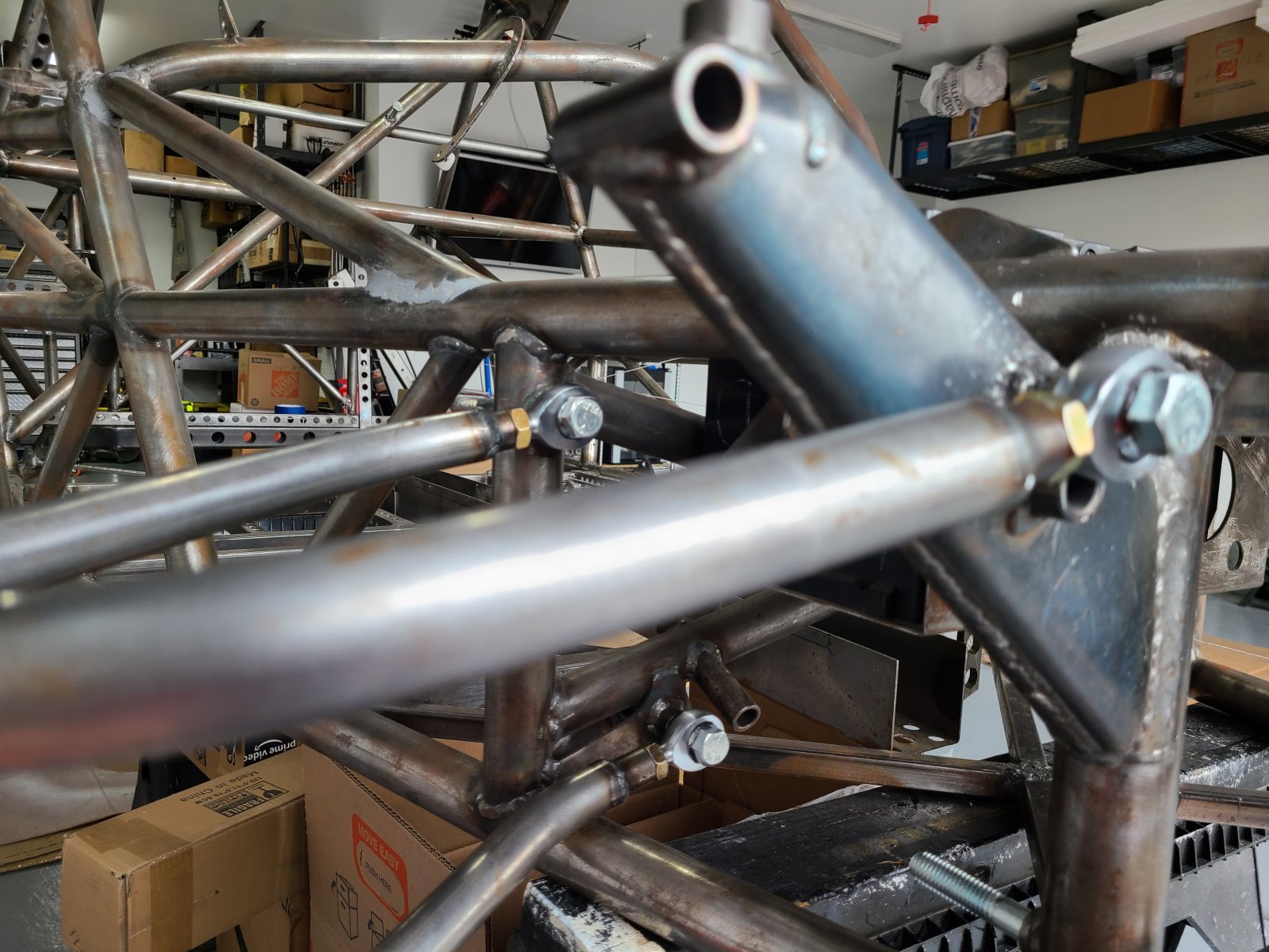

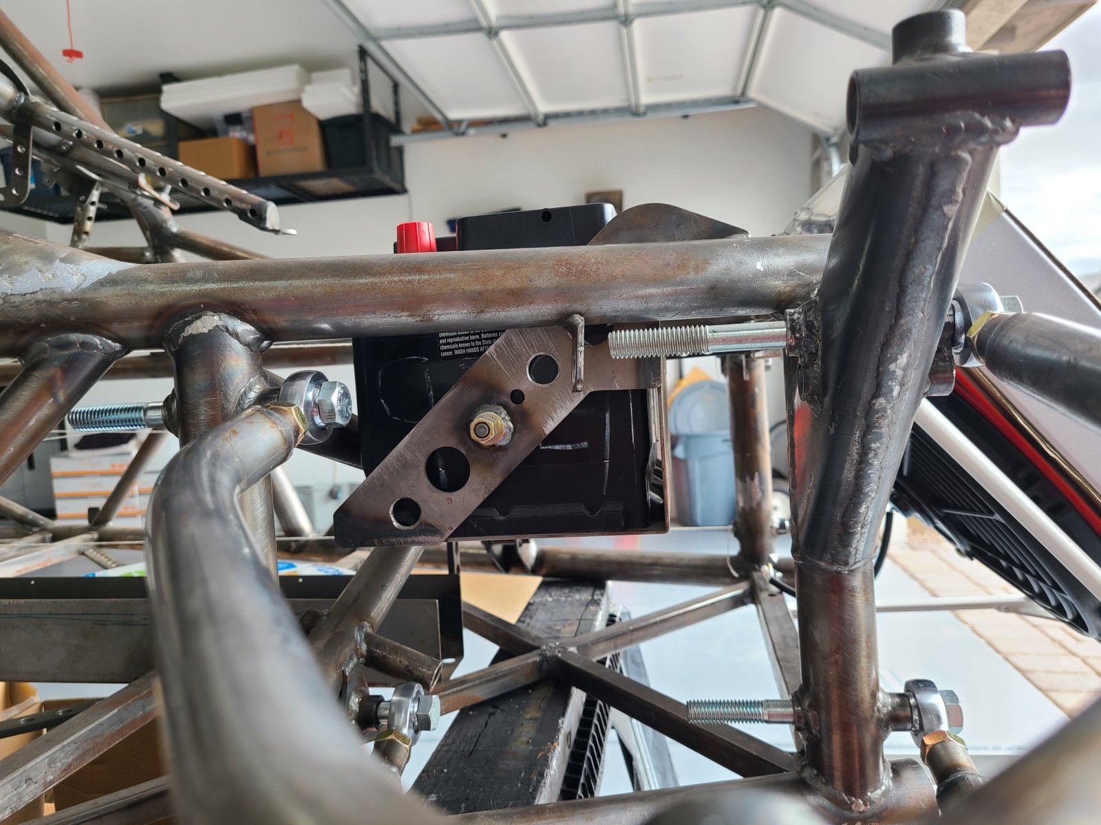

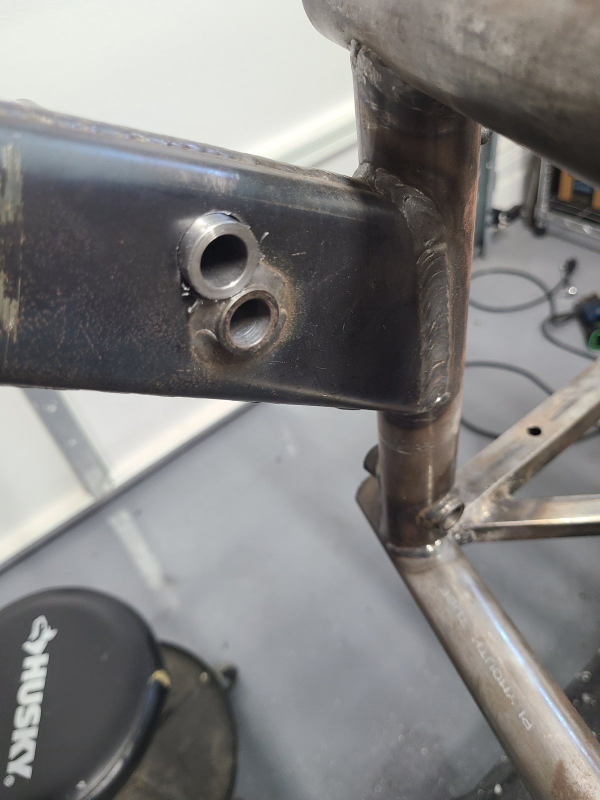

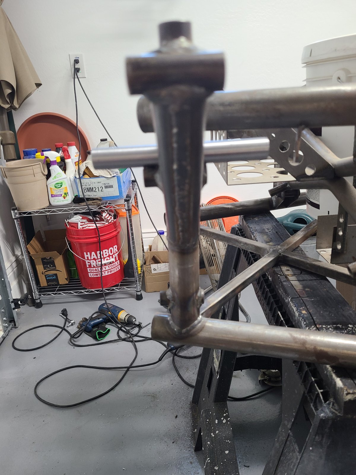

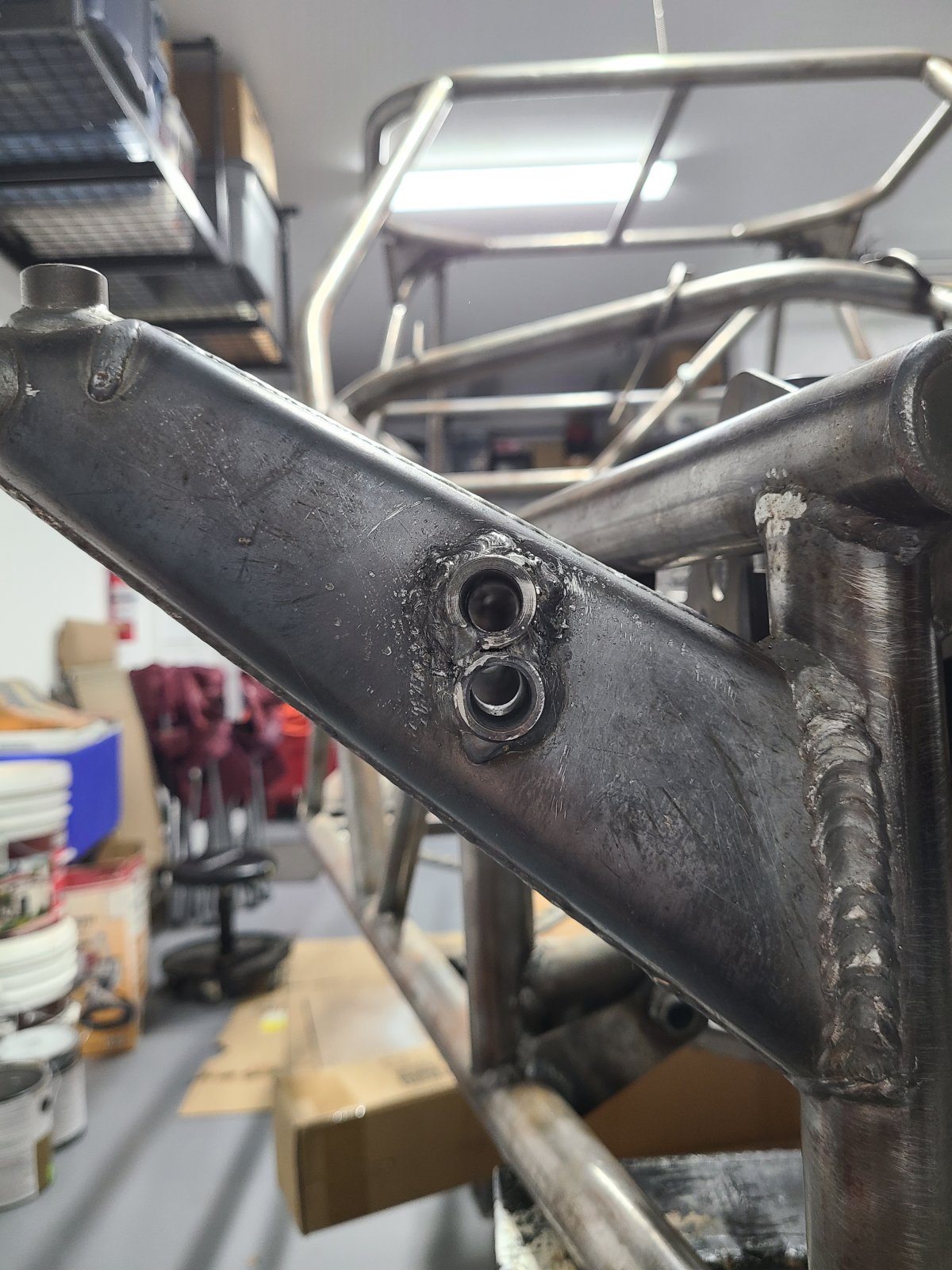

Time to fix the missing anti-dive geometry in the front suspension. Moving the UCA forewardmost mounting bushing up 3/4 inch (above the existing bushing mount), angles the UCA downward toward the rear by about 4 degrees. This will add approximately 12% anti-dive to the geometry to help keep the nose out of the dirt under hard braking.
It's still a Goblin, mostly! Can't help it that my inner engineer has to make improvements to everything I touch. ;) (and Racer X sneaks into my garage and starts drilling holes into everything)
Lonny built an excellent kit, which we all know, and it is in a very elite class for legal street cars - Sevens, Atoms. Unfortunately my Goblin is also my 'retirement' project and I can't turn that engineer thing off, sooo ideas, analyses, fabrications, and modifications happen. :p:cool:

Ross, it will be a while before the new geometry can be tried, but here's a couple photos of the suspension arms mocked up.
