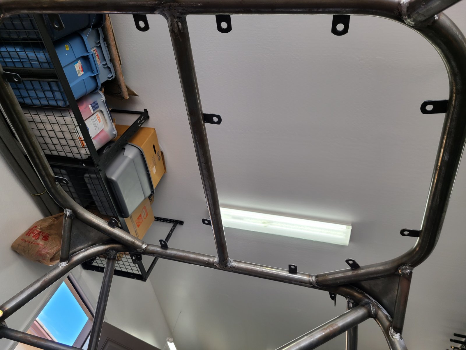

Welded steel tabs around the halo, button head screws on acorn nuts. This mounting system can also be used if I decide to use an acrylic top too if/when I decide to let the sunshine in. ;)

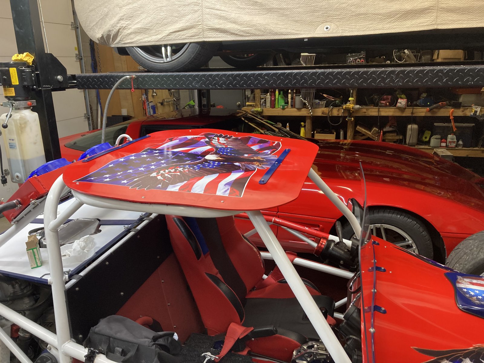

That’s what I did using polycarbonate for the roof. I ended up just going with black polycarbonate that I’m working on painting and will have an American flag decal on it.

Got the tabs welded in to mount the roof panel.

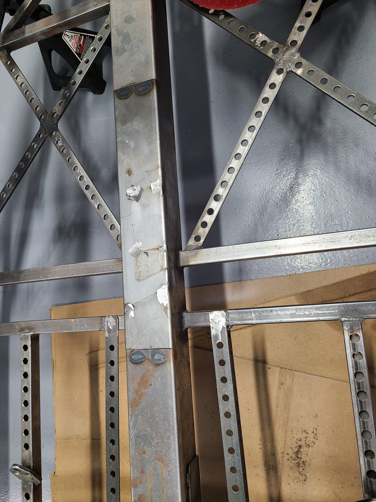

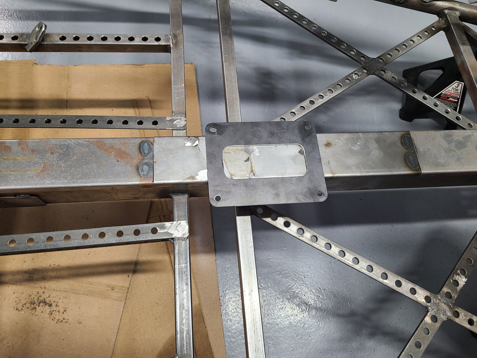

Also removed the original shifter mount plate from the tunnel cover to install a different plate to accept another style of shifter. Need to determine the optimum fore/aft location before it will get welded in.
Plan to add lateral brackets for more support for the shifter - and it will need some speedholes too!

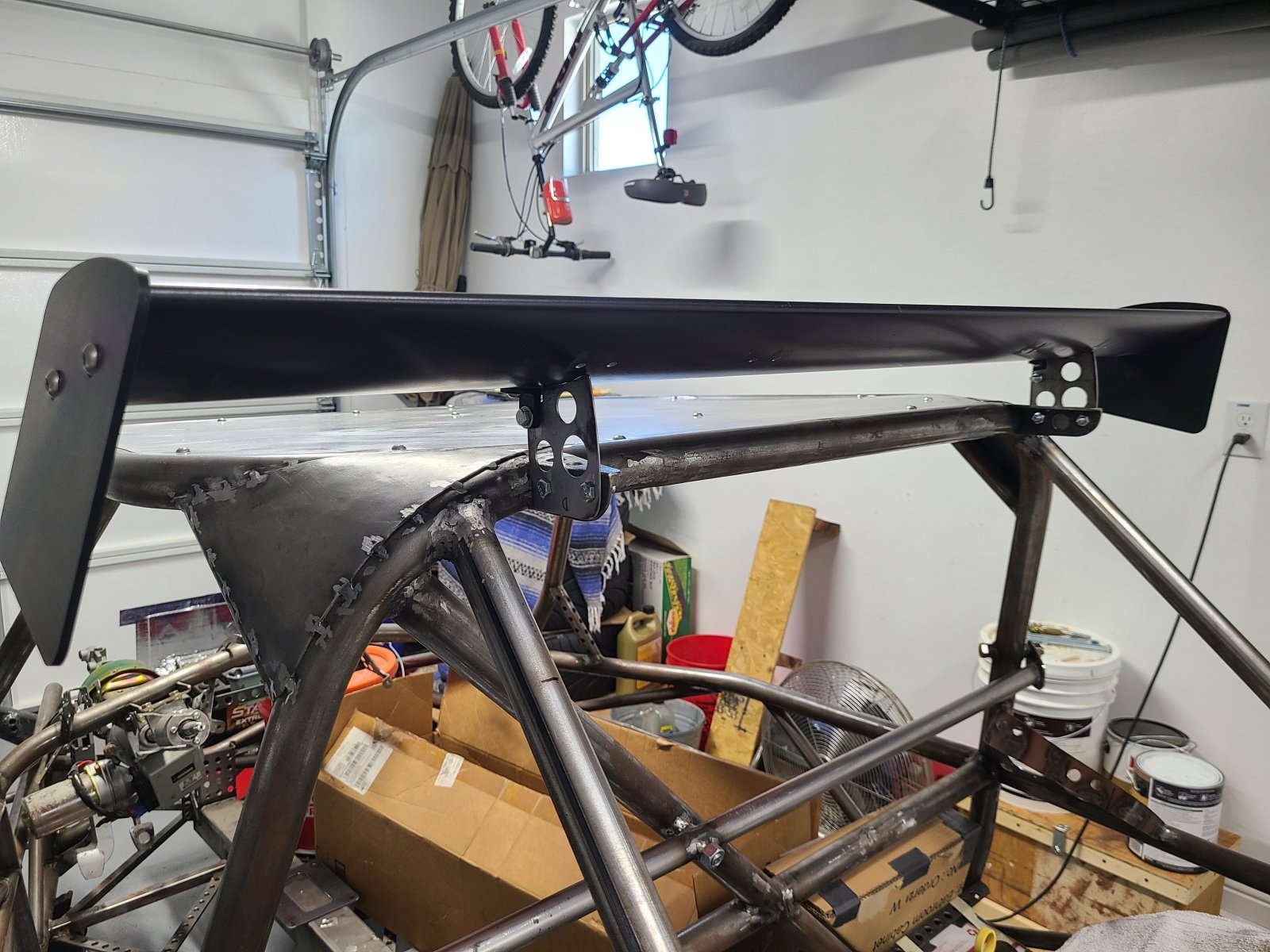

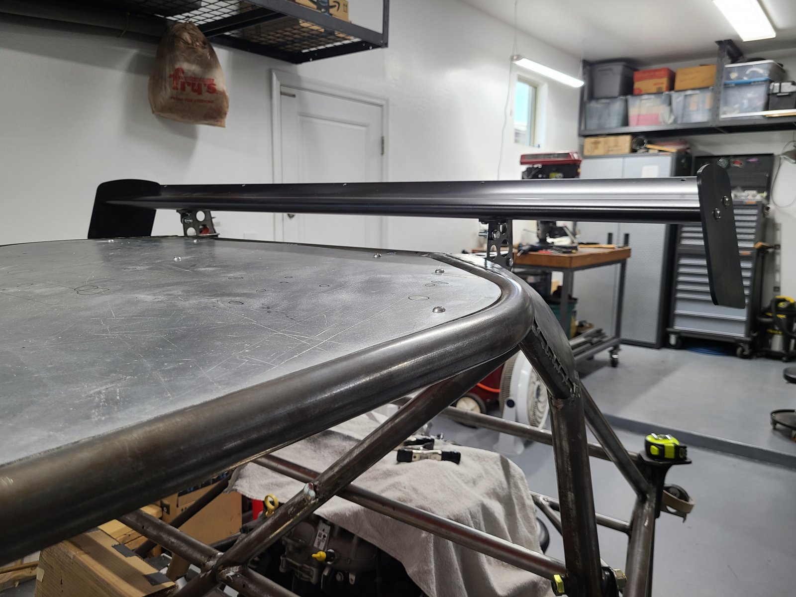

Tinkering this morning, I fabbed up the final design for my wing mounts (yeah, they do have speedholes). They are just a wee bit shorter than most everyone else's (except @Ross).
The flat roof panel will help with the efficiency of the wing, getting clean and slightly compressed airflow directed across the bottom of the wing. I'll be employing an aero trick on the wing to increase downforce (bet some of you already know what it will be). I also plan on doing something a little different with this wing that will help with handling, stay tuned. :D

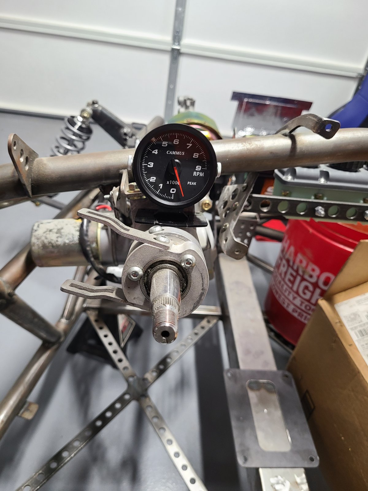

OBD2 tachometer 0-9000 RPM, will fit perfectly directly above the steering column (along with the other 2 most important gauges - oil pressure and boost).

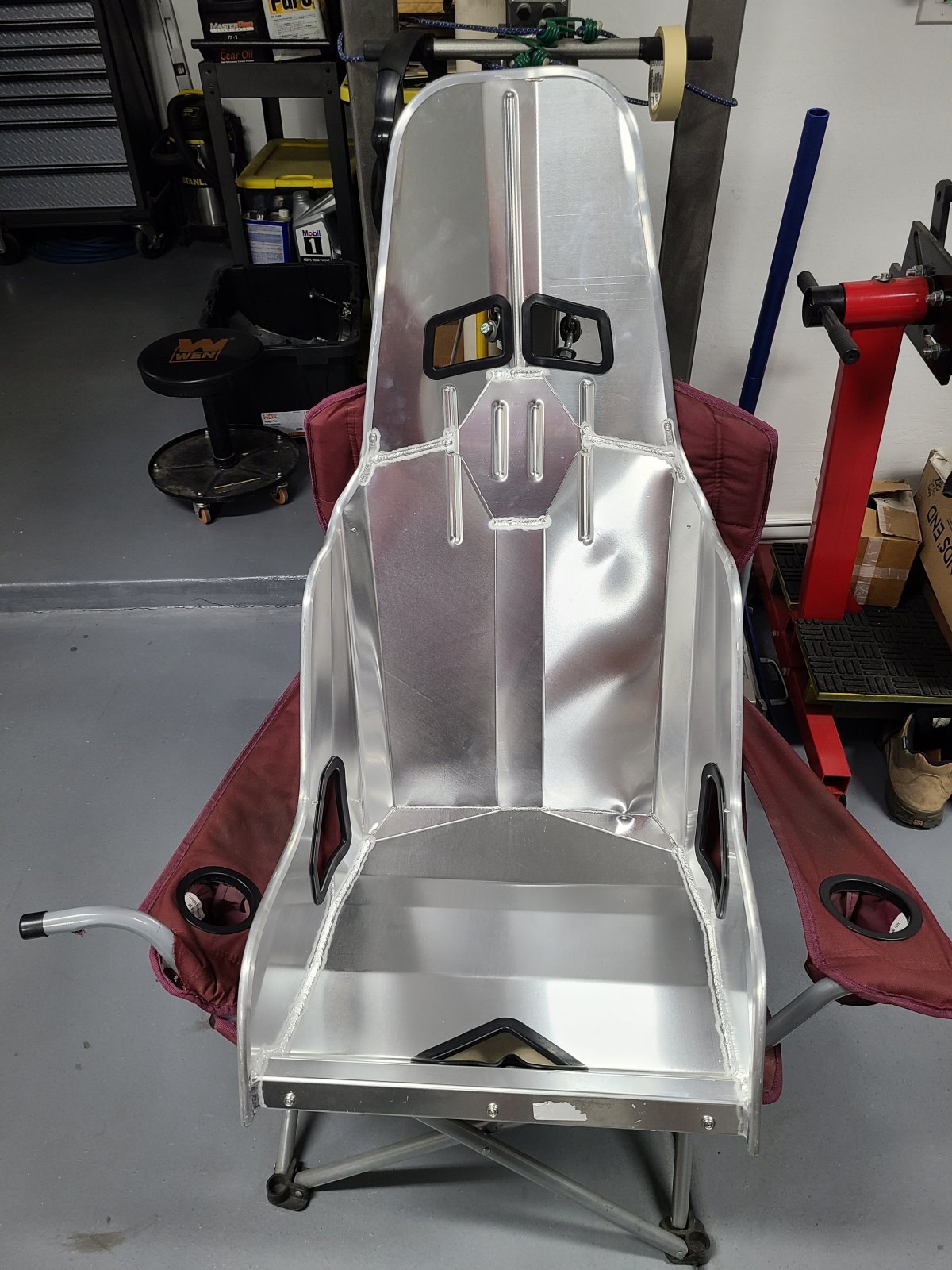

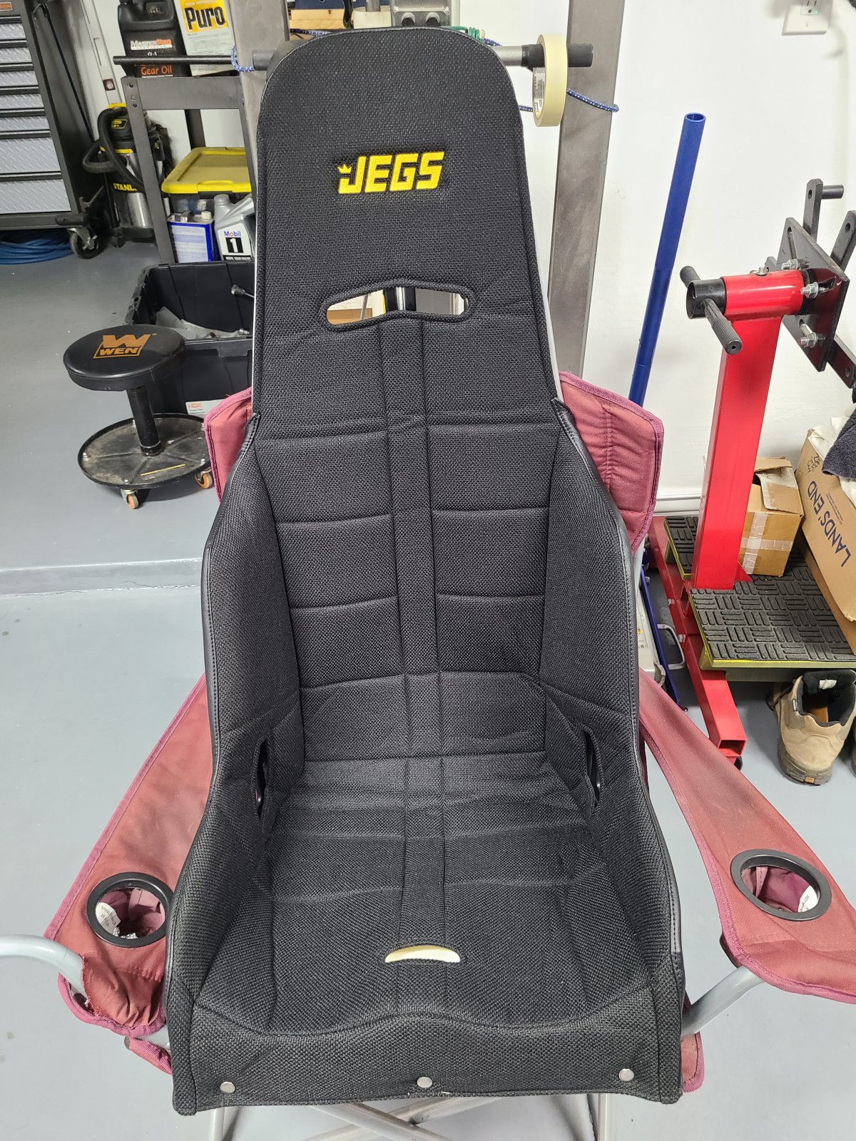

Also decided the cheap (really cheap) ebay seats already have gotta go - they are coming apart and I don't even have them installed yet! Replaced with 18 inch Jegs aluminum with their padded cover - nice tweed fabric. Fits my Squatch butt snugly, a little tight in the midsection, but some judicious tweaking will make some more room.
