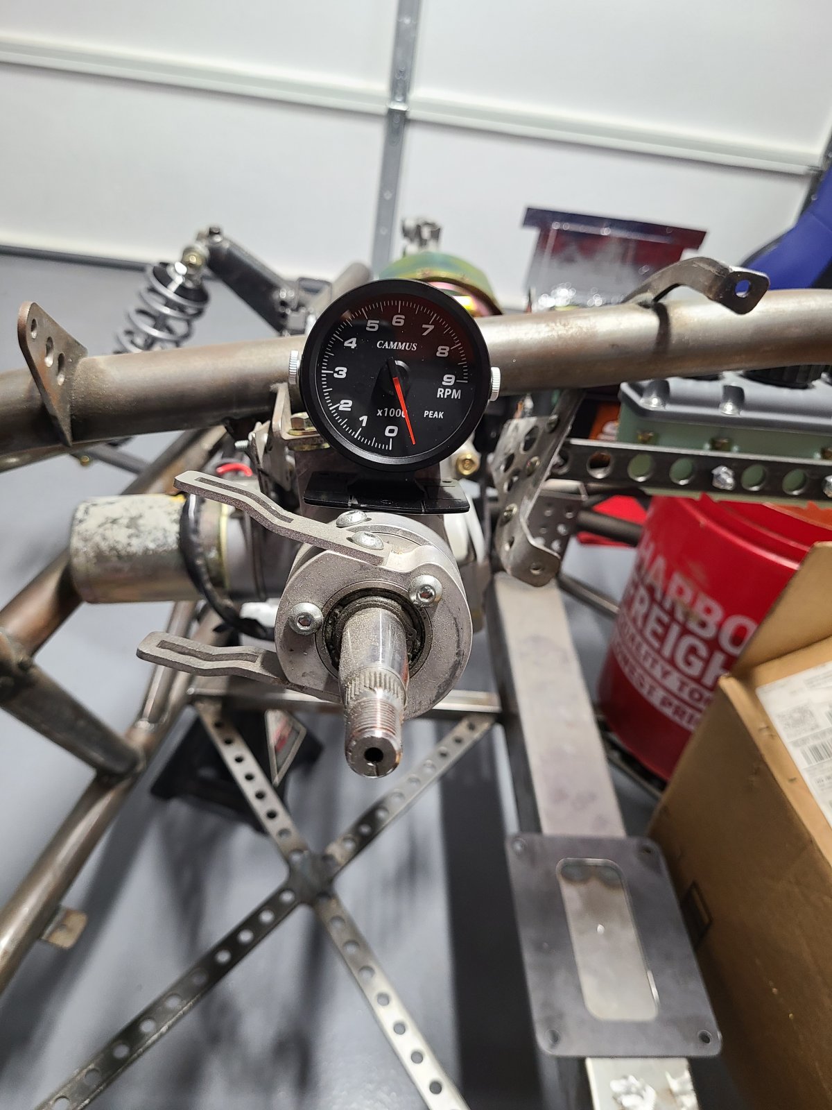

OBD2 tachometer 0-9000 RPM, will fit perfectly directly above the steering column (along with the other 2 most important gauges - oil pressure and boost).

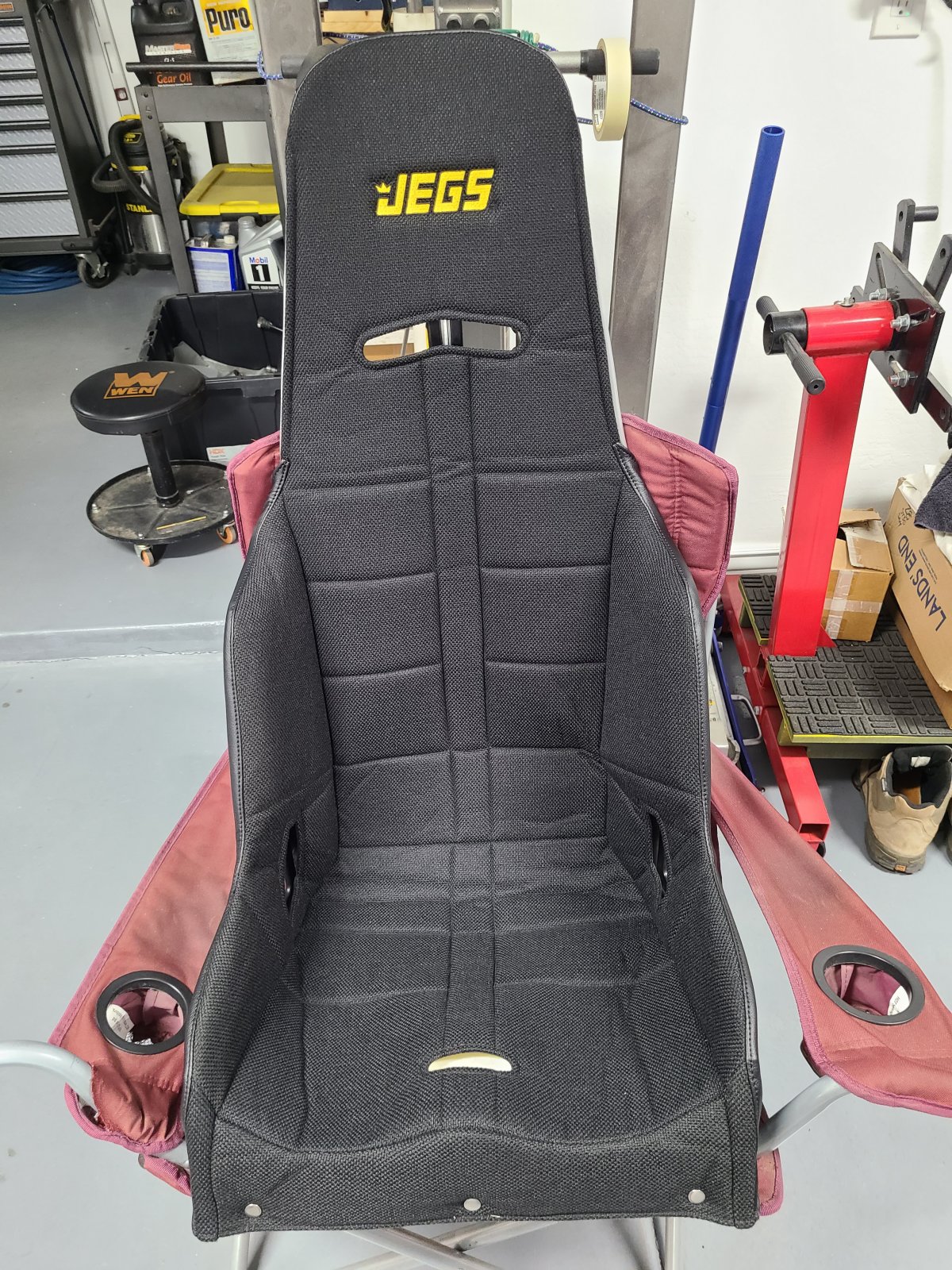

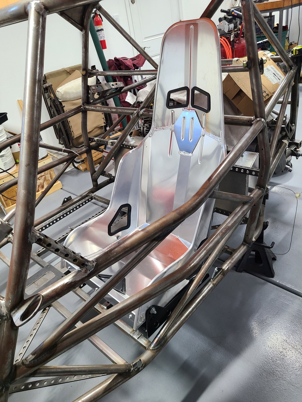

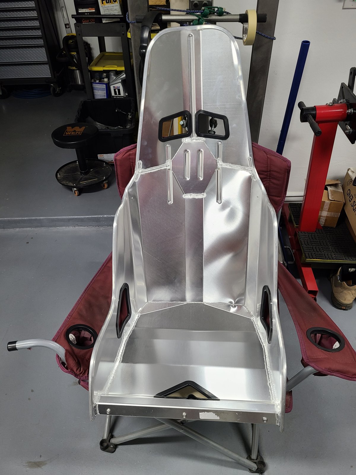

Also decided the cheap (really cheap) ebay seats already have gotta go - they are coming apart and I don't even have them installed yet! Replaced with 18 inch Jegs aluminum with their padded cover - nice tweed fabric. Fits my Squatch butt snugly, a little tight in the midsection, but some judicious tweaking will make some more room.
View attachment 40489View attachment 40490
Forgot to mention - aluminum seat with cover and mounts = 17.5bs (2X =35lbs). Cheap ebay seat with sliding mount = 33.5lbs (2X = 67lbs). Weight savings of nearly one entire seat - 32lbs. It all adds up! :cool:

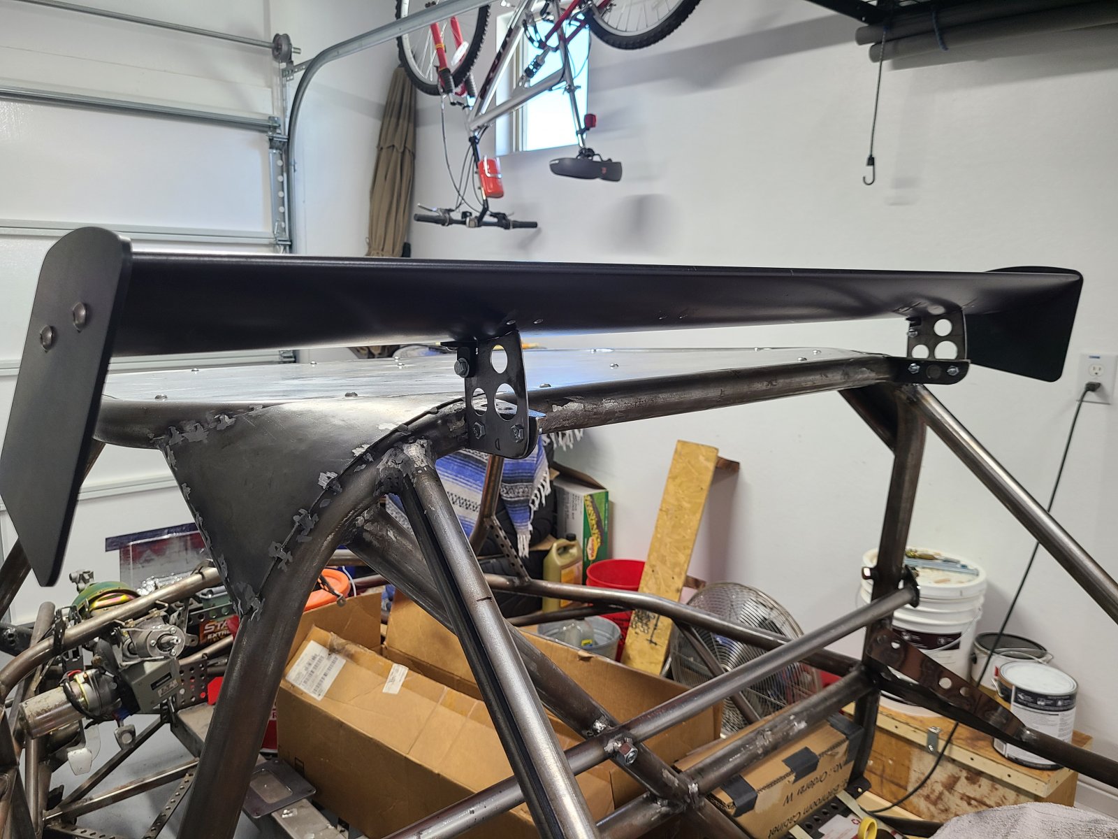

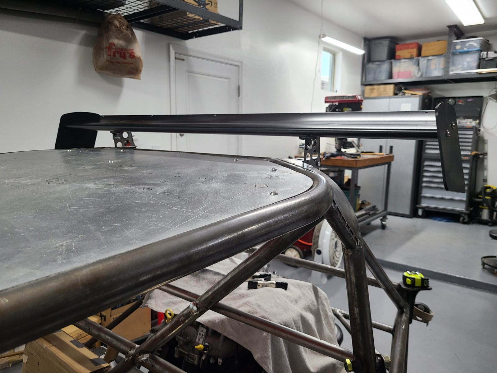

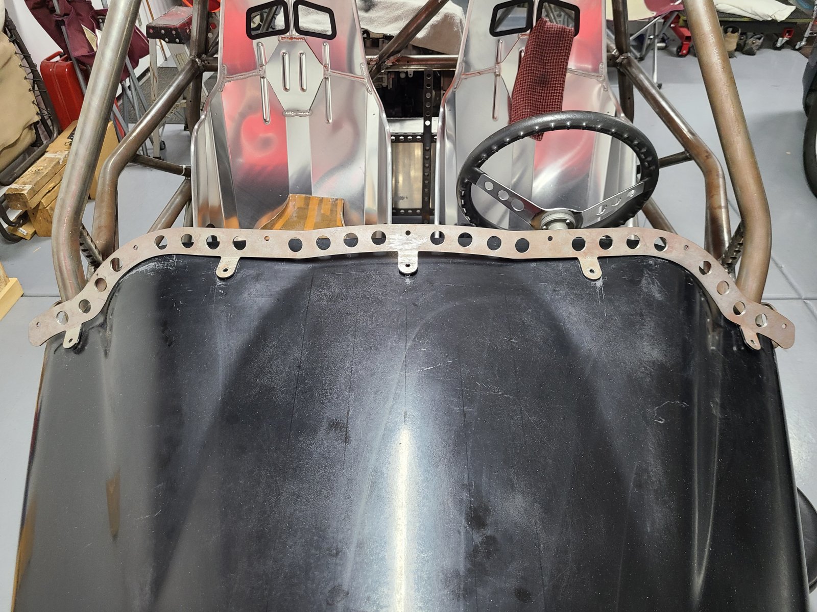

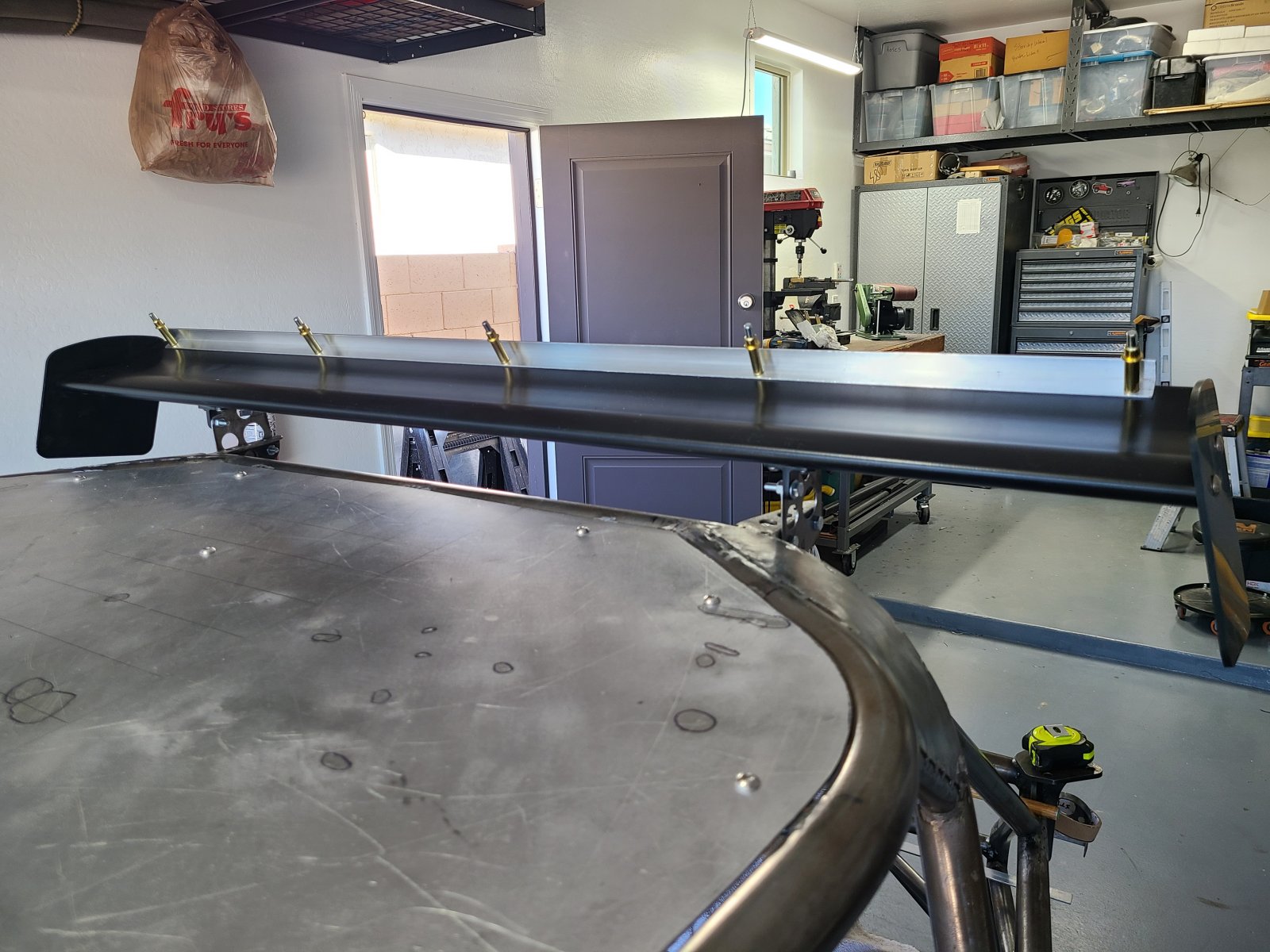

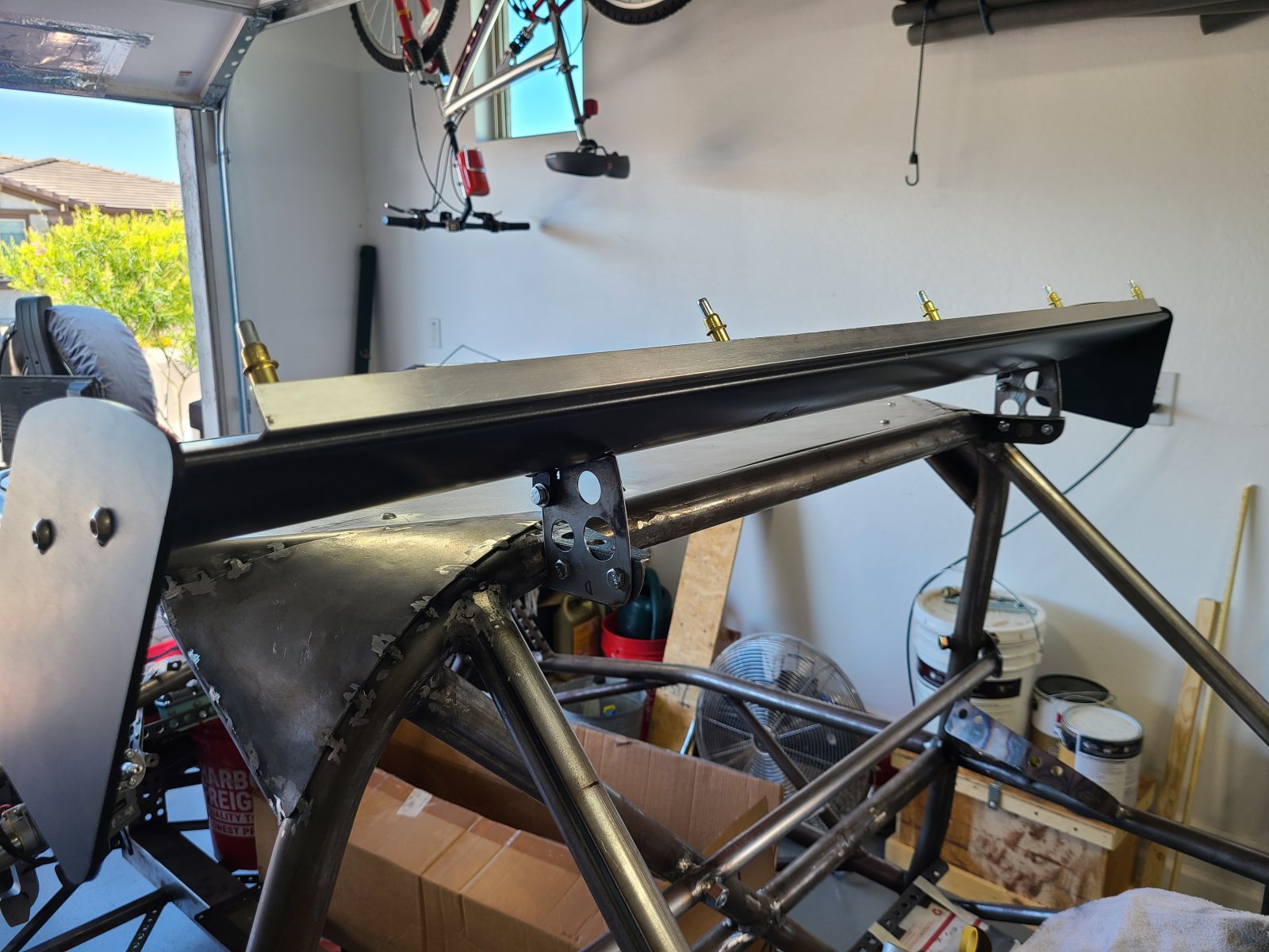

Tinkering this morning, I fabbed up the final design for my wing mounts (yeah, they do have speedholes). They are just a wee bit shorter than most everyone else's (except @Ross).View attachment 40384View attachment 40385
The flat roof panel will help with the efficiency of the wing, getting clean and slightly compressed airflow directed across the bottom of the wing. I'll be employing an aero trick on the wing to increase downforce (bet some of you already know what it will be). I also plan on doing something a little different with this wing that will help with handling, stay tuned. :D
(wanted to post something that doesn't have anything to do with wiring and increase @Gtstorey frustration level! :p)
1/2 inch Gurney flap on the trailing edge of the roof wing. May seem tall, but the majority of the time a Goblin operates below 75ish MPH and the Gurney flap is meant for operation above 150ish MPH. And those are Clecos holding it in place for alignment - temporary before it will riveted in place.
For those not knowledgeable of aerodynamics, the flap increases the high pressure 'bubble' on the top of the wing and creates a larger low pressure area at the back edge of the wing to pull air across the bottom to increase downforce (simplest explanation). Seems almost too simple, but it is proven to increase wing downforce by 25% or more, so my 'little' 48 inch wing is essentially the same as 60 inch wing without a Gurney flap - at speed. Aerodynamics lesson over. ;)

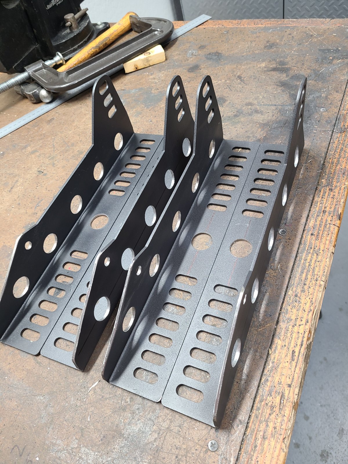

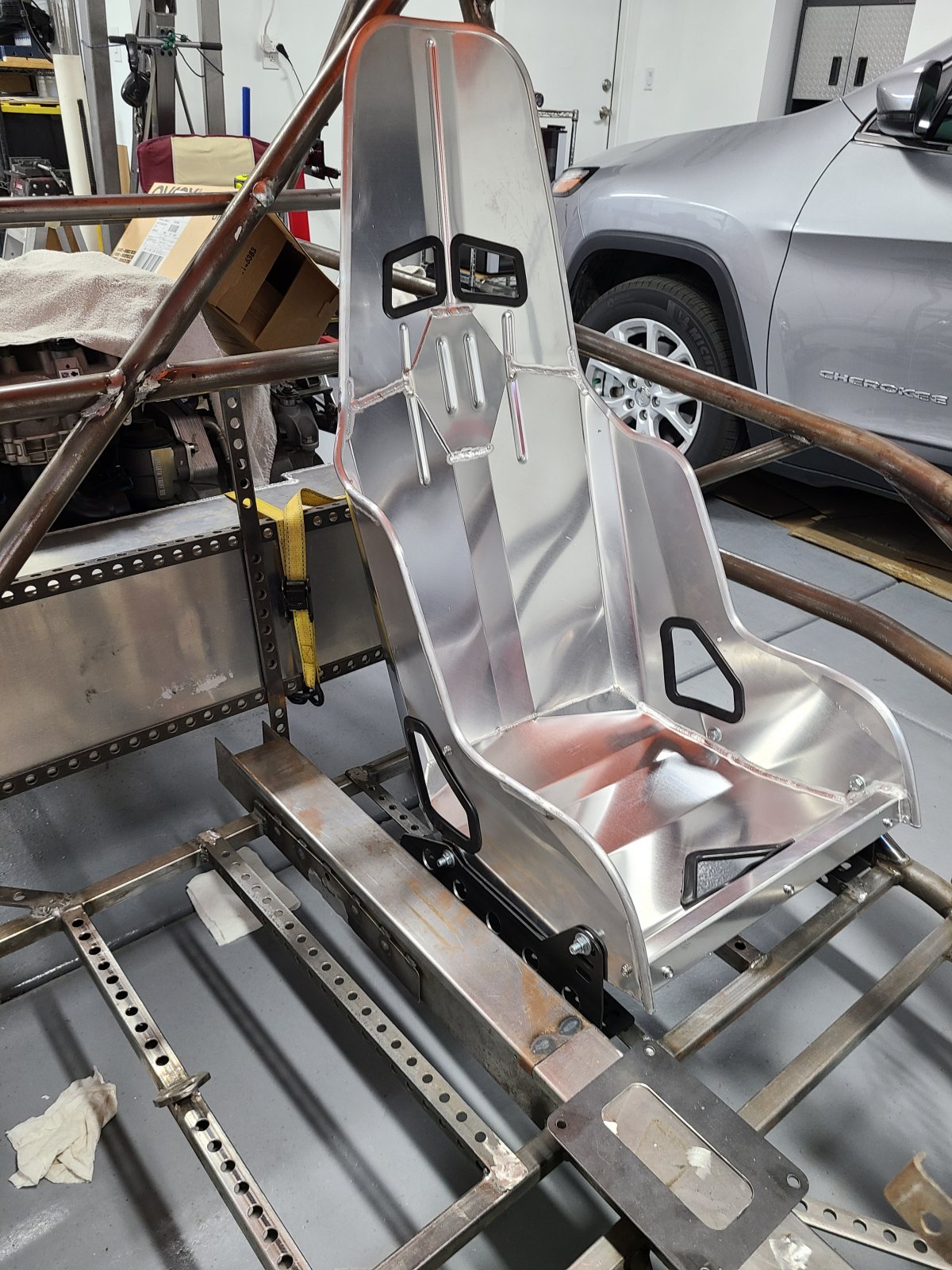

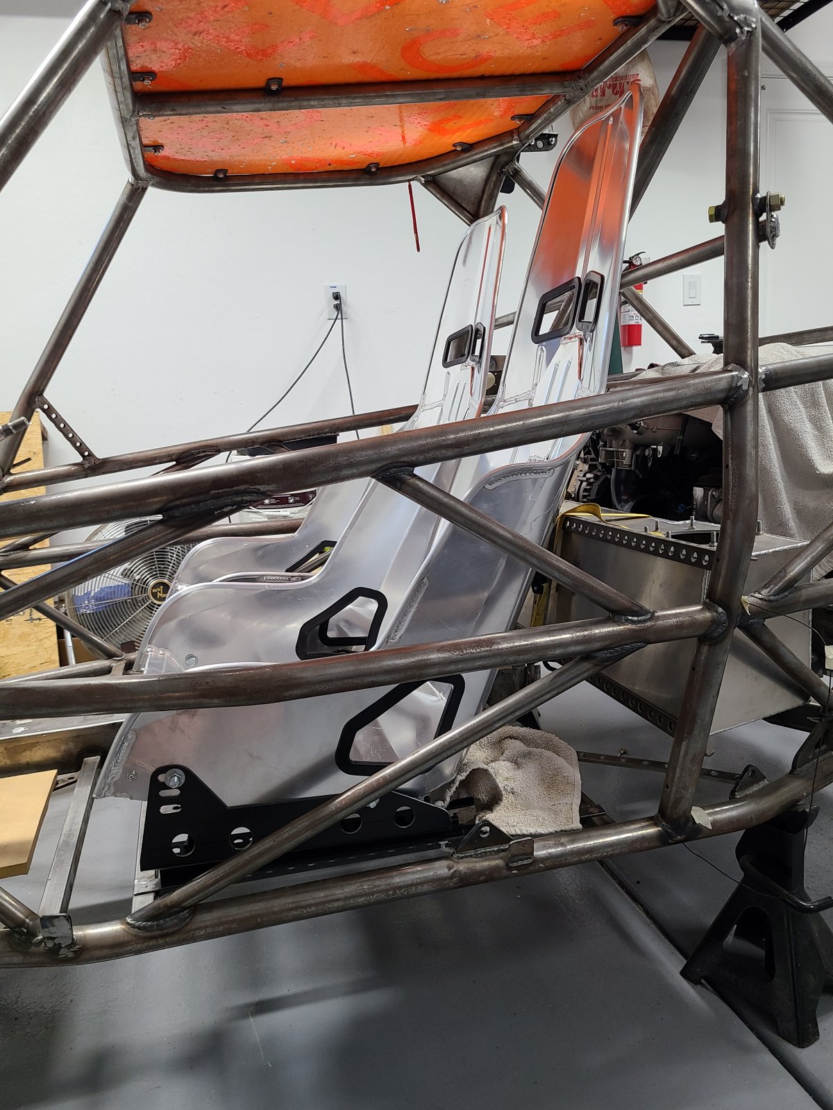

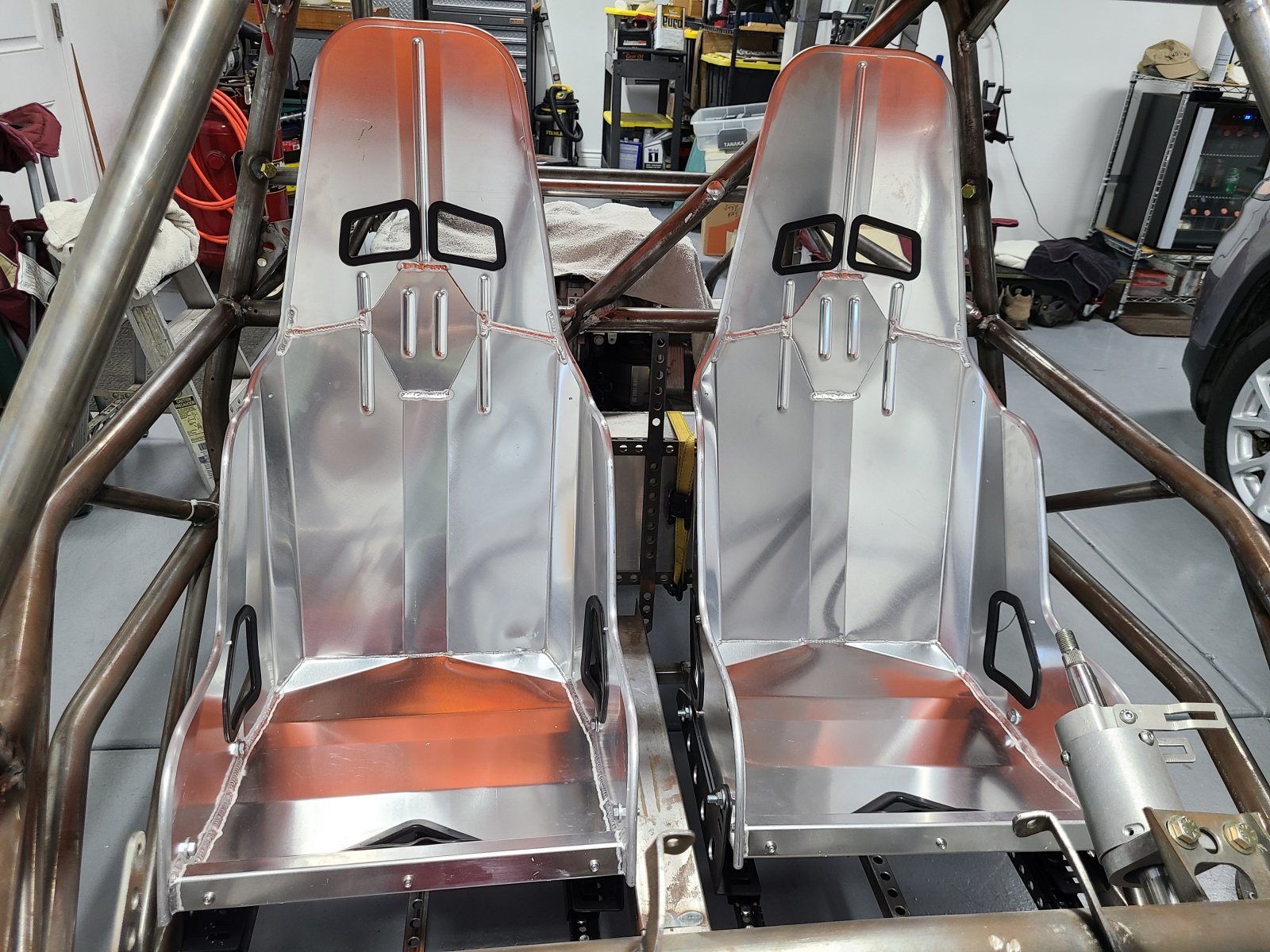

So progress on my build has slowed to a snail's crawl, but I finally got into the garage today. Got the 'generic' seat rails for my new aluminum seats modded to my liking - and dropped 1 1/4 lbs from the set with some trimming and speedholes!
Then got the driver's seat mocked up into position in the cockpit. The angle is good and they are a pretty snug fit in there, but they are sasquatch sized seats. Thinking I may want to raise them about 1-1 1/2 inches, they are really low - much lower than the cheap ebay seats I was originally planning to use.
