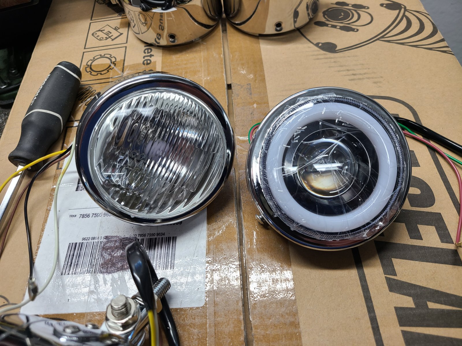

Did you purchase the ones on the left (standard lens) or the ones on the right (projection lens)?
The projector lens on the right makes a huge difference in the beam pattern and the amount of light on the road where its needed versus being scattered off to the sides. These are also cheap enough that different bulbs can be tried to find the best combination.

The bulbs in paired motorcycle buckets were the standard lens, and fit right into the Dominator buckets. I got that far when i discovered I could just replace the H4 insert instead. The chrome paired buckets had LED inserts, so I just swapped them out.

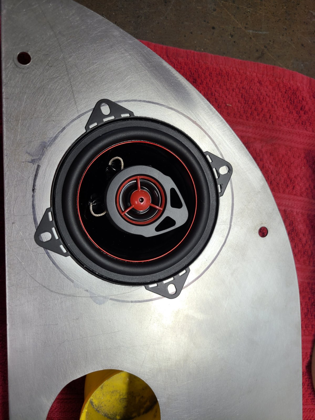

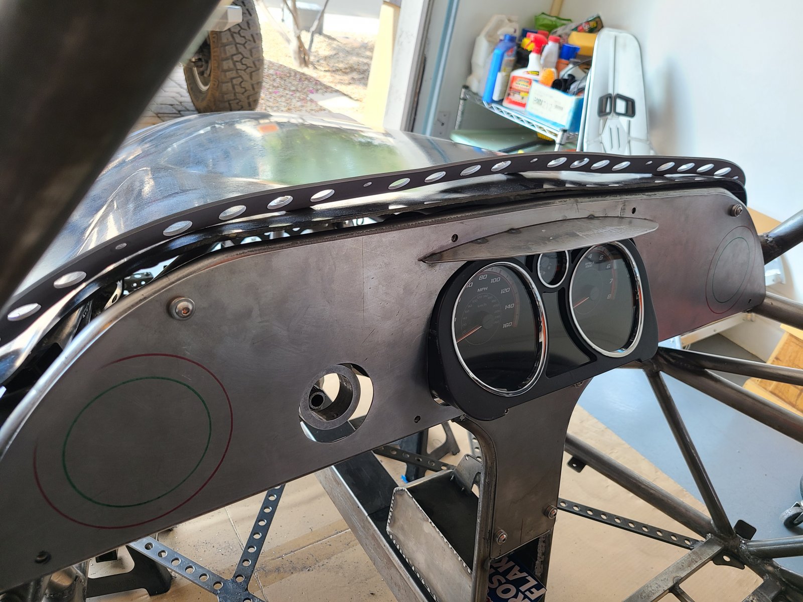

Been getting the dash further along with the Cobalt gauge panel, steering column, and speaker holes cut out. I also added an old school sunvisor above the gauge panel to provide some shade so it can be read when the sun is trying to shine on it.
Have more gauges (2 1/8 inch) to layout and get cut out. So yes, my dash is getting 'speedholes' in a manner of speaking. :p

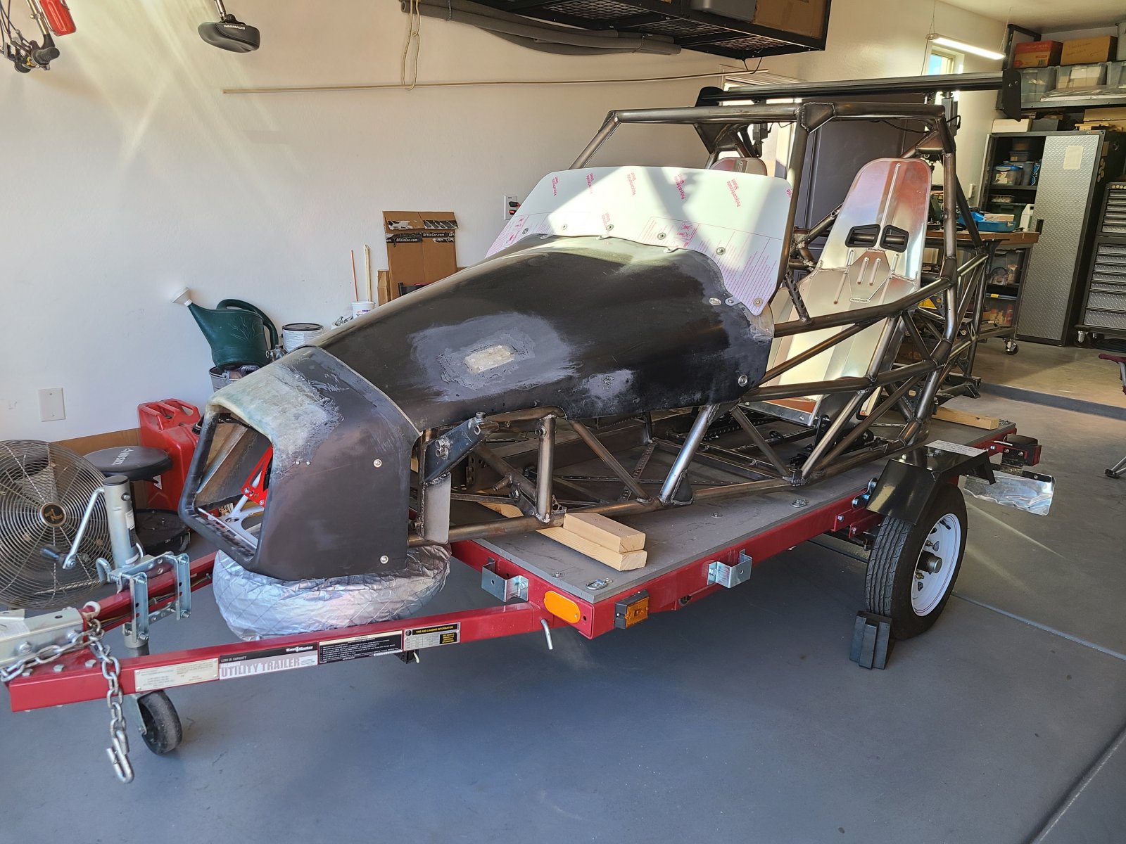

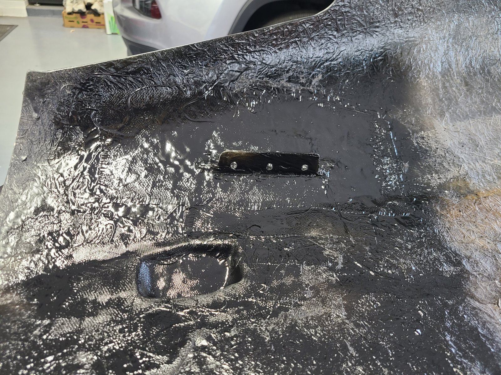

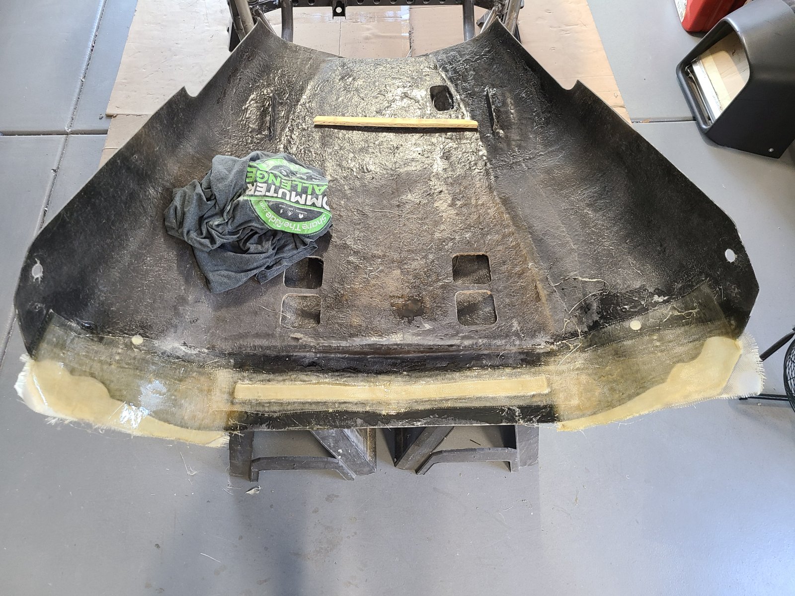

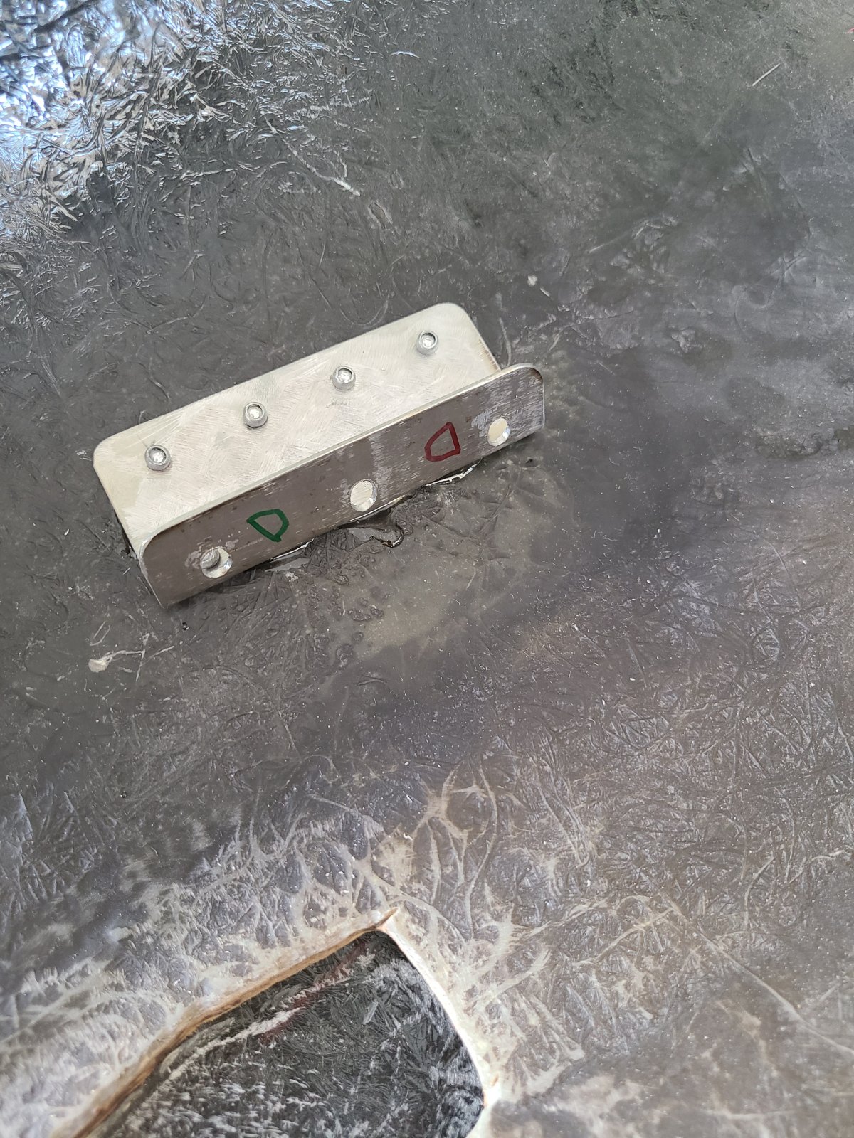

I've also been working on the hood to get the hood hinge mounting plates permanently installed and riveted/bonded to the underside.

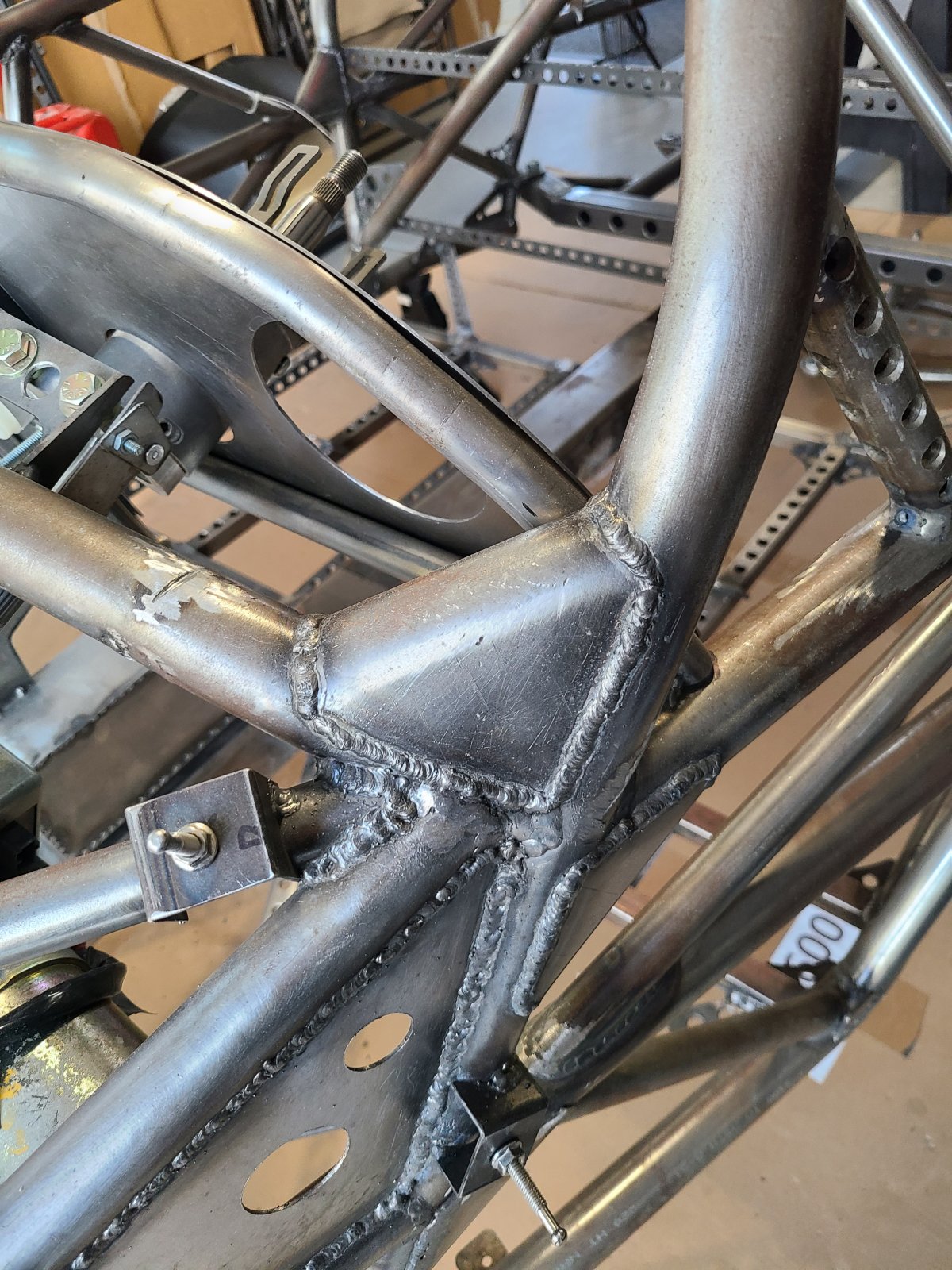

The hood back end corner cutouts from DF do not matchup very well with the A-pillar gussets I have welded in.

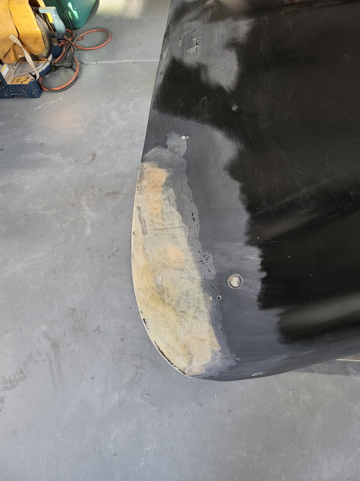

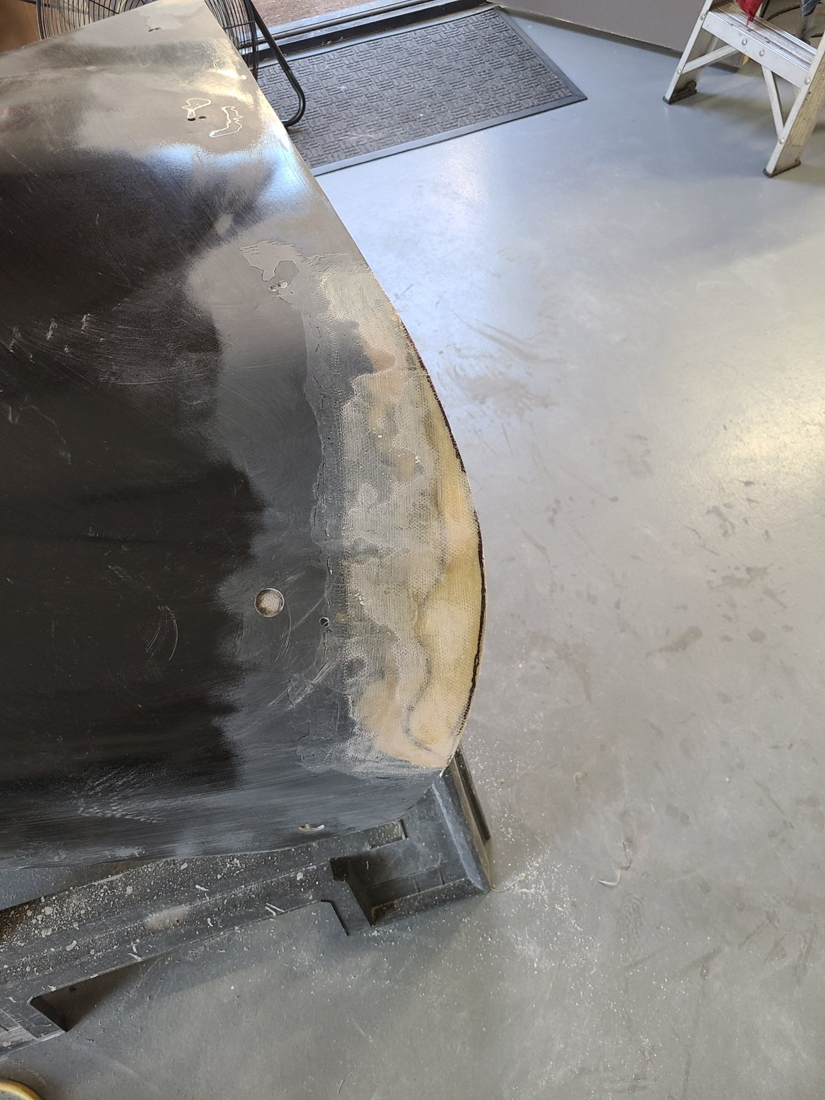

So some recontouring of these back corners is underway with fiberglass fill-in and new cutouts to match my modded frame.
It all takes time and has been slow going with the hot weather and only getting into the garage on weekends. When it finally cools off I will get much more accomplished. :D
Almost looks like my hood was made this way. ;)
Got the overall contour cut, just need to notch to go around the A-pillars and get the finish skim coat on it for final sanding.

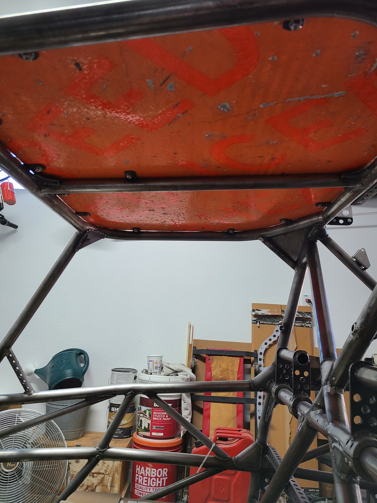

I appreciate your proposal, but I don't have the equipment to bend 1.5 inch tube (minimum recommended size tube for a cage). I wish I did. :rolleyes::D My bender is only capable up to 1 inch tube.
Give DF some time to get back to you - make sure you call them (I know you have been) - they will make the tubes that will fit correctly. You can also request a center bar(s) too, kinda like this:
Make sure @Lonny knows this is an add on cage, it should include sleeve tubes that must be installed at the A-pillar to make this connection strong enough (butt welding tubes together won't be).
