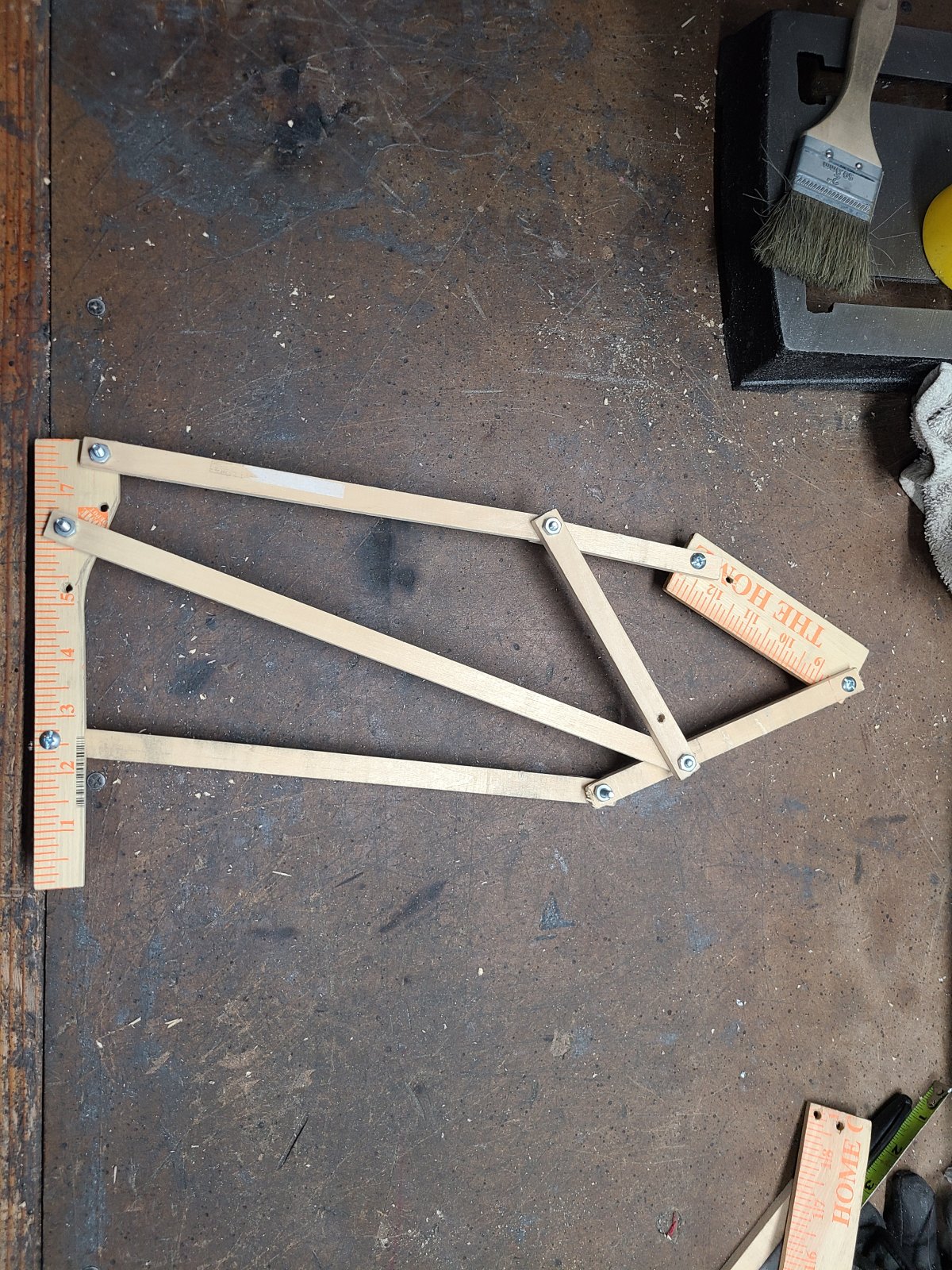

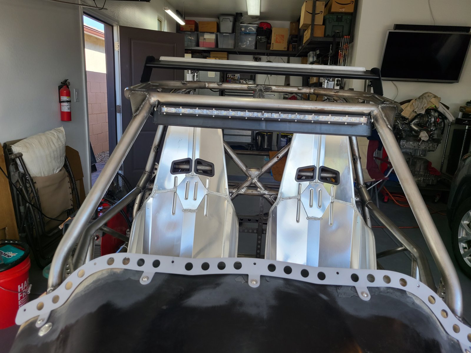

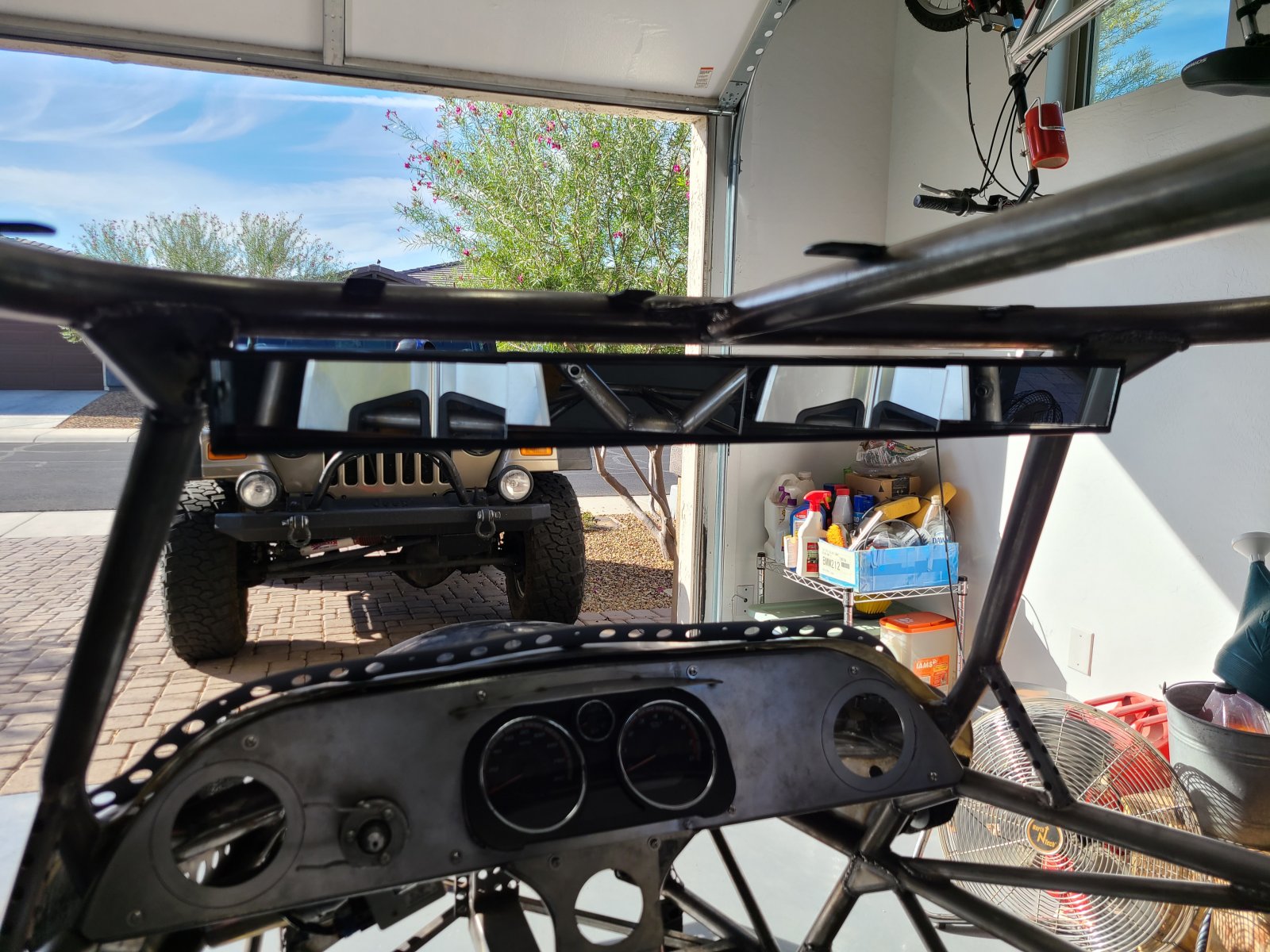

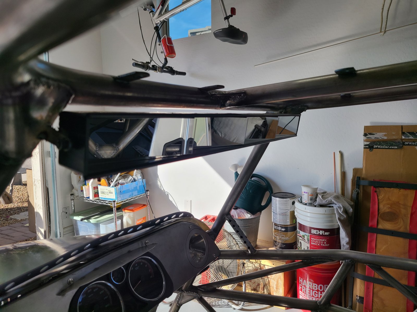

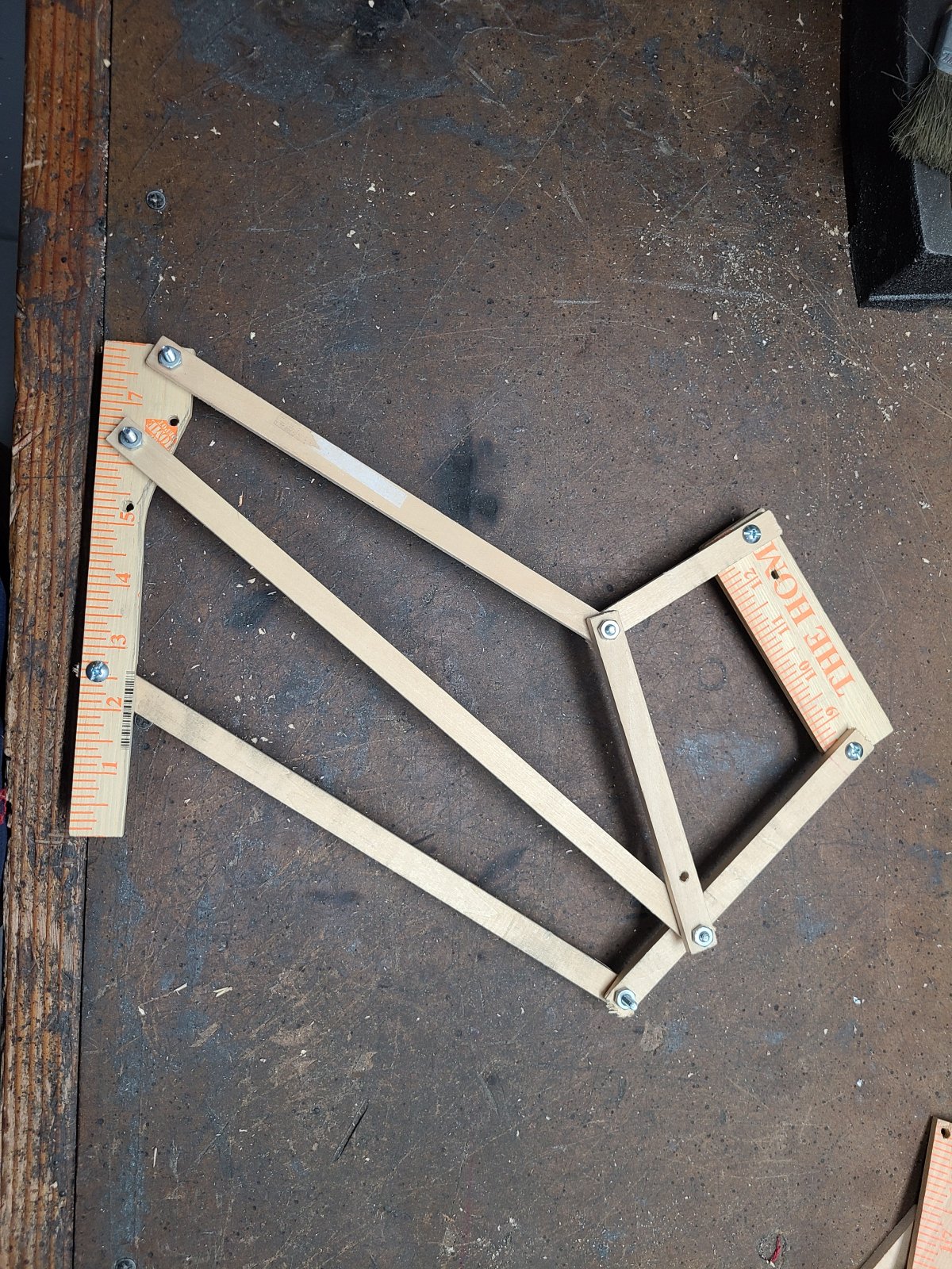

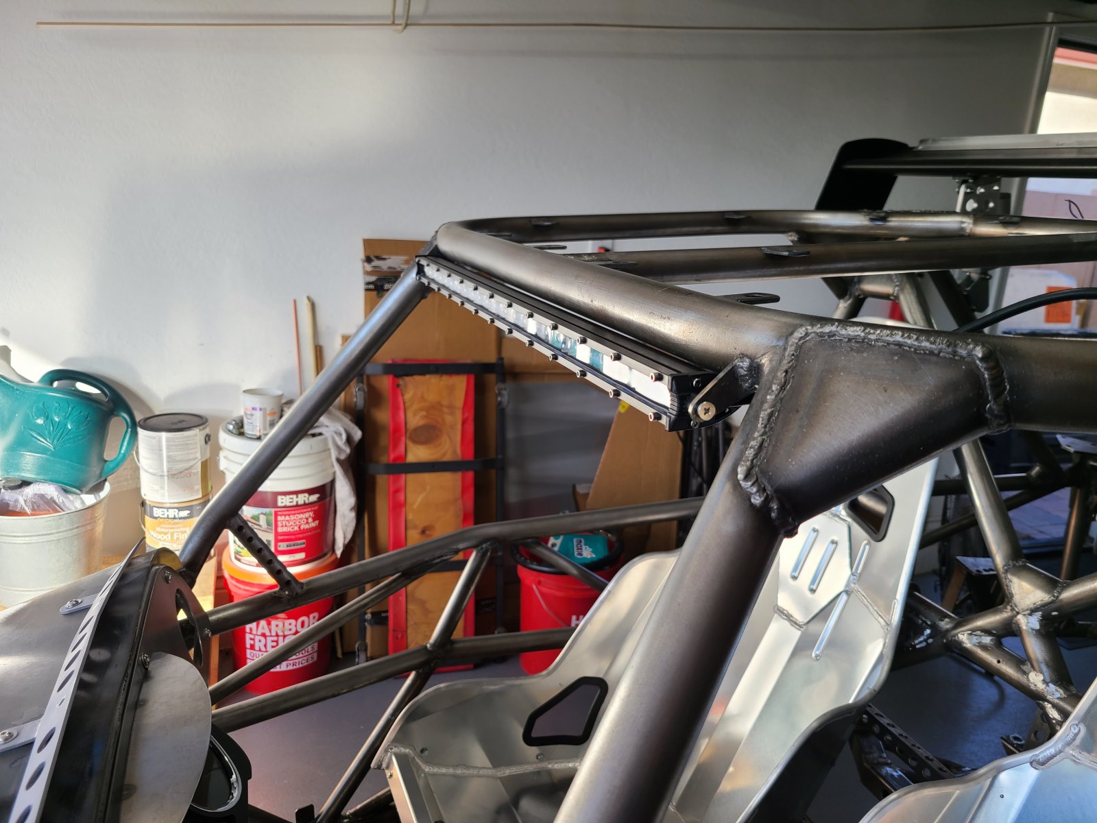

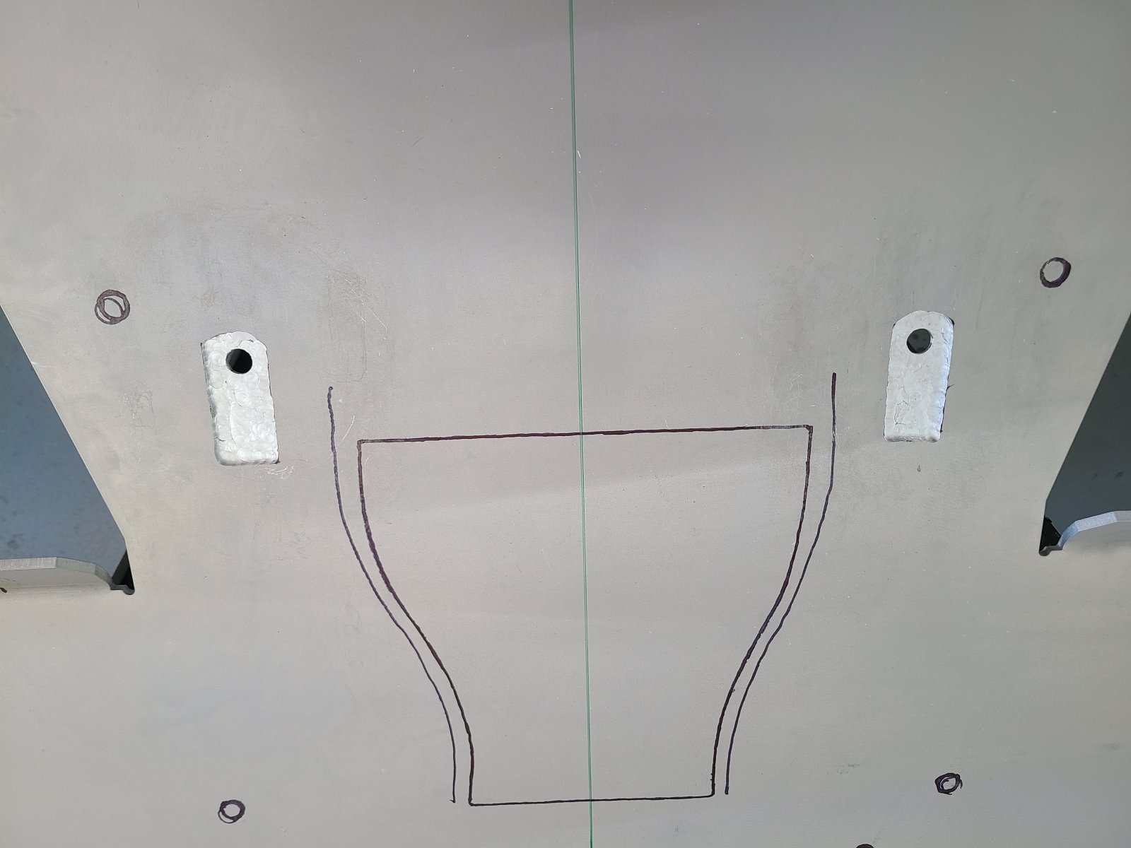

I sure like that yard stick/paint stick aided design! Good stuff!Update: Been doing a bunch of small items to get brackets installed for some nice accessories that I want in my build. Wanted a bright FU light for those night time excursions that will project light from the LH ditch to the RH ditch.
I don't want to end up with my pretty 'grill' all messed up.
I don't want to repeat what @Ark :D did to his Bronco not seeing deer or other night critters before its too late.
I also wanted a 4 panel (wink) mirror to provide the best view of all those Mustangs, Hondas, and Miatas behind me.

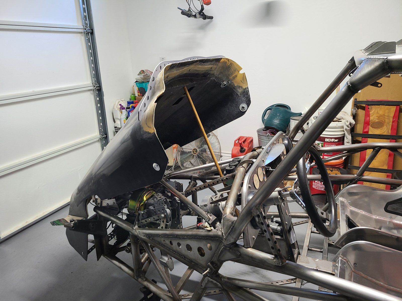

Next I didn't like the way my fabbed up hinges turned out, not enough lift/height to clear the nose as I thought I was getting. Only getting 1/2 the lift on the hood I am looking for.
Soooo, back to the drawing board and working on the design of a higher lift double hinge that is about 3-4 inches taller before it kicks the hood forward for underhood clearance I'm looking for.
View attachment 50277View attachment 50278
Will take some more refinement before committing to making them in aluminum to replace the existing.

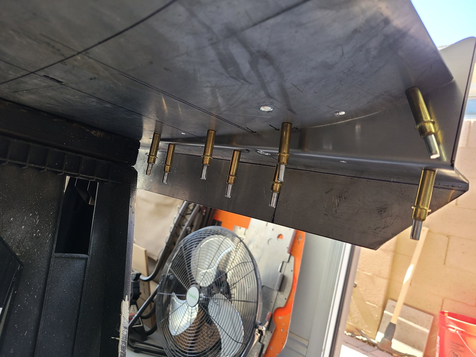

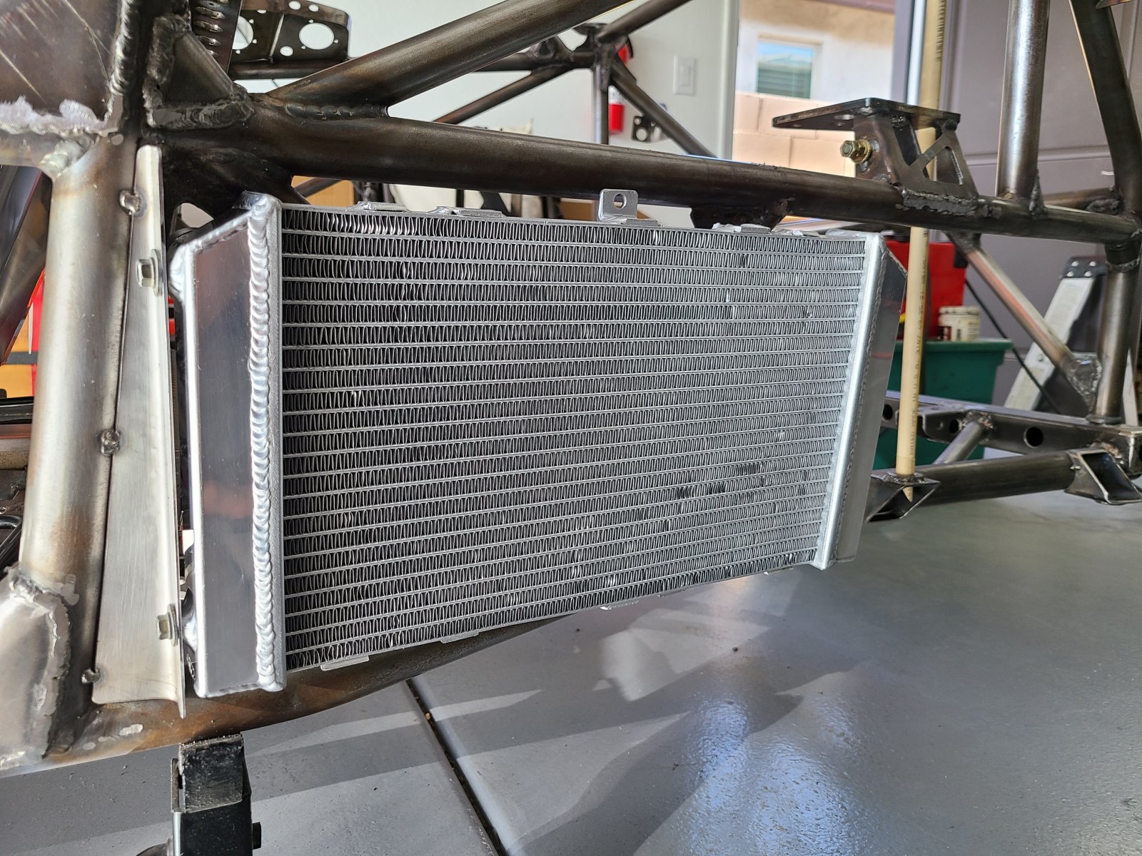

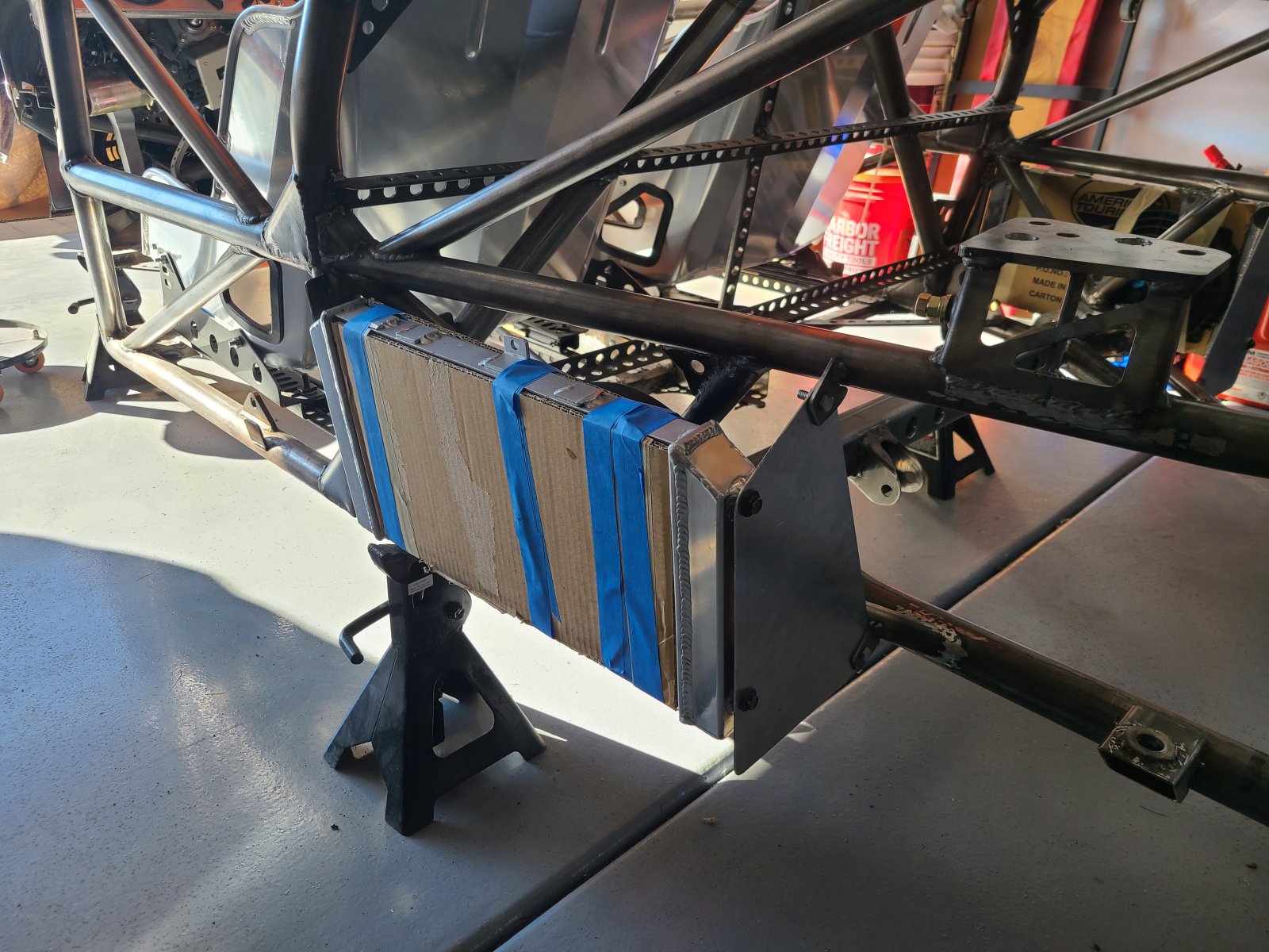

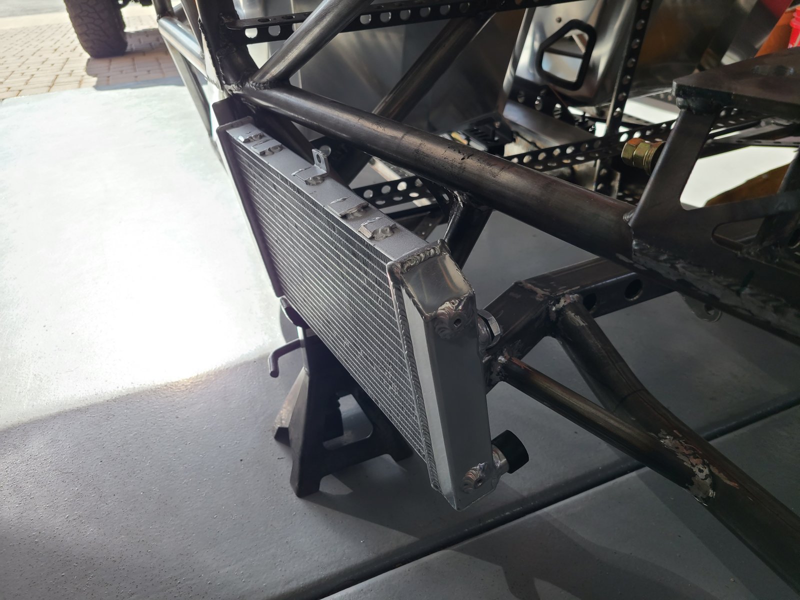

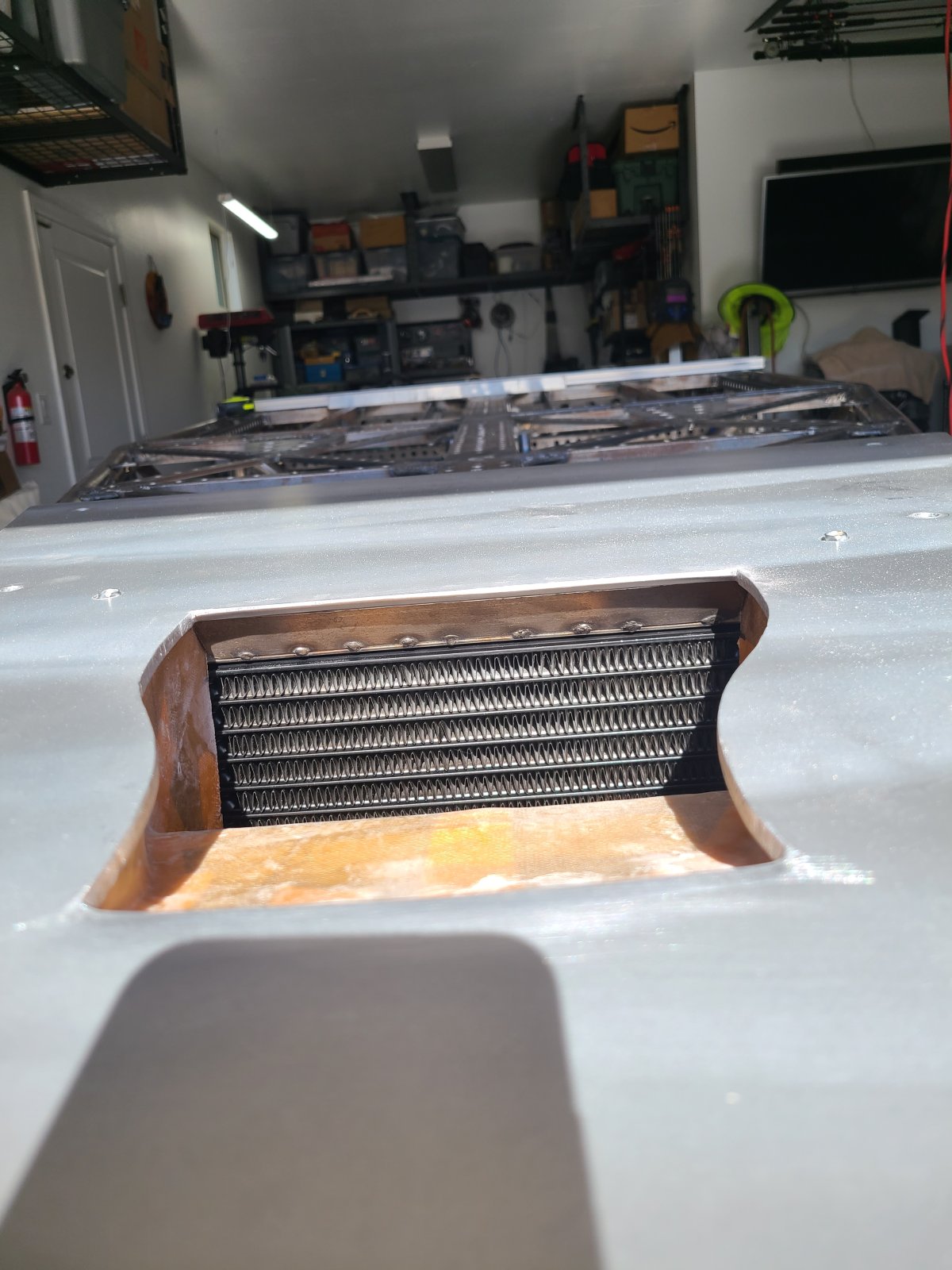

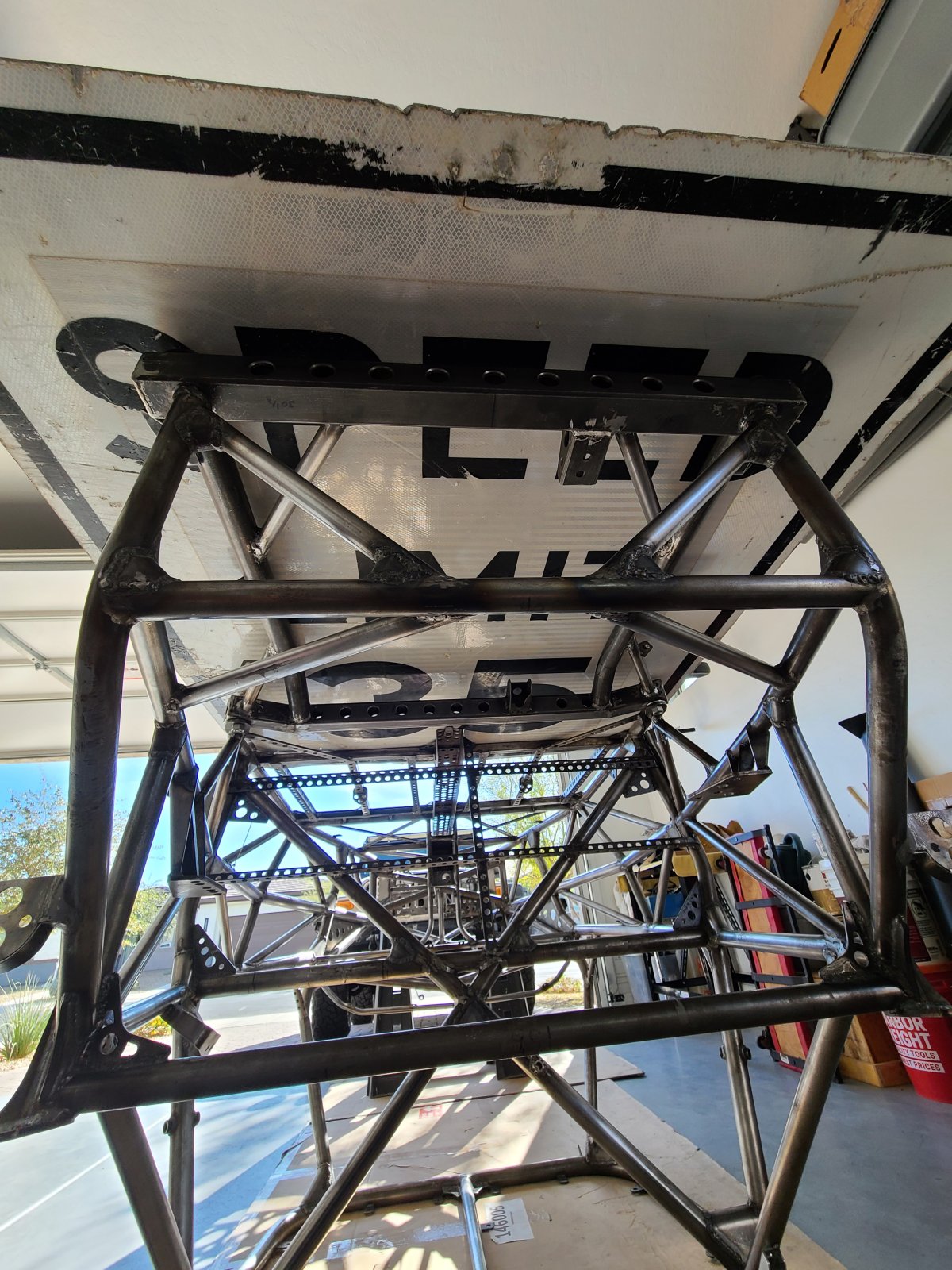

Also working on the intercooler heat exchangers mountings. These are the KZ750(?) radiators that I purchased quite a while ago andhave been kicking around ideas of how to mount them to my esthetics. I decided horizontal mounting on the sides next to the fuel tank. Each one has an 8 inch fan and will have air scoops for adequate airflow.
View attachment 50279View attachment 50280
More to come.
