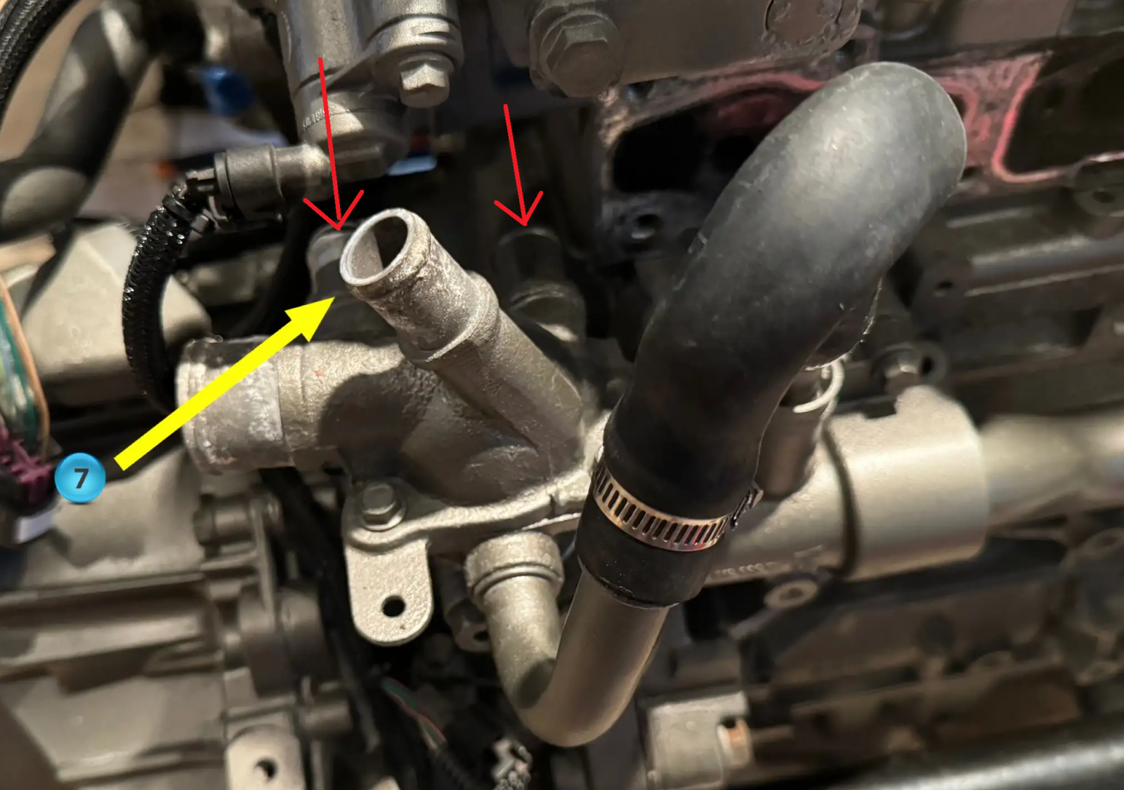

If you're running an F35 trans and a stock LSJ thermostat housing, the oil cooler (5 and 6) should have matching coolant inlet and outlet barbs facing forwards on the thermostat housing. I don't think you captured them in any of your pics. Stock LSJ hoses make these connections a breeze, easier than any other Ecotec oil cooler plumbing.
7 goes straight to 8.
Forwards and reverse flow lines don't matter in the lines in the tunnel.

#7 goes to #8
Intercooler plumbing is here.
The oil heat exchanger (#5 & #6) goes to the back of the thermostat (red arrows)

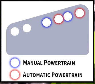

I used Cobalt Seat Bolts on passenger side, can someone remind me what two bolts to use with the spacers on transmission side?
Jareth

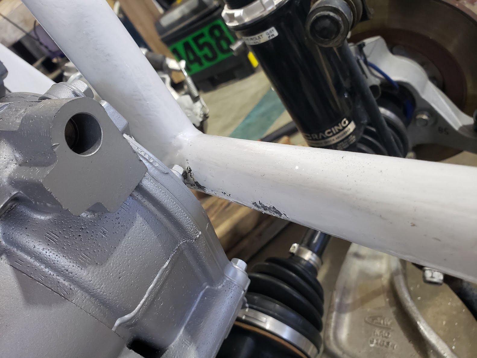

Will this be some sort of an issue, I hear what the video says but if I put mine in the first hole this small bolt interferes with the frame.
That bolt has plenty of clearance on my frame. It never attacked the fresh white paint. (Sic)
I used the correct bolt holes for the LSJ side mount, but yes, it attacks the frame. After I tighten all the subframe and engine mounting bolts, there should be about 2mm of space. At least I can touch up the paint. I should have put a protective tin can over the frame.
Loosen all the engine mounting bolts, lift up the engine a bit, and then try the correct mounting holes for the engine.
