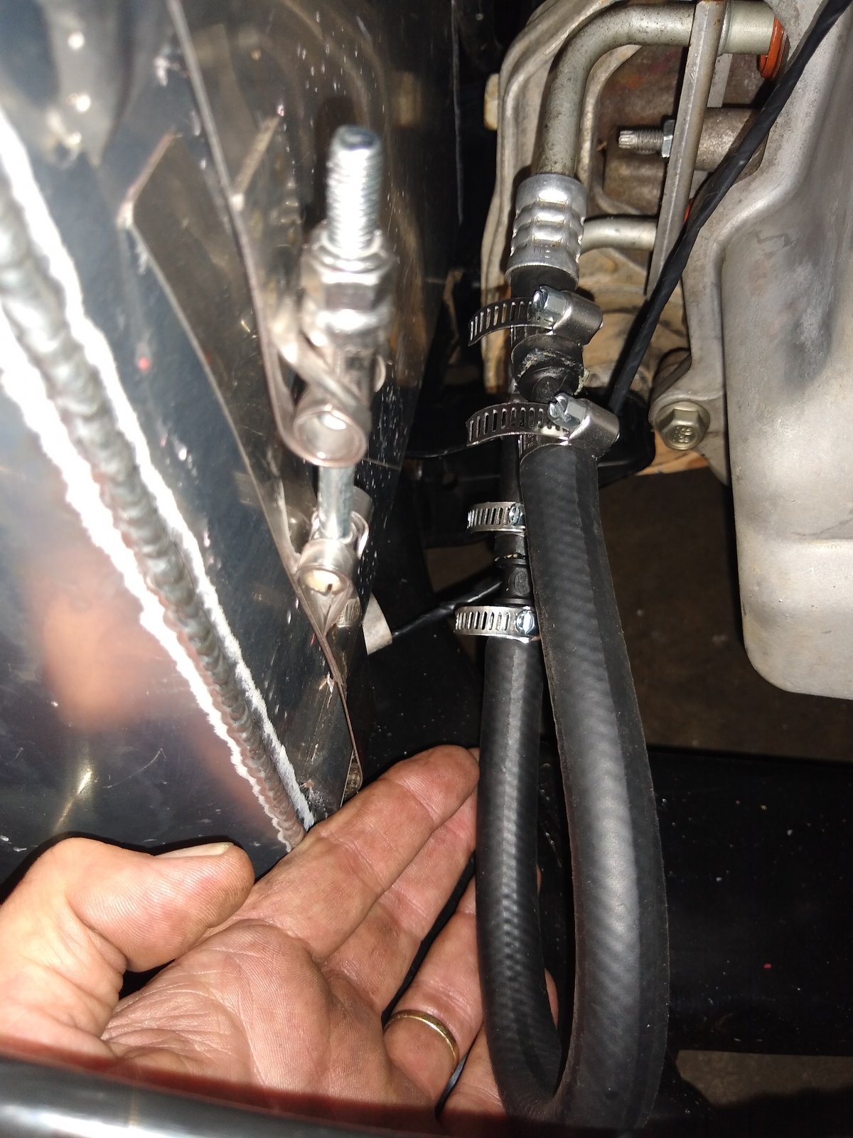

I went to my local junk yard and got the connectors for the transmission coolant lines and paid $2 (!) for it. I did fabricate a loop,and when I cranked the engine there were NO leaks! I topped off the trans fluid (first), and now I will be chasing down why the engine doesn't start - another thread in another place. Thanks, y'all, for the advice.
