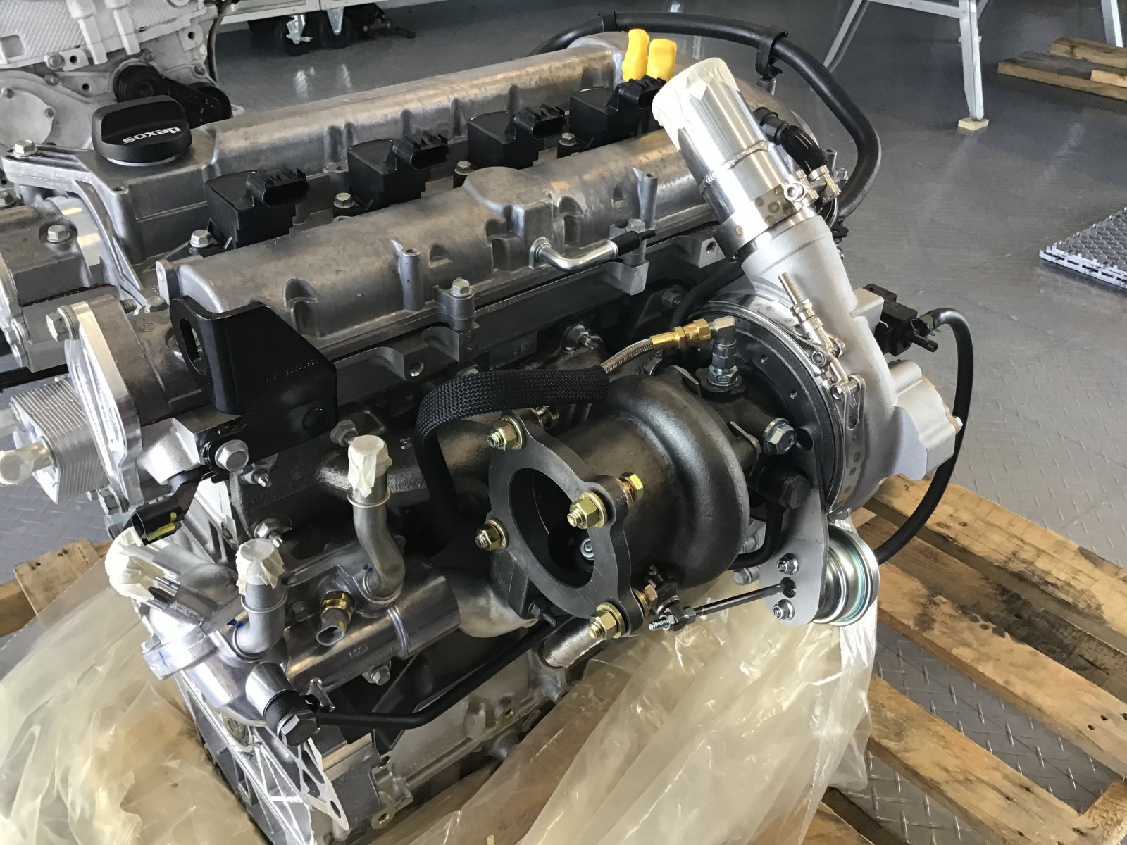

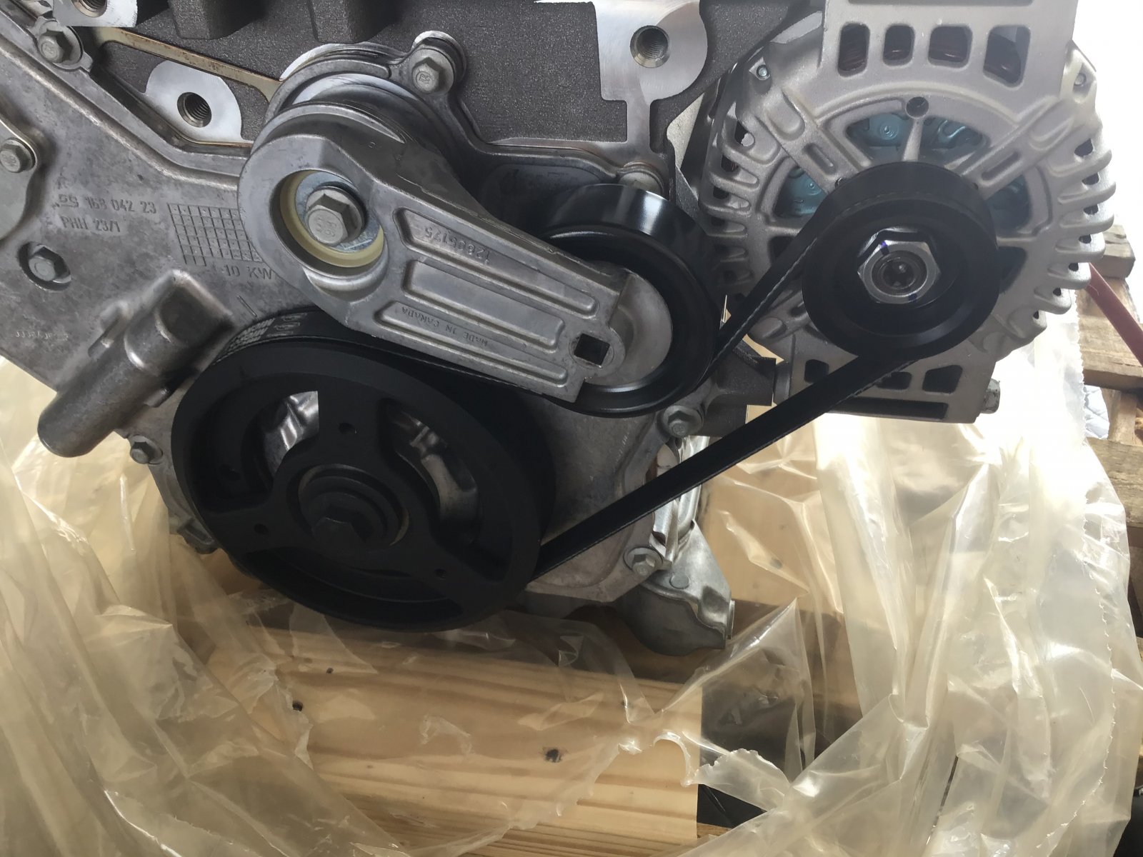

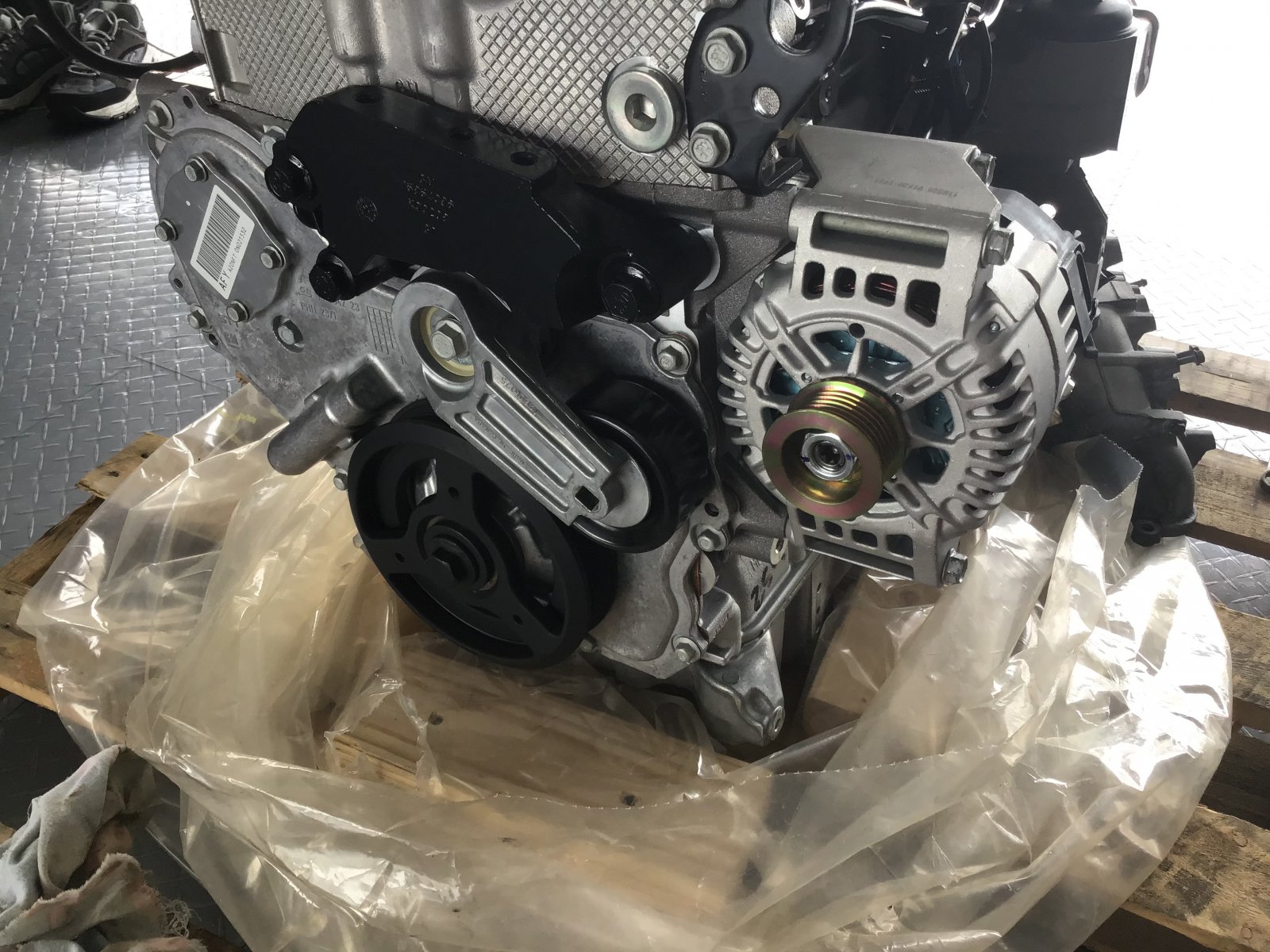

Has any body bought the ZZ PERFORMANCE crate engine LDF and it come with 6 rib harmonic balancer so I need to buy a 6 rib pulley for my alternator, If anyone has bought one already, Can you tell me where you bought yours from and what size. Would be greatly appreciated.

I double checked mine and it is also a 6 rib. I just bought a brand new alternator which is factory at 5 rib. I'm not sure it matters as I see that the ATI harmonic balancer are 8 rib. So unless everyone that uses one of those is changing at minimum idler pully and alternator, and for some cars also AC and SC pulley what are they doing?

My Harmonic
Balancer is 6 rib and the idler pulley is fatter as well for a 6 rib belt, just need to get alternator 6 rib pulley, or just run it with

I bought the belt Lonny suggested for the 5 rib, but with this being 6 and a bigger idler, does your belt seem to tight

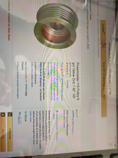

Okay I found one on amazon a lot cheaper than jegs for 13.77 will just have to paint it black. Now the fan belt I measured from one mark all the way around and it’s 35 that’s what the wrapper stated also. So I figured 36 would do it but the one I pull up on amazon looks way to long

Do you see what I see, Exact fit
6 Rib Alternator Pulley,
Will powder coat BLACK
