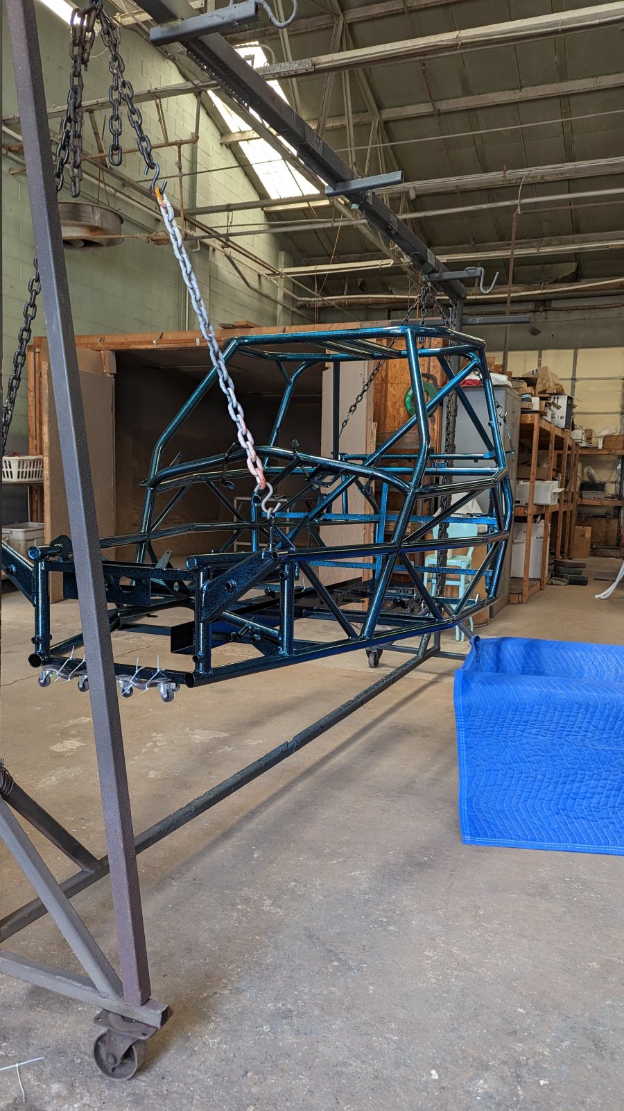

Something terrible happening to my foot. Doc says it's just inflammation. Had to call out on my 3rd day of my new job. Hope I don't get fired.

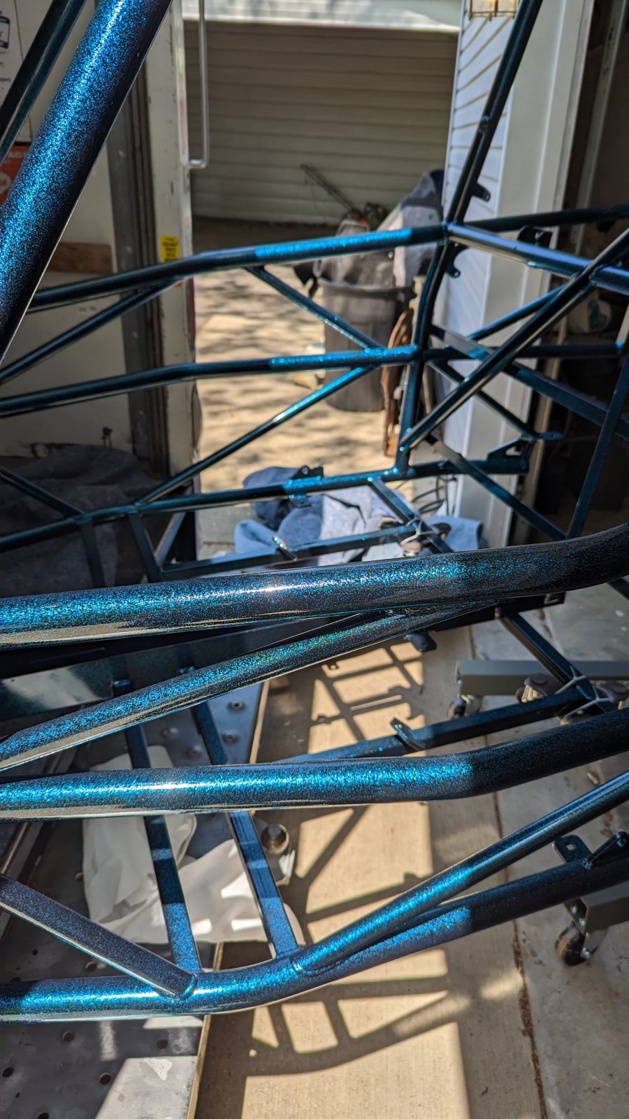

Anyway, frame is back.

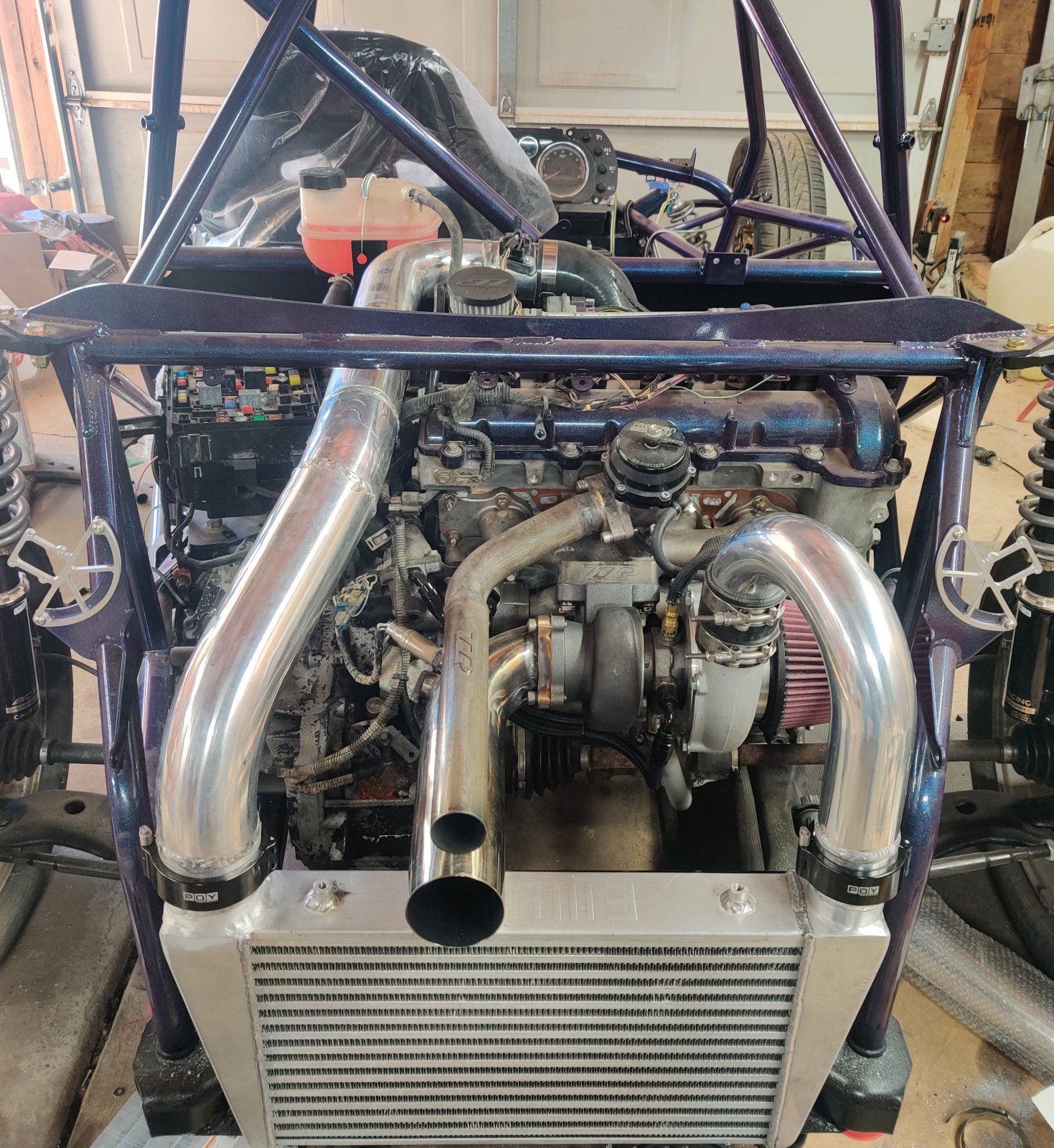

Having almost the exact same donor I can tell you it's a riot, I added a chinaboi and on 11psi it is violently fast, mine was a 2010 XFE base 5speed car

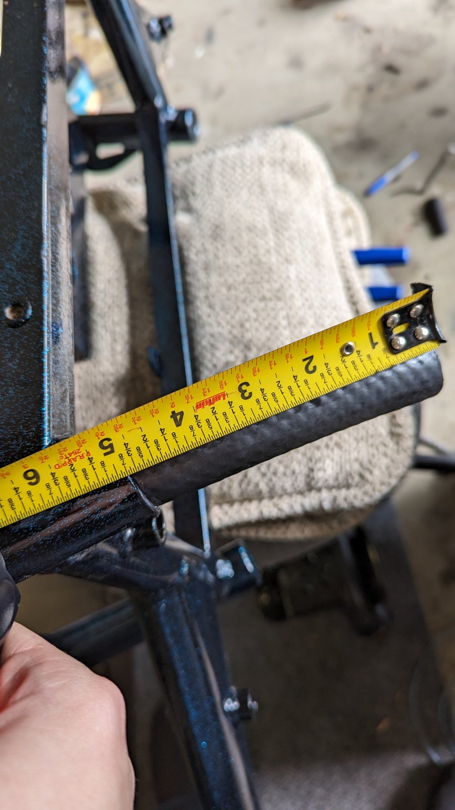

If I remember correctly the 4 inches on each end was overkill and I needed to trim them back a little more anyway so you should be good.

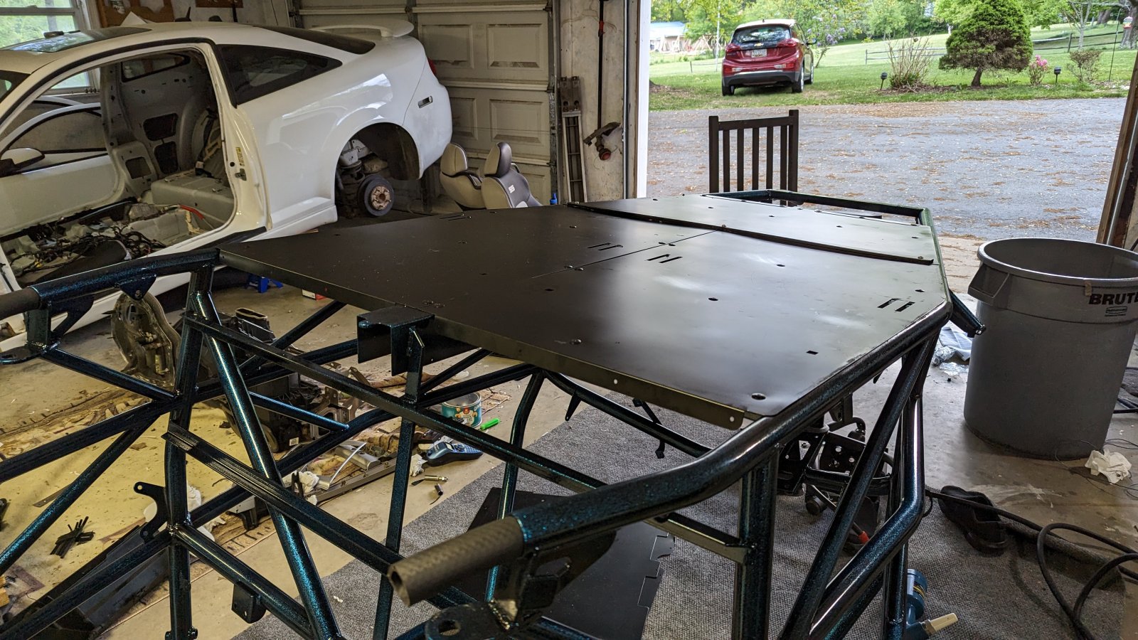

Another question, I forget to use poly adhesive on part of the floor pans..
Does df supply enough rivits to redo mistakes? Is it worth the trouble?

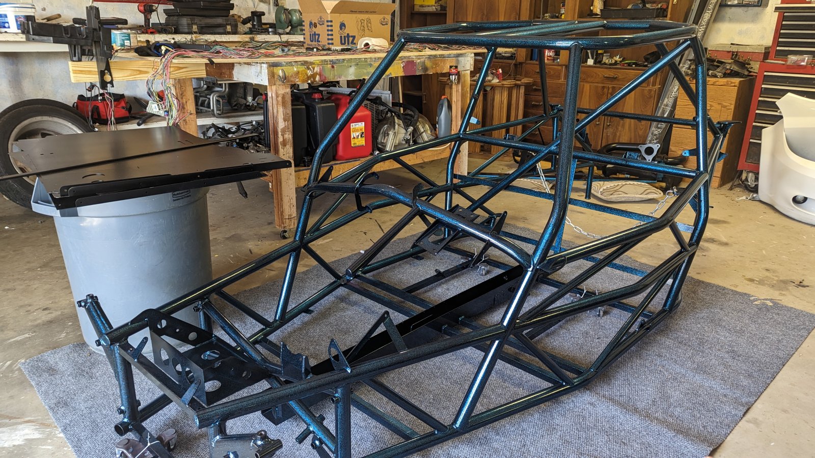

Also progress

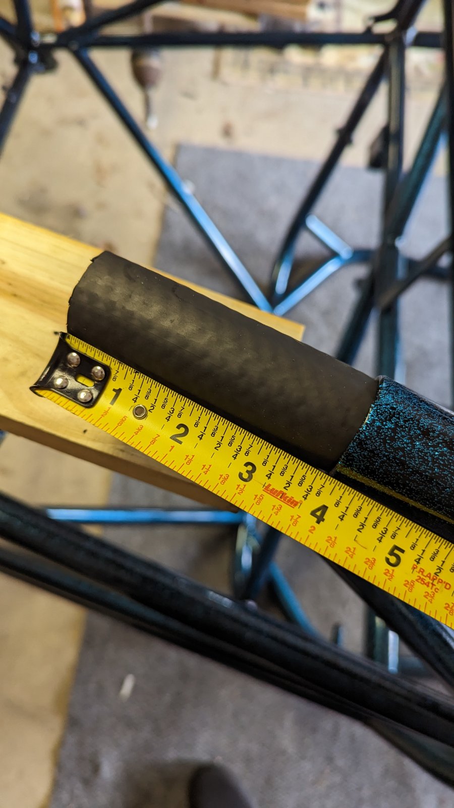

My hoses in the frame shrunk back after I drove it a few miles. Guess that it makes sense, since I pulled the snot out of them when installing them.
