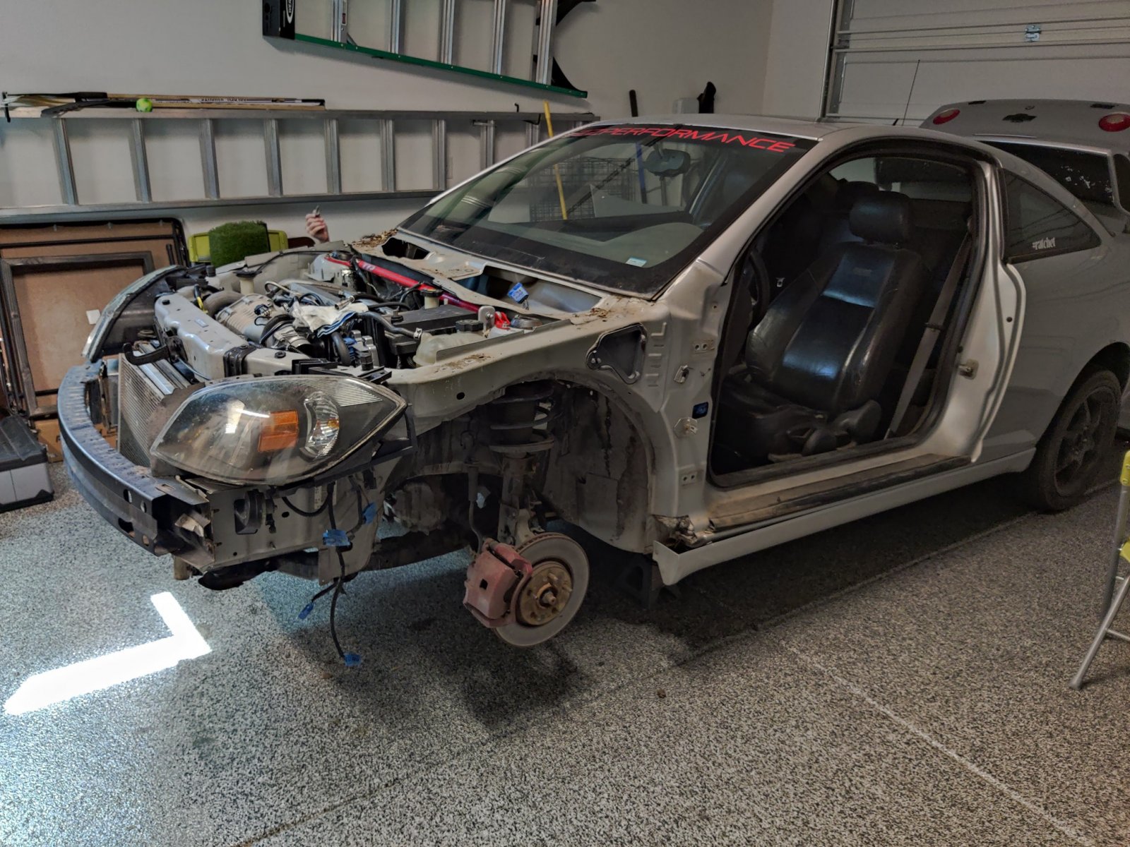

May 2021 -We bought a donor-
2007 Cobalt SS w/ 140k $2800

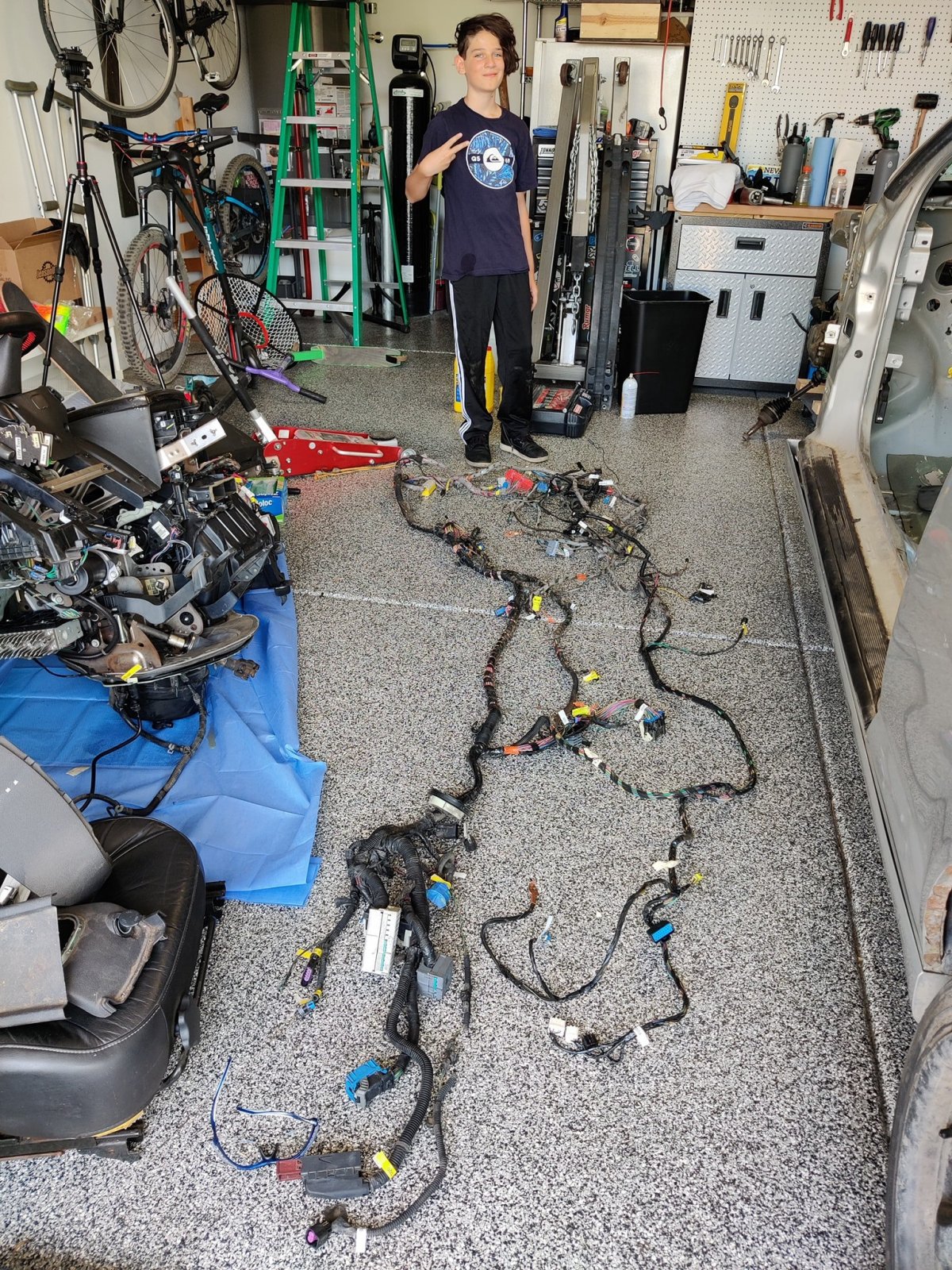

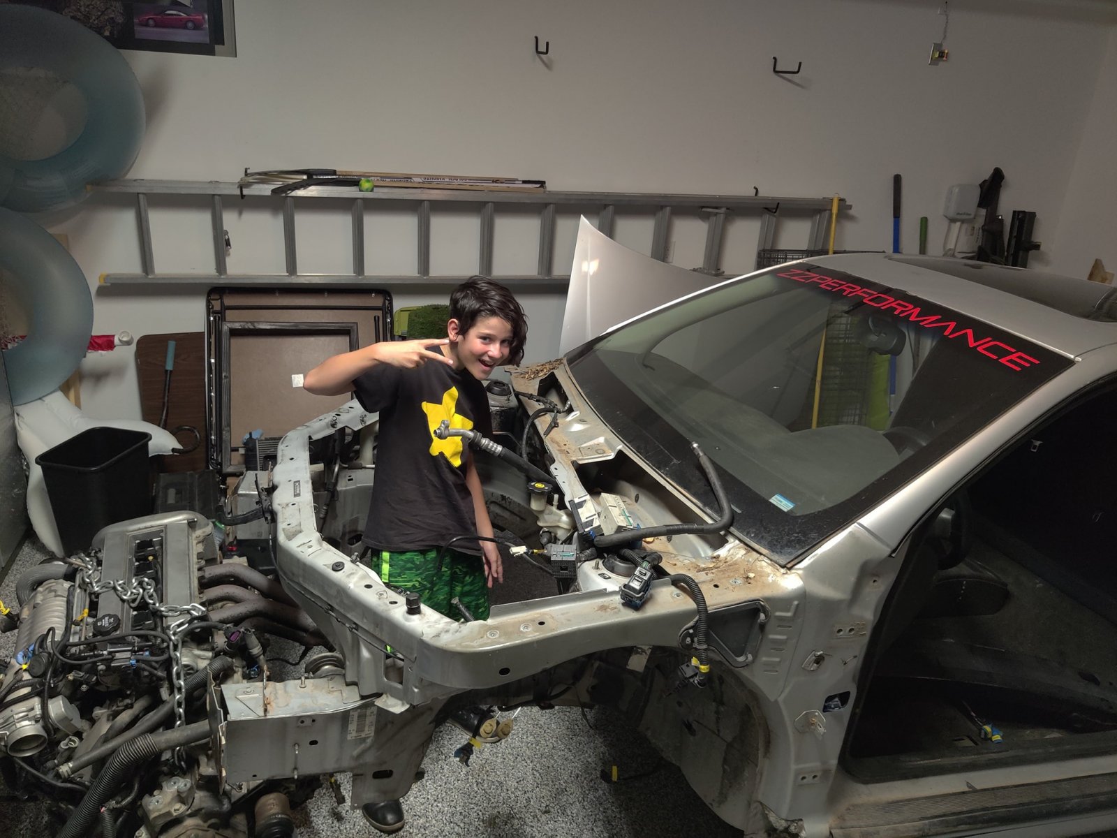

Car ran great, and we actually drove it from Provo, UT down to Las Vegas, NV and started tearing it down shortly after. Tear down went fairly smooth.

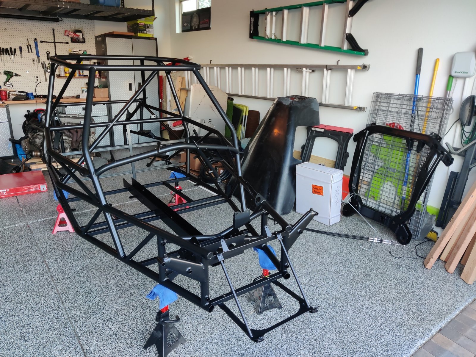

Took me a little bit to figure out the powder coating situation, ended up getting hooked up with a family friend that works for a iron fencing company and they blasted the goblin and parts I wanted in a nice satin black for FREE! Can't beat that. While waiting for the goblin to arrive, I sold off a bunch of parts to locals, the aftermarket bits went quick, and managed to sell the hood, and some other stock parts to recover about$1800 in total.

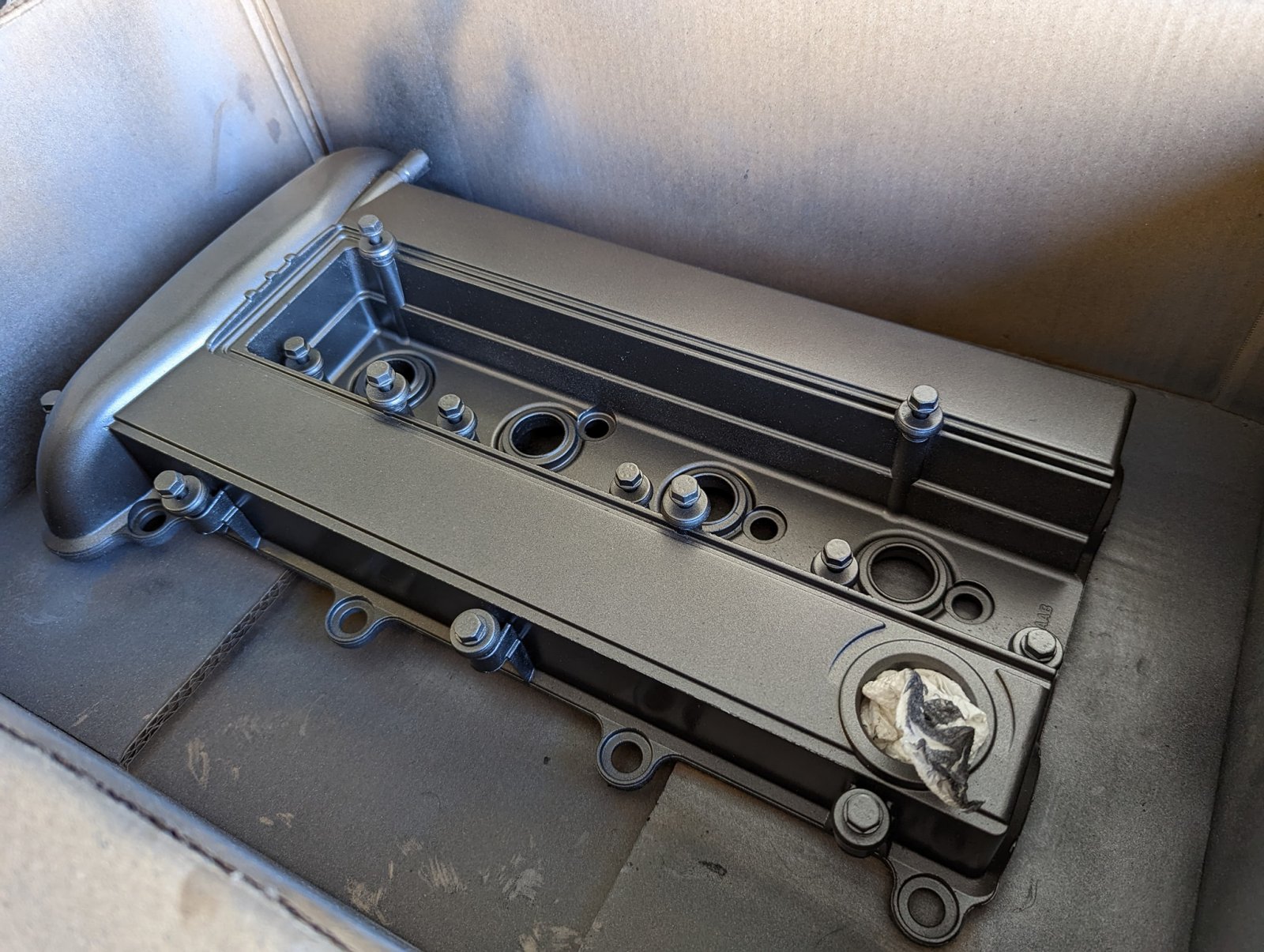

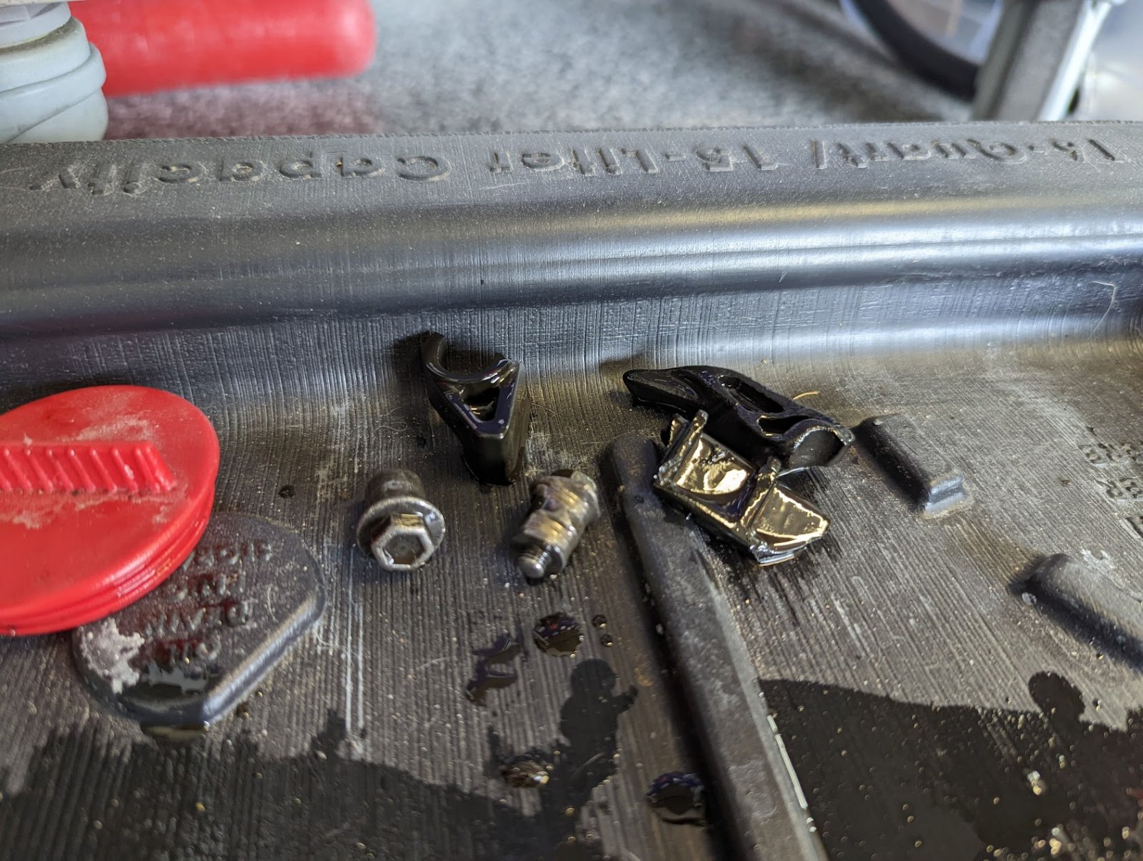

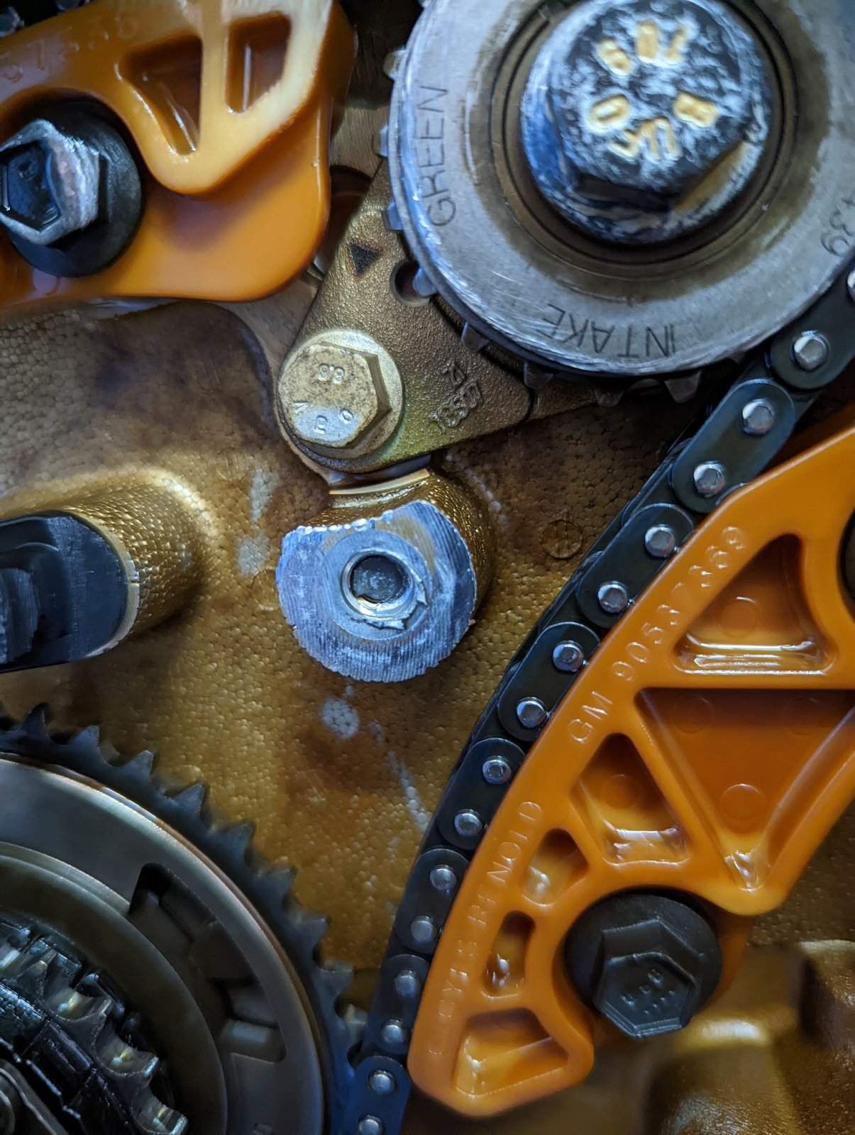

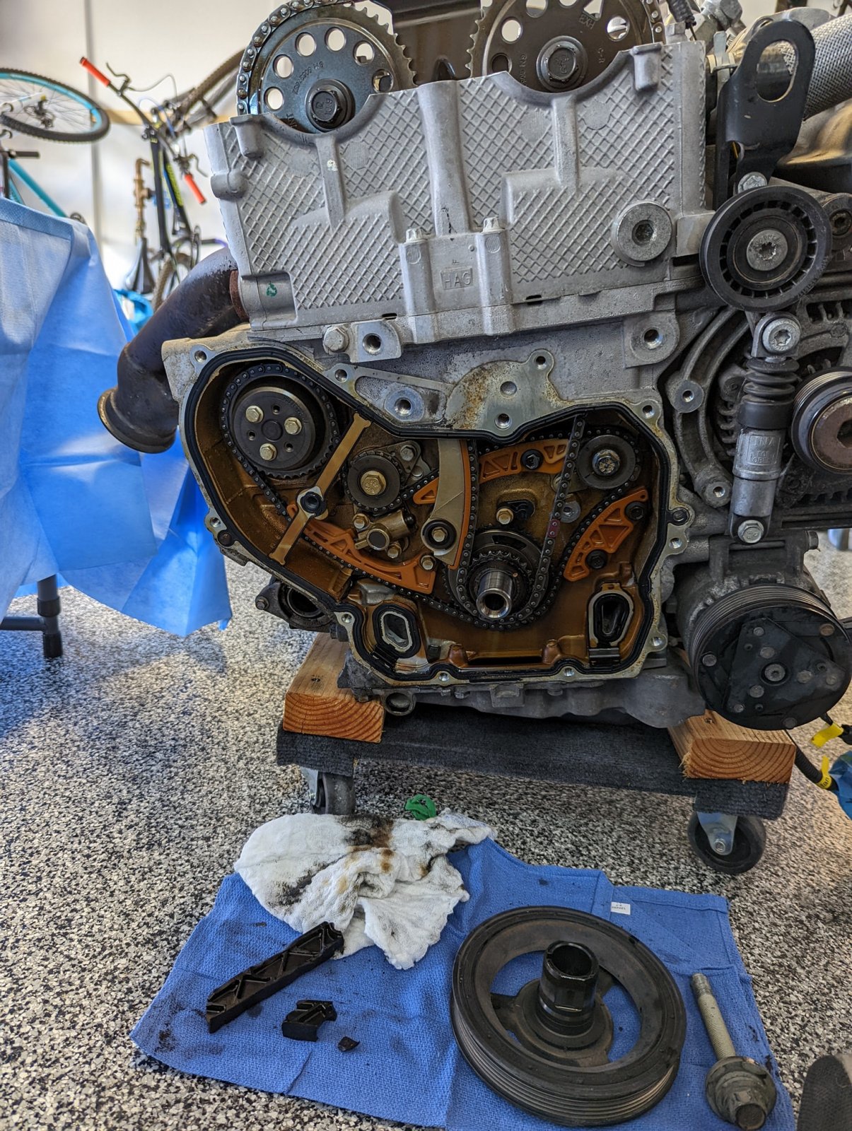

I was debating whether or not to open up the engine and just do a timing chain change, I'm not super savvy as a mechanic and the idea of it was a bit daunting. I decided to go ahead and do it though, and boy am I glad I did. Found one of the timing chain guides was broken into multiple pieces, bolt head was sheared off and no where in sight. Great. Was able to tap out the sheared off bolt, and changed out the water pump for a new one, as well as the whole timing chain kit. Painted the headcover as well, because why not. After mounting the engine to the goblin, I dropped the oil pan and found several more bits of bolt heads, metal, and timing chain guide.

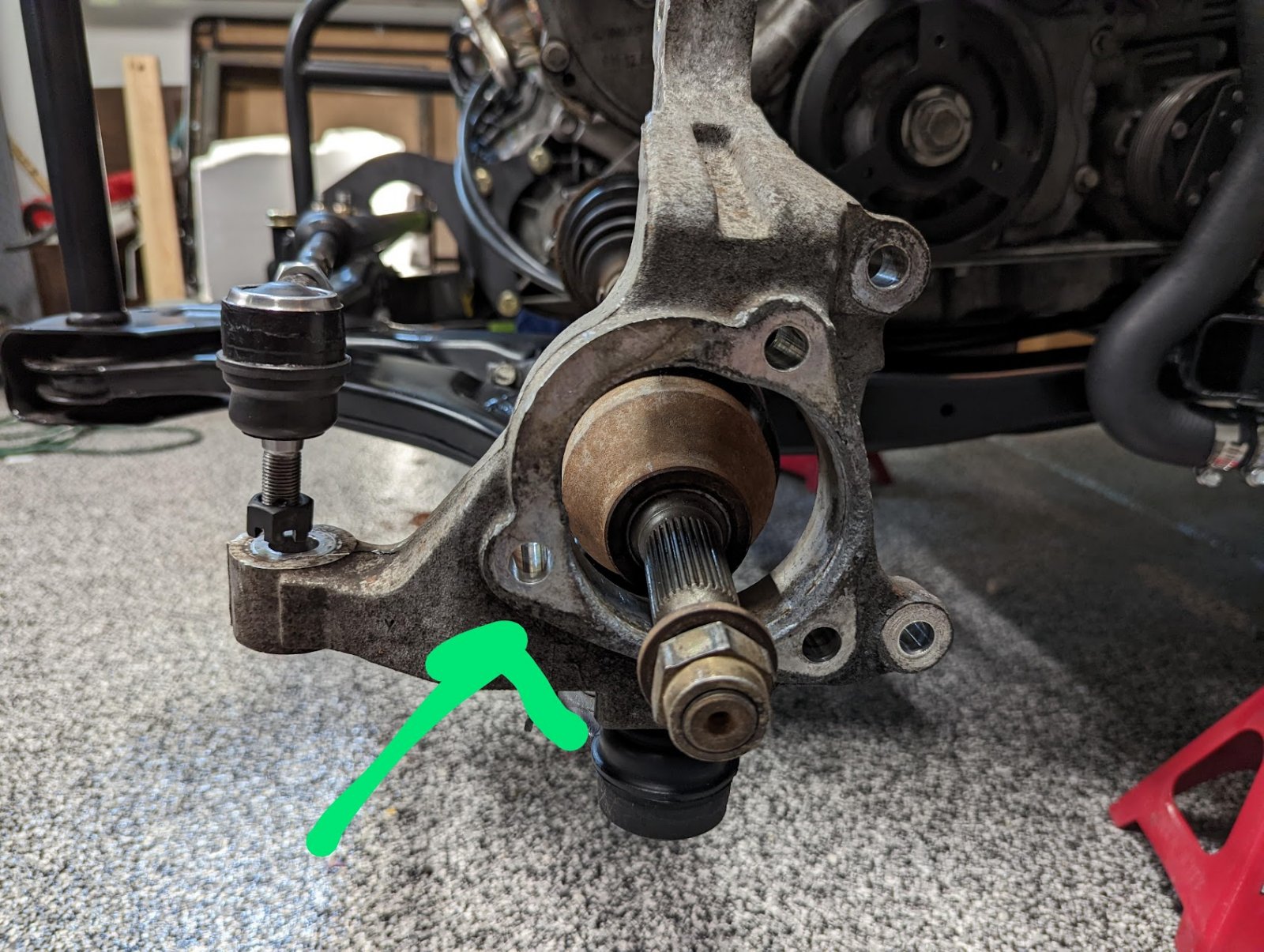

Does anyone know the part number for the 3 bolts used in the steering knuckles? My box of misc hardware doesn't seem to have anything the resembles what is needed.

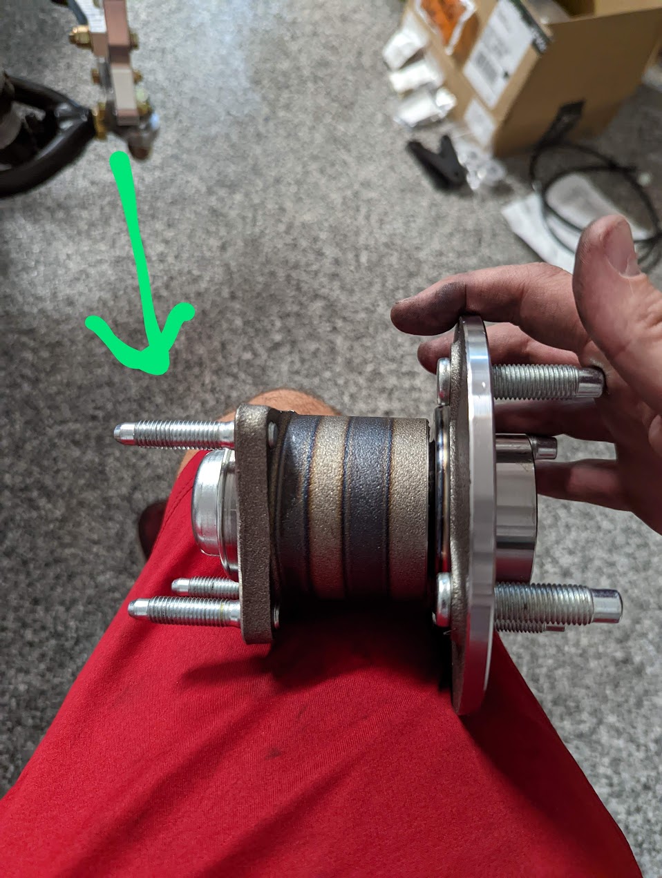

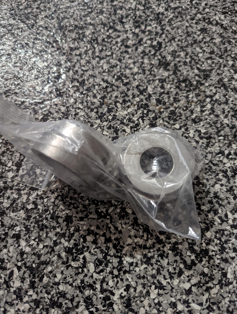

These are some new 4x100 rear hubs. What size and type of nuts do I need to use for these to bolt up to the adapter plate on the front suspension? I have used some class 10 m10x1.50 nuts, but they stripped the bolt and ruined two of the bolts pointed in the picture. Don't know if at this point I should just buy another hub or figure out if they sell those replacement double sided bolts somewhere?

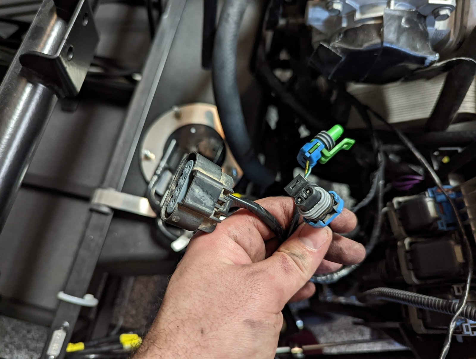

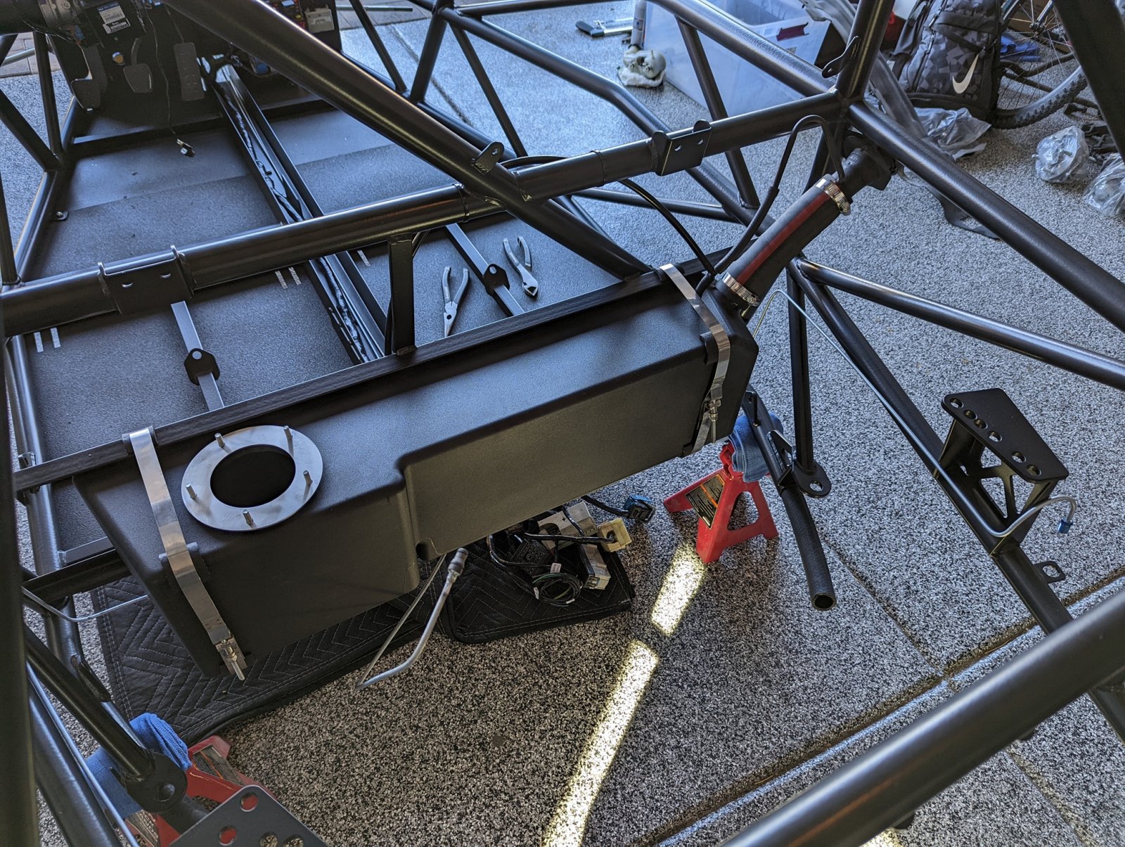

I know the big plug goes to the fuel pump, and the small grey one goes to the coolant overflow tank, but does anyone know where the green plug goes?

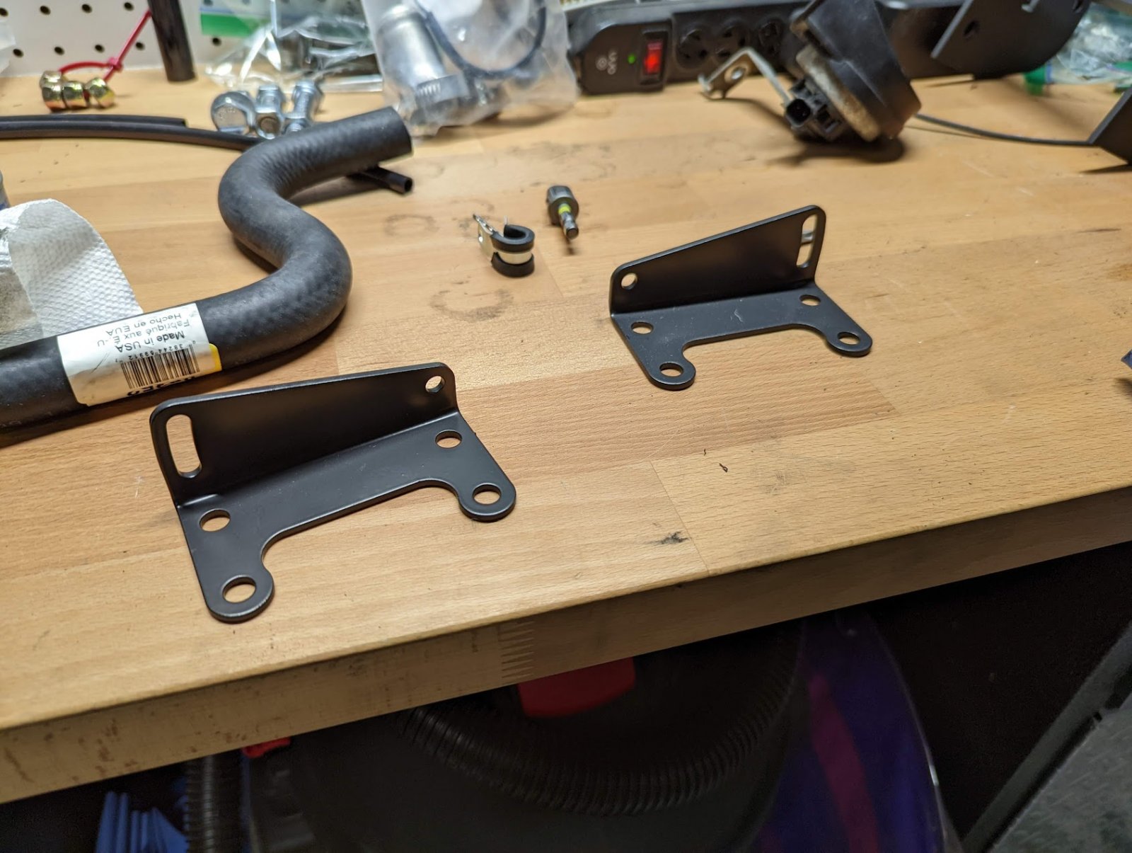

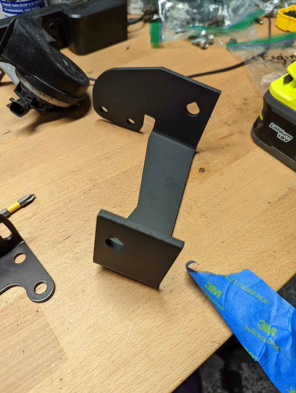

Not sure where these brackets go?
34496
or this one?

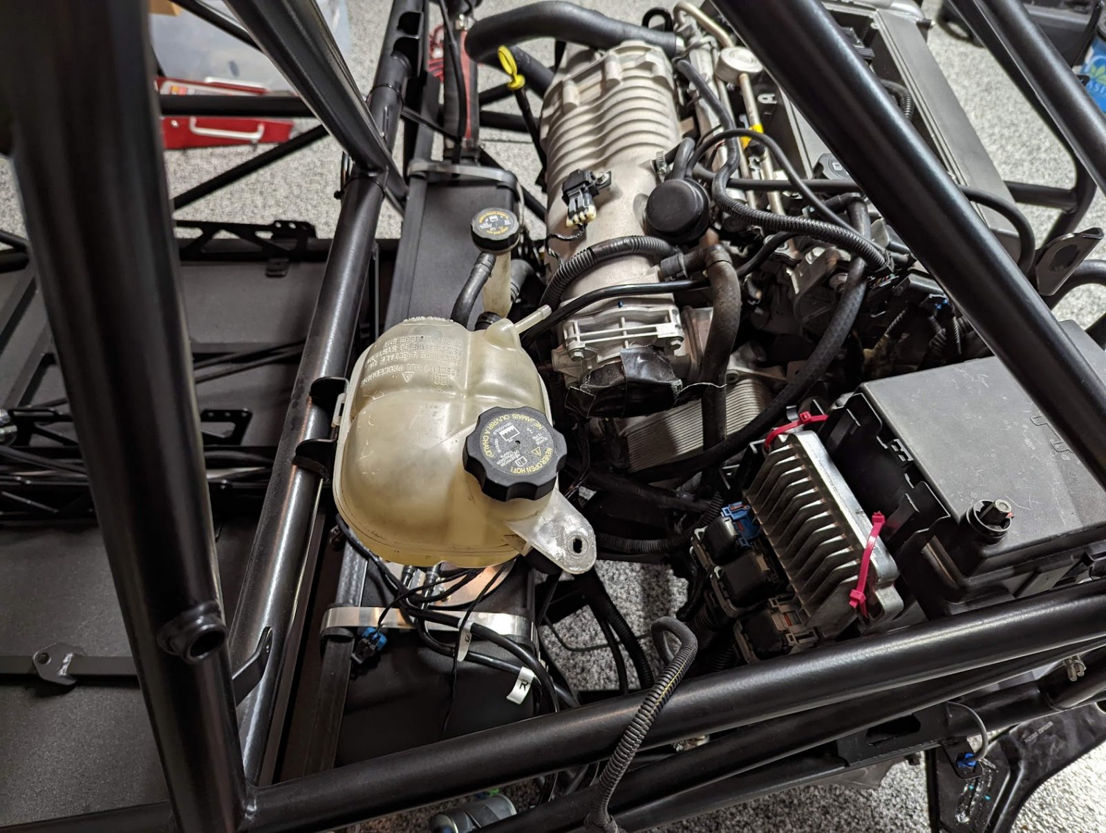

Also, how the heck do I install the coolant overflow tank?? Every picture I see seems to be the old version where it had a welded out arm attaching to the tank...

The green connector is for the ambient temp sensor.
The pair of round aluminum adapters are for the stock struts. You don't need them if you go with the BC coilovers.
The two angled brackets are provided for the rear wing. I did not use mine because they didn't fit the wing I got.

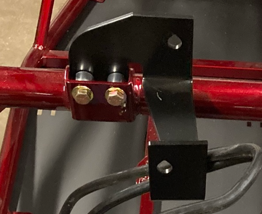

The last bracket, along with an included but not pictured spring, is used to mount the coolant tank.
Threads on the hubs, at least the part the nuts go on are a metric course thread, so if you got a M10 nut to go on then they are M10x1.5. It does seem like a lot of the hubs come with crappy studs that are easy to strip so you have to be careful and not overtighten. Makes you wonder how they hold up to the abuse they see on a full weight car. I'm not sure what the hub side thread is. I would have guessed it's the same M10 but the picture appears larger, so maybe M12. If they are stripped anyway, unscrew it and see.

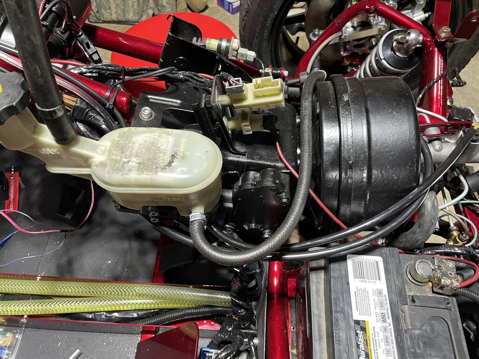

Welcome! Here is a picture of the bracket used to mount the coolant bottle.

I think that the nuts I used to attach the Cobalt rear hubs to the Goblin front uprights were M8x1.25 distorted thread locknuts.

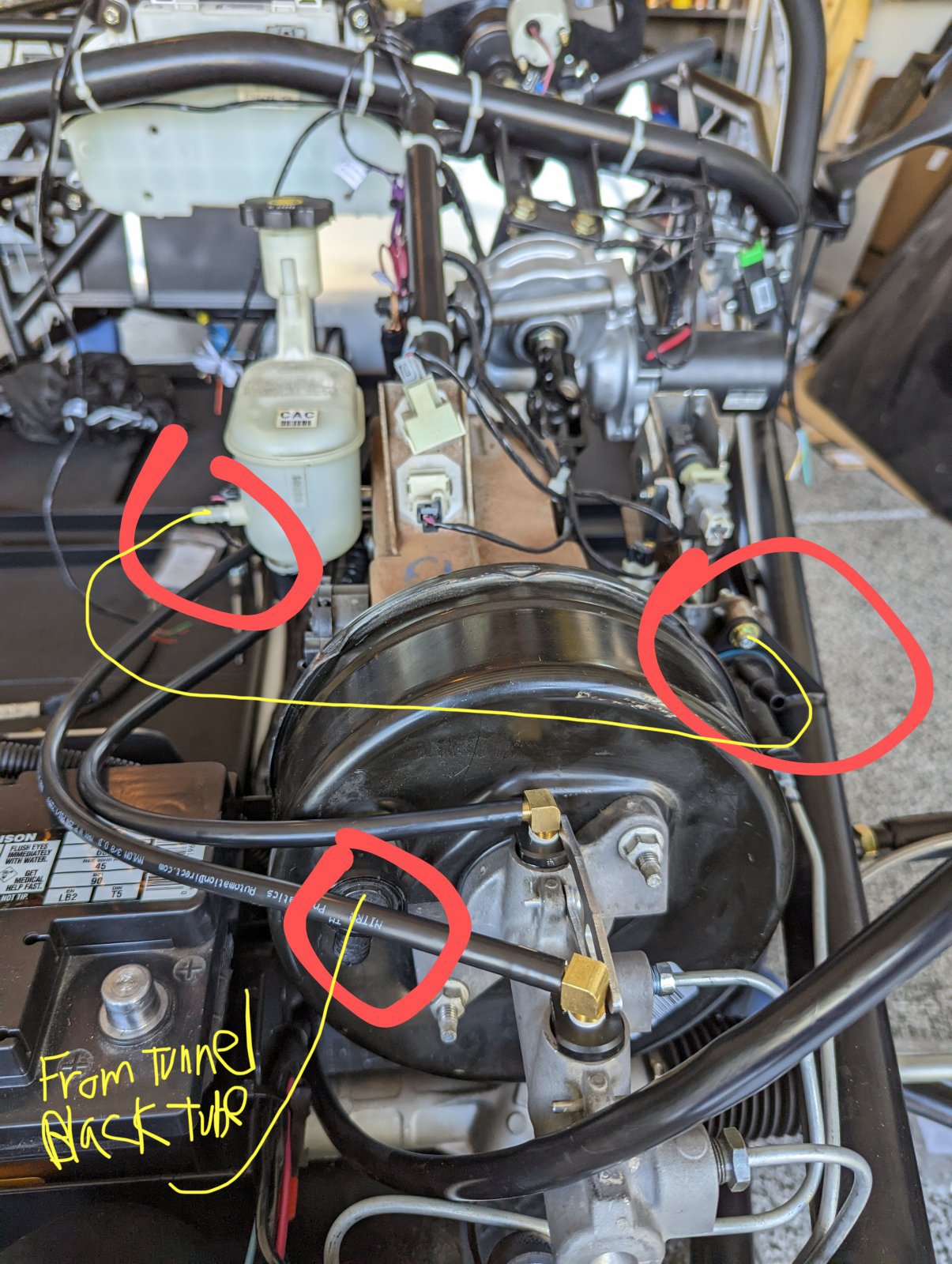

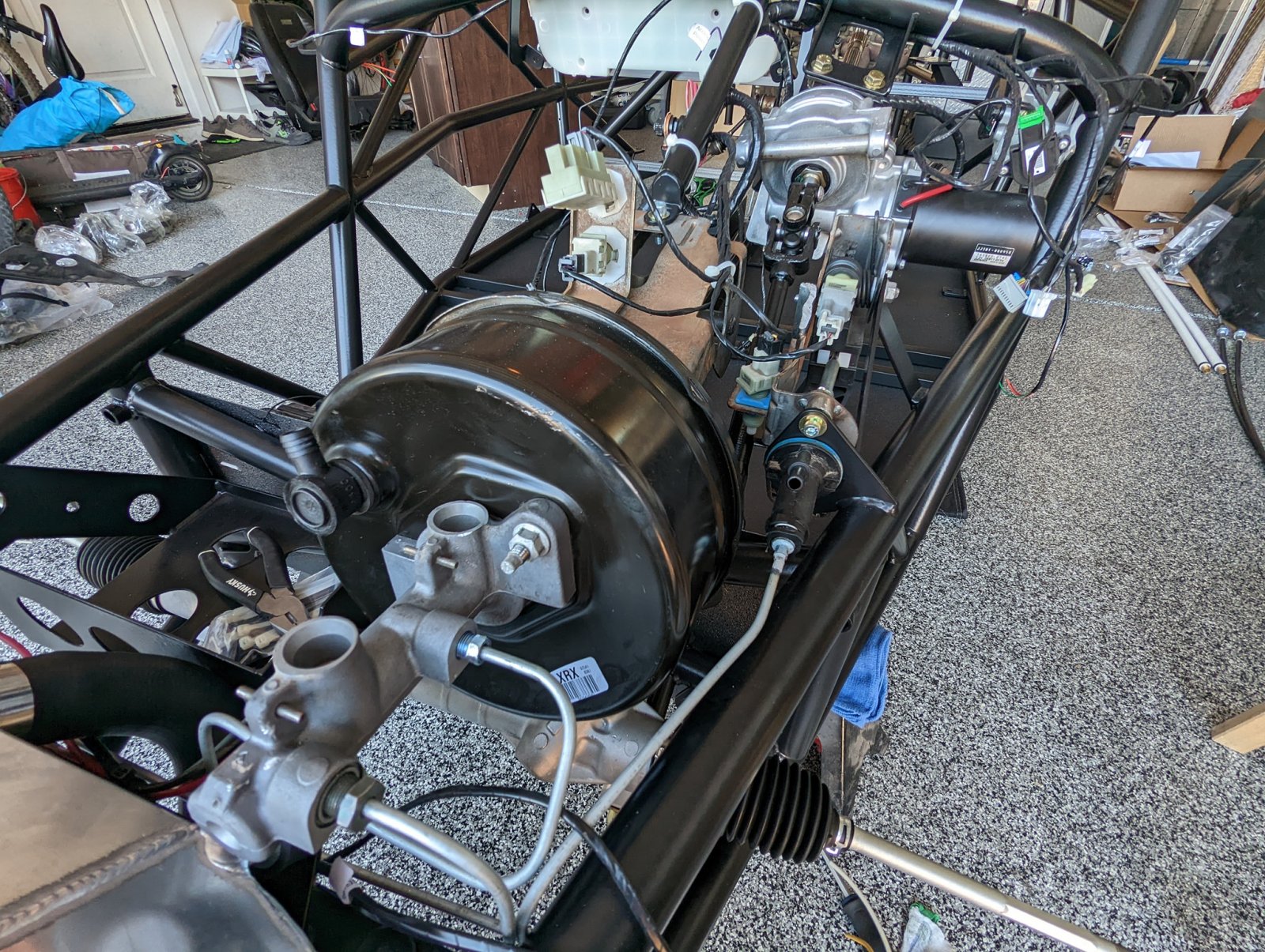

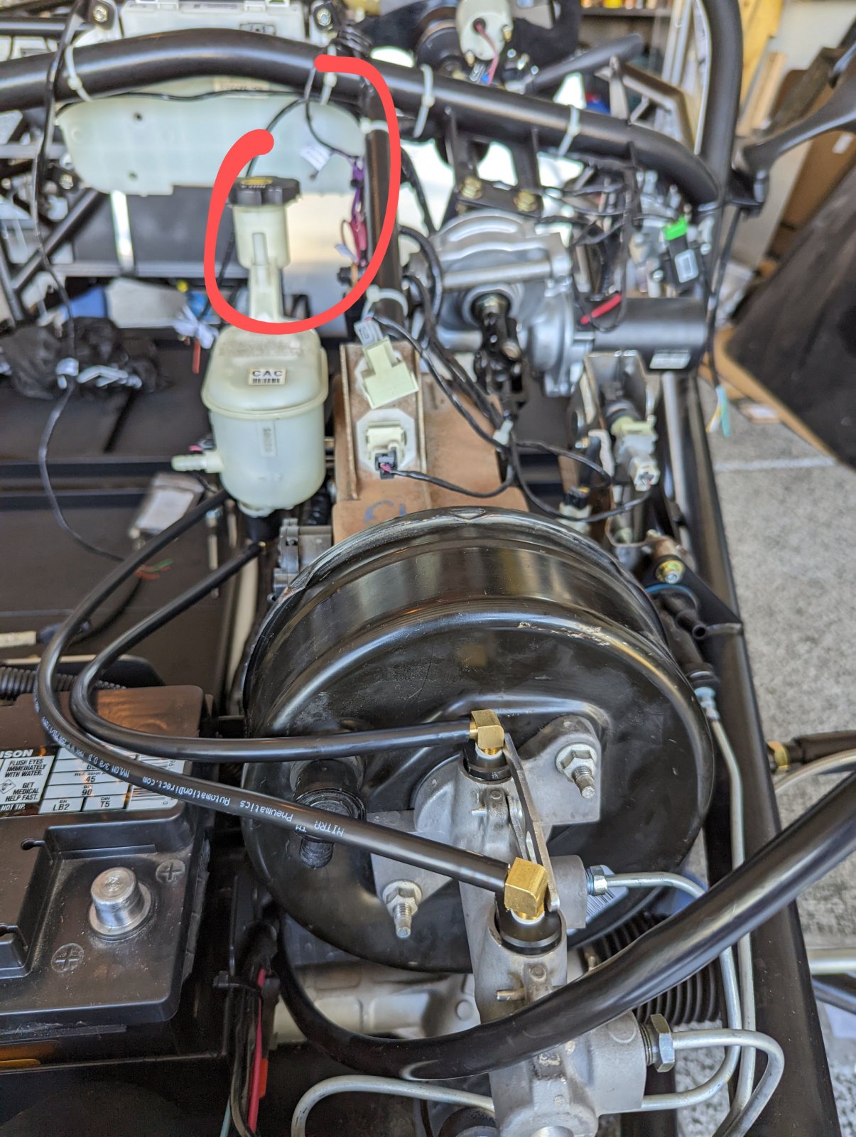

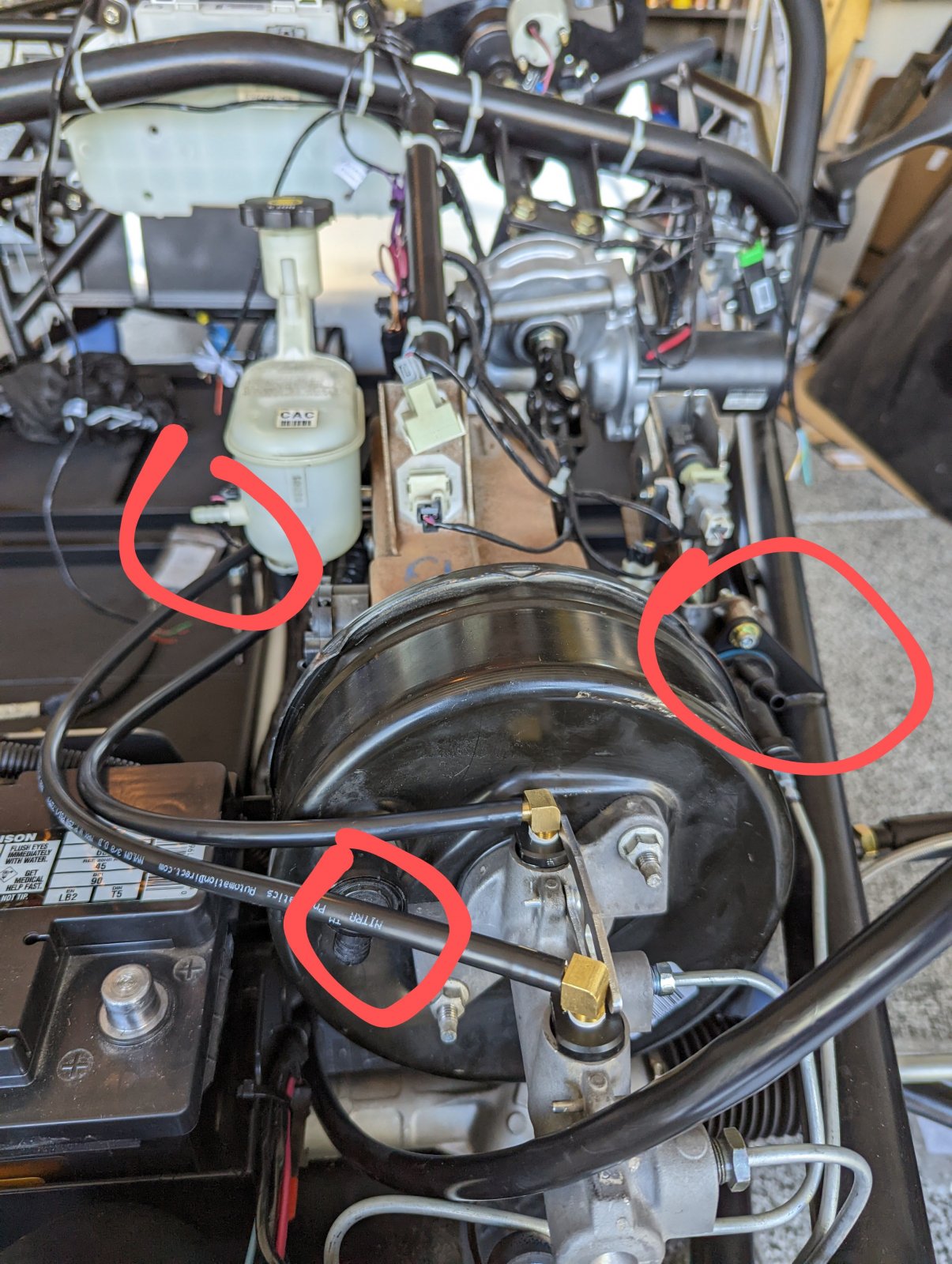

Things have been looking good, but I have some questions on the following circled connections. What do they connect to? I know I have a somewhat rigid tube coming from the engine through the tunnel cover that I assume is supposed to hook up to the break booster, but it just seems too small of a tube. The connect coming off of the brake reservoir, and clutch master cylinder have me confused too.

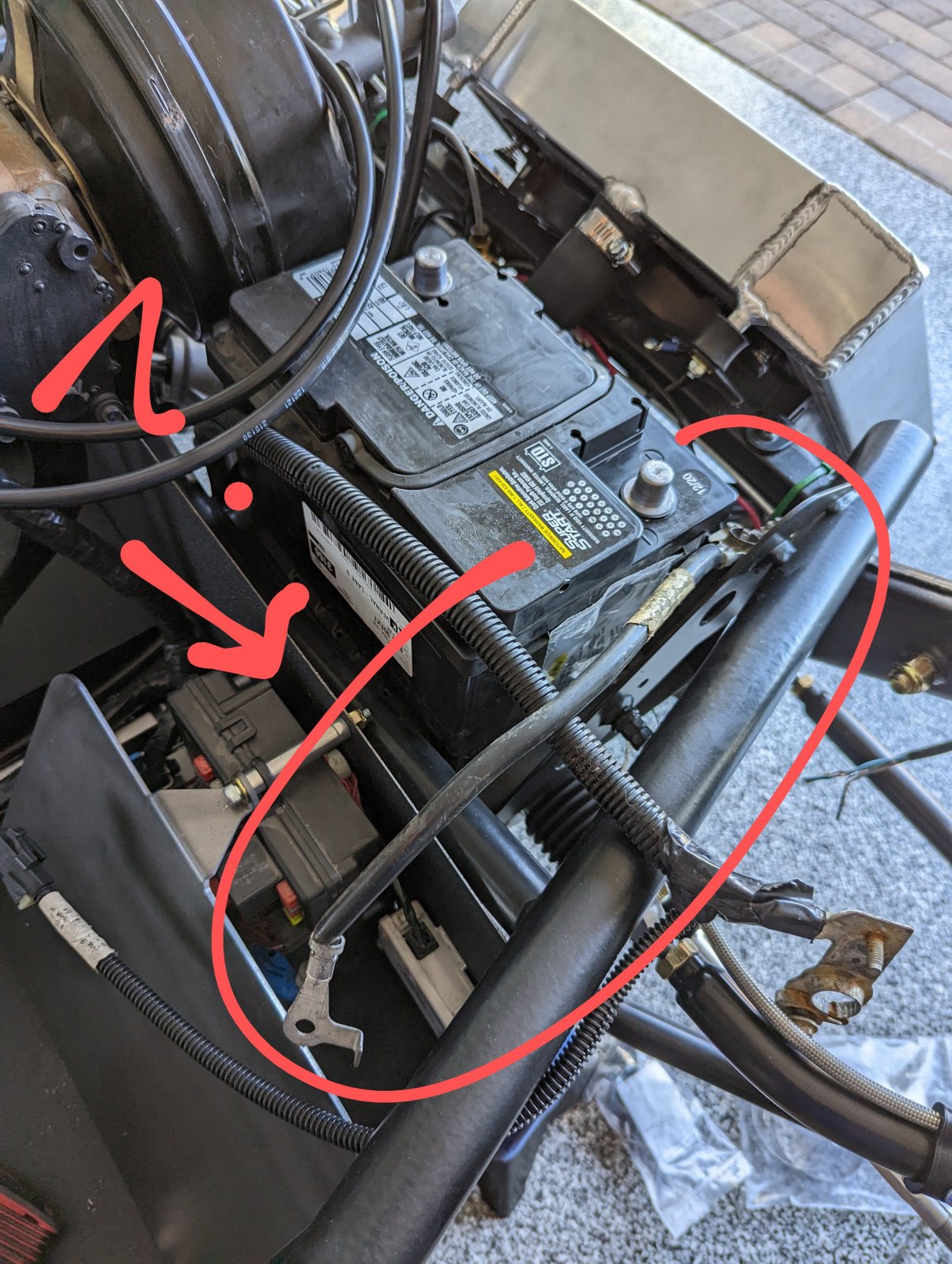

Also the negative battery terminal. Should I hook the ground in between the kickplate or is the somewhere else I should look to put it?

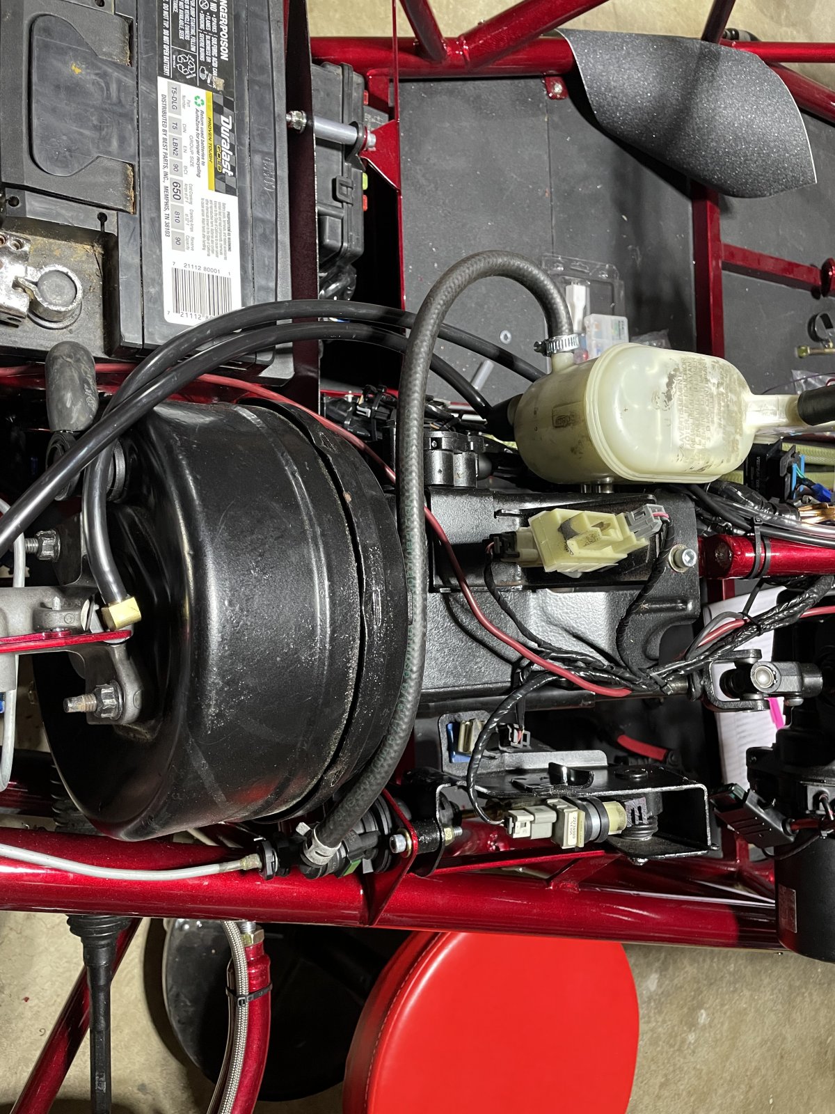

The nipple that you have circled on the brake fluid reservoir is the fluid feed to your clutch master cylinder. The nylon line coming out of the tunnel gets a section of hose clamped to it, and the hose connects to the circled fitting on the brake booster.

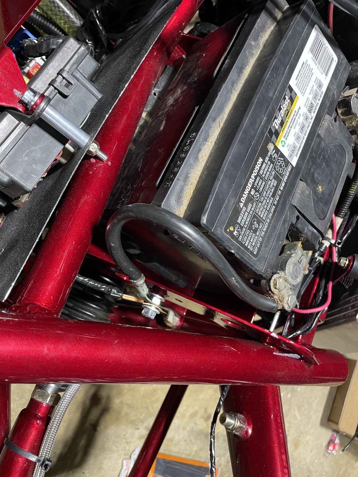

Your negative battery cable goes from the negative battery terminal to the chassis and connects to the ground stud on the side of the battery tray (it's visible in your photo; has the two nuts stacked on it).
Black nylon from engine through tunnel to brake booster.
reservoir to clutch master
black stud highlighted in yellow is your ground. Blue line highlights where the wire should go.

Does the top connection on the brake reservoir get connected to anything, or is it just capped?

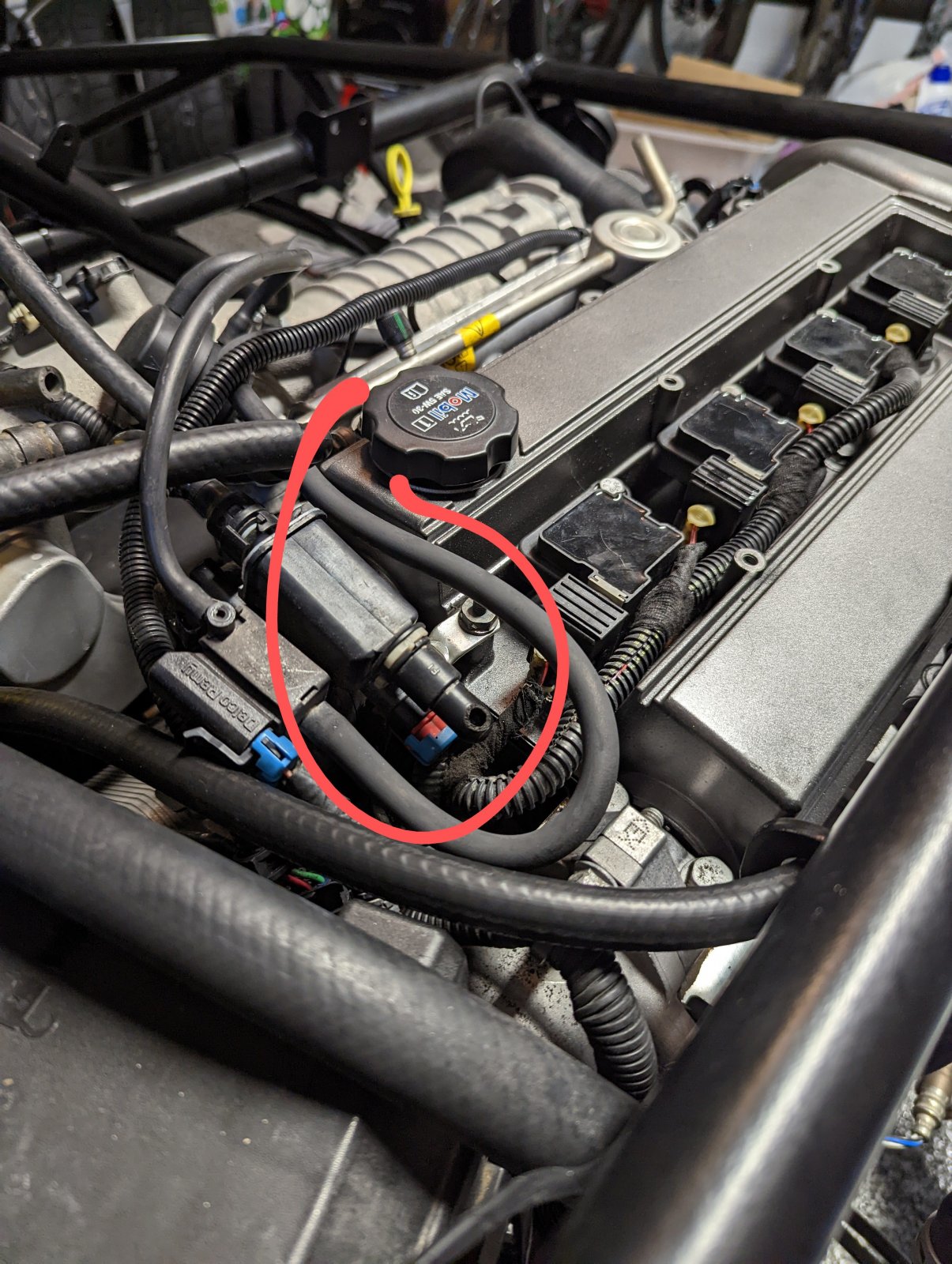

I believe this is the EVAP solenoid circled? I seemed to have broken off the tubing that attaches to this. Do I need a new one to pass emissions I assume, also where does that tube connect to?

The top of the reservoir doesn't go anywhere (put a paperclip down it - it stops before the reservoir), so no need to connect it. I cut it off.
I didn't need to pass emissions in Arkansas, so I just eliminated the evap solenoid.

Gtstorey, that is the evap solenoid, at least it was on my LSJ.
