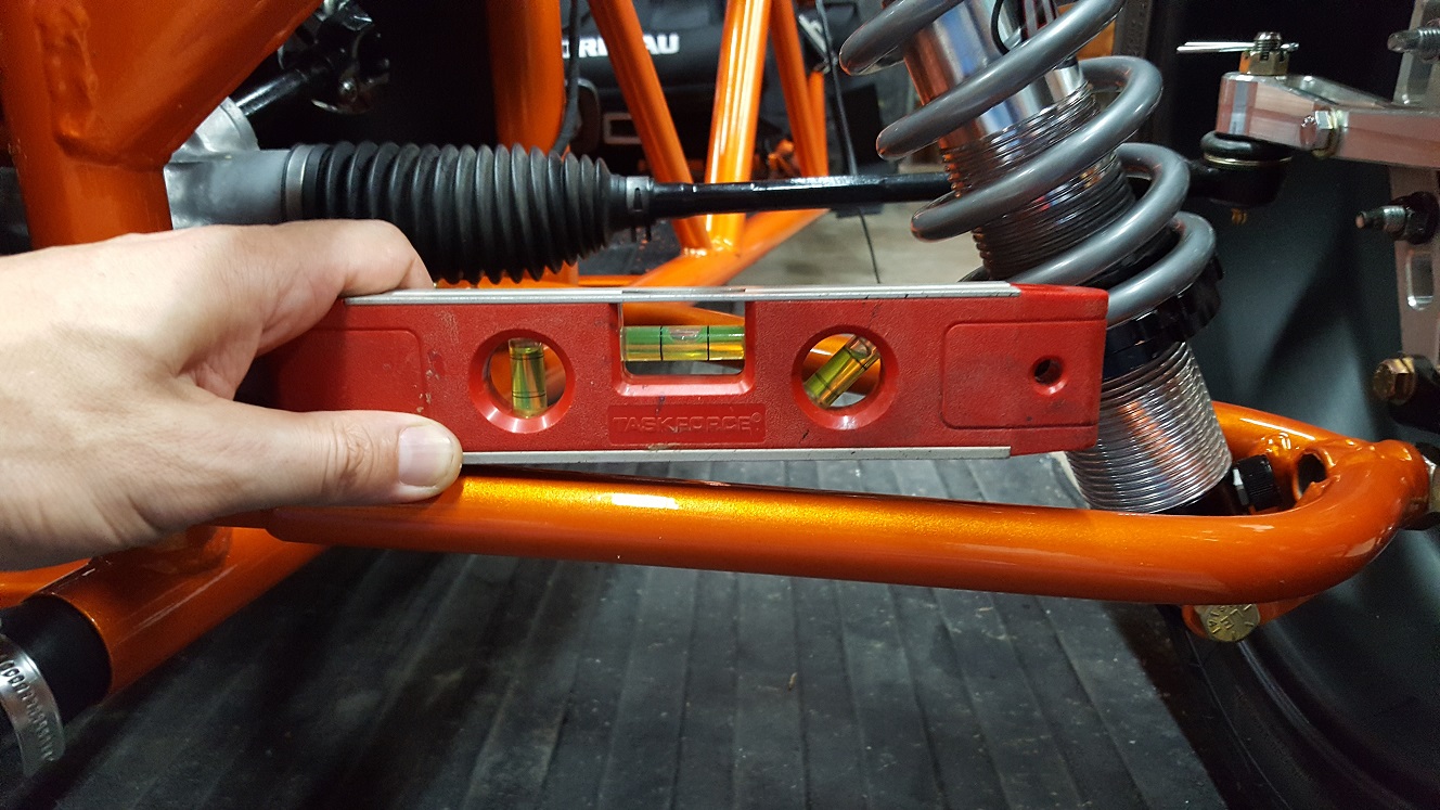

The instructions say to adjust your front coilovers until your lower control arm is level to the ground with you and a passenger in it. I don't see any way of doing that without running out of threads and compressing the crap out of the spring. I only have about 1" of threads left and my arms aren't even close to level. I weight about 200 lbs and the suspension barely budges with me standing directly on it.
??? You shouldn't need anything different than anyone else all things being the same. Post pictures of what you are seeing. It shouldn't be sagging that much.
I know it should be common sense, but I don't know what does what as far as how compressed the spring is. I'm not sure if tightening the lock nut (compressing the spring) lowers the ride height or if loosening it (relaxing the spring) raises it.
At first my spring was compressed to the point of the lock nut being within an inch or so of the top threaded portion. Not really knowing what I'm doing, I loosened it to the point of what the instructions say which is about 2" from the bottom. This is what I'm seeing now. I can stand directly on the control arm and my 200 lb ass practically makes no difference as far as how level the control arm is.
You are going the wrong way with it. Loosen the lower lock nut and then lower the lower spring mount. This will allow the car to settle down and level the lower a-arm. The picture doesn't have anyone in the seat but I assume if two were in the seat it would still be high on the left side (frame side).
In other words, the spring tension is lifting the car side up and pushing the wheel side down causing the current angle you show.
