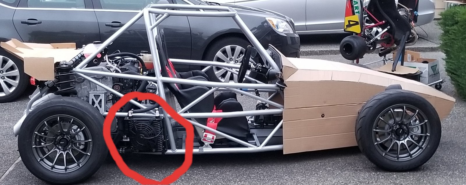

Waterdriver
Side mounted with fan. Haven't seen IAT's more than 10 degrees above ambient.
Bodywork with scoop still to come.
