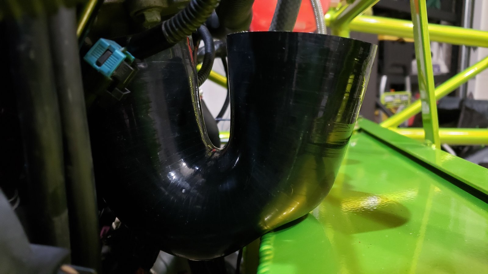

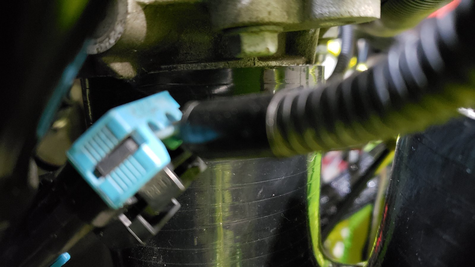

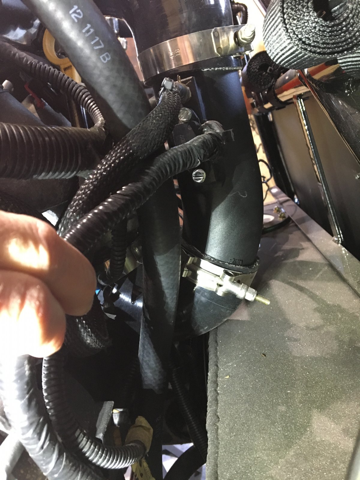

Also....I must be doing something wrong here....
No way does this fit. I have looked @RichRich and @Lethalcast build threads and theirs dont look like this.
Seated in as far up as it will go.
Check out that pressure up against the tank.

The coilovers were meant to be shipped. I'm going to figure out what happened tomorrow morning and get it shipped out before noon. I'm sorry it didn't all make it.
I think I missed it because I rushed to get the kit out the day before Thanksgiving instead of the day after Thanksgiving as I had originally planned.
The 135 degree elbow will need to have the ends trimmed back to your liking. As you trim the the toward the throttle body, it will move up and away from the tank. I'll get a photo and measurements tomorrow and share them here.

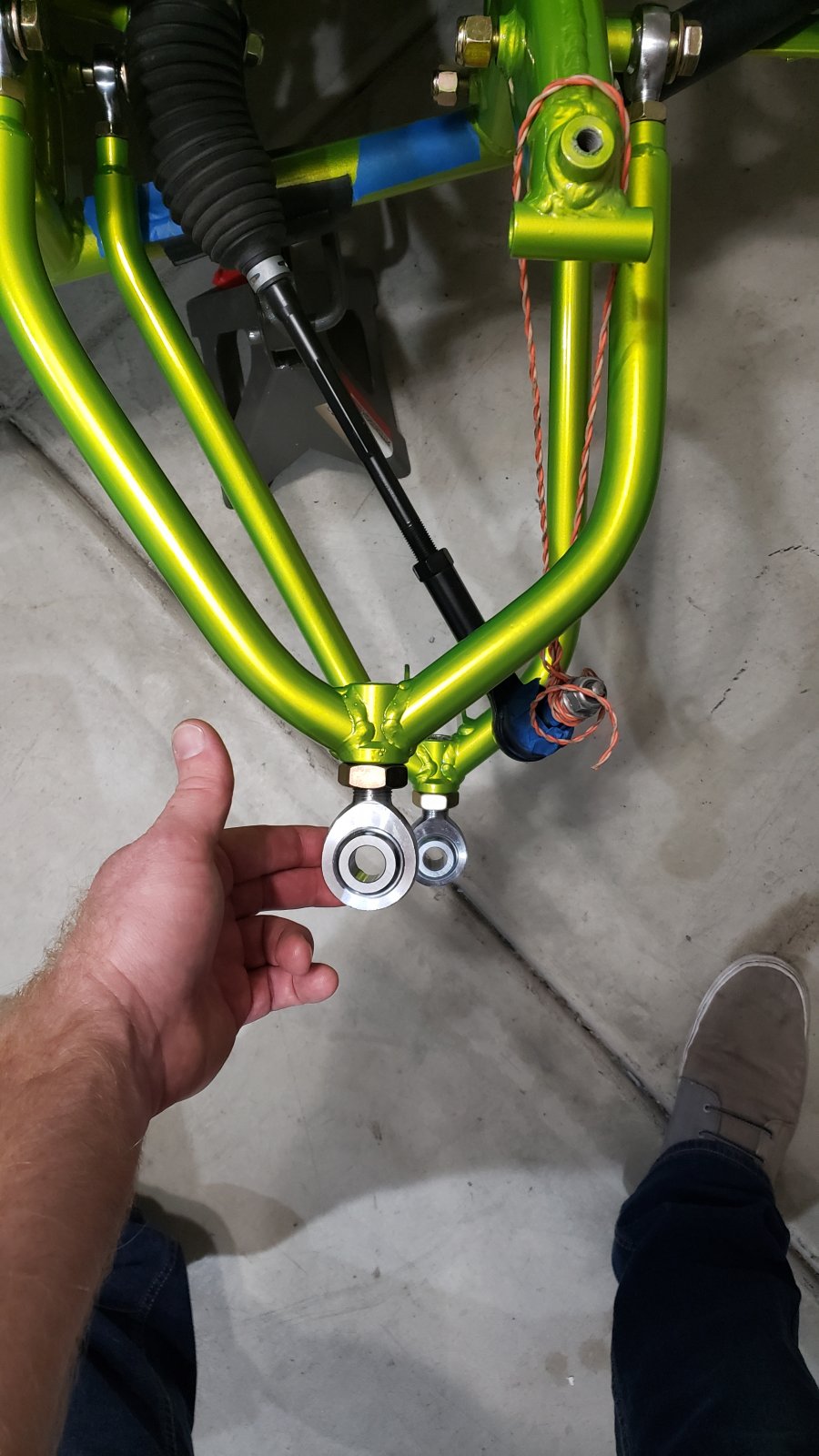

Before I tighten these down I just want to ensure the orientation is correct. The top and bottom joints seem quite a bit off.
I know that they are not snug but the front is touching the chassis and the rear has the same gaps.
IDRVSLO
Just watched the Motorhead Garage episode, looks like everything is good to go and there is a slight offset to the joints. Can anyone confirm?

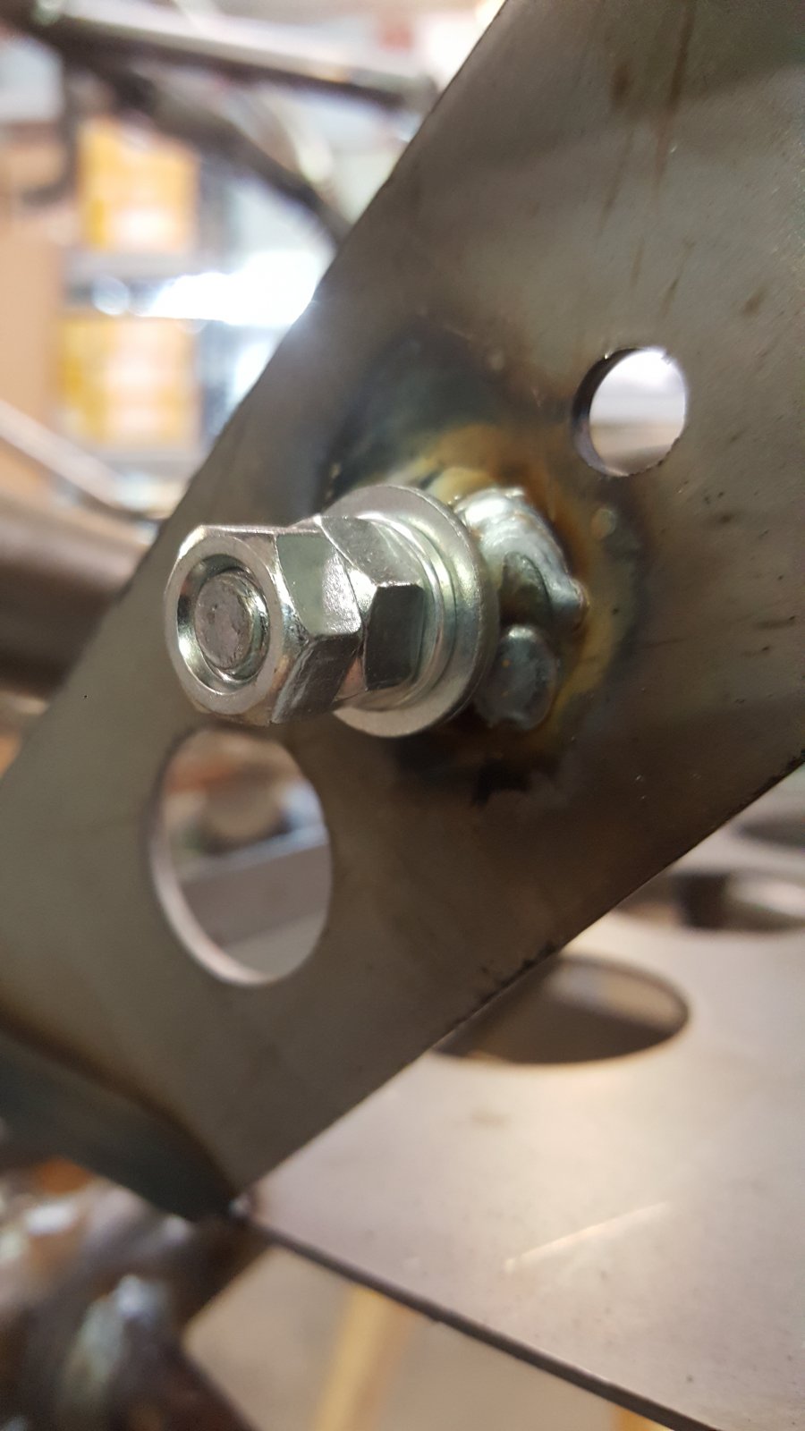

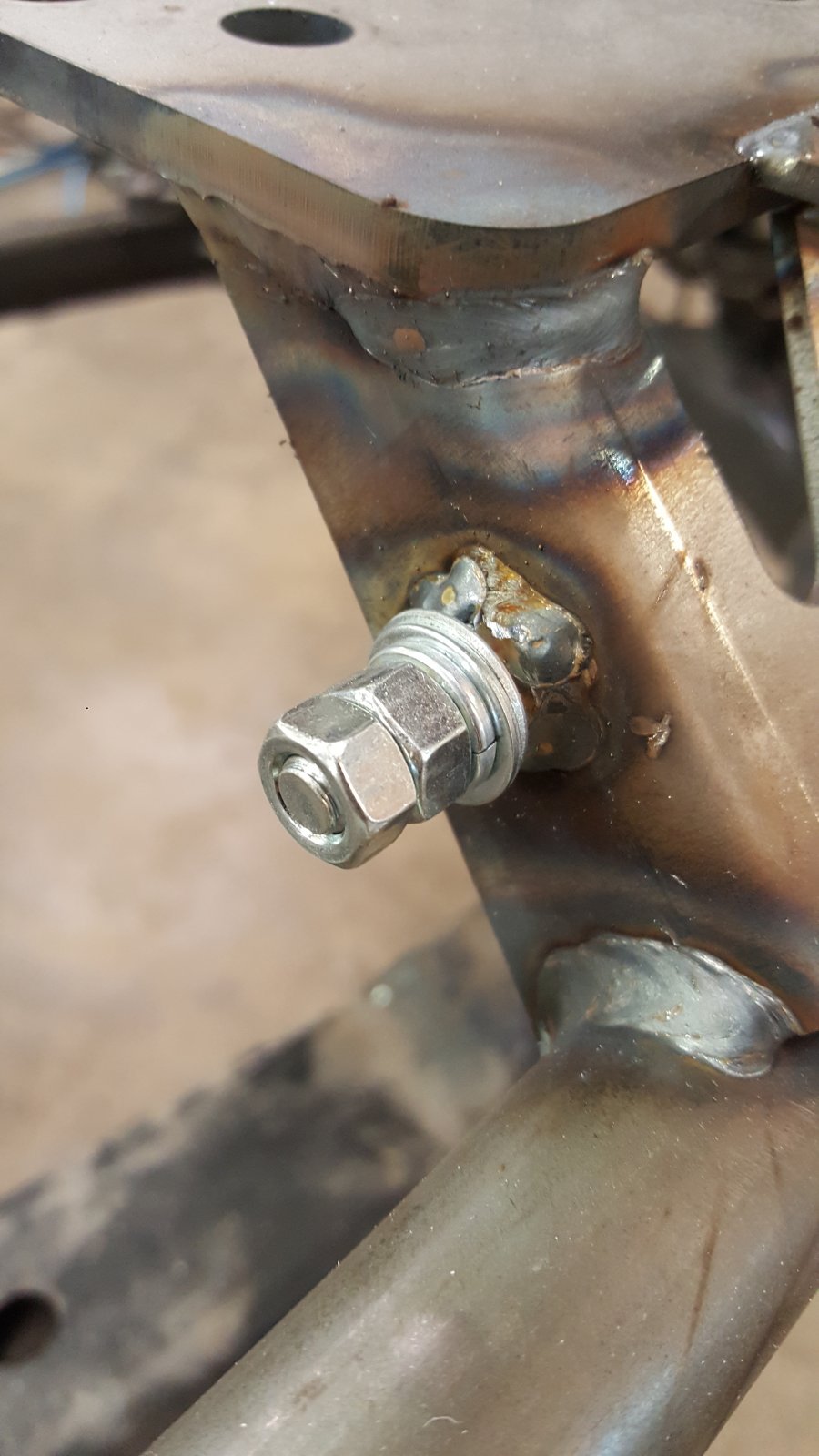

I hate to be that pain in the ass kind of guy, but I see a lot of powder coating on the ground terminal. I'm sure you have cleaned off the threads good. Might consider using a clean nut with a star washer or some other type of grounding washer. Especially with that being the battery to frame connection.
Hopefully it was powder coated with the hardware on the grounding stud.
We stack nuts and washers over the stud so that when it gets powder coated the important surfaces will be clean of powder coat and the external surfaces will match the frame.
The ground strap should go between the two flat washers.

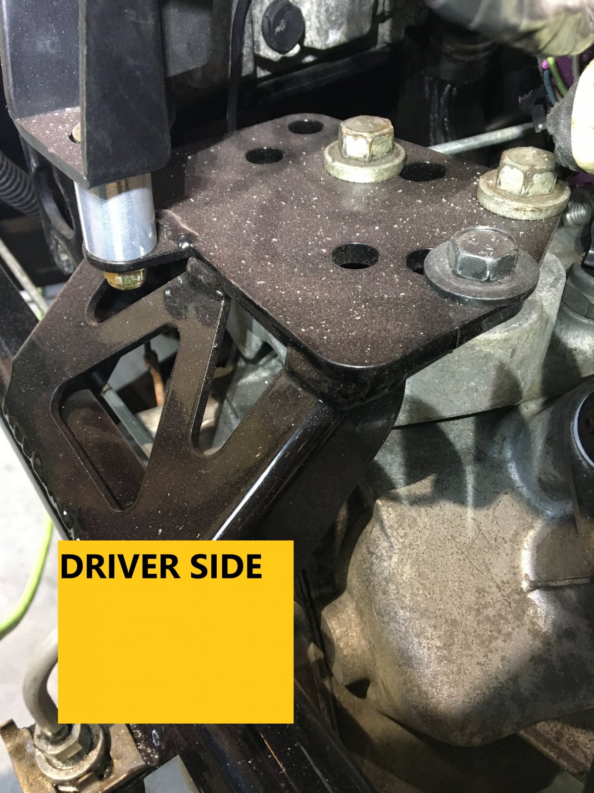

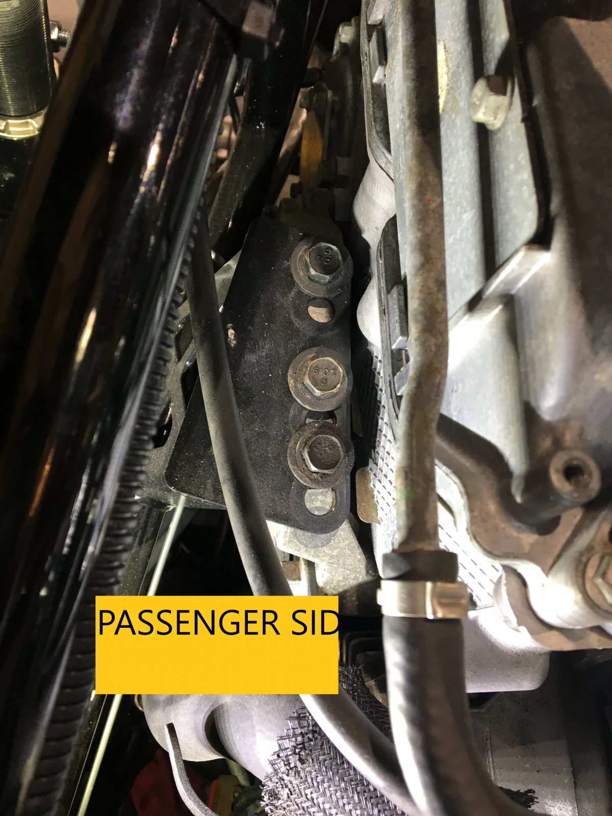

YOU MAY WANT TO DOUBLE CHECK ENGINE MOUNTING HOLES AND SCREWS. THERE ARE MULTIPLE HOLES AND EASY TO USE WRONG HOLES. WILL TAKE SOME PICTURES AND POST WHEN I GET HOME.
IDRVSLO
Thanks for the pictures. Confirms my motor mount locations are correct and as Adam mentioned I need to trim the hose for it to fit that bend.
Appreciate you posting those.

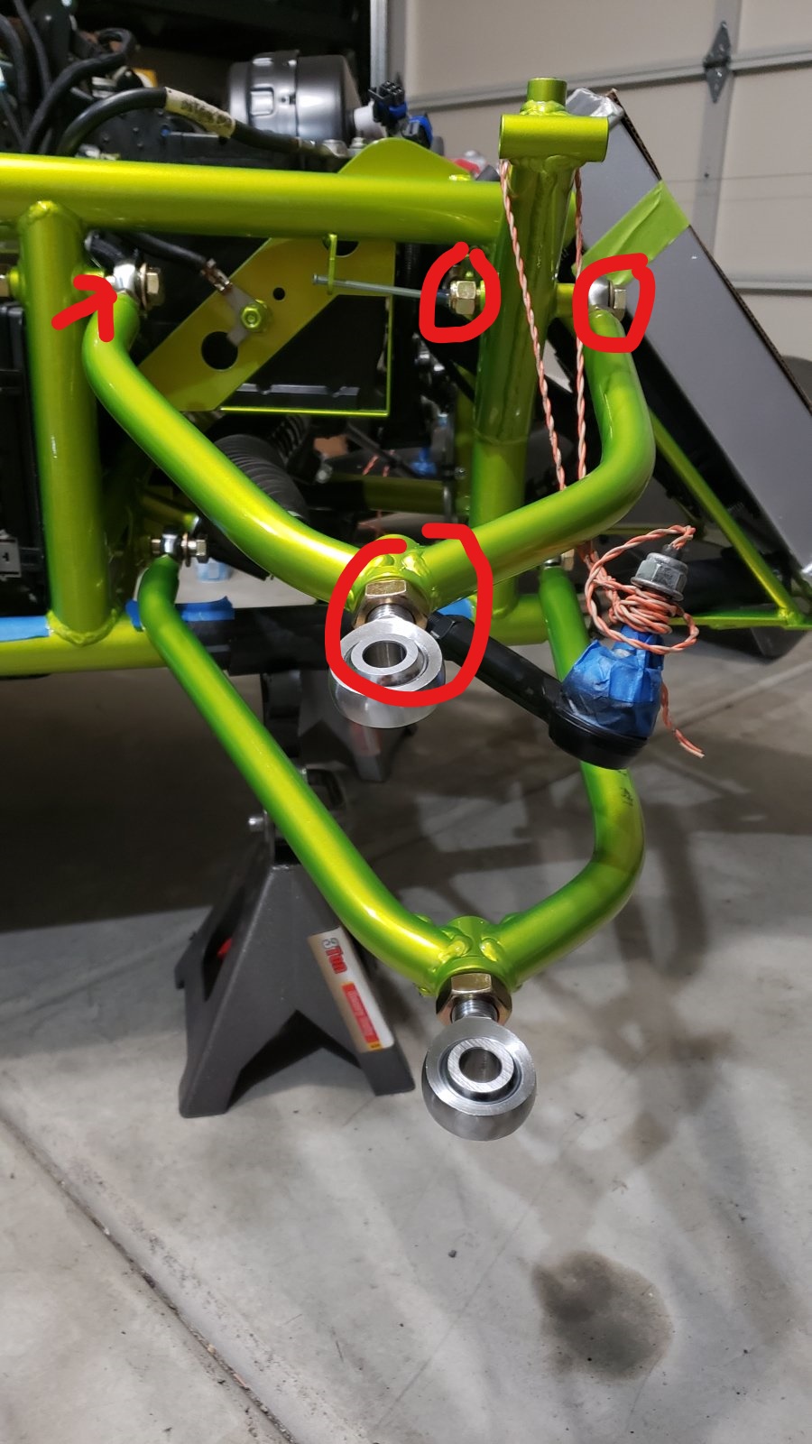

Not at home right now but can anyone confirm the size for these bolts/nuts along with the ones for the shock mount. I dont have many SAE wrenches and want to make sure I get the right ones/set.
k.rollin
19mm or 3/4 will take care of the connections to the main chassis and the jam nuts for the small rod ends. 1-1/8 for the large jam nuts, and 15/16 for connecting your control arms to your uprights. It's been awhile too, but I seem to remember a couple of videos being uploaded for Stage 2 assembly, so checking YouTube for front brakes and suspension might be worthwhile.
