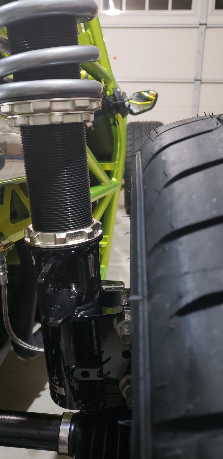

Went back through your blog and im sure i missed it... would you be willing to post up a picture of your rear tire-to-strut clearance? Also, what strut you ordered?
40mm/1.575"
275/40/17
17x9.5 5mm offset

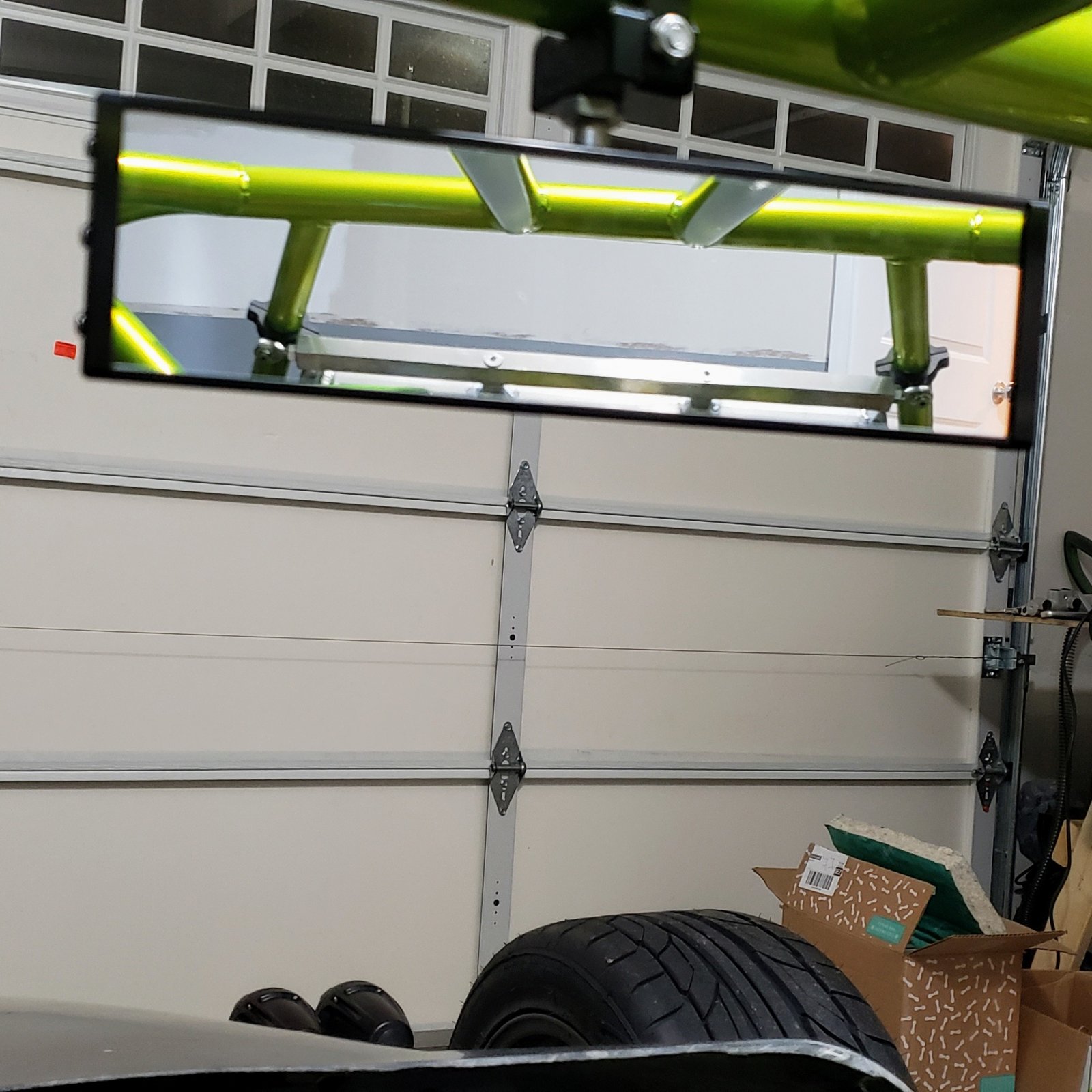

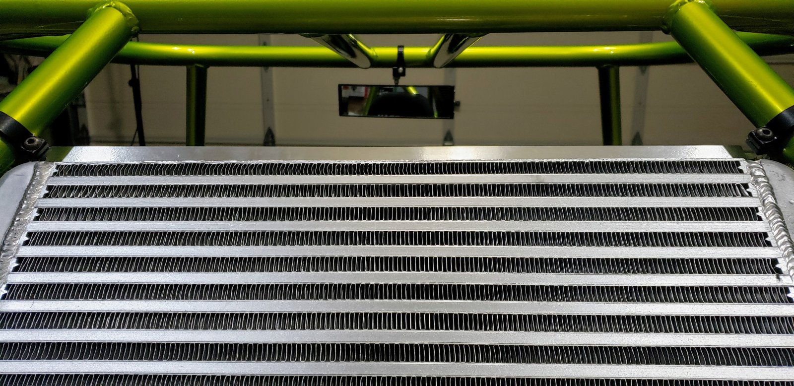

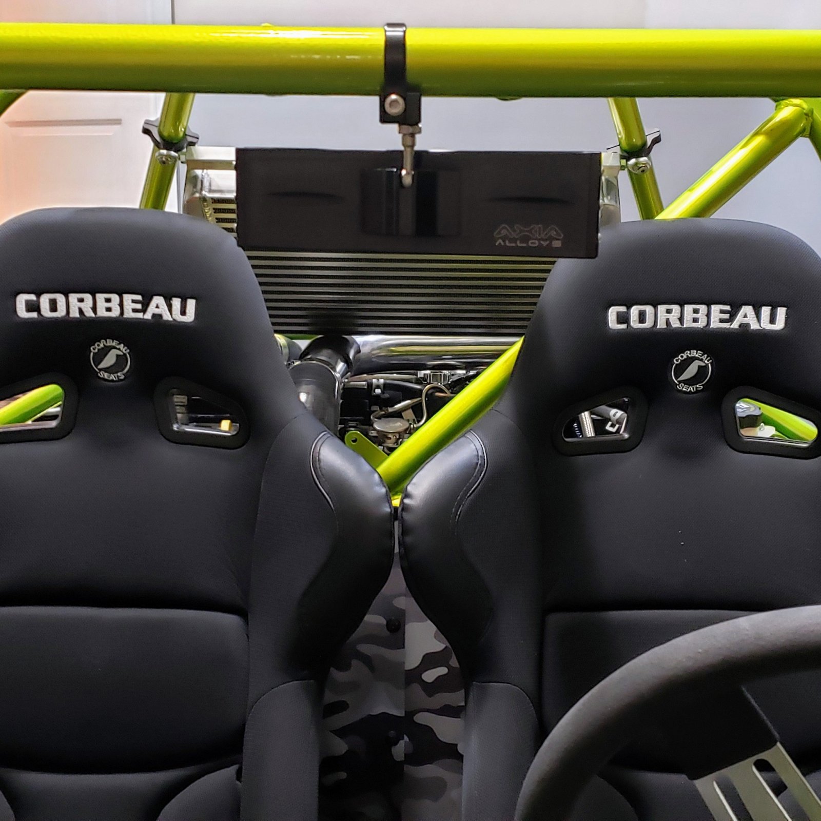

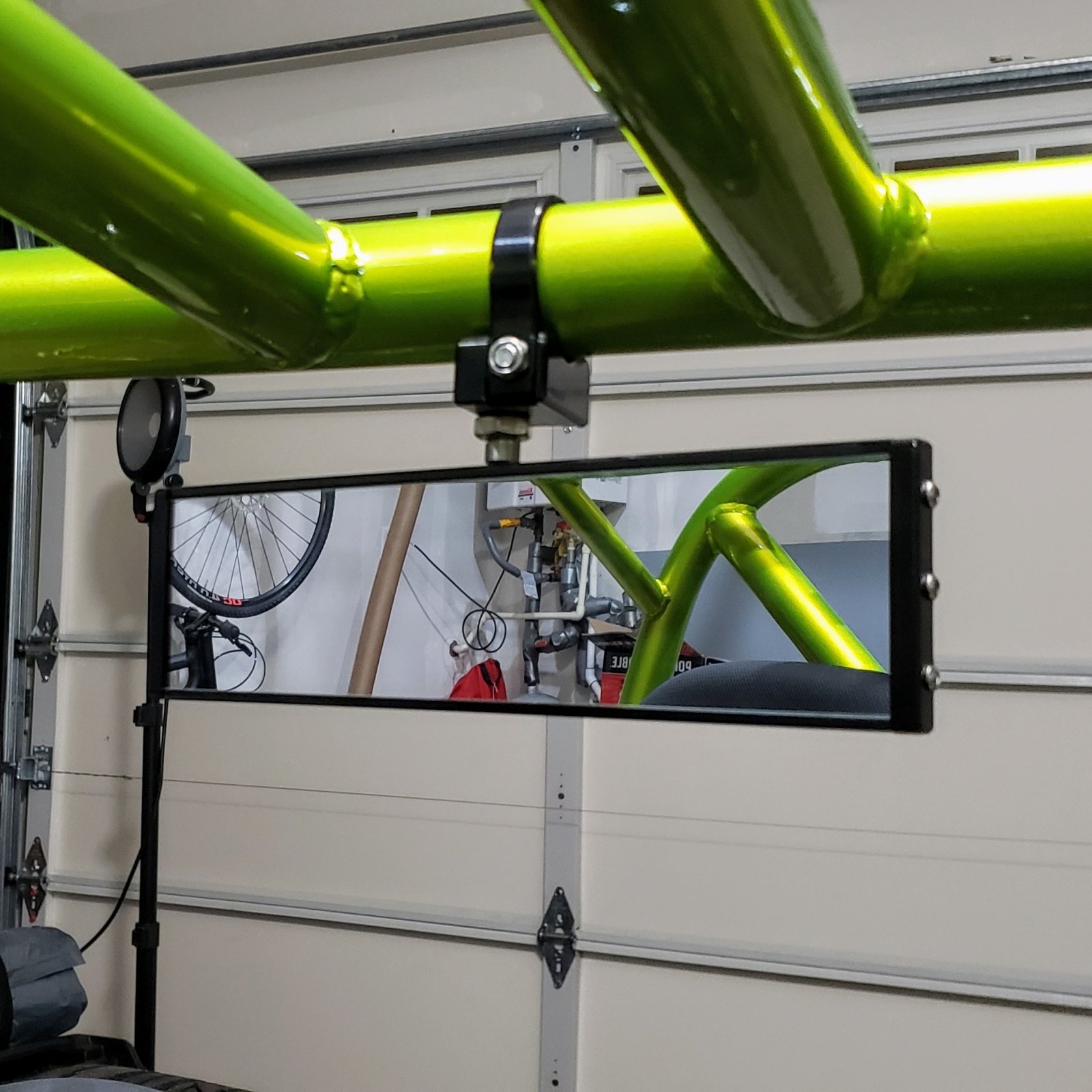

You can see right through the halo/intercooler slot. These sit so low you are looking right something chest level...we will see if the view changes once my wang is installed. Also has just enough convex to take away any blindspot on the passenger side.

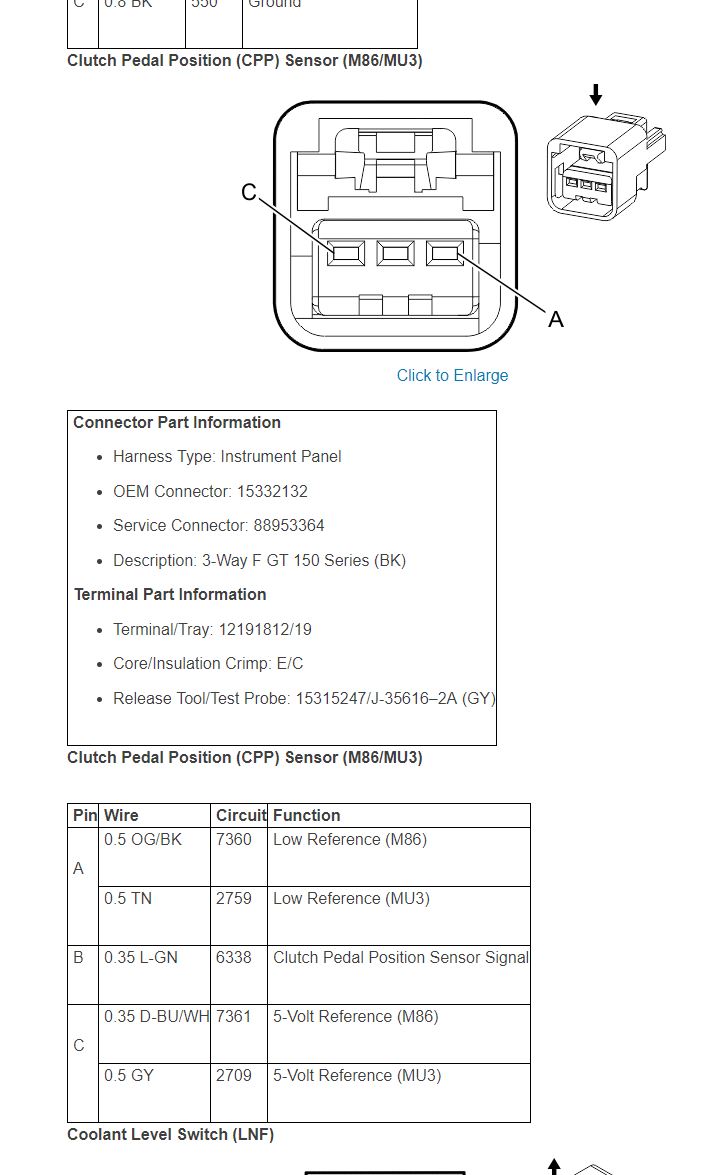

So it looks like 2/3 are for the Clutch Pedal Position Sensor?
If so you can see I have 2 out of 3 that are labeled but the grey wire doesnt have a matching wire on the opposite side.....ugh.

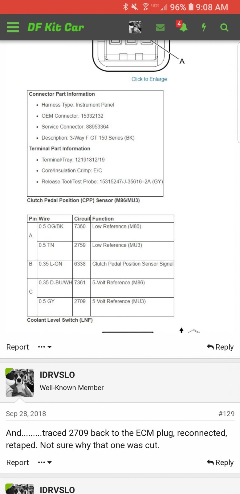

Hey bud, basically finishing up my wiring and noticed I ended up in the same boat as you did ha. I have that left over gray wire from the clutch sencor after reconnecting everything. I must of cut the other side by mistake. Did you ever find out if it was needed or where it’s suppose to go? Thanks!

Yes, definitely needed. I traced it back and had to re solder it. It goes back to the ECM. I dont have that diagram currently available.

If I remember correctly it was the smaller of the two plugs going into the computer. That connector is ultra fragile, just a heads up.
Thanks man! Yea I have to change out a pin from that connector. One was broken when I first purchased the donor and it would t run right. After many hour of testing stuff I finally figure out what wire it was and it just fell out lol I’ll try and find a PIN number for it on the ECM side.

Pin 14 I believe.. there is a thread on the clutch position sensor under electrical.. I also cut the gray wire..
